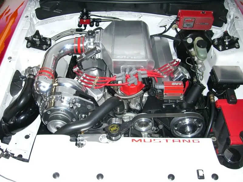

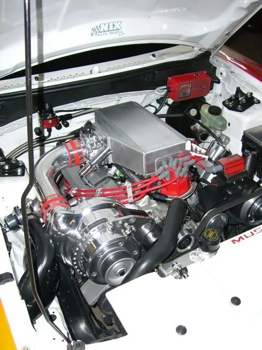

Here is a pic of mine installed. Not a fox, but similar setup. I believe teh fox brackets are slightly different, but you still got the idea of placement and piping.
