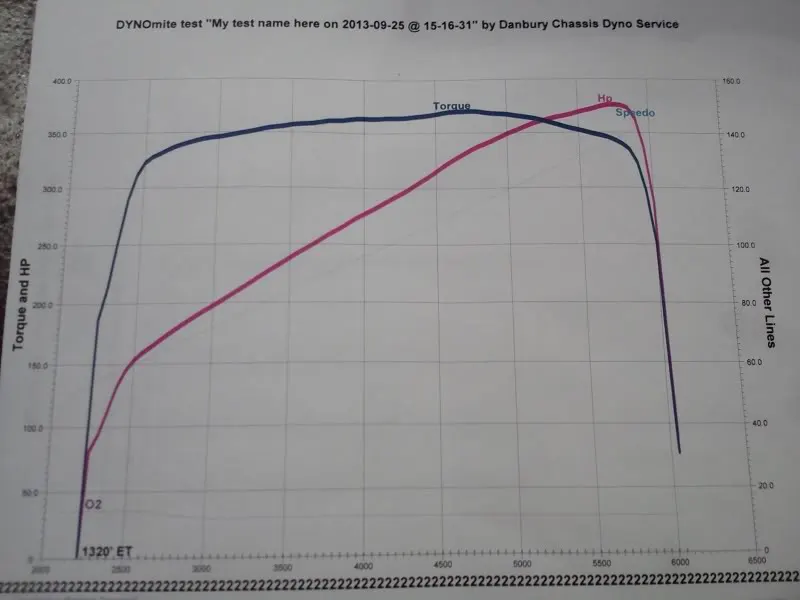

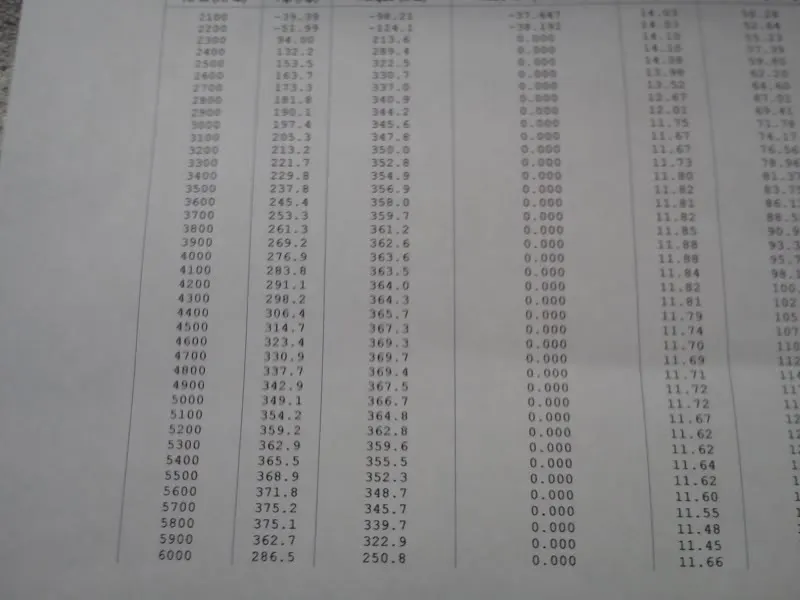

So the car put down 375.2hp @5700rpm and 369.7tq @4700rpm on a dyno jet. The tuner and dyno operator said that the air temp gauge hit 150 and that is too hot! Is 150 over kill or is it normal for this blower with a stock cold air???
