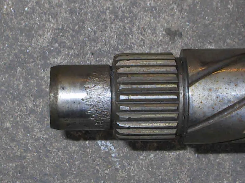

The whine is due to a scored mainshaft inside the trans. In 4th gear, the mainshaft is 1:1 with input shaft, so it's silent, but in all other gears there some differential. It will be loudest in 1st and R
Cause is usually low fluid level starving the roller bearings between the two shafts.
Fix Is to machine the shaft and sleeve it.
Standard rebuilds don't address this. They come with new roller bearings, but the issue is the snout they ride on is galled and what causes the noise.
You can try to find a good used mainshaft
