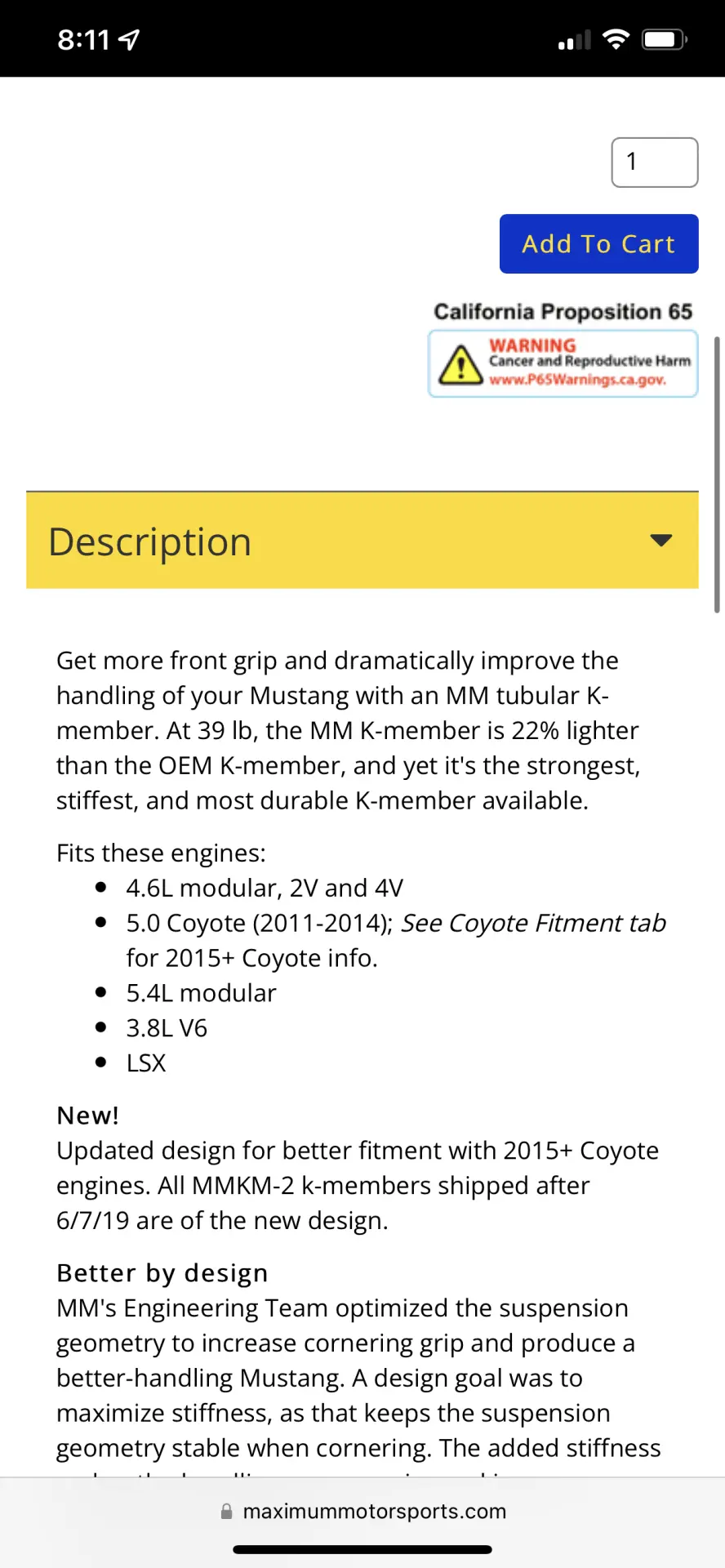

A tubular will also work, as the max Motorsports k member does say both 4.6 and v6
