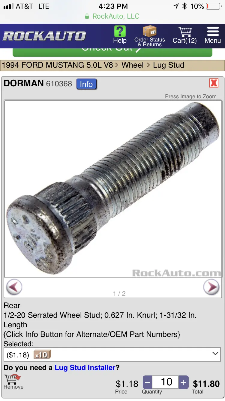

Cool man I’ll try that option and hopefully find some if not I’ll just order from lmr. Also do you know if these studs are what i should get for replacements? And I figured that if I have to loosen the strut nut I might slip in some new ones, not quite sure on that yet, but question is on my caster plates, I don’t remeber where I had them installed but they used the stock shield cover thing, does this need to be on there? It’s always bugged the crap out of me for let’s say the last 13 years!! Dang my engine bay needs a good cleaning, it’s been sitting garaged queened for to dang long.For the dust shields, try Ford. I think I paid $14 for the fronts from Ford directly but I'd imagine price may have gone up a bit more since.

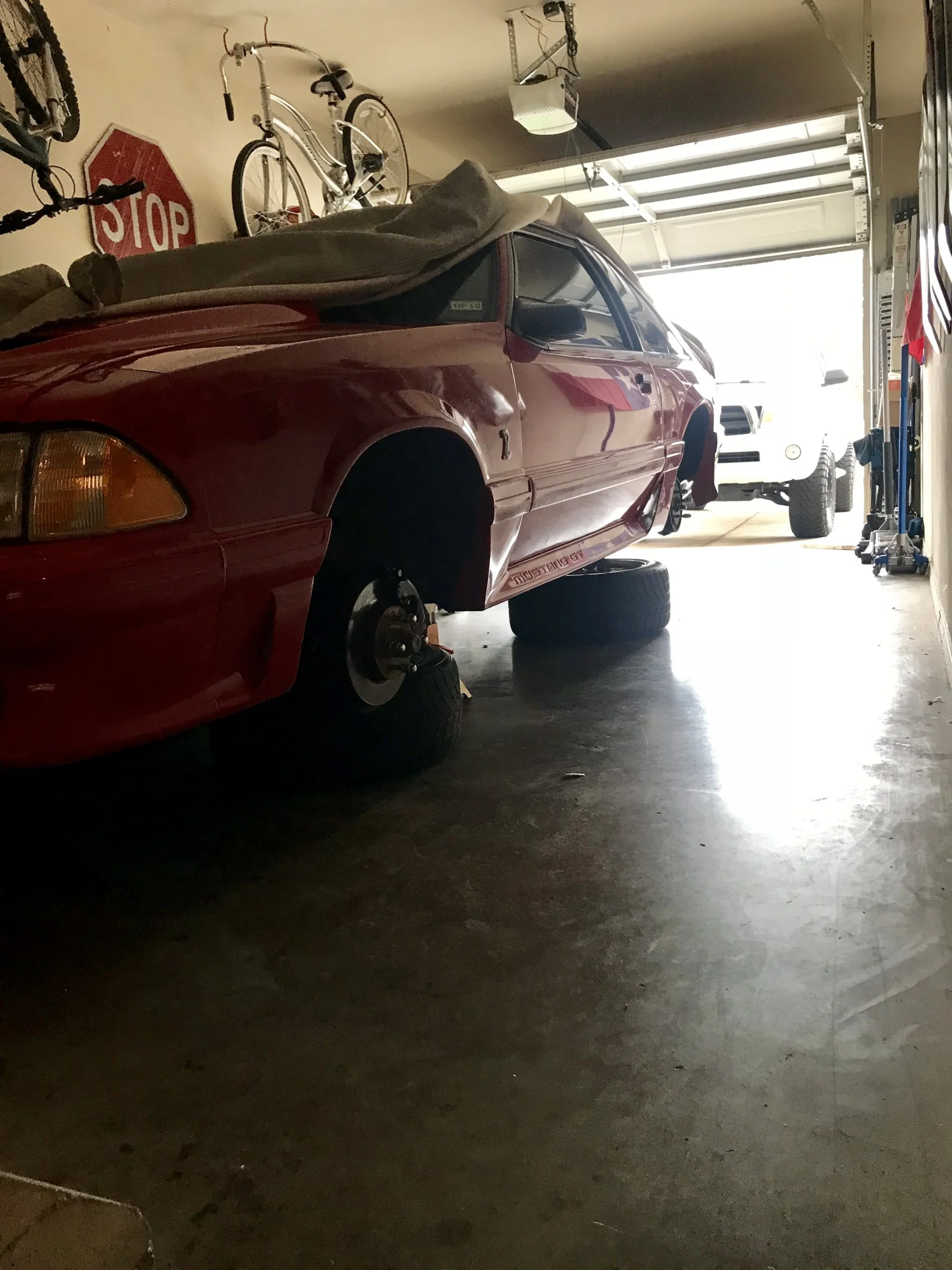

It is a big project but not really that bad, the most difficult thing for me was wedging the 93 Cobra Brake Booster into place. I used Rivets to install the Dust Shields but I am sure you can come up with some small 1/4" nuts and bolts to hold them on.Alright guys getting started on this swap. Pending the front big brake kit but figured it start to disassemble things that I need to get off. Boy that PB blaster stuff stinks put some![]()
on the bolts, they needed to be bathed and let sit for awhile. Have a couple of questions since I know I’ll get to them, and have plenty more.

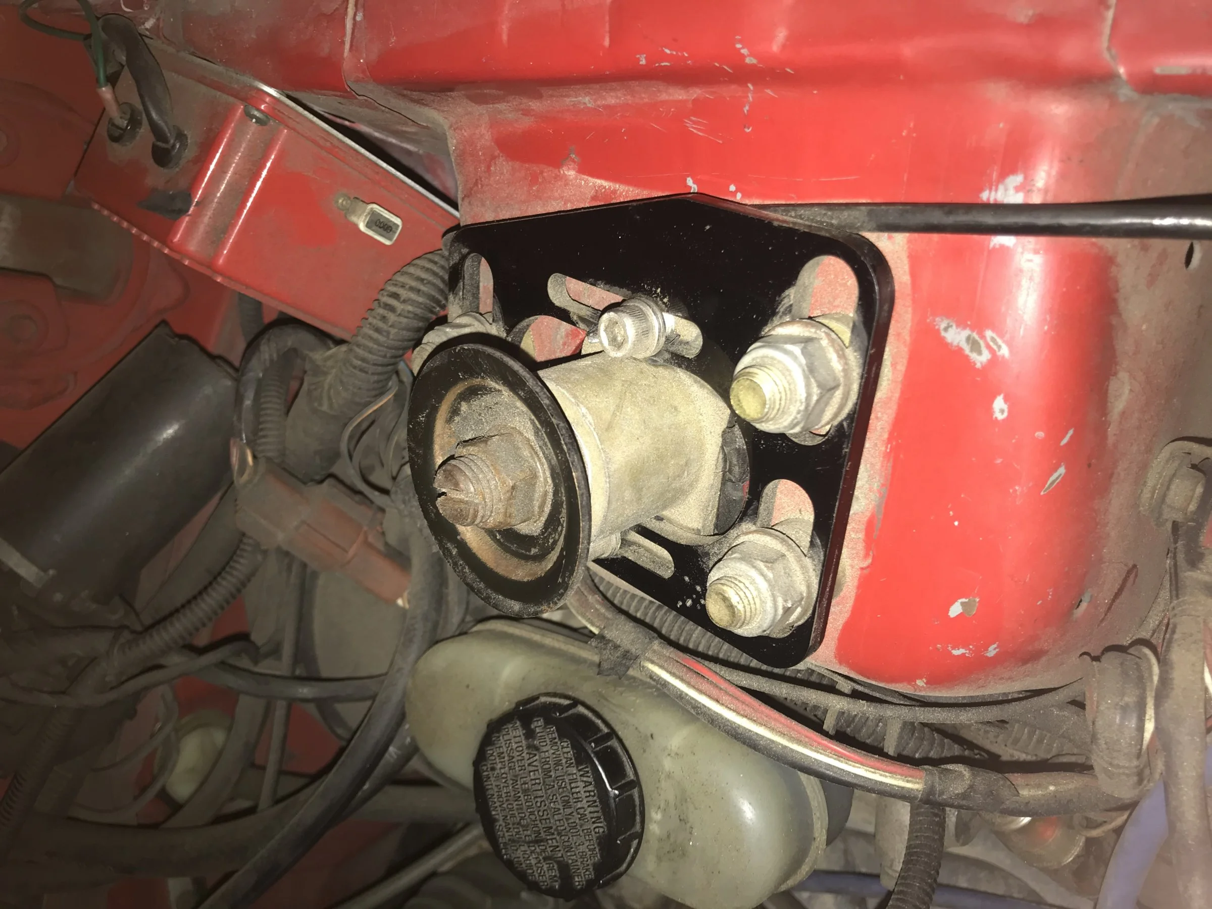

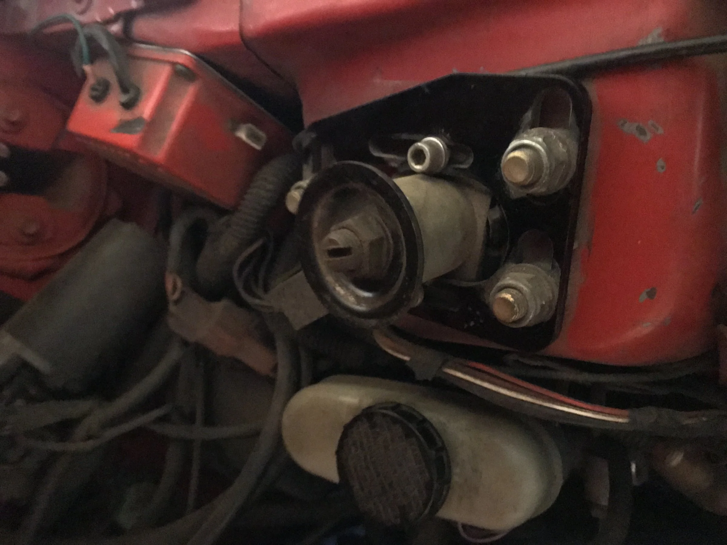

Yeah I was going to ask about that. On the LMR vid for their 5 lug kit they changed the MC but left the stock booster in, at least that’s what I recall bc I was waiting to see how they changed it and they never did. How do I go about that, just loosen and pull out then get the 93 booster to wedge in?It is a big project but not really that bad, the most difficult thing for me was wedging the 93 Cobra Brake Booster into place. I used Rivets to install the Dust Shields but I am sure you can come up with some small 1/4" nuts and bolts to hold them on.
When I upgraded to OEM Cobra 13"/11.625" brakes, I changed my MC and booster to a 93' cobra MC and 93' cobra booster and my brakes feel perfect. This upgrade is worth every penny spent and every F bomb you'll shout while under the dash removing and installing the booster. We will be here to answer any of your questions you may have throughout your install.Yeah I was going to ask about that. On the LMR vid for their 5 lug kit they changed the MC but left the stock booster in, at least that’s what I recall bc I was waiting to see how they changed it and they never did. How do I go about that, just loosen and pull out then get the 93 booster to wedge in?
Truth! This is what I did.I have done the 5 lug swap on 6 different cars. In my opinion you MUST do the booster, otherwise you will have a hard pedal and poor braking. It actually defeats the purpose of upgrading your brakes. 93 cobra booster swap is not that bad. If you elongate the holes where the booster studs go through the firewall it will slip in no problem. You have to trust me on this. I actually have it down to where I can swap the booster in under 45 minutes.
