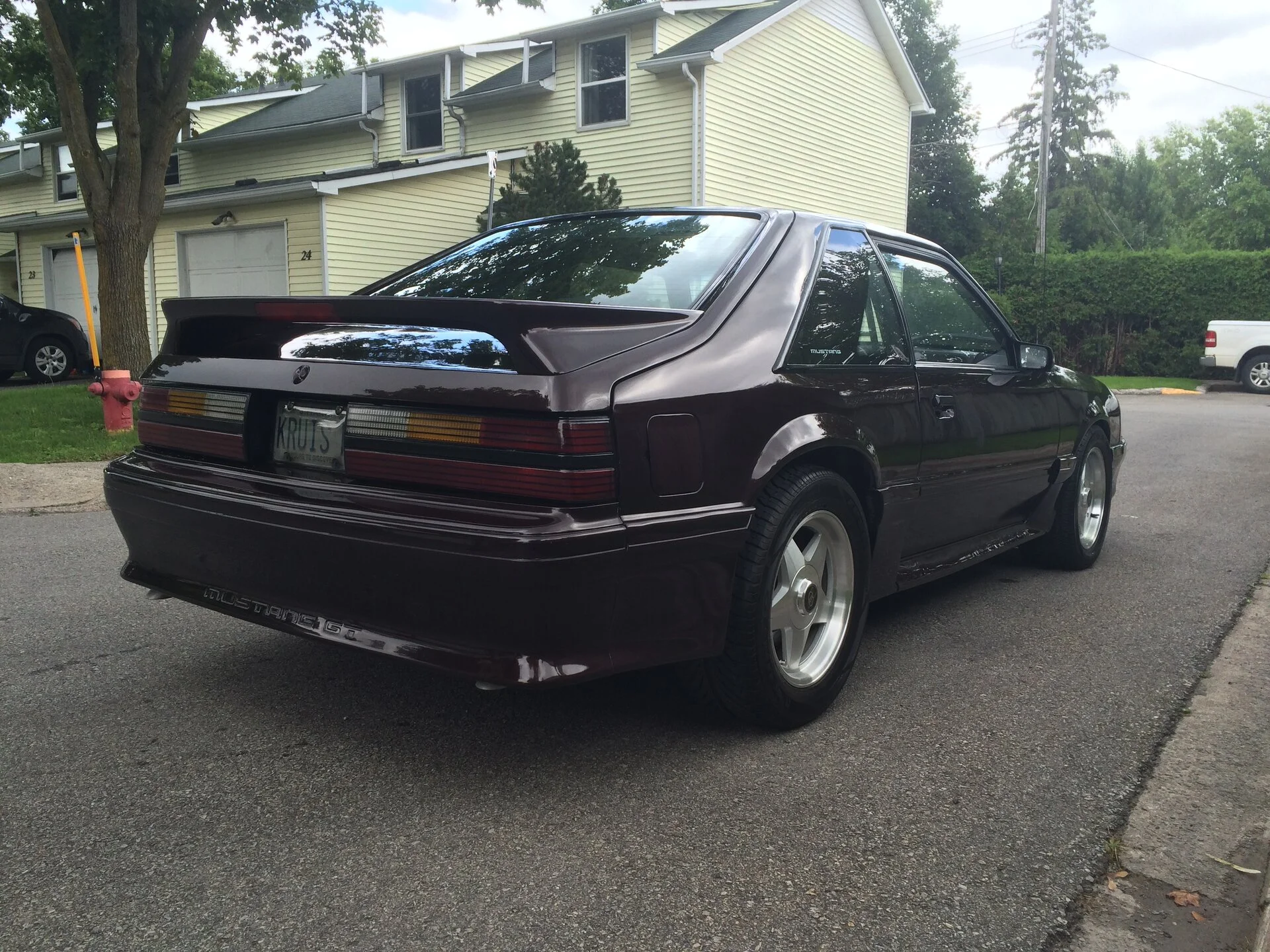

I have a 90 GT. I moved the my lower control arms in 0.75" as per the modified K member in the Mathis Performance Handbook 2. I tried some SN95 QA1 tubular lower arms with a spindle from a 2000. My rims were 16x8 with an 8mm or 0mm offset (I don't remember off the top of my head). My rims stuck out too far as seen here...
So I went back to a fox length arm - no other changes.
