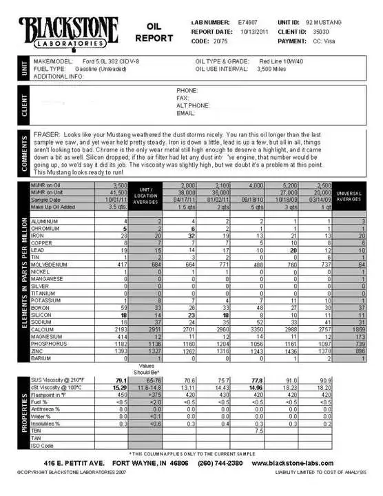

Looks like a good report from Blackstone. I think I am going to try them just ordered the test kit online; they look like they actually give you pretty good feed back on the analysis. The company I doubt with in the past really gives you no feed back on what the analysis means. I think that was a affective test with K&N, I run a knock off K&N from Summit but use no oil, with less then 1000 miles a year and never run in less then nice weather I think I will be fine…

MFE92 said:
You didnt read the original post where blackstone said "If the filter had let any dust into the engine, that number would be going up, so we'd say it did its job"

Yes, if it makes its way to the oil, it will show up when analyzed.
There are a lot of surfaces for dust and dirt to stick to before it winds up in the oil.

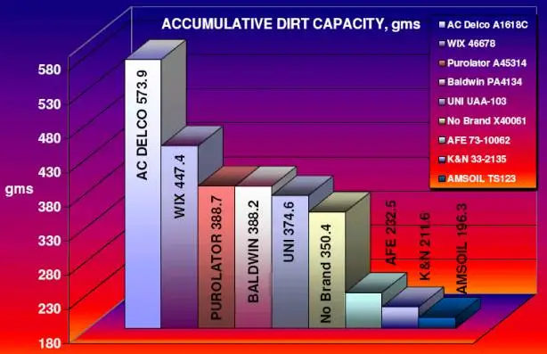

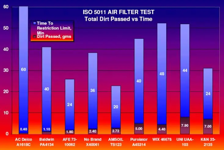

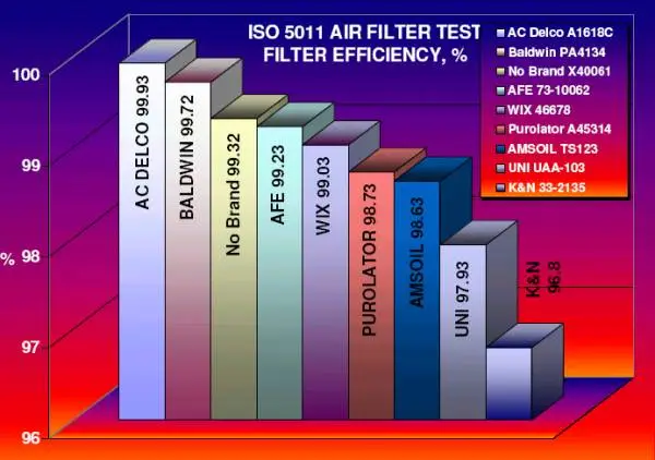

One test:
ISO 5011 Duramax Air Filter Test Report
Compared to the AC, the K&N “plugged up” nearly 3 times faster, passed 18 times more dirt and captured 37% less dirt.
K&N will pass the most amount of dirt in the least amount of time.

wow an AC delco filter (GM OEM) lead a test on a duramax (GM)
lets all throw our big open filters away and put motorcraft filters on....
****t hat i'll stick to my K&N and let my **** breath
Put on your reading glasses.
The test was independently performed under controlled conditions using a $285,000 machine at Testand Corp of Rhode Island (manufacturer of the machine)
FILTER EFFICIENCY: K&N scored lowest, test done to ISO standards!!!
FILTER CAPACITY: K&N scored 8th out of 9th
