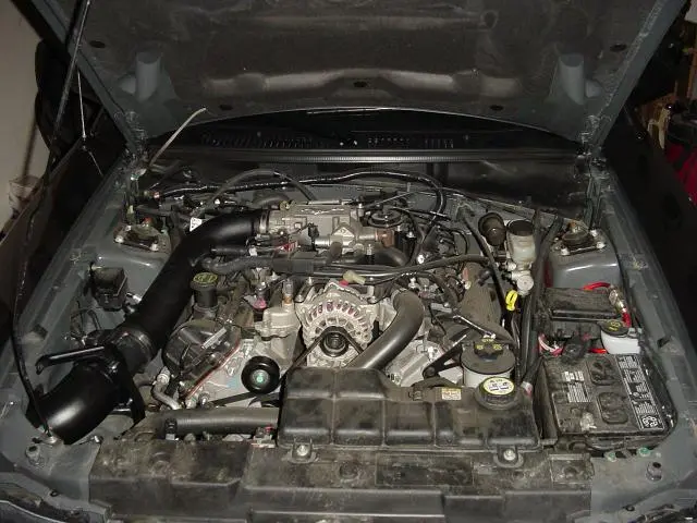

propellerhead said:
Here's my Roush CAI... nothing fancy, just the way I like it...
