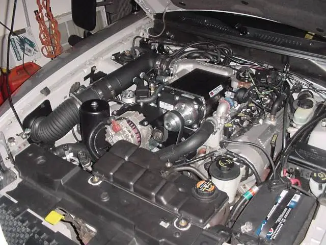

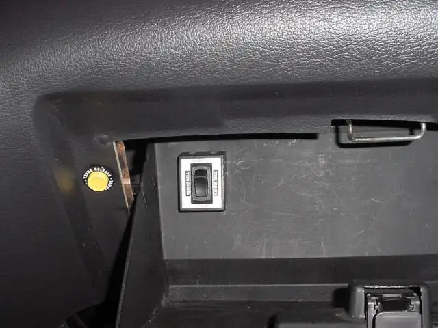

My KB is finally installed!!! :banana: :banana: All I had left to do this evening was fill up with coolant. Dan_Soprano had a really good idea on how to prime the IC pump. Remove the top hose on the IC reservior, pour in some coolant and then run the pump while blowing through the hole in top. Repeat the process until the coolant circulates all the way through the hoses. Kind of messy but it worked faster than the way KB suggested. I mounted my switch chip switch in my glove box. I'll post pics later if someone will resize them for me. Looks like it was meant to be there from the factory. This thing is a torque MONSTER! Man I love it!!! Everyone should be able to feel the power. :hail2:

Here a few pics...
