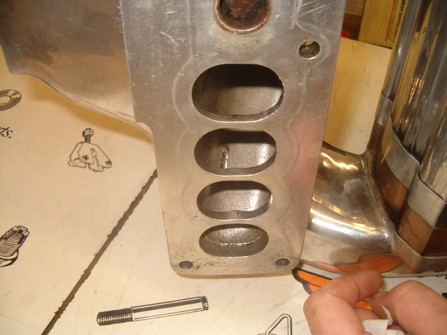

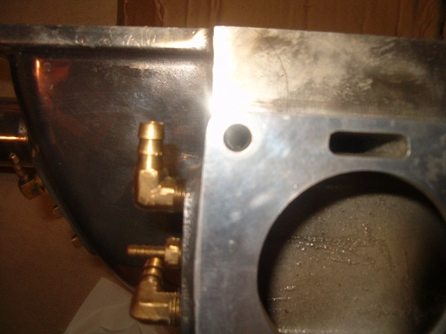

As you guys might know, I have had my KB up for sale for a while. Well someone bought it (he will remain anonymous unless he decides to post in this thread) and I shipped it last week.
So he called me tonight and said he saw some things that concern him and he wants to send it back and get his money back. I don't know what to do. I tend to think (1) he is overreacting, (2) that used parts can't be expected to be perfect, and (3) used parts are sold as is.
I never had any problem with the blower at all, and I never noticed the things he is talking about. I suggested he take it to OPCON up there and have them check it out and tell him if his concerns are valid, but he seems unwilling to do that. He wants to call off the deal after it has been executed.
So I don't know what to do. I want to do the right thing. Are his concerns valid? I need your all's advice

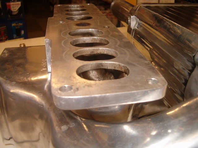

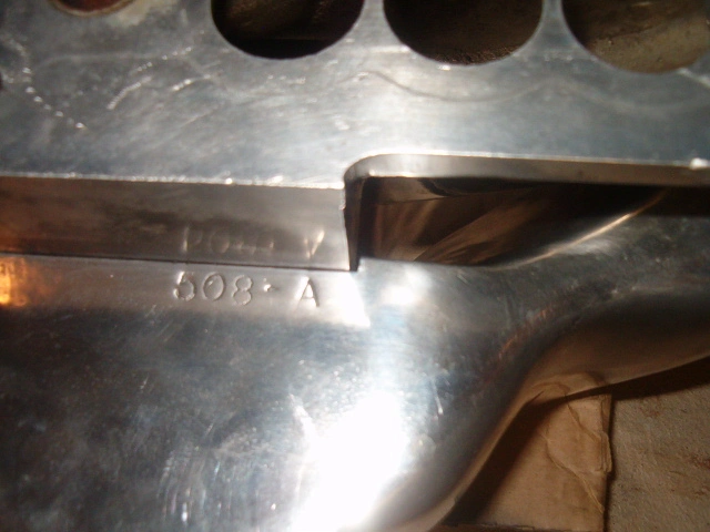

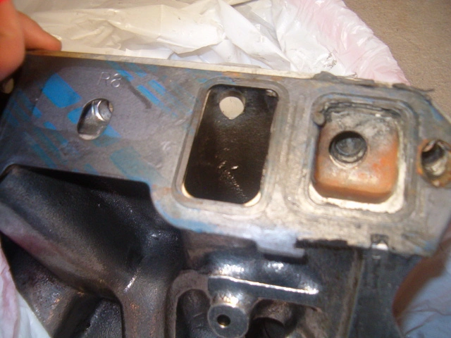

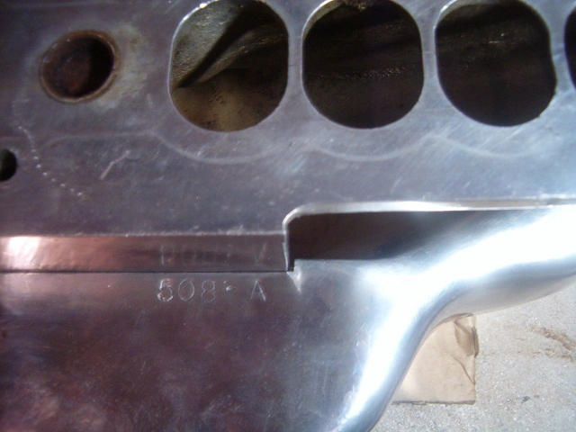

He says there is a crack in the metal between the #7 and #8 runners. Is this a problem?

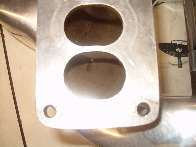

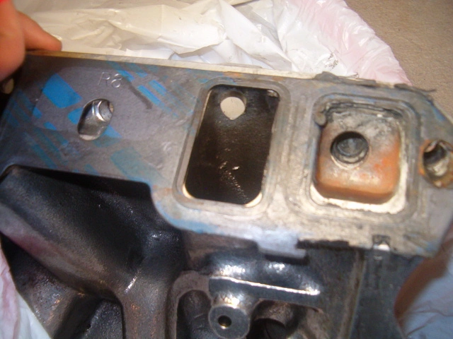

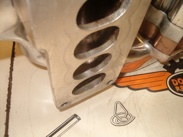

He says there is a scratch/mark in the blower above the #8 inlet and also in the lower intake #8 runner so he is worried something hard went through there and messed something up. Remember that at least 2 other people have owned this blower before me and it was rebuilt almost exaclty one year ago. Again, does this make the KB suspect.
The oil in the blower (from my blow-by) worries him.
Something about the inlet and outlet not lining up (?)

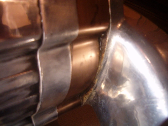

And he is worried about the dirt back here; he is worried it might be an indication of a possible leak.

i did not notice it when i had it, but i never looked that closely at it. did you see where it is? it doesn't look like a very big problem to me. what i mean is, after all, it is not like it is a place that might come loose, or cause a leak, or a stress point, or anything like that.

The crack is a non issue to me. That part that you show is just to show that it was intended for a stock lower intake. It has NOTHING to do with the functionality of the blower.
The scratch is another non issue. It goes from the blower to the lower intake on the #8 cyclinder. So, he can use his own stock lower intake if he's that worried. But I am sure he can see the entire length of the runner and see if there is anything wedged in there.
The dirt on the back again a non issue. Take it apart clean it and reseal it.

The runners can be TIG welded, I would only be ANAL about the actual blower unit itself not the intake, worst case buy another intake from KB

did you see the size of the crack and where it is? i never even noticed it. you can choose to believe that or not.
and it has nothing to do with whether the blower will work or not. it is not at a stress point or in a place that holds the blower in place or in a place that is in danger of causing a leak.

The crack in the intake concerns me a little. If it gives any when you push on it, I would fix it. If it's still solid I say leave it alone. Everything else looks like a non-issue to me.
Maybe offer to pay the repair cost for the intake if he sends you a receipt for it. Even if he pays for the repair himself, he still got an awesome deal. I wouldn't give him a refund.
Why not forward those pics to Kenne Bell and see what their techs think? Personnally the only thing I would be concerned about is the crack and would expect a little money back to fix the crack. I think you're right on with offering him money. But not too much, he already got a sick deal on it.
I would be concerned of the crack myself. That 2nd pic shows the crack almost to the end of the line if you will. Even though everyone is saying it's not a pressure point area and what not metal expands with heat. Well KB make a good amount of heat, so I could see that crack prossibly growing just by expanding and retracting during cold downs and running temps. But then the questions still becomes how in the hell did it get there to begin with. If you had no knowledge of it you have no responsability(sp?) in fixing it. I would offer to pay half of the repairs for the crack the other stuff is no concern.
