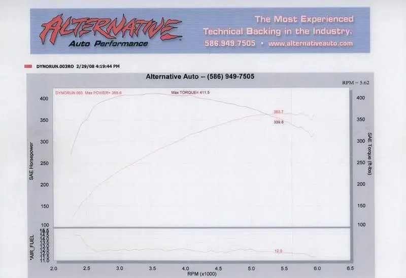

thats not my car so i dunno what the fuel system is.this is my chart
