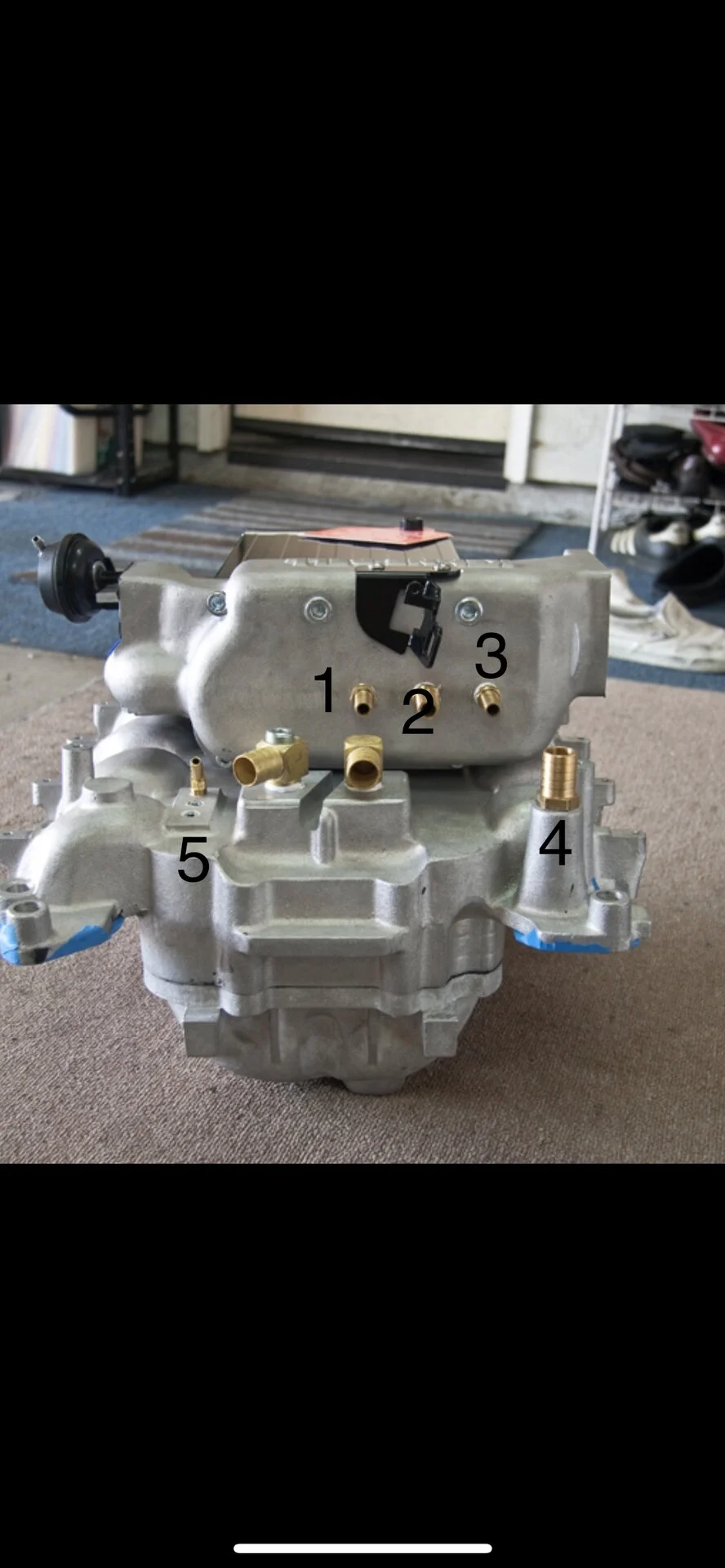

Random question, but some of my hoses are starting to rot and I can’t find a diagram or install directions anywhere.
Anyone able to identify each of these ports?

I looked around to see if I had an install manual for that year but I don't.
Number 4 should be for your brake booster. I think 5 goes to your fuel regulator. The largest of the top 3 should probably go to your vacuum tree and the other two can go to whatever needs a vac source.

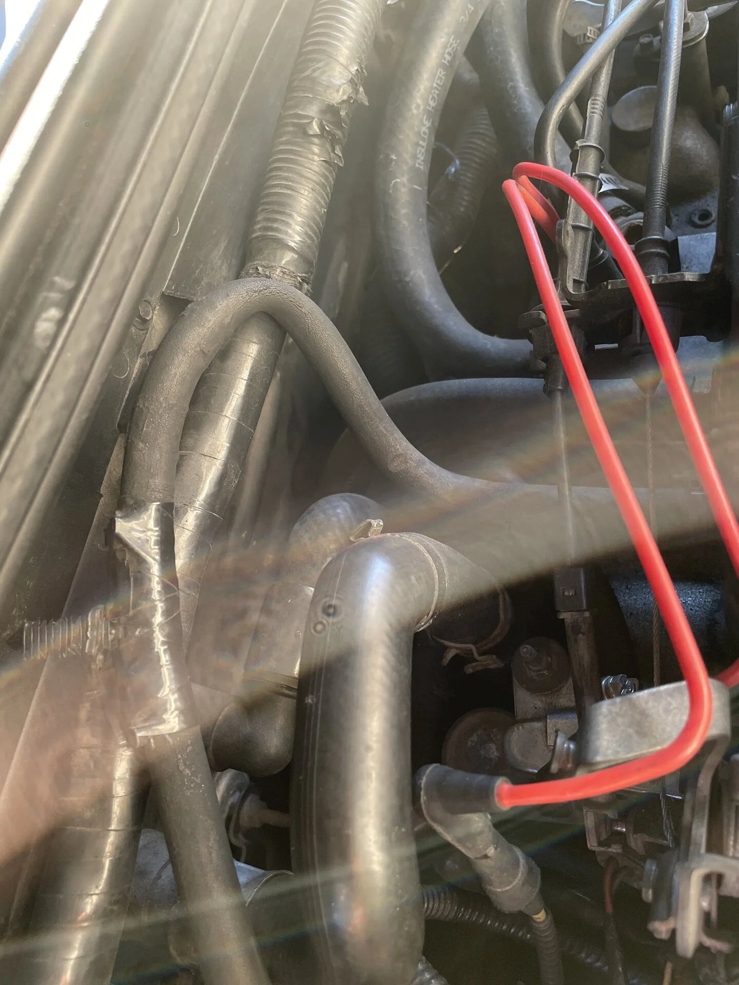

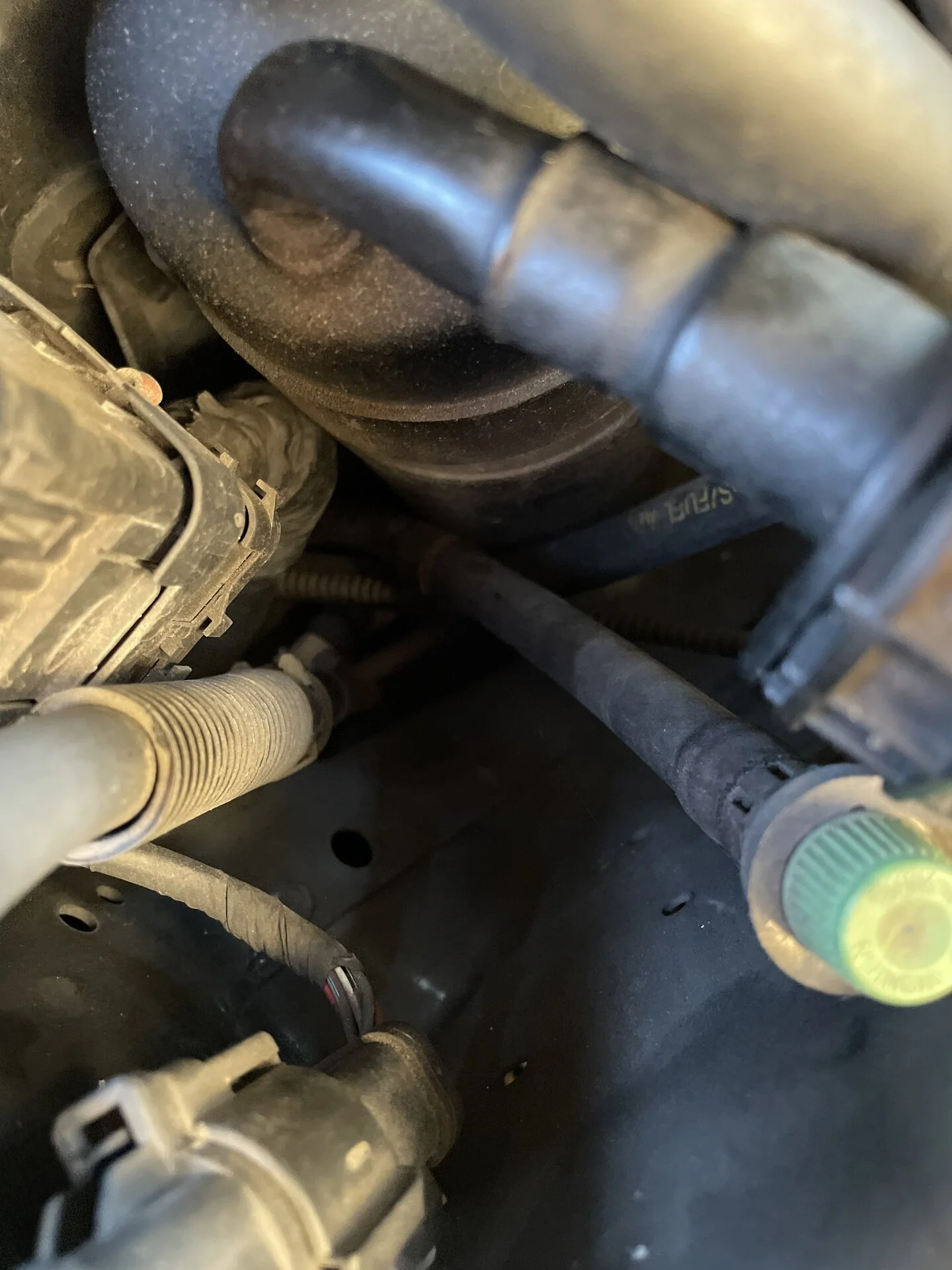

The hose in the worst shape says fuel on it, I follow it down and it disappears into the firewall, I didn’t have too much time to mess with it but I couldn’t find where it went from there. I’ll attach a pic.

It’s the one with that 90 bend in the first pic and the one that says fuel on it in the second pic, looks like a 3/8 or 1/2 inch line, I believe it’s connected to the #2 port but I’ll have to double check that. It doesn’t connect to my actual fuel line that runs from the fuel tank. I’ll have to get the car in the air and try to see where it goes to.
