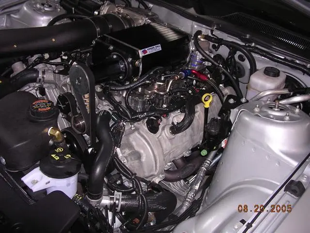

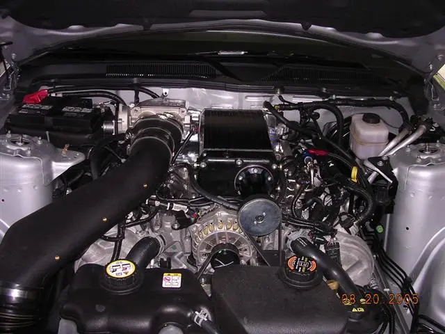

Just installed a 2.4L Kenne Bell protoype kit on my 05 Mustang GT. First off, I am in now way associated with Kenne Bell. Just a very happy customer and installer of many of their kits. :D
Secondly, the install was very simple and a direct bolt on. The supporting hardware wasn't difficult at all. The intercooler and BAP were all very easy. The kit includes a 90mm MAF, 39lb injectors, Boost a Pump, and all the hoses, fitting, bolts, etc. necessary for the install...it's complete!
Jim Bell already had a couple prototypes in some recent magazines. This is the follow up preproduction model. The 1.7L non intercooled, 1.7L intercooled, and 2.4L intercooled will be for sale in about a month.
It is very streetable and the variable cam timing adds to the lower torque curve tremendously. It's a monster at 14psi. I have it set on 10-11psi for the street. I'm sure this car is just as fast as any Kenne Bell 03/04 Cobra at the same boost levels.
I managed 450rwhp at 11psi on pump gas. A little race gas, a small bump in timing, and 14psi generated 505rwhp on a Mustang Dyno. On a dynojet, I'd bet we'd see 50rwhp more. Thanks to SCT for all their hard work on getting the tuning 100%. Also thanks to Kenne Bell, BSP and IDP for all their hard work on making it happen.

If you don't like the looks of the Ford GT, 03/04 Cobra, or Lightning engine, your not going to like this...they look very similar. Personally, I think it looks bad as$. Nothing like getting rid of the "LS1 style" stock upper and the capability of 24psi w/ built block. :D
So how did you get the kit exactly? What will the price be once it is released to the general population? How do you adjust the boost? Did it come with gauges? Are you going to upgrade the clutch, internals, or rear end?
I am going to put one in my car when they come out. I have an email stating that the kits will be released on Oct 1. Hope they are not late because my Mustang will be beddin down once the snow flies and I would hate to have to wait until March/April to drive her with the supercharger.
I am part owner of a performance business and we have the kit on our 05 GT business car. We have a 2.4KB on our 03 Cobra and we also had a KB on our 01 Lightning.
The stock bottom end will have a long happy life with 8-9psi. I'd recommend a clutch upgrade with 450rwhp and above. I have JBA long tubes, JBA catback, 60lb injectors, BAP, and an upgraded clutch and flywheel.
That is a very nice set-up for sure, but your comment about being as fast as any KB 03'-04'? :rolleyes: I am not sure about that one. The power #'s that you are getting (450rwhp) are less than my upper only stock blower 04'. I am sure you are aware of all this just wanted to let others that may not be too familiar with what KB or Whipple powered snakes make power wise. :nice: It does seem like the 05' has a lot of potential when it comes to forced induction. :cheers: Edit: I just re-read your post and noticed that you said at the same boost levels. You are correct about that, but how many of us running a KB or Whipple will run at only 11-14psi? Kind of defeats the purpose of having one of those blowers.
Very true, the 03/04 Cobra has raised the bar with 600rwhp daily drivers.
We normally see about 525rwhp on a dynojet with an 03 Cobra and a KB at 15psi on a street tune. We did 505rwhp with 14psi, that was my comparison. Pretty close, not exact. Don't get me wrong, the 03/04 Cobra can make a lot more power on a stock block...but I think the new 3v w/ variable cam timing is going to surprise a lot of people. 20psi and a built block is going to busy these cars in the 9's with traction and a good driver. :D

The 1.7L would be fine on a street car up to about 6-7psi. The 1.7L intercooled is great for those wanting to run 9-14psi or so. I think it's a great choice for a stock block car wanting 400-450rwhp.
