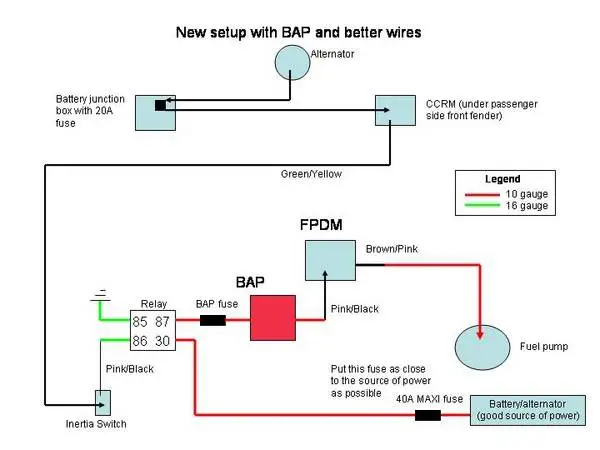

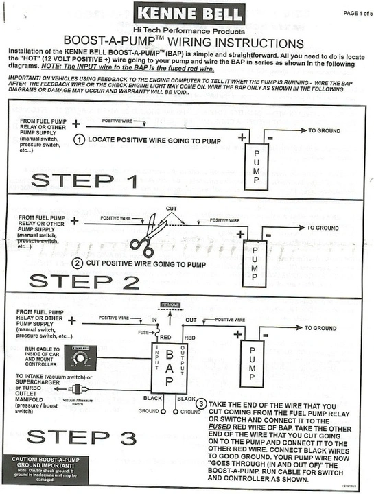

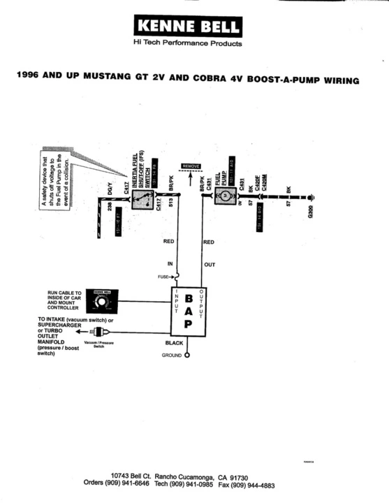

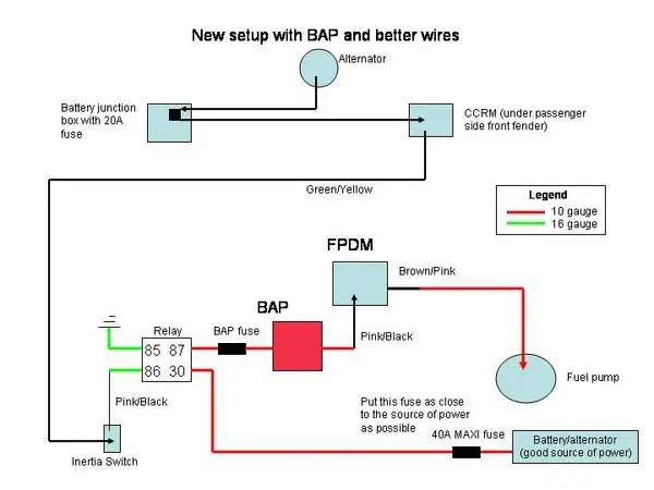

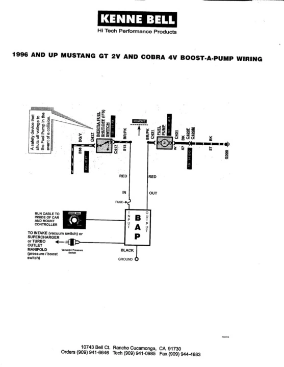

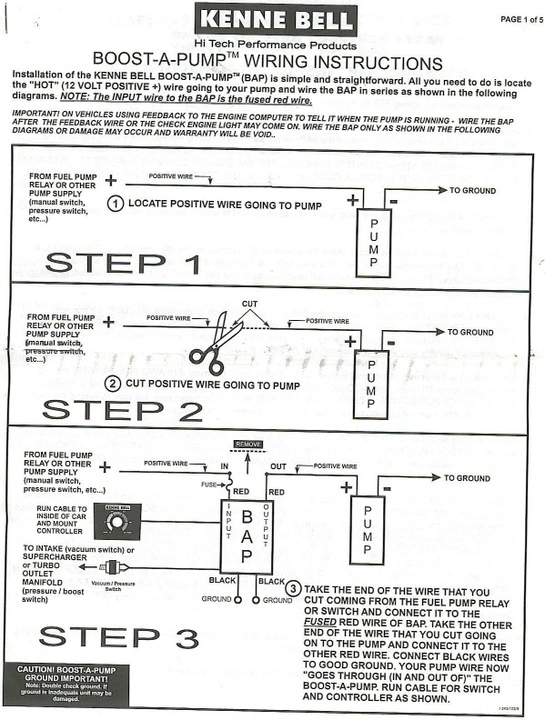

I strongly reccomend not wiring it per the Kenne Bell instrucions. Wiring it their way draws a lot of current through some pretty small wires and some people including me have trouble blowing fuses. The last one I blew, was at WOT and was lucky that I let off in time. It would suck to have a 30 cent fuse cost you a motor. Any way here is the reccomended way of wiring it.
