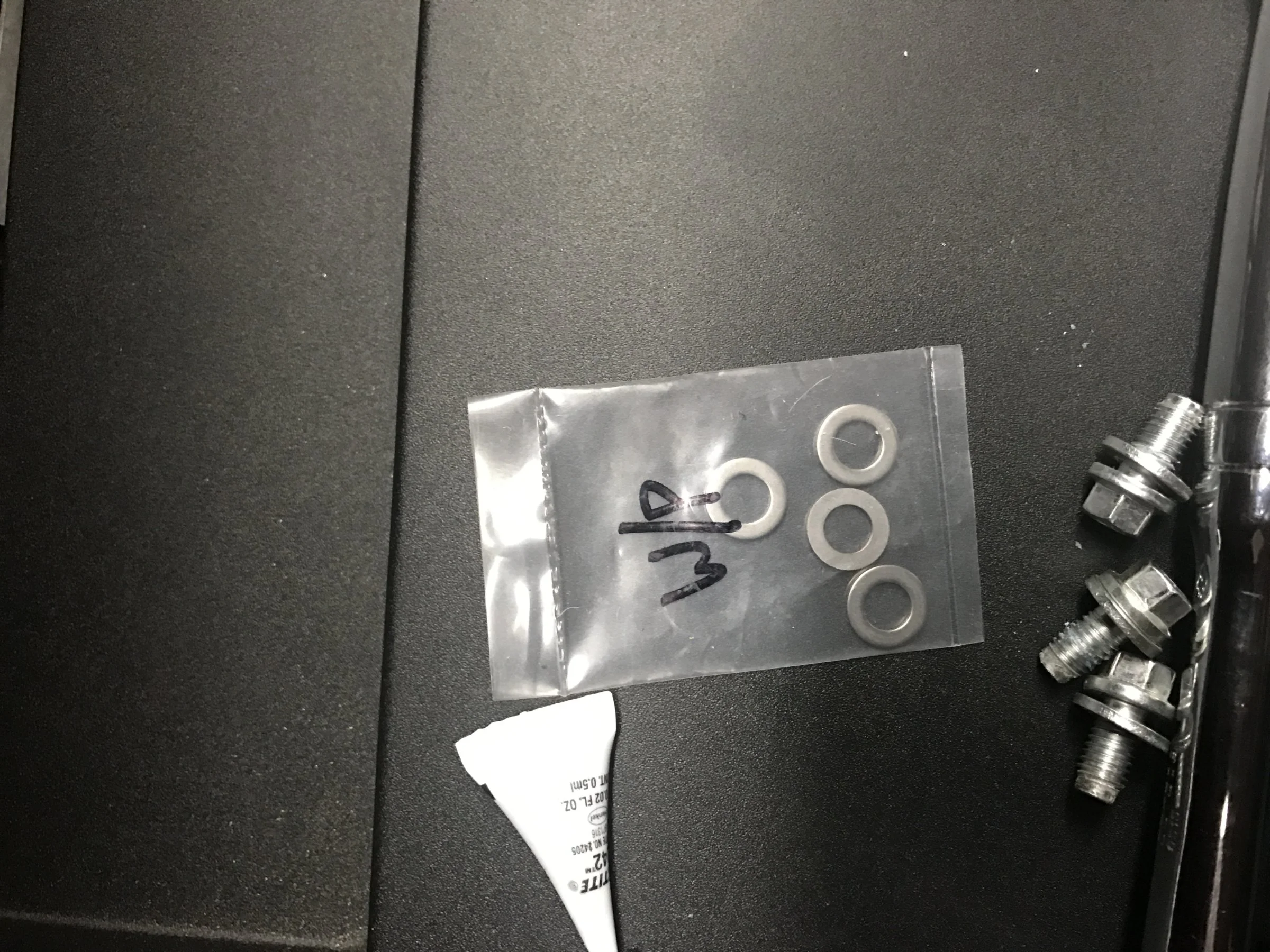

So the "kit" intailed 4 washers in a clear sac labeled "w/p" lol. Installed and am on my way to work right now and belt squeal is gone. So they said that Ford sometimes presses on the water pump parts harder on some cars and the belt rubs the side of the flanged pulley and that is what made it squeal this time around I guess
