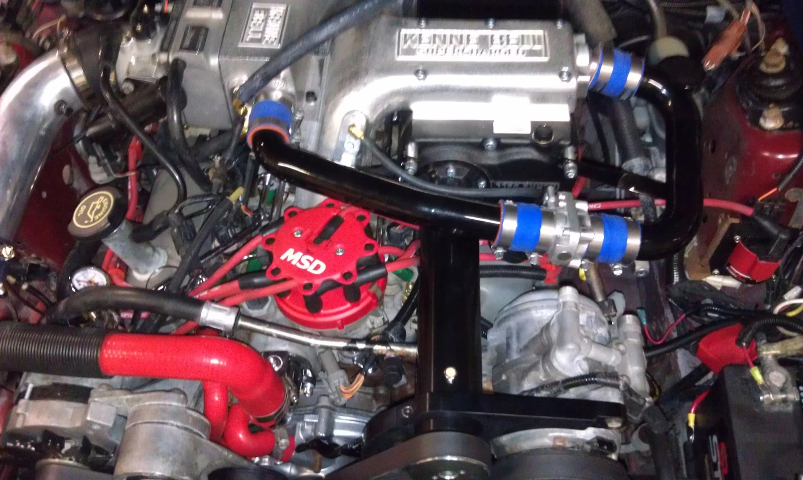

Here's a pic of the install. Now to get her started....:scratch:

Almost got her to fire tonight. Turned fuel pressure way down and put stock MAF back on. Definitely know it's too much fuel. Just not sure which change made the difference. Gonna put PRO M MAF back in tomorrow and see if that makes it worse....
