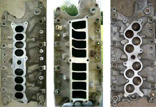

How will it possibly work with his GT40 lower when the runners are staggered, vs the stocker where they run in line? I don't even think they'll physically bolt together, but the bigger issue is going to be the runner alignment. It'll be so mismatched he'll never get it to seat up?
Just look at the differences between the intakes below (disregard the truck intake in the middle)

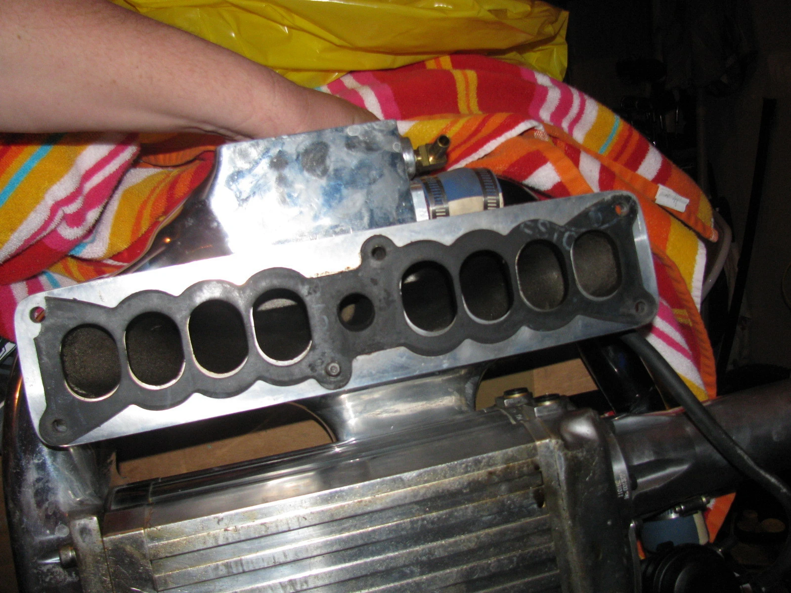

I was wrong on this, the bolt pattern is the same, but obviously the runners do not line up. i forgot that the Kenne Bell outlet manifold is not "open" and instead is runner specific. Should have looked at the one on my workbench before replying. Sorry.
I finally got through to KB. It is compatible but the snout and bracket have to be changed over for $359 and $75, respectively. The intake can be swapped out as well so it will bolt right up to my lower for another $500. So, by the time I buy the blower and convert everything over, it is going to cost more than a new blower with warranty would be. And, it just sold.
