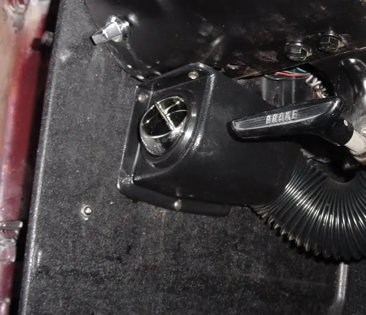

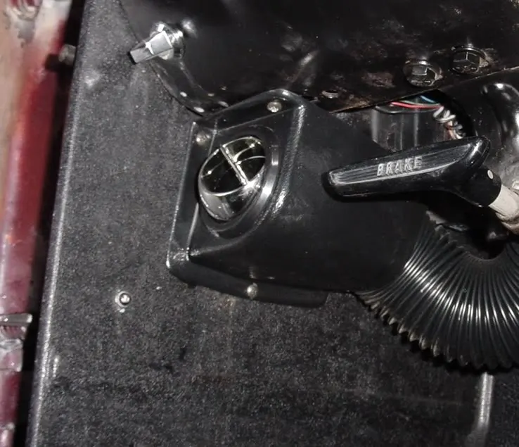

I have the Vintage Air Kit with the round under dash vents in the corners by the kick panels. I installed small 4" speakers in my kick panels with 3/4" spacers.
Anyone have the premolded kickpanels for 6 1/2" speakers? How much room is there from the bottom of the dash to the top of the speaker? I need about 3-4" for the vent assemblies.
Thanks.

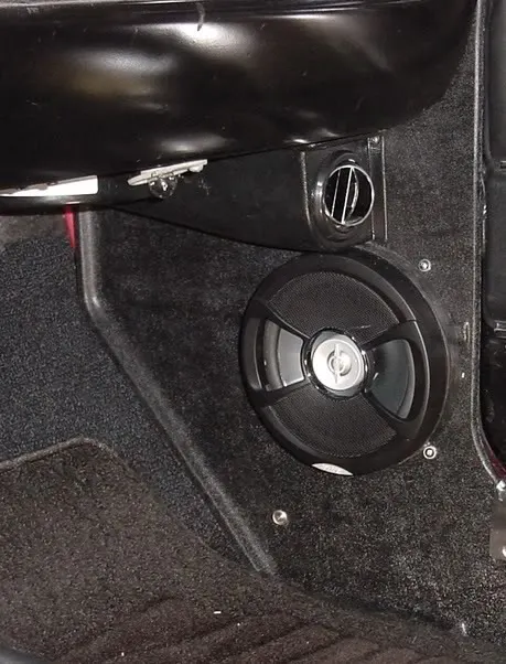

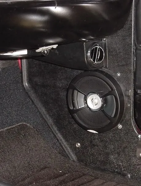

I bought a set of Infinity 6 1/2" Reference 6012i for the kick panels ($79)

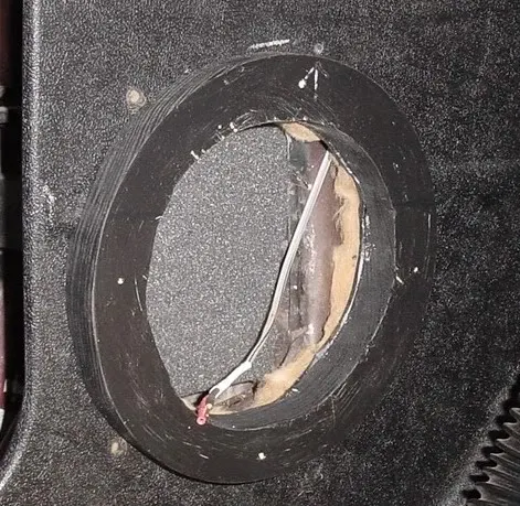

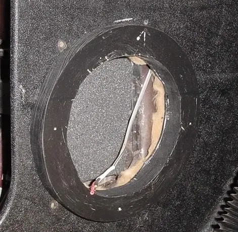

The install depth is 1 15/16” I was able to get away with using the same method I mounted my 4” ones in there using 3/4" wood spacer. The Magnet diameter was about 3/8” bigger than the door hinge plate access holes, so I did a little “percussion engineering”. That allowed the speaker to drop in place. The AC vents needed only a tad bit of trimming on the flanges.
Driver side spacer:
Pass Side complete:
BTW they sound GREAT and the price made me want to go back and get a set of matching 6x9s for the rear, but the Kenwoods I now have are doing ok. It'll be a while before I get the urge to add an amp & subwoofers.:nice:
