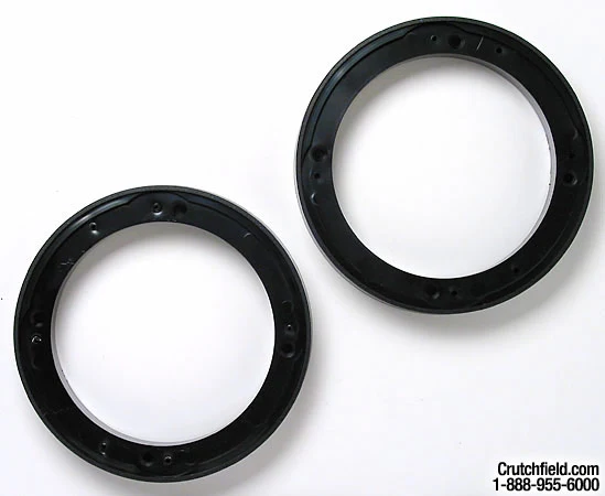

Found a pic....

Yes, you definitely need to wedge them for an angle up and toward you because they are only providing some mids and upper range sounds. Those sounds are directional unlike deep bass where it doesn't matter. Think about it; when you hear a loud stereo beside you in traffic, what do you hear? Boom, boom, deep bass. You don't hear much of the upper range of sound because it is directional and needs an uninterrupted path to be heard. The ceiling medallions are a bad idea unless they are angled somehow. Sorry, Chelle, I love you anyway.
milner351 said:
Ideally you'd use those over some kind of wedge to angle the speaker up and out toward the center of the car... .otherwise, you're wasting that sound on your ankles...
