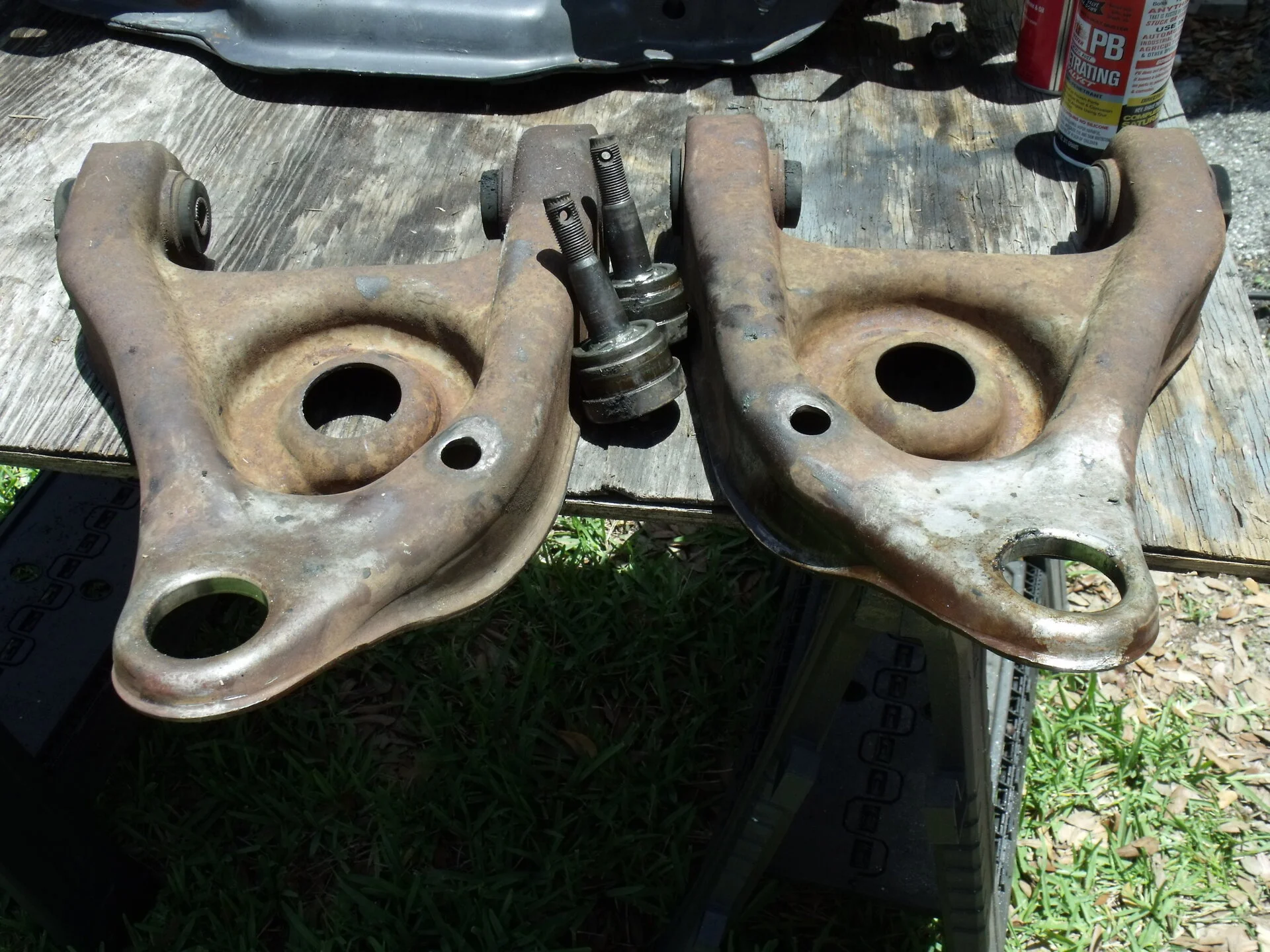

If it works as well on the bushings, as it did on the ball joints I might have a shot of Gentleman Jack tonite to celebrate....
Lost my shade and it got hot ( florida) so the attempt on the bushings will be later this afternoon/early evening....
Stay tuned......

I ended up using my ball joint tool to do the bushings on the control arm for my SN95 last year. It worked ok. I made some spacers to keep the control arm flanges from bending in. LOL I started watching season 4 again last week myself.
Well, it looks like my ball joint remover will not work removing the bushings... at least not with what I have.. The "C" frame flange needs to be bigger or the parts smaller... darn it..
I remember trying this on a press or a vise one time and having the same problem with the flanges bending inward.... I went to a muffler shop and the guy cut me some exhaust pipe the correct size and that fixed it....
