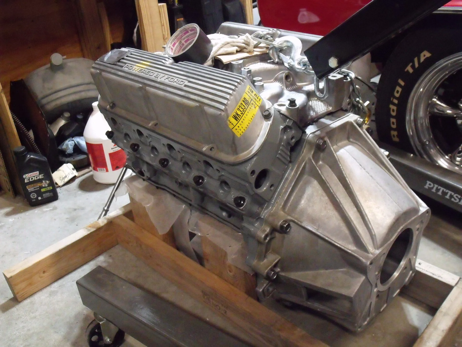

It actually has two engines, just not installed.
yeah, but this is the expensive one, at least compared to the other two
