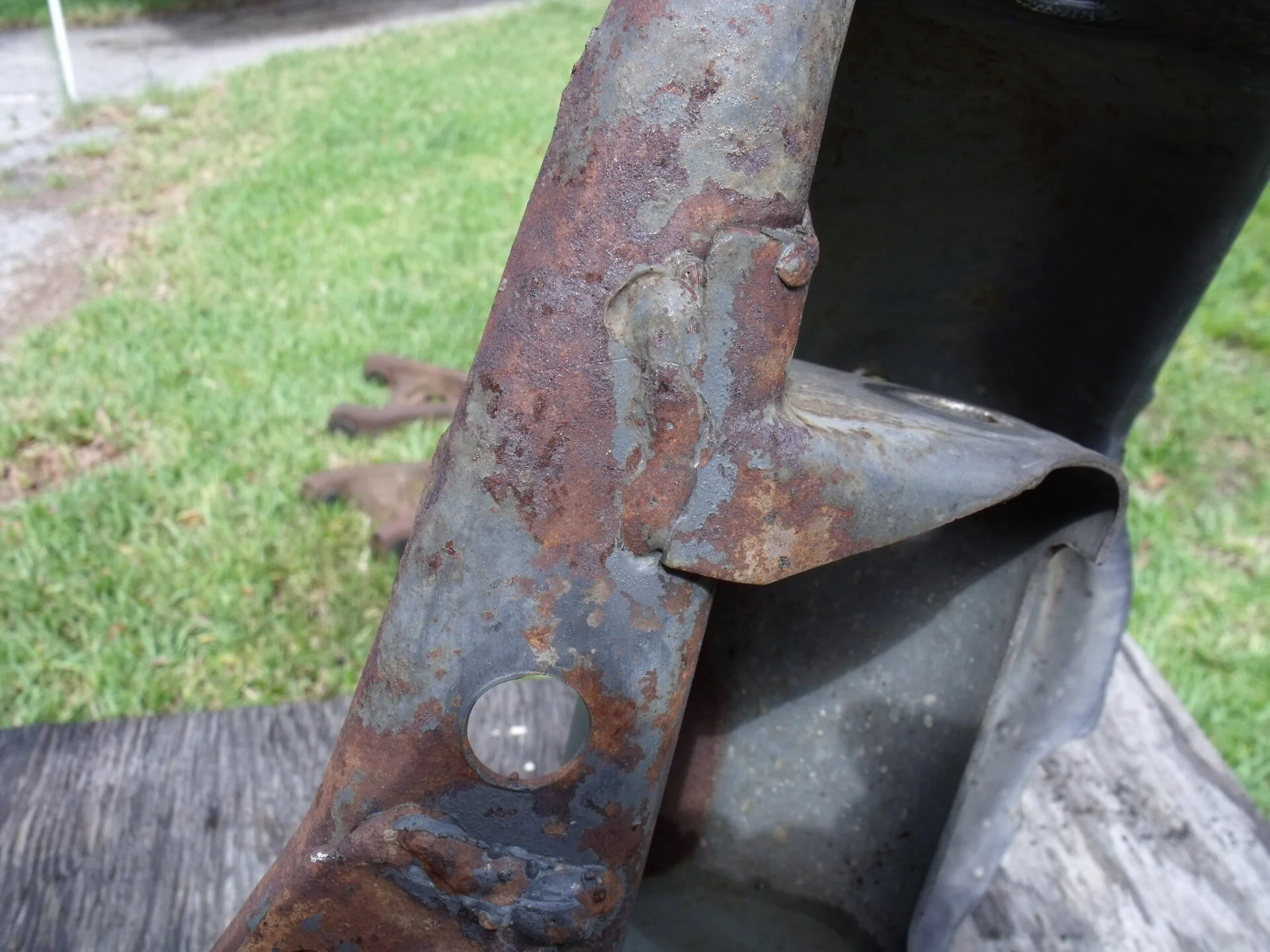

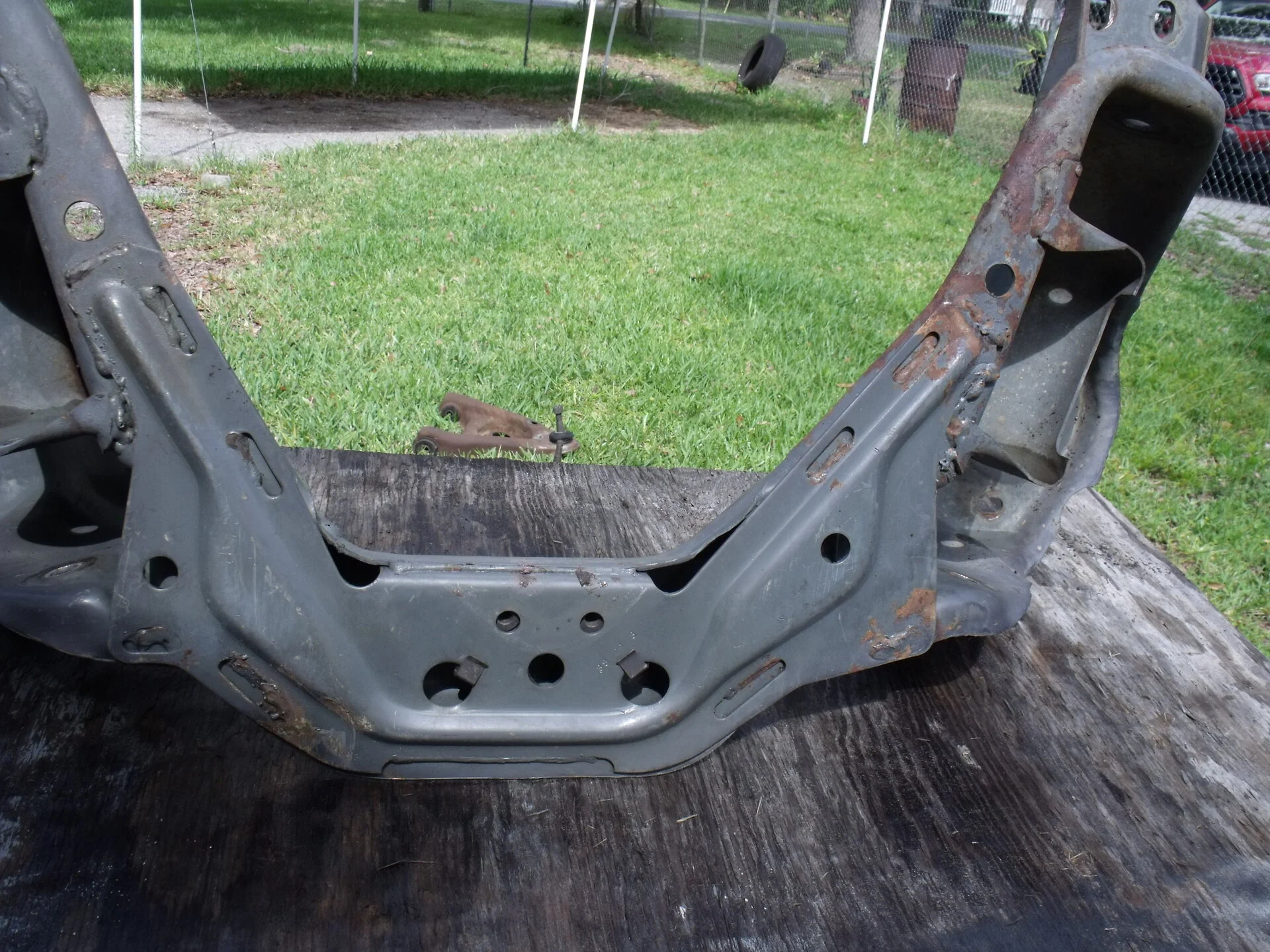

Here is a shot of the k member after a couple of pressure washer going overs... HOpefully you can see the paint color... I kinda like the gray.. Will paint the A arms black... You can see one of the spots of superficial rust which was the main reason to remove the K member, making the job much easier..
There are some surface rust areas in the engine compartment that I want to wire wheel and paint, mainly around the radiator area that I can now stand in the engine compartment and address easier too.....

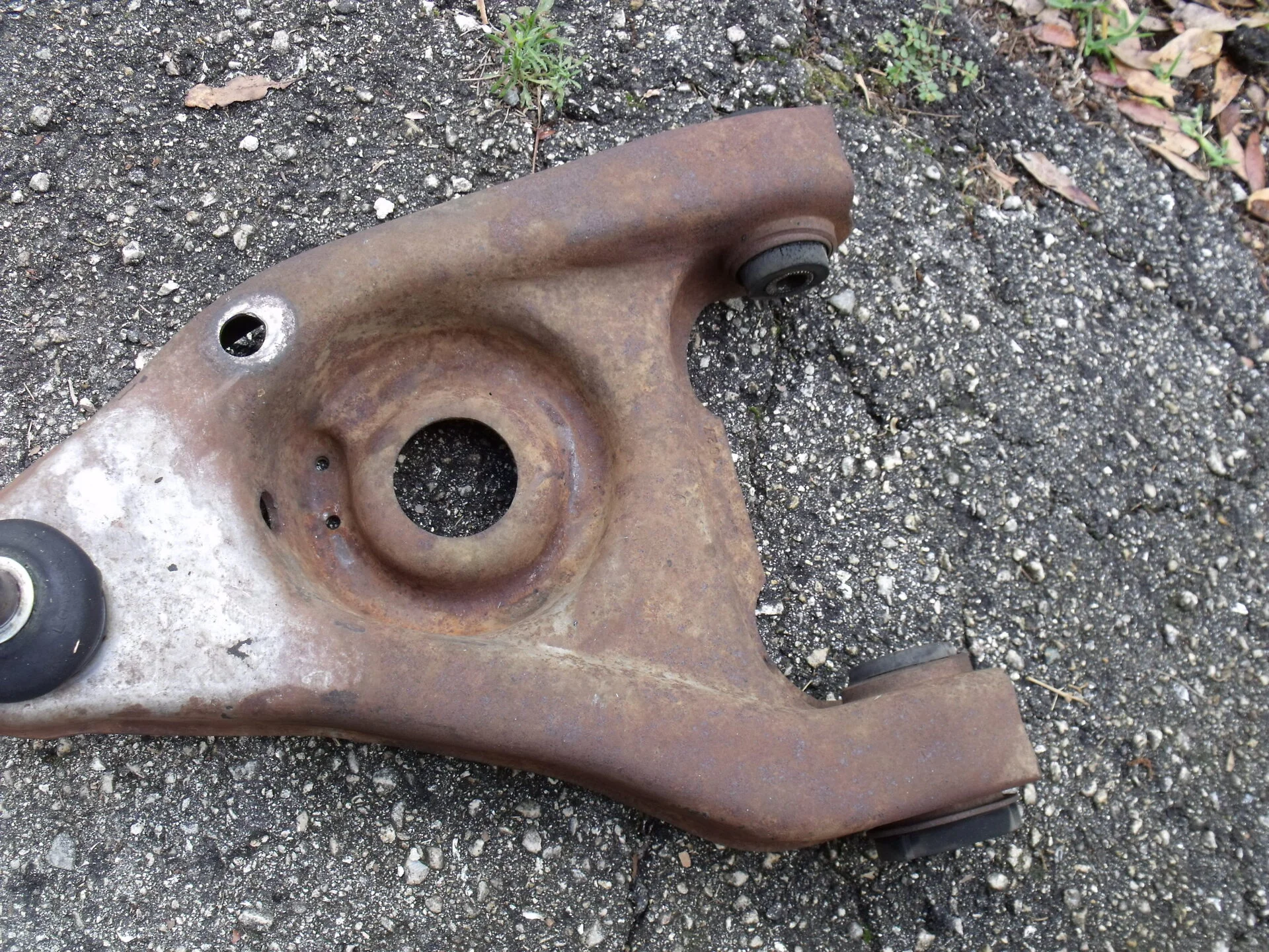

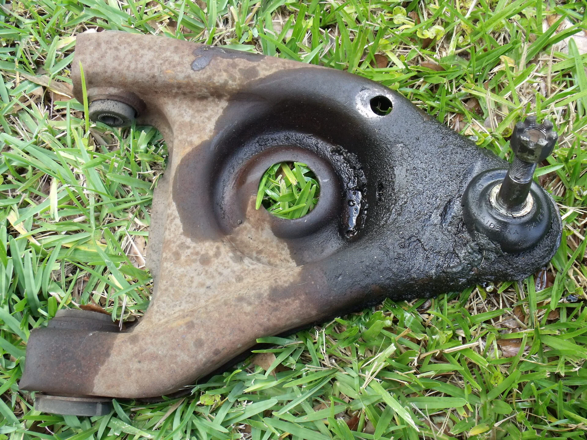

The A arms have always been on the list to wire wheel and paint... They must come bare metal from the factory.. Look how the grease stopped any rust buildup.. Before and after pressure wash.... Have I said how much I like my pressure washer ( old thread)....

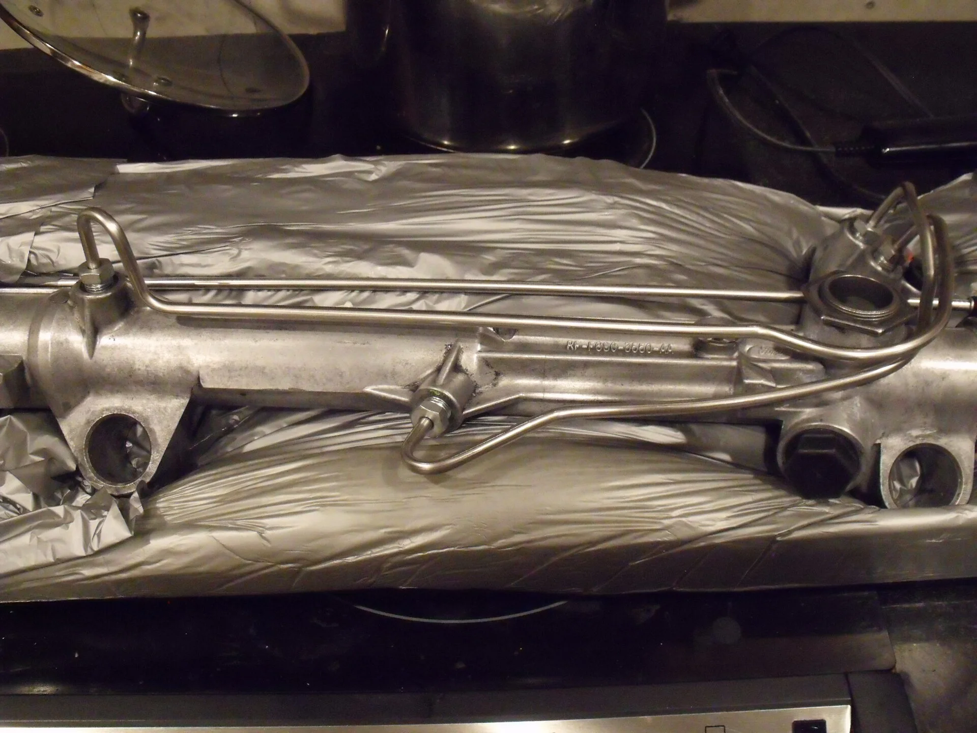

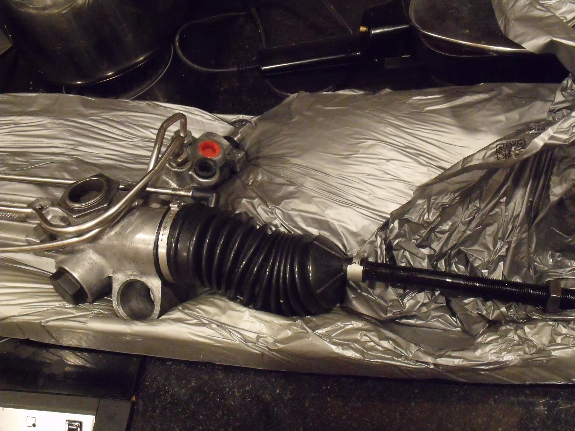

When the K member goes back in I want to install the hybrid steering shaft to my 03 , turn one rebuilt, rack before the engine goes back in too...... Yes, those are new stainless lines on the rack. Good thing my son is out of college....... LOL

That's exactly how my K-member looked when it came out. That's the Ford E-coat that the entire chassis is dipped in before paint. There was body color on it, but not much.
Not that it matters but usually there is a date stamped on the K-member on the bottom. Mine was dead center where those 5 holes are, but some have seen them out near the A-arm mounts.
I will check on the date code... I know my sister ( original owner) was hit a couple of times by DWO's in San Fran with it... Lets see if its original.....
In the center area where the 5 holes are it is stamped 38 21 3
If you go down to the left about 7 to 8 oclock from there, almost to the outside lip, it is stamped..... 4 11 83 .......
