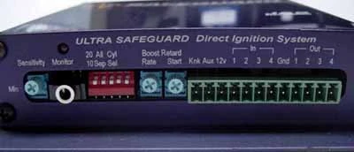

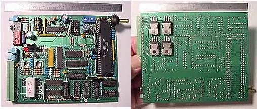

We are working on an eight coil version.
We have one for the two coil Focus and the early four coil 4.6's.
Here's the install diagram and text for the two coil Focus unit:
http://www.jandssafeguard.com/FocusInstall.html
photo of four coil unit:
