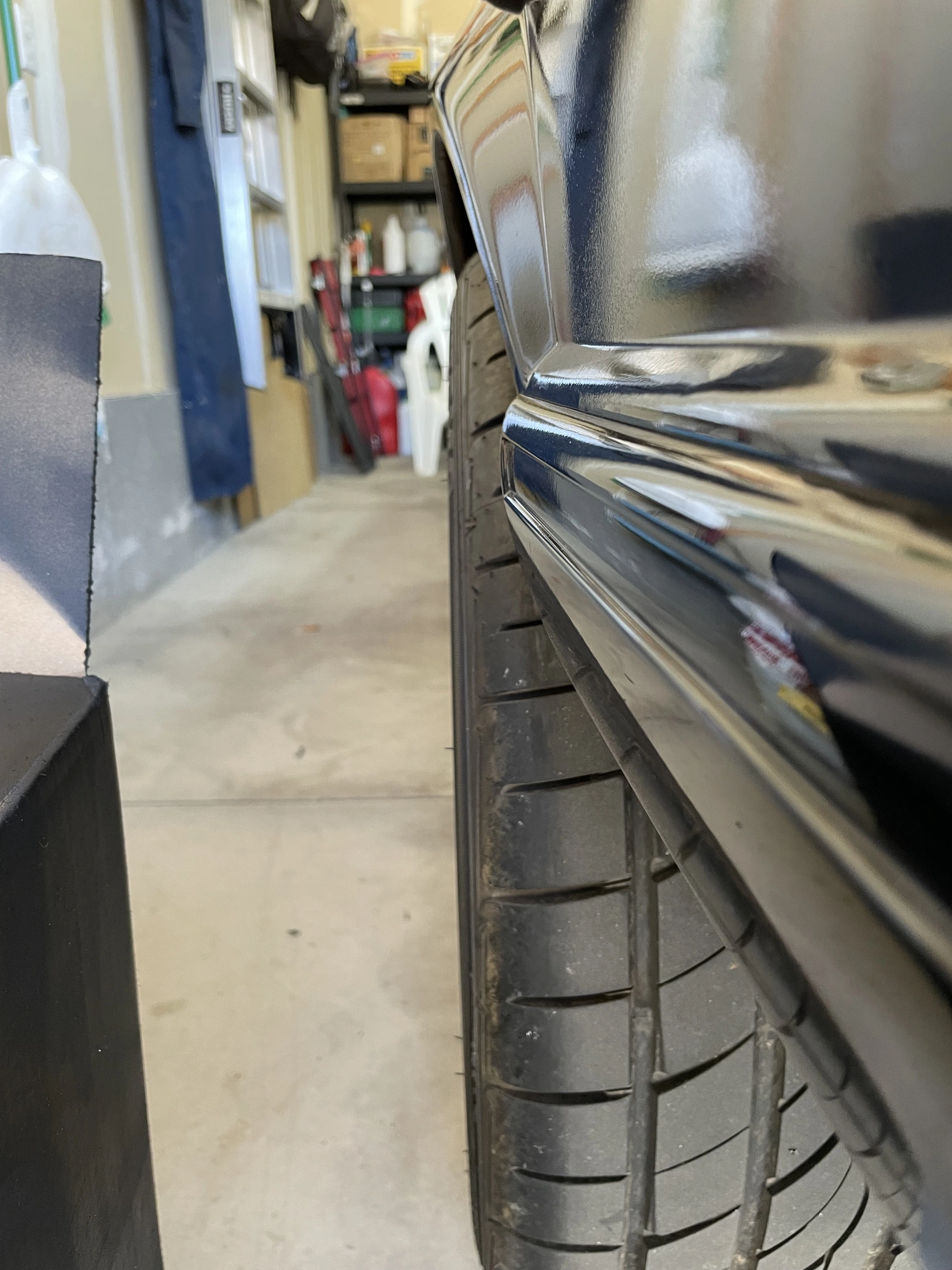

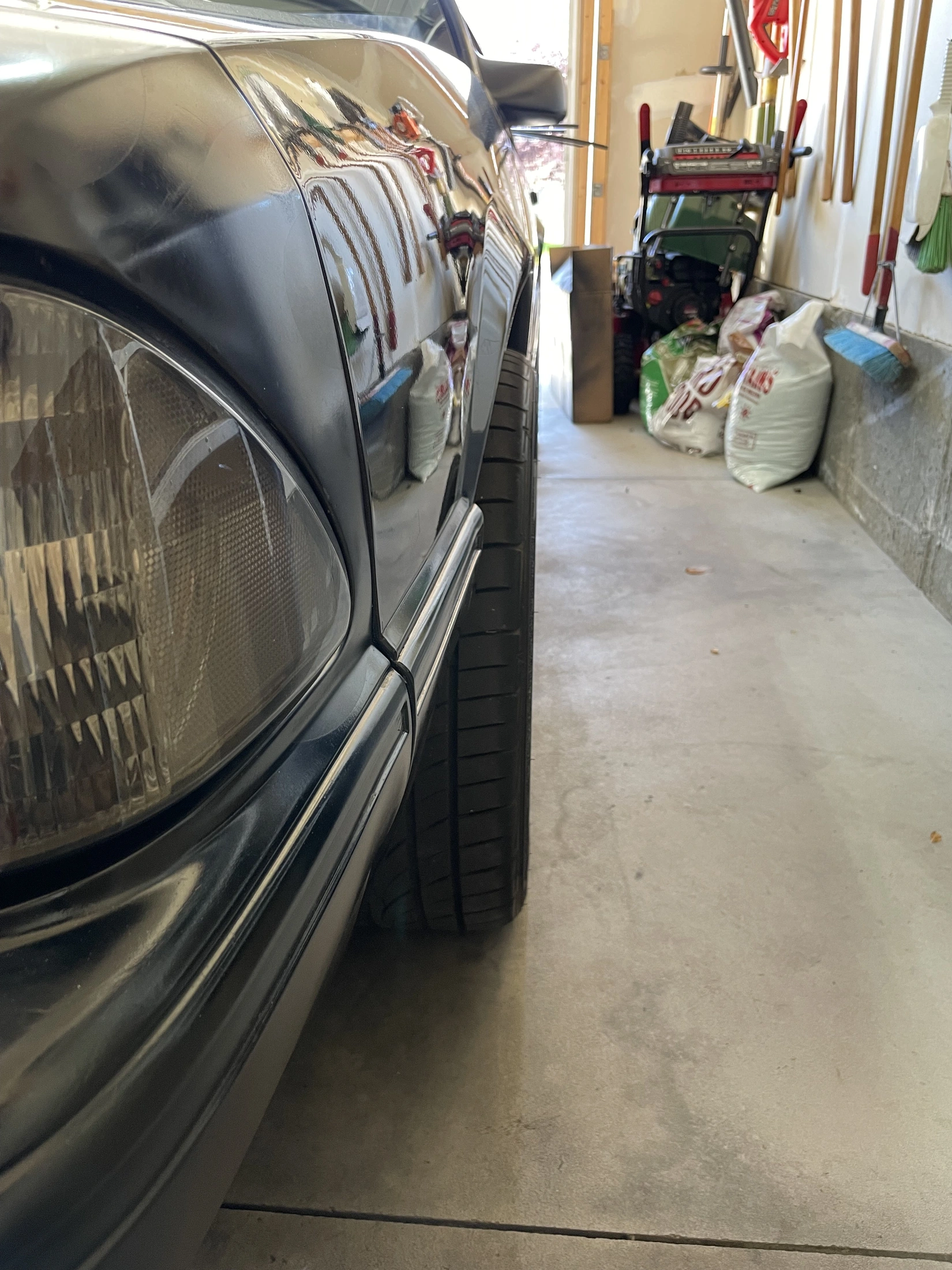

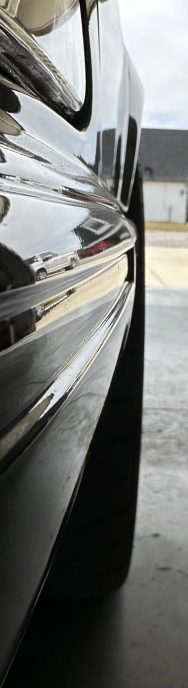

I’ll take a photo looking down the side of the car, I just realized the pictures above do make it look like they stick out, but they are really more in line with the fenders. I think the ‘look’ is perfect, just need a little more clearance. I don’t know the offset on the new edge GT wheels, surprisingly there isn’t much info on them that I can find.
I like them for the looks, but also heard they are one of the lightest OEM mustang wheels, could be myth tho.

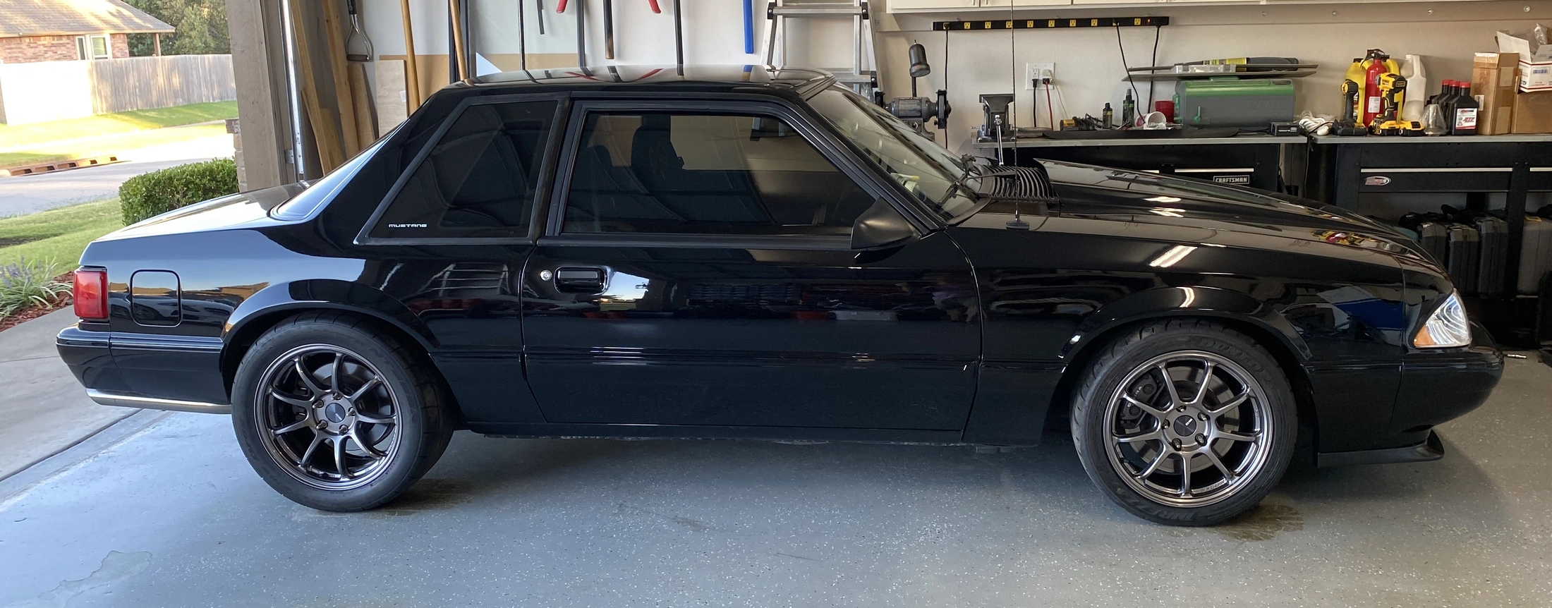

I run 245/40R17’s up front on a 17x8 wheel with a +35 offset. In the rear I run 275/40R17’s on a 17x9 wheels with a +45 offset. Zero rubbing and the car is pretty low and has a SN95 width rear end. This was with the stock front suspension and now with a MM K-member and zero offset control arms.
The picture you show makes the front wheel look like it’s not centered in the wheel well? Then again it could just be that it’s a taller tire.

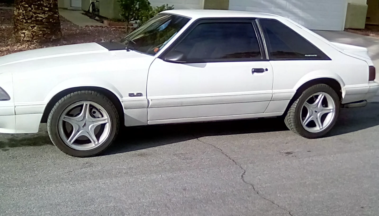

Do you have some pics? I'm curious about the look. I'm planning on getting 17" ponies...8s in the front and 10s in the rear.

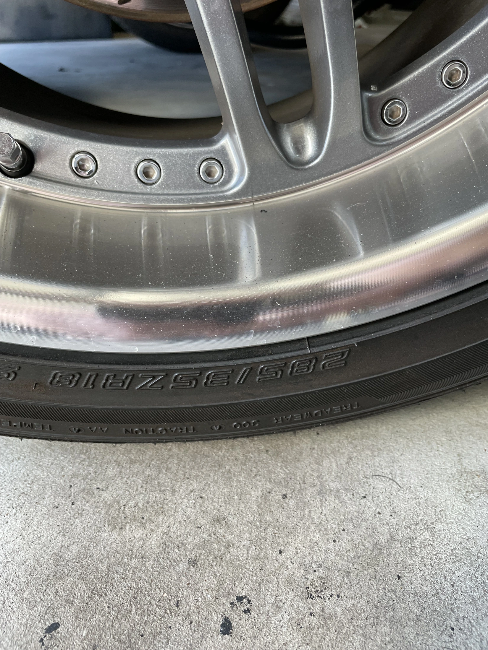

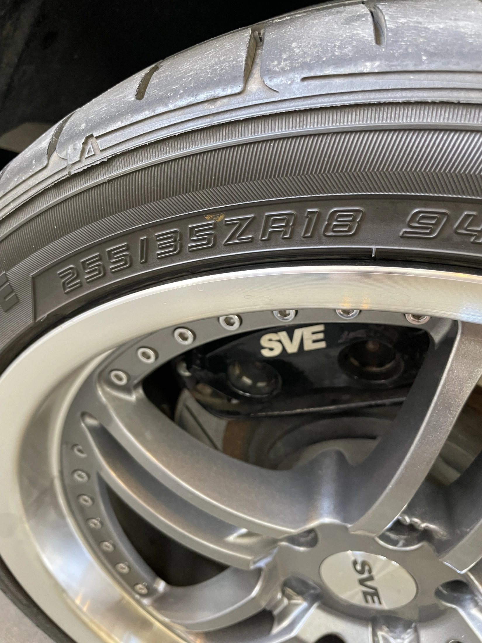

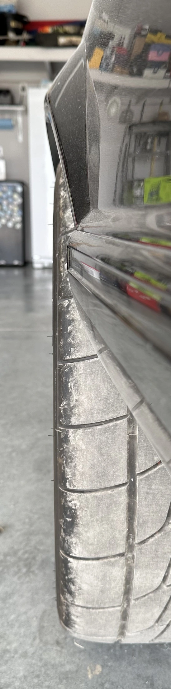

Here's what I currently have. 11s in the rear and 10s in the front. 18" rims. As you can see in the pics, the rears clear but the fronts do not. Not sure why the previous owner tried fitting 10s in the front. It runs the risk of jacking up the fenders right now. New rims and tires are happening this winter.
Rear tire size
Front tire size

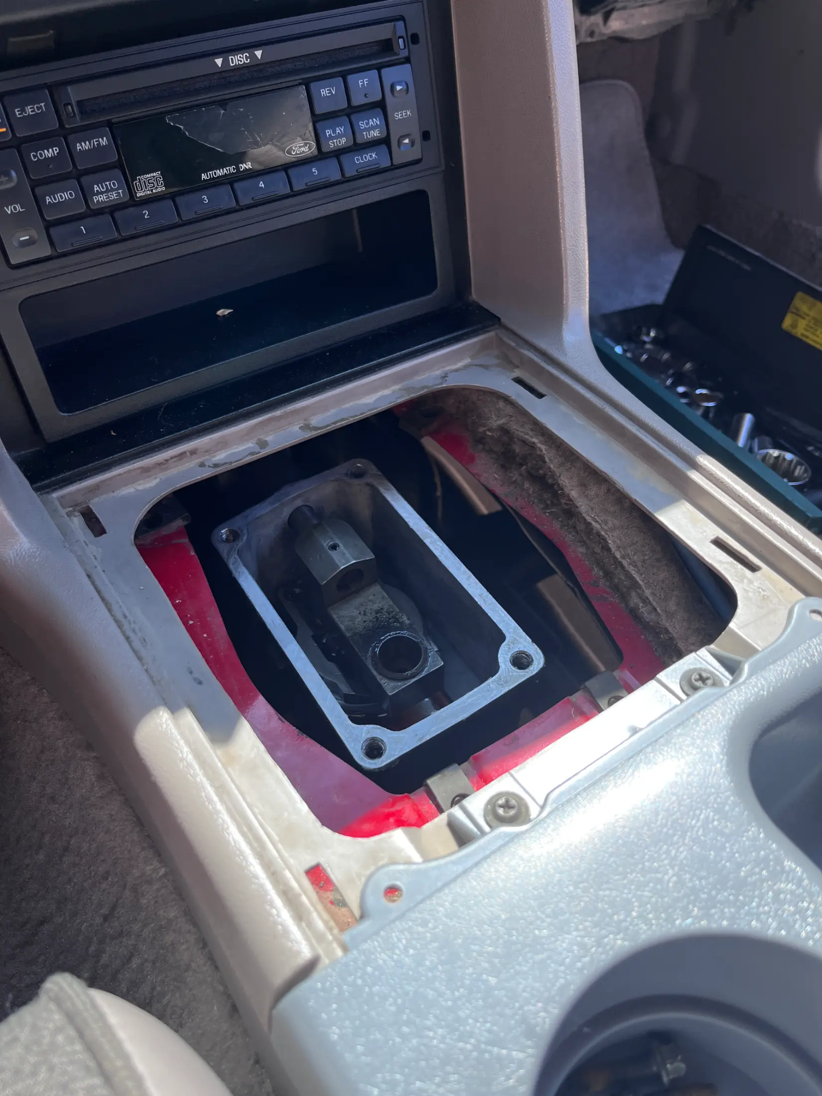

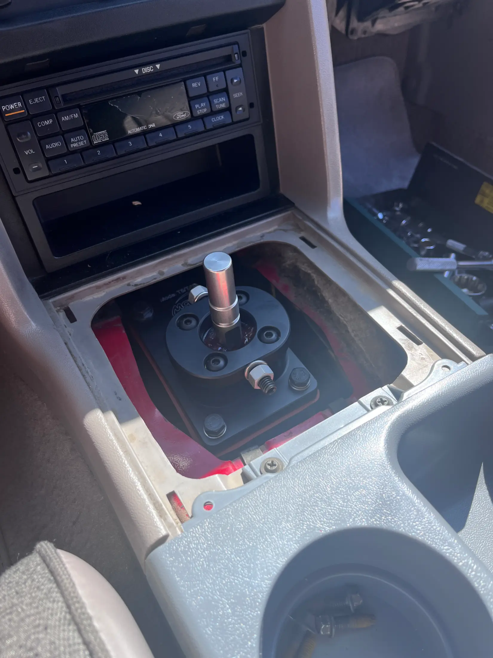

Started the MGW short shifter install while my kid was napping:
Old one out:
New one in:
That’s as far as I got before she woke up. Just need to put the stop screws in, finalize handle position then put it all back together.
I used the MGW rubber gasket. Tightened the bolts down just enough to where I saw the gasket squeezing out slightly… is that still too tight?

I think most people just throw some RTV on it instead of a gasket.
Got the set screws done, shifter is back on, car is driveable at least. I was hoping to not have to take the entire center console out but for the life of me I cant get the two back bolts that hold the main cabin to outside boot and metal bracket on. My fingers just won’t fit… which is weird cause I’ve done a MGW short shifter on a fox before without removing it.
Kind of works out I have to remove the cup holder piece to adjust the ebrake assembly, and it could be a good time to clean everything up.

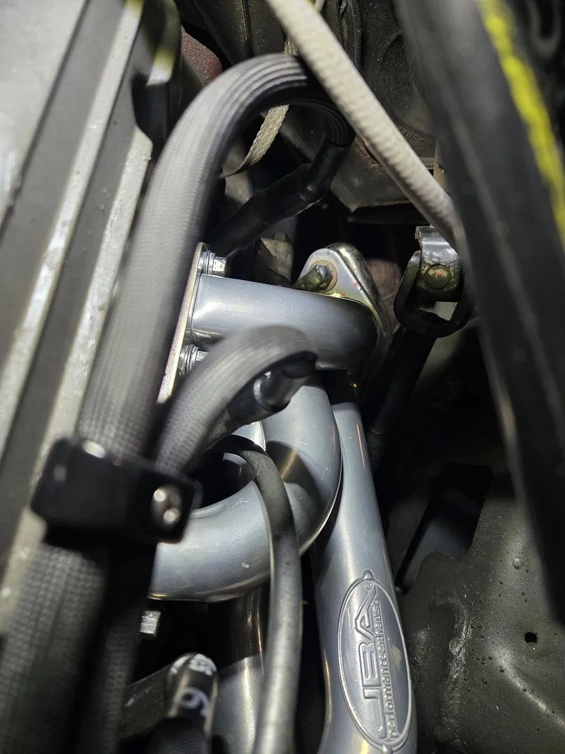

I see you have JBA headers. If yours are the same as mine they can be a pain because they use a bolt dropped down through the header flange. When you tighten or loosen the nut on the bottom the whole bolt spins. So you have to get a wrench on the top while you turn the bottom.
I welded a tab to the head of the bolt so it catches against the header body and doesn't allow the bolt to spin. Really makes the whole process easier.
If yours are the same you could do that after you get them out. Next time the h-pipe has to come out you'll thank yourself.
