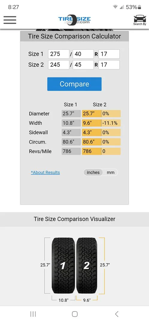

Well I just realized what an idiot I am. I bought 275/40/17’s for the rear wheels…. THOUGHT I bought 245/40/17s for the front but I bought, received and had mounted 245/45/17’s…. Is this gonna look goofy as hell? Should I have them swapped out? I’m sure they would I haven’t done anything with the tires just brought them home and put them in the garage.
Edit: nevermind they are almost identical in diameter, should be fine.
It will look great. That's what sizes come in LMR's 8/9" wheels package.
The backs are wider so the sidewalls end up very similar betweent the two. If running staggered you actaully want different aspect ratios front and rear (assuming you want the same tire height front and back)
Reactions: gkomo and Noobz347
Thanks for the reassurance. I had a little freak out but then remembered I ordered them those sizes because those were the same sizes that were already on the car.

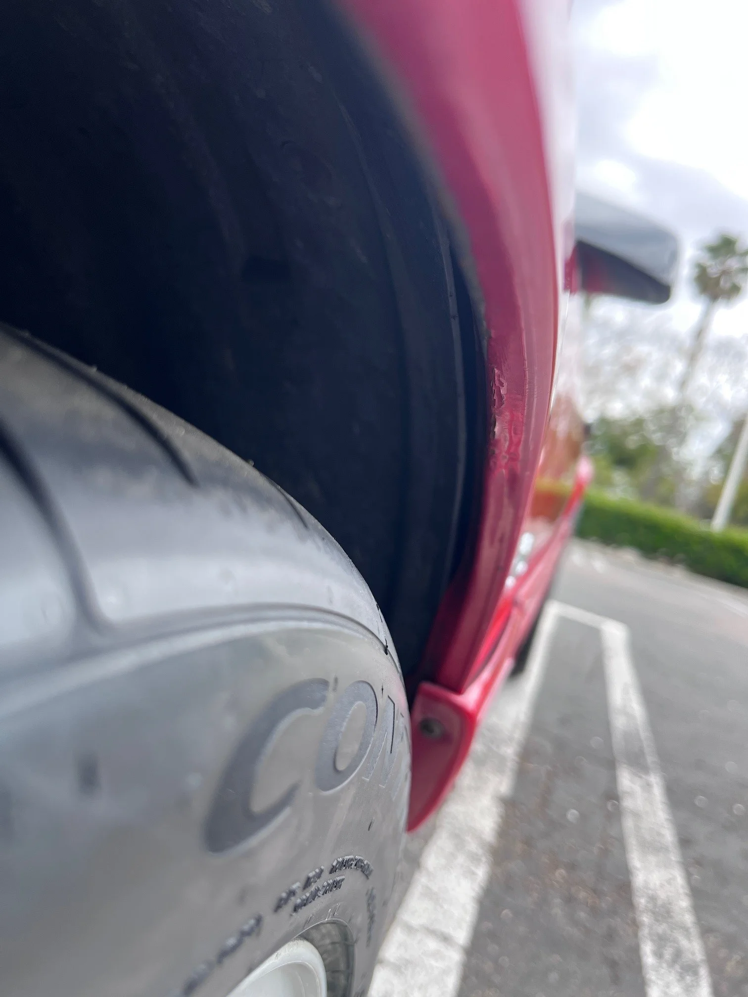

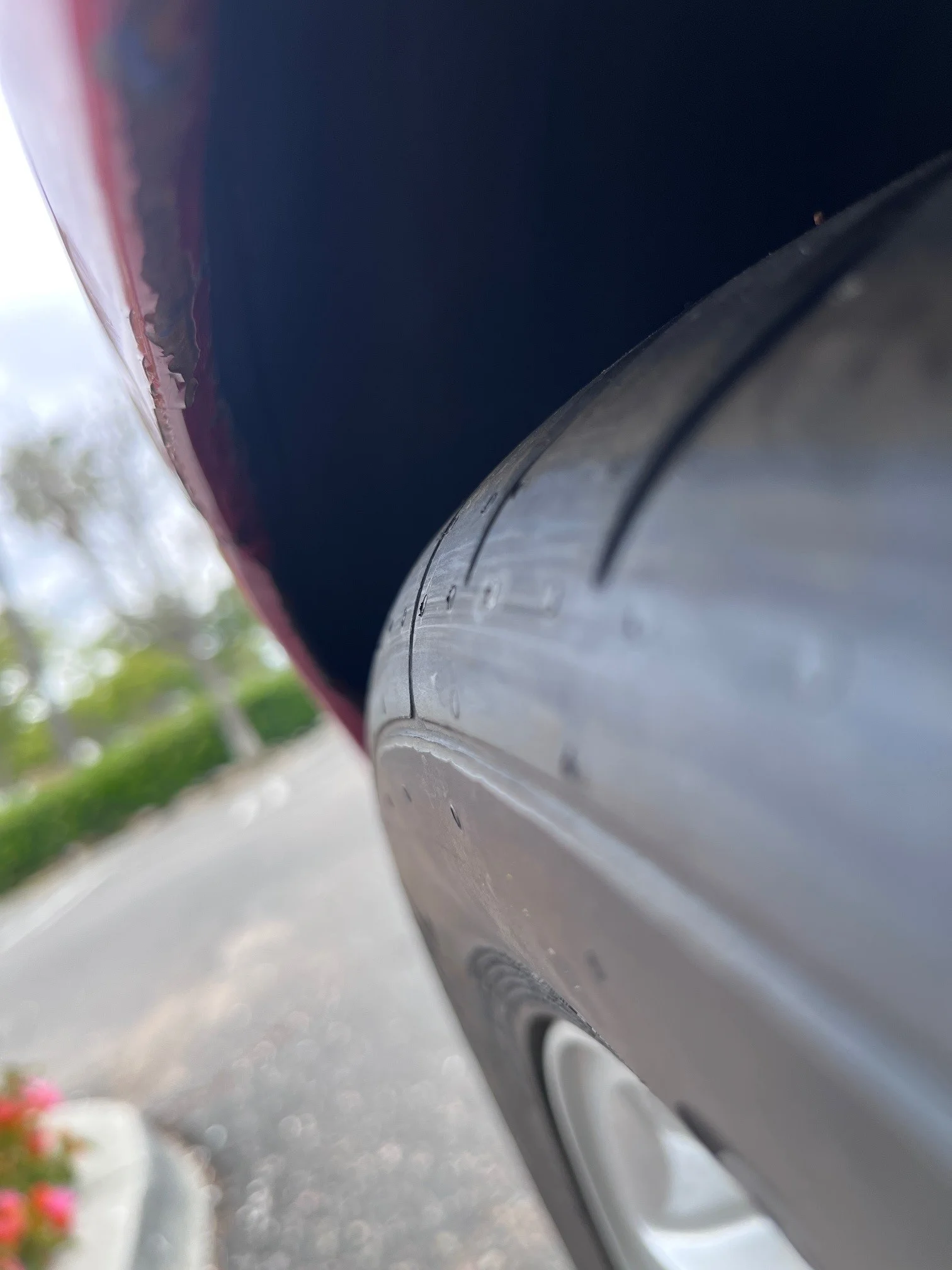

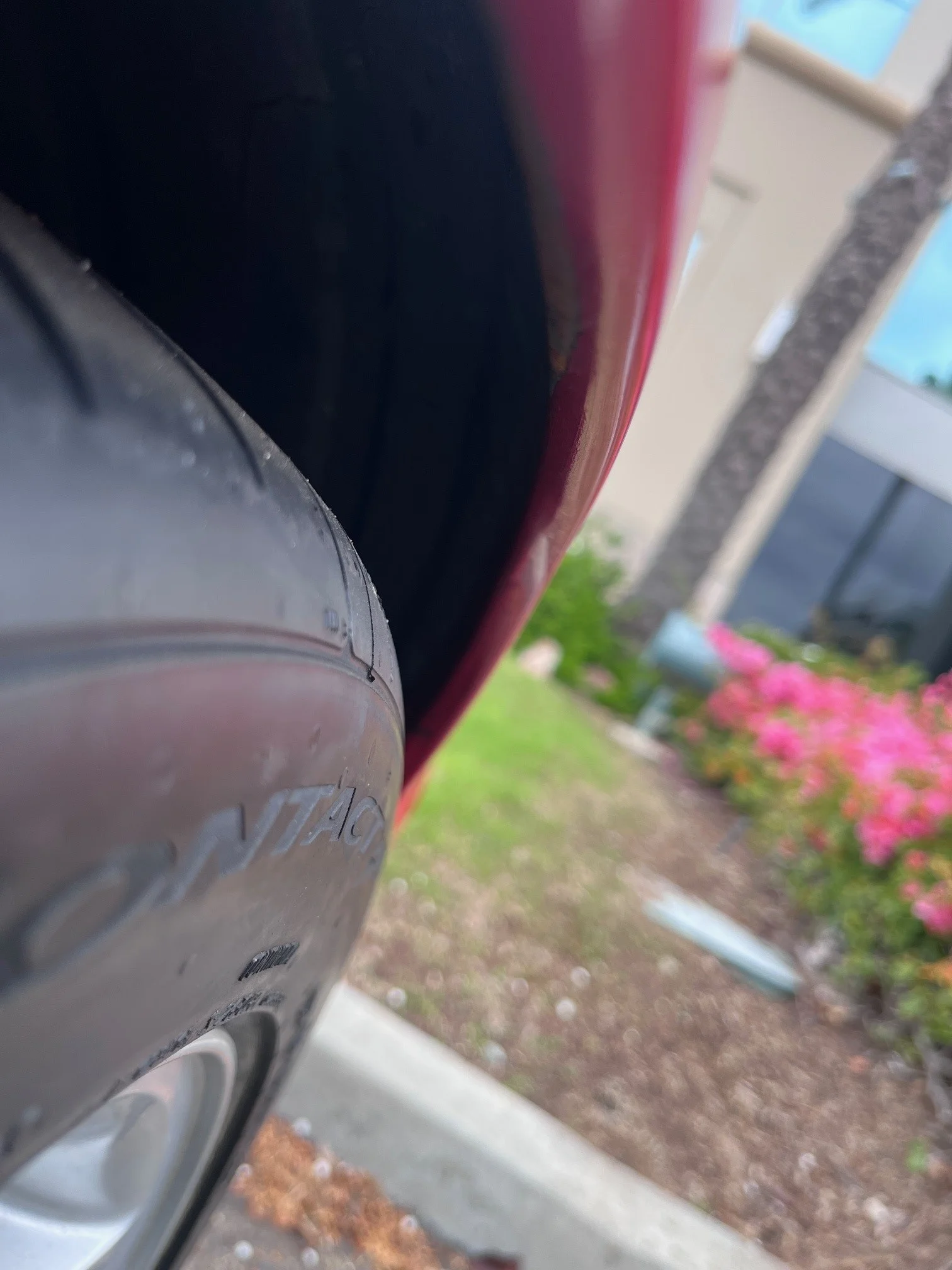

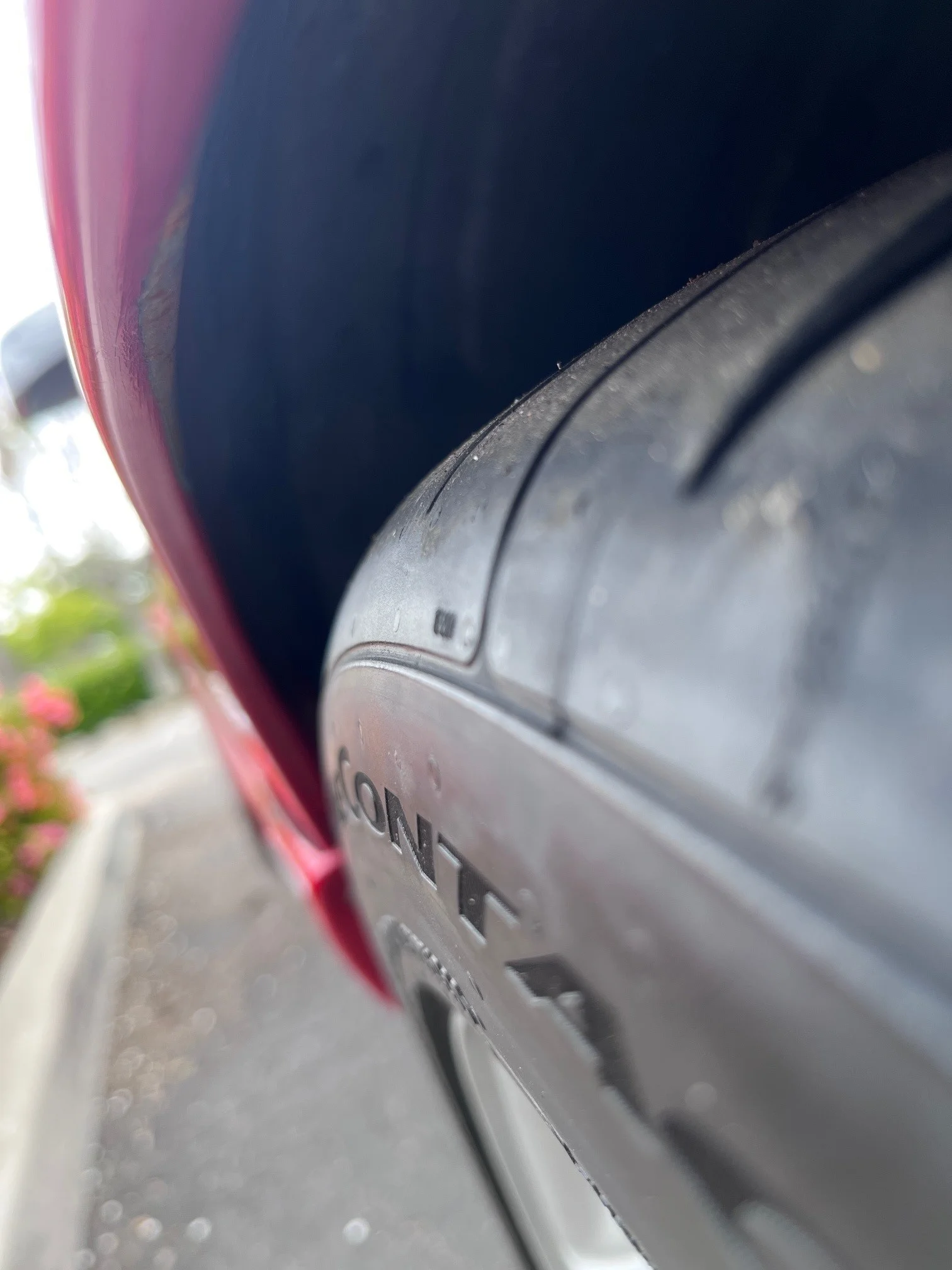

Got the drivers side rear fender rolled to where I ‘think’ I’m comfortable with. The Eastwood roller tool definitely works… but it ain’t easy. That’s some manual labor swinging that thing back and forth. Besides kneeling parallel to the car, I found any other position won’t give you enough leverage to actually move it. Hopefully get the passenger side done tomorrow.
Reactions: AeroCoupe
Got the passenger side rear fender rolled today. Actually had the little one 'help' me, so that was cool. Passenger side was in worse condition, but the rolling went smoother after doing the drivers side and learning some tricks and how to angle the roller. Car is all buttoned up and back on the ground, ready to go to work tomorrow! Excited to drive it a little longer of a distance after all thats been done.

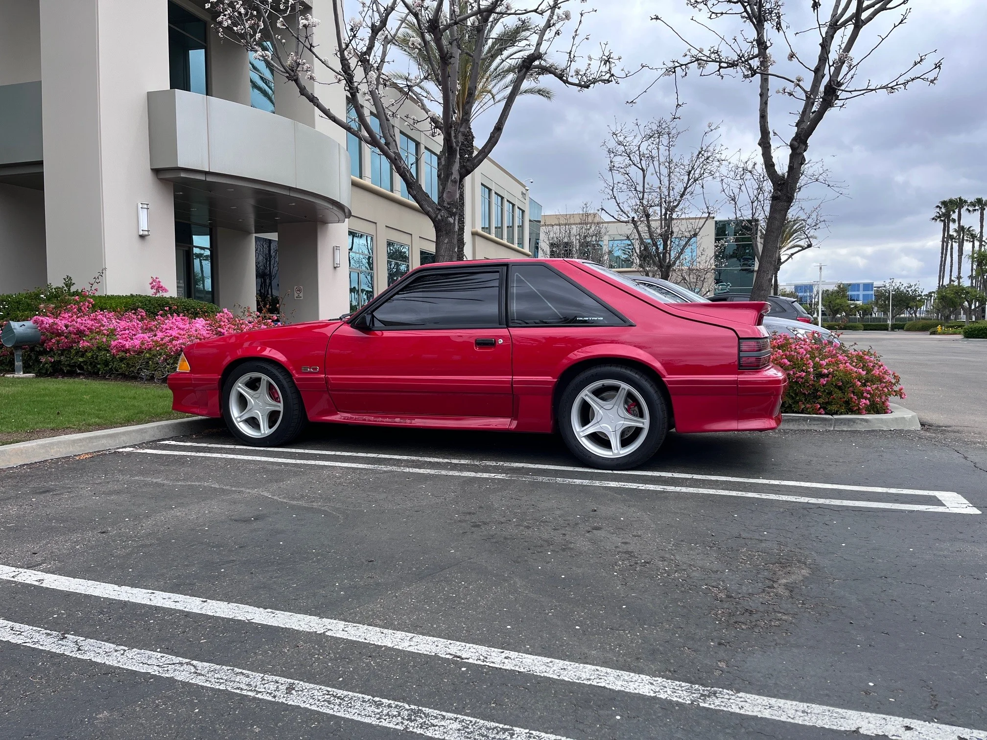

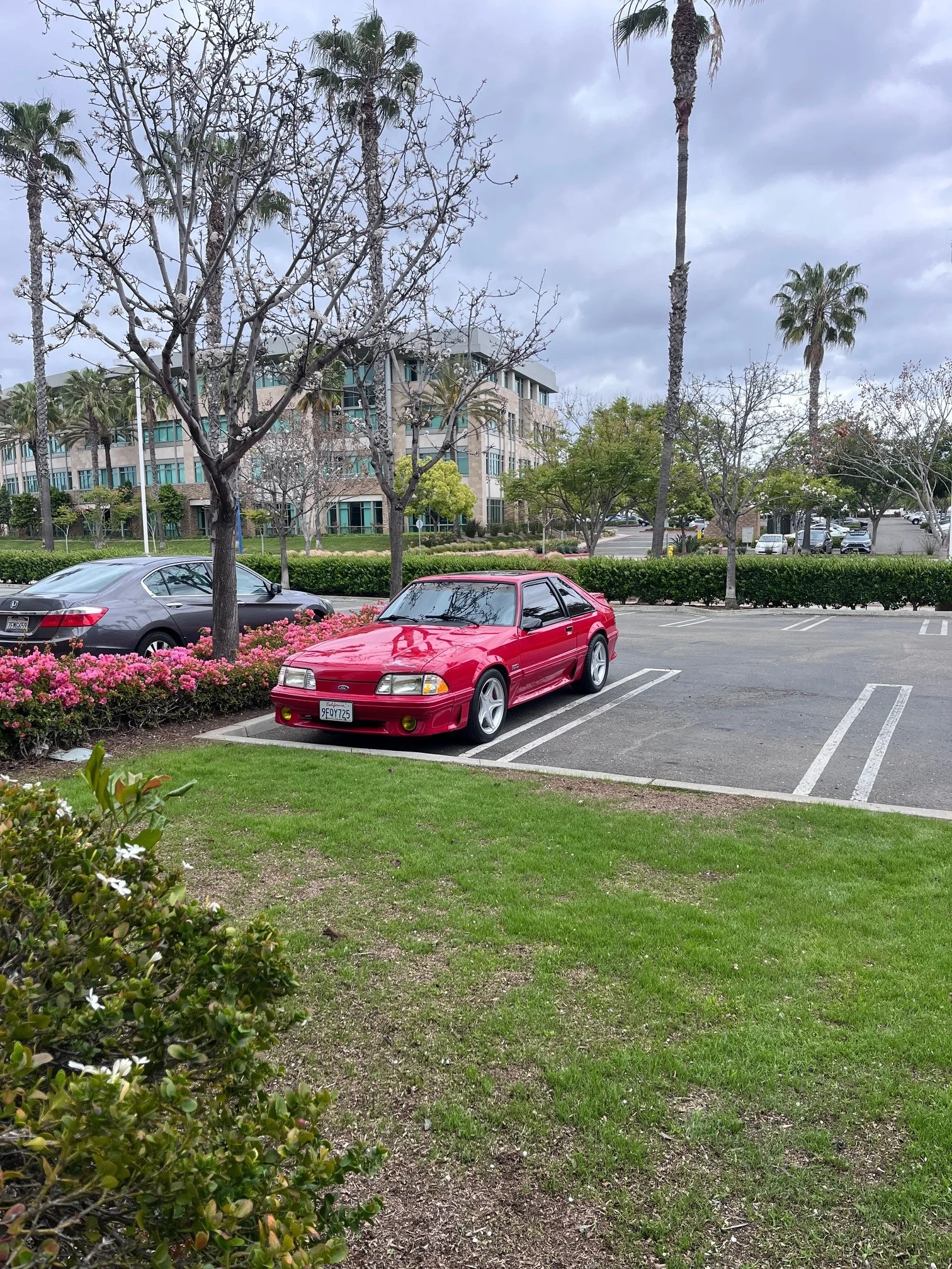

I'll head back out to take some photos, but i did snap one of the whole car when i got to work. She made it with no issues (ha, its like a 15 minute commute)... nothing leaking or anything. Turned the heater on the way and it blew out hot air... first time turning the heater on. If you zoom in you can see the new 5.0 badging. I didn't hear any rubbing at all on the way to work, although i never really went over any major bumps or anything. The new tires fixed my 'bump bump bump' issue, which is fantastic. Engine still feels like it vibrates too much like when i got on it up in the 4k-5k rpm range. She's still slow.

Post pics of those rolled fenders please.

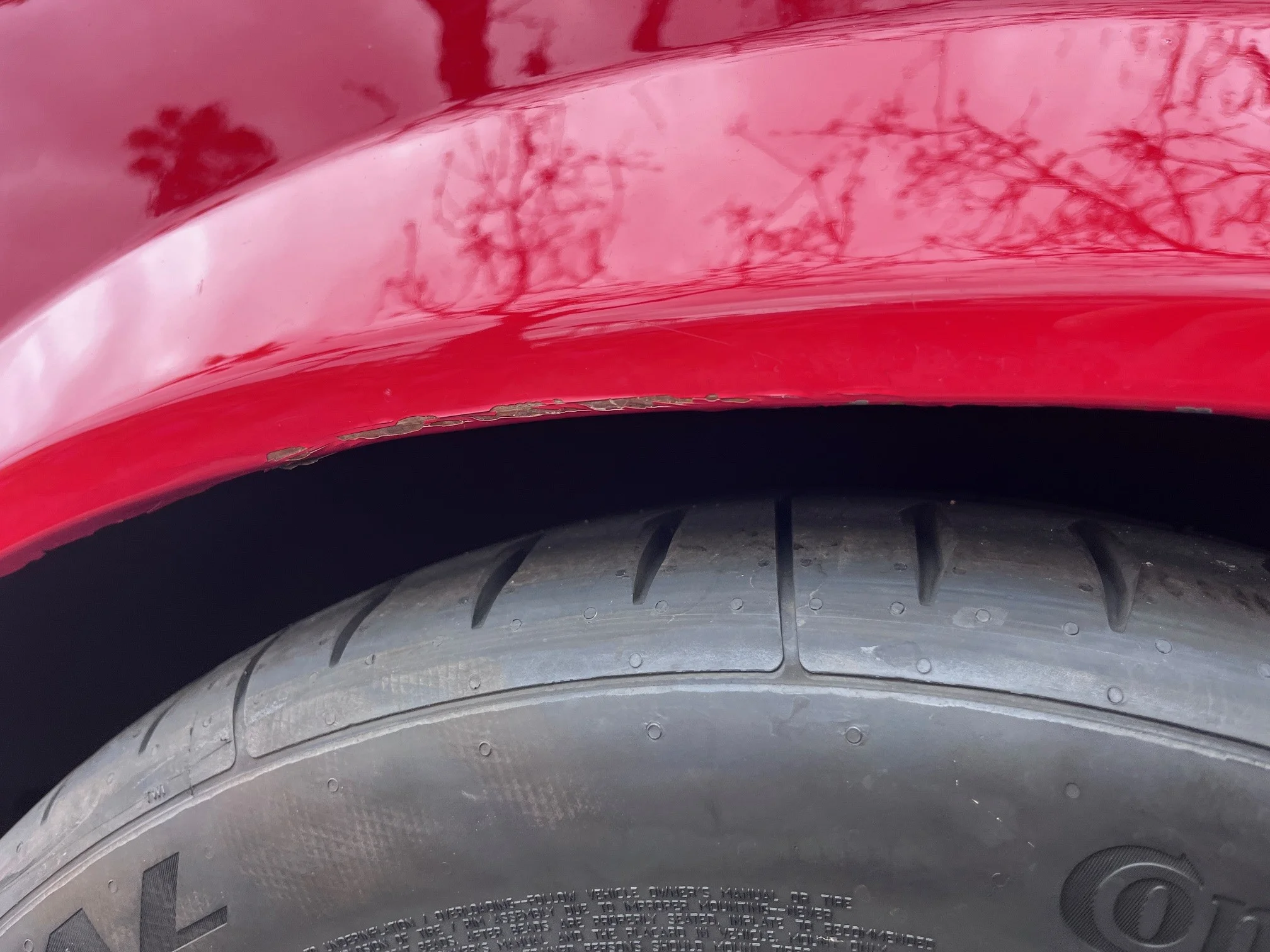

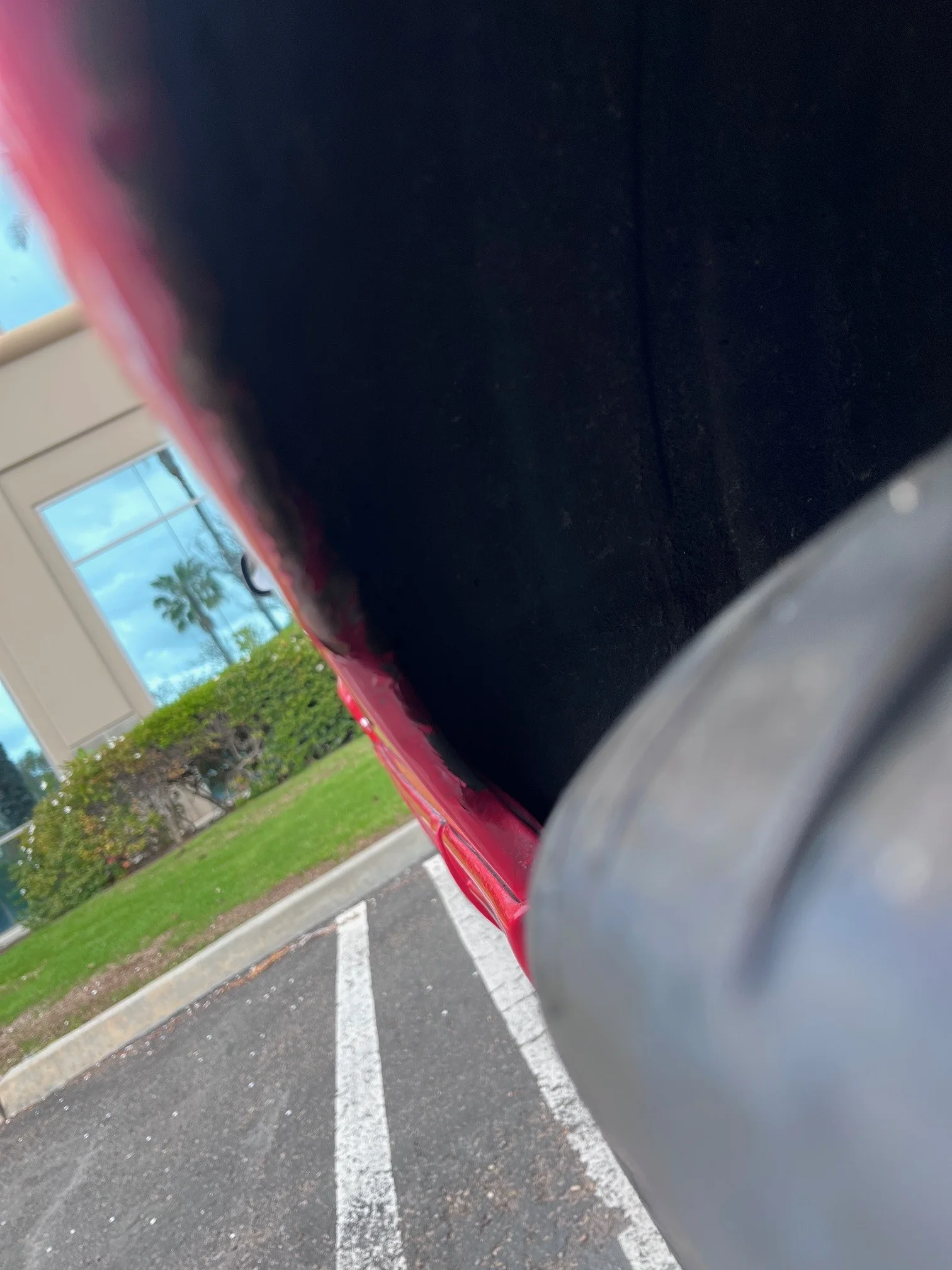

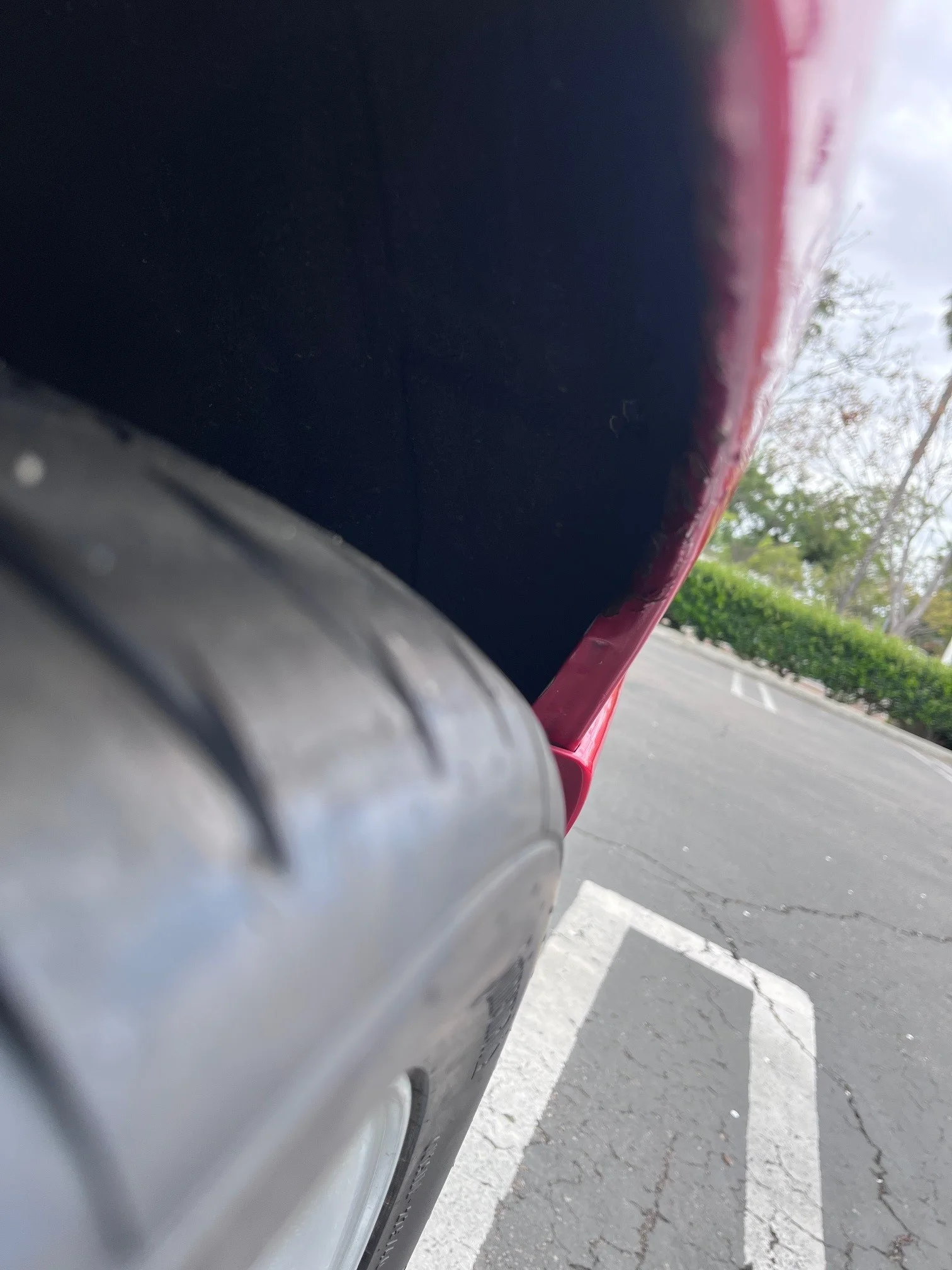

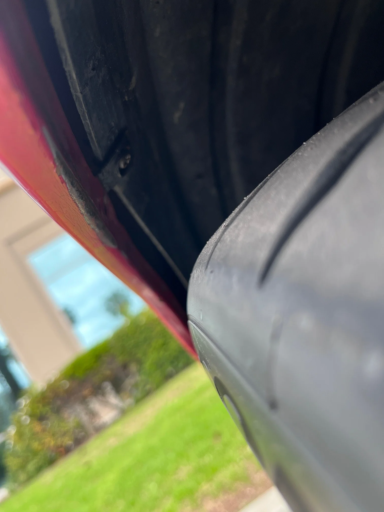

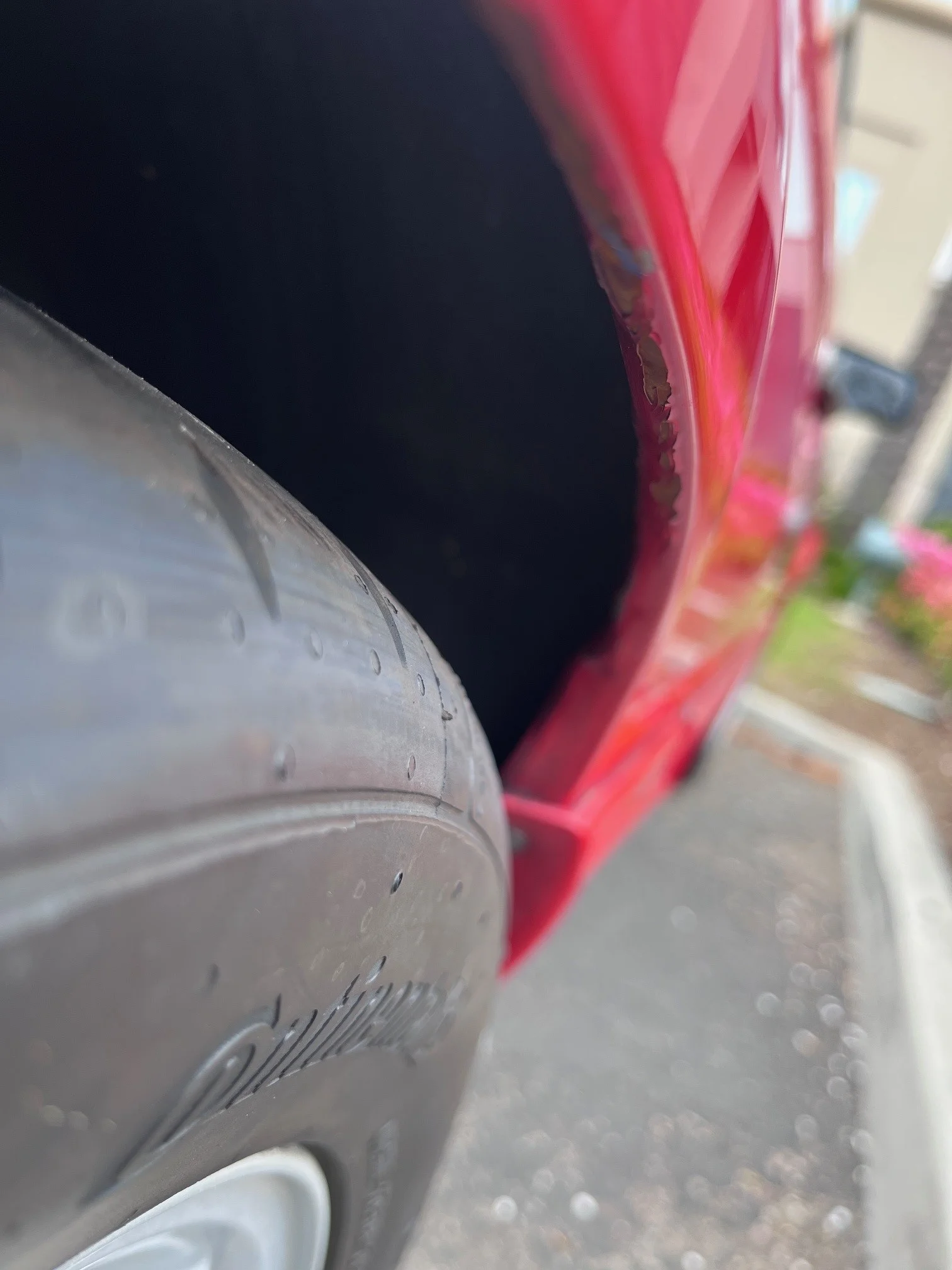

Here you go. JUST remember, the PO already 'rolled' the fenders so chipped paint or :poo:ty looking rolling job was not me, lol. I tried to improve where i could with the Eastwood Roller. Some camera angles blurr the photos a little, but i think you can get the idea.
Drivers front Fender:
Drivers rear Fender:
Passenger front Fender:
Passenger rear fender:
And here's the worst of the PO's work... chipping on the outside of the rear passenger fender:

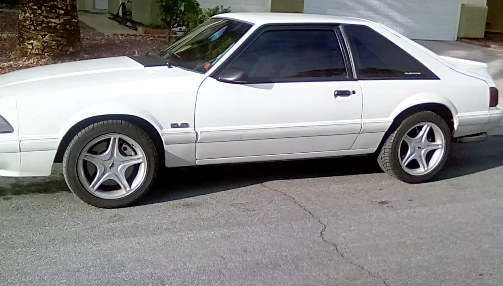

I think the yellow fogs look good out in the natural light.
Yeah that came out good, the fogs set it off and your choice of rims are brilliant,

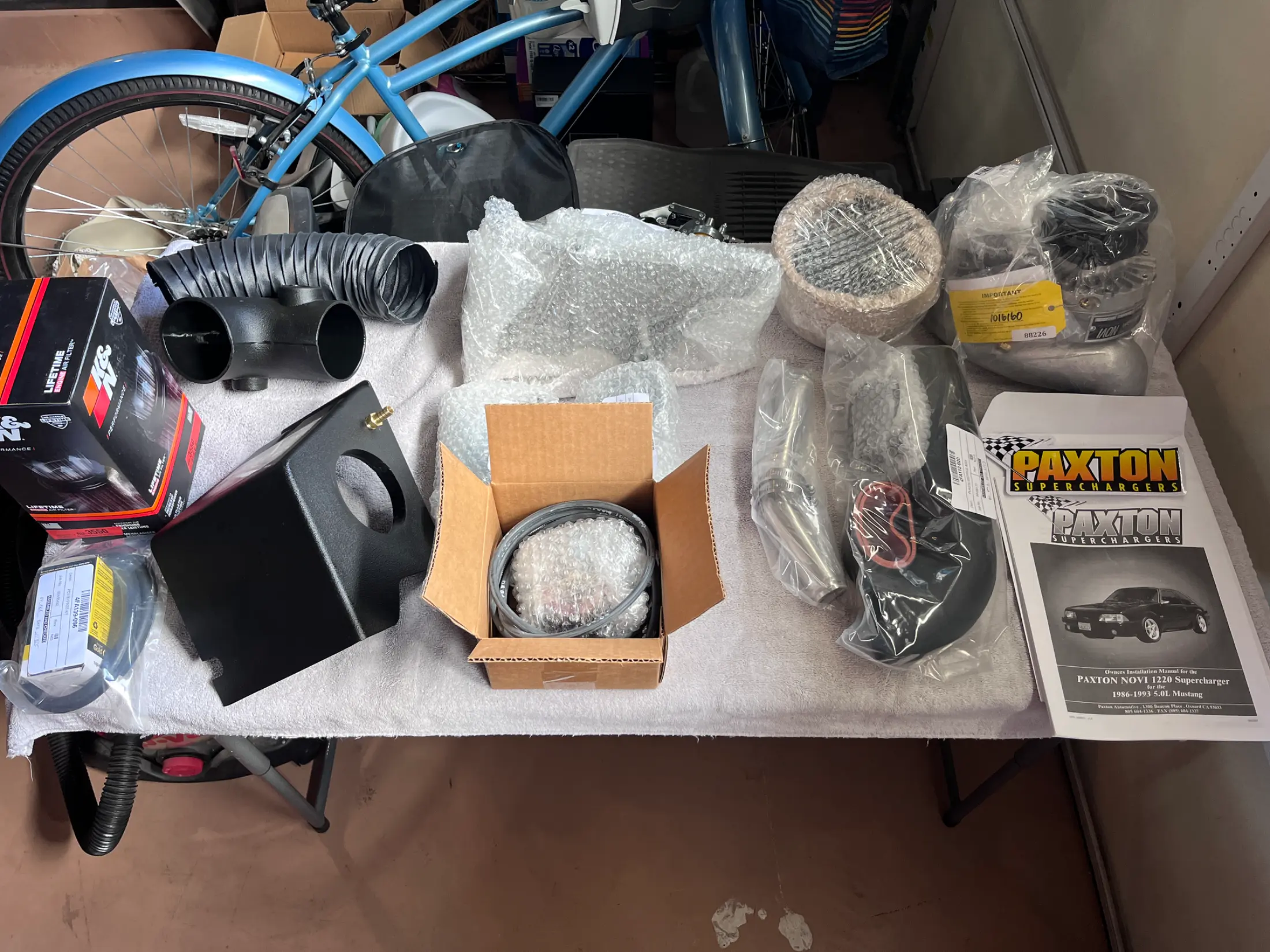

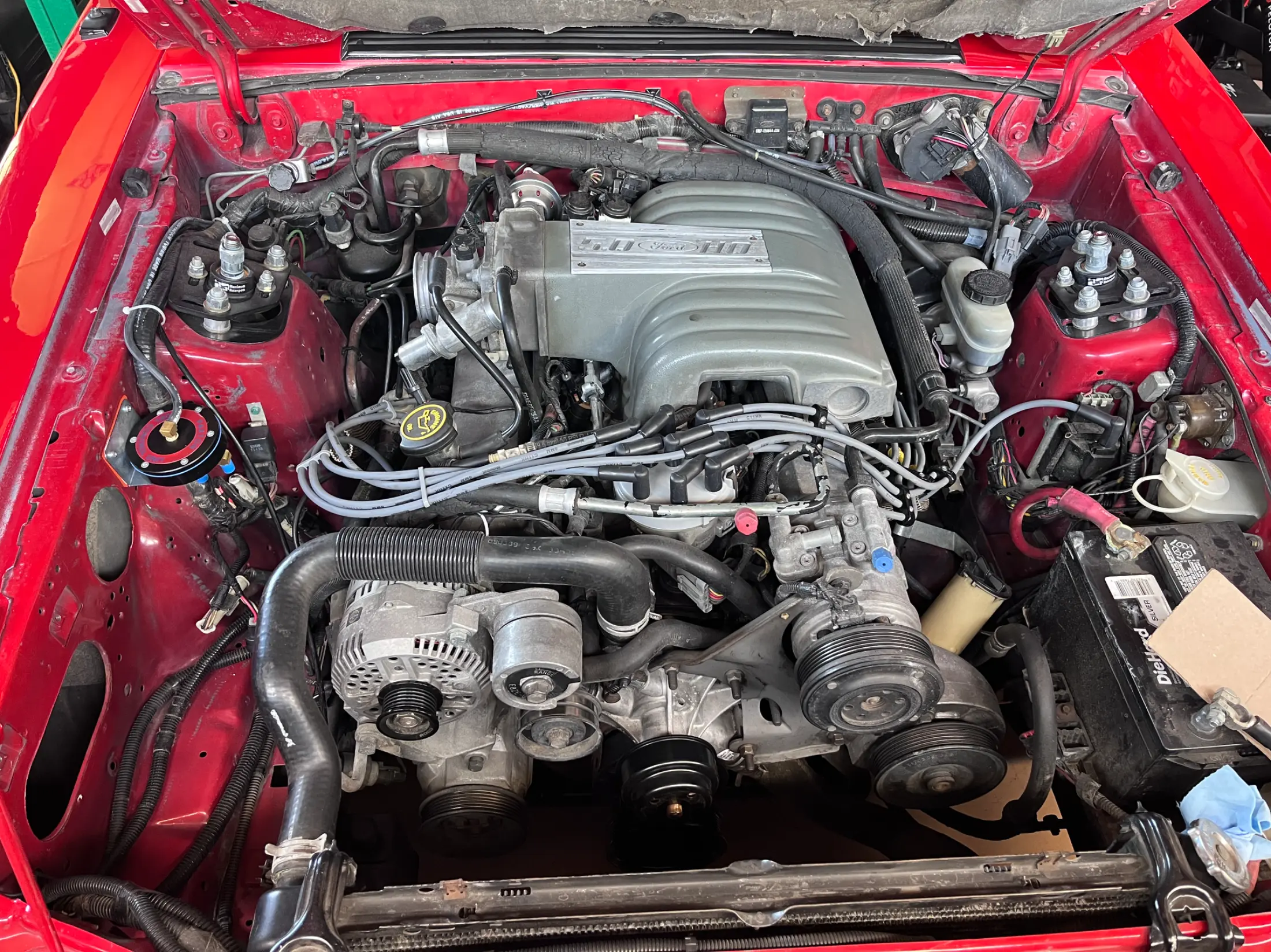

Well, after my successful drive to work… parked the car back in the garage… decided, why not… let’s start the supercharger install now. Got everything out and laid out on a little work table. I feel like with the fuel pump done, everything else ‘shouldn’t’ be too hard to do. Car will probably be down for a while now. The only thing I’m not 100% sure on is the FMU fuel line hookups. The Paxton/Vortech install instructions suck, and ive watched the LMR vortech V3 install videos but they like skip over the actual fuel lines. It like “hook up the fuel lines” and bam they are done and don’t really show you where exactly they go. I’ll cross that bridge when it’s time and I’m sure I’ll be asking questions.
I’ll take this time to completely flush my coolant because the coolant in my new overflow tank (after topping off with fresh coolant) looks like garbage now.
Reactions: TuFun
This mornings work, going a little out of instruction order because I wanted to get the noisy FMU hole drilling done while the kiddo was gone.
- removed fan, shroud & drive belt
- removed intake tract and moved relay/mounted FMU
- ran FMU vacuum line to tree and secured with ziptoes
- started doing the passenger side boot heat wraps
Reactions: nicholase and TuFun
