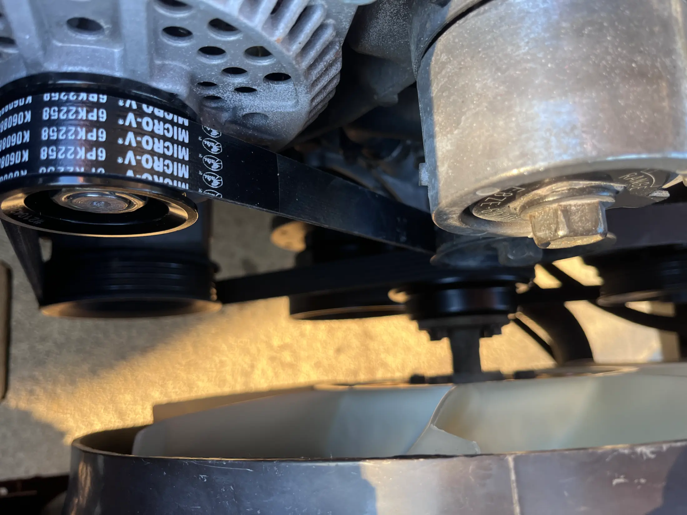

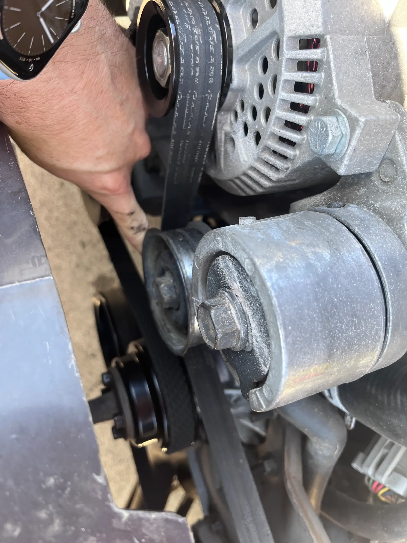

Ok got everything back together. Put the drive belt on and it’s too long:
So the stock 1990 GT belt per LMR should be 91”. Since I put on the 1993 cobra pullies I’m assuming I need a stock 1993 cobra belt which is 88.9” per LMR. If you look at the top picture, I would think taking off 2” from my current belt would work just looking at it from a visual perspective. Right?
Right now the tensioner isn’t doing anything and I can almost stick my finger between the tensioner pulley and the belt.
All that’s left is a new belt and I think I’ll change the oil too before starting it up.

Yep, you will need a shorter belt. Double check your routing first. LMR has a diagram.
I’m pretty sure I routed it correctly. I do have a belt sticker on my radiator support plus I did check LMR as well. I think I just need the shorter belt. But logically the 1993 Cobra belt would be the correct one right?

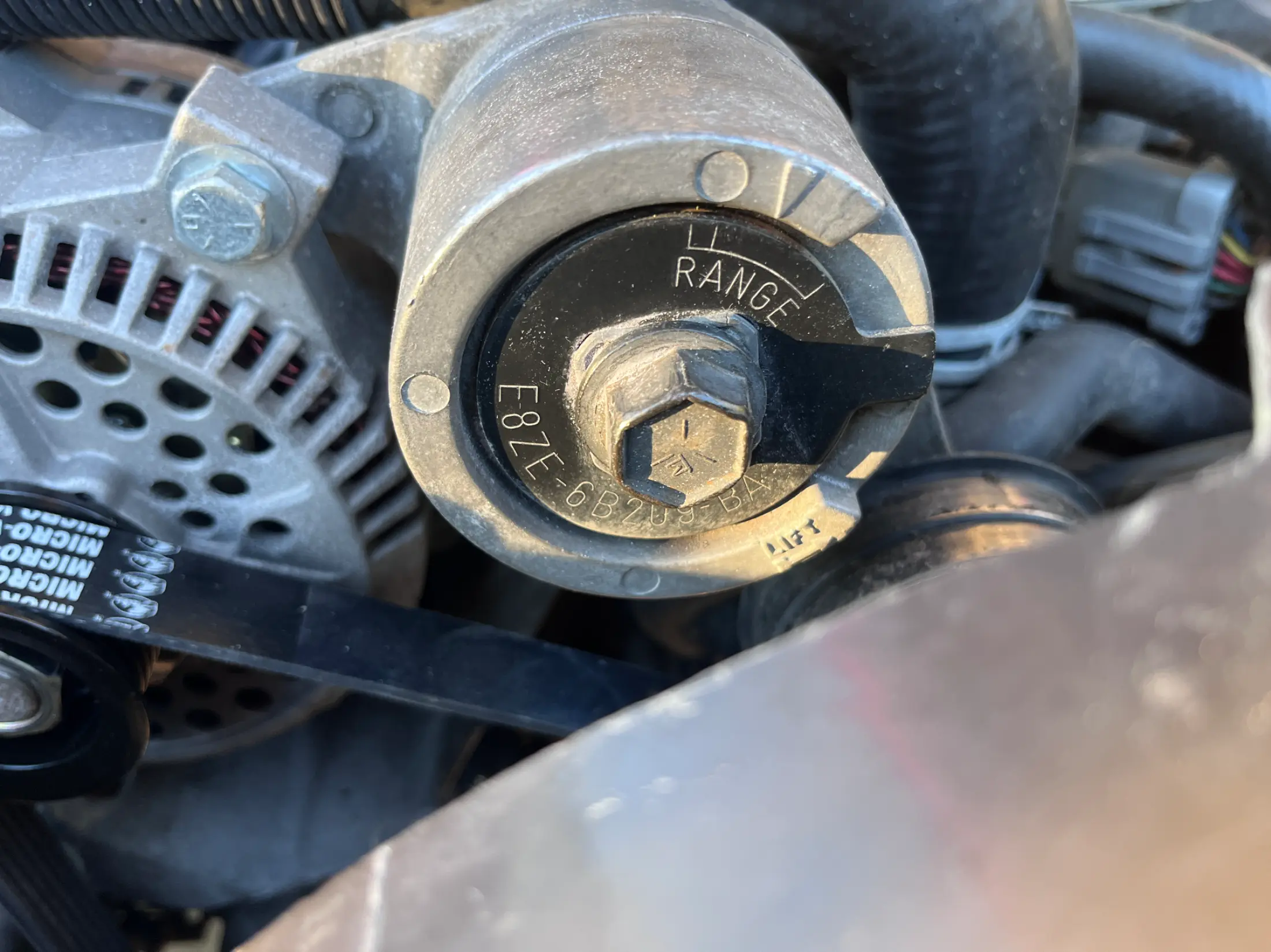

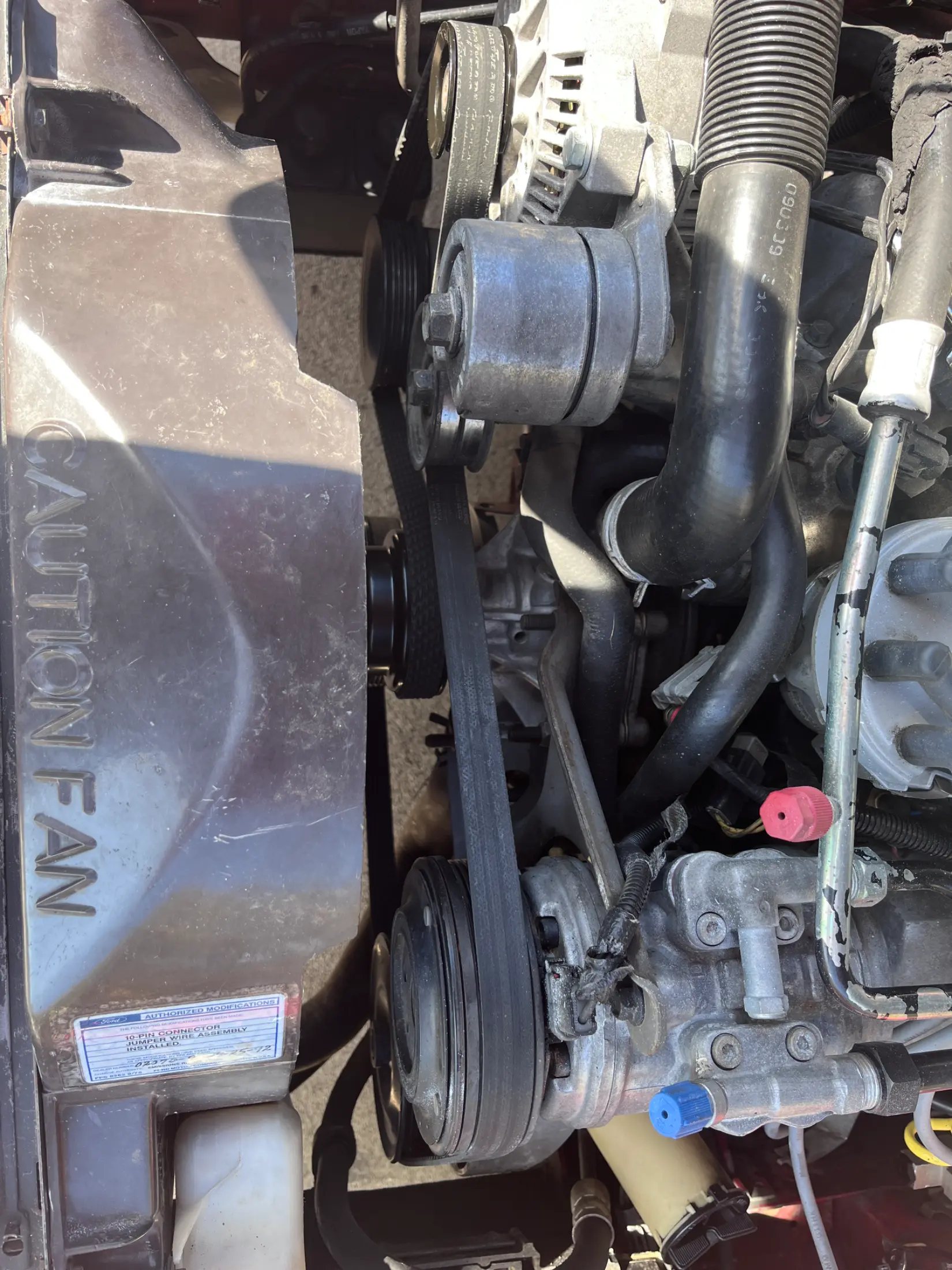

Got the new Cobra spec belt on… seems to fit perfectly:
Tightened up the fan/water pump bolts. Just need to change the oil before I start her up and see if my work doesn’t grenade the engine lol
