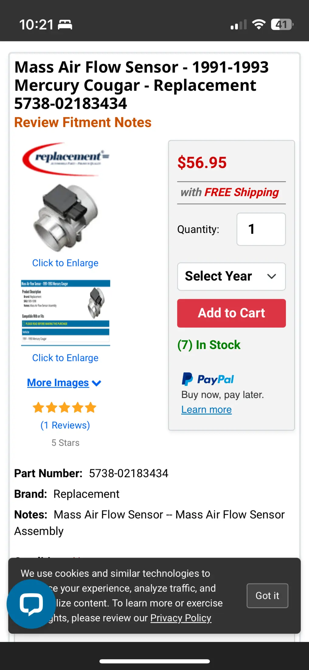

So something like this?
But will my Fox MAF sensor work in this housing? That thread talks about using a SN95 sensor. Or do I need this housing and also a 94/95 MAF sensor?

The MAF you posted will work and my understanding is you use the stock sensor.

I bought a cougar MAF housing and will put a 94/95 sensor in it. Both are 70mm and rated for 19# injectors. I'll report back this spring.

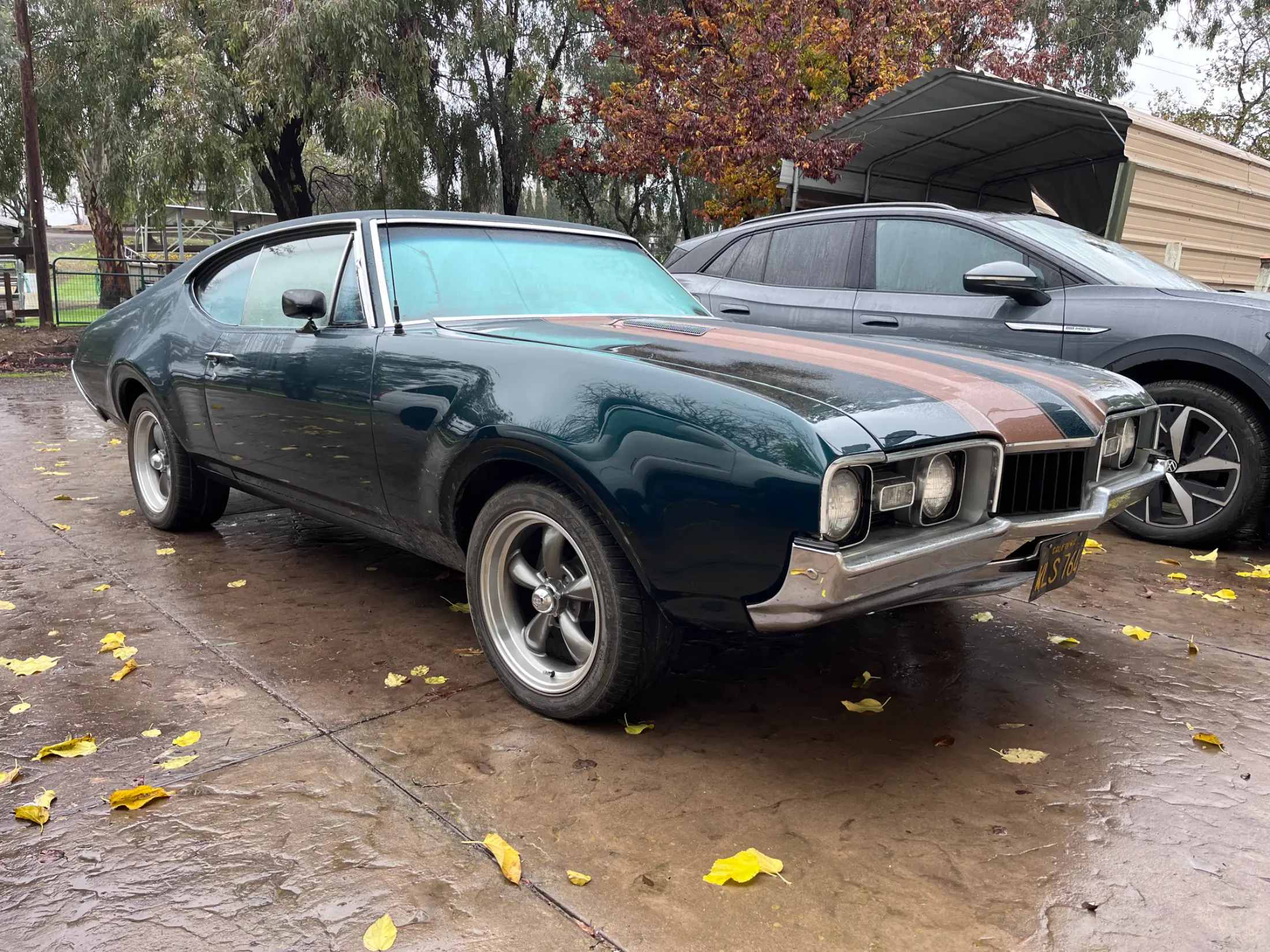

Was up at my dads for the holidays, just wanted to share a photo of his 68 Cutlass with a 455.

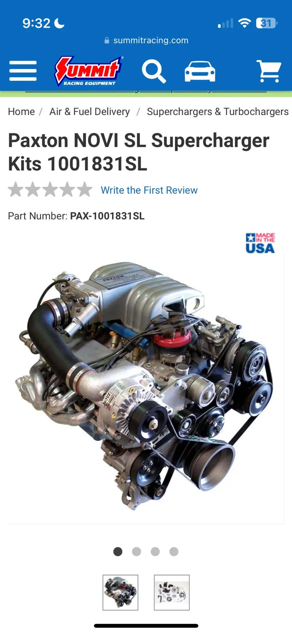

Been reading up on superchargers. Was kind of dead set on the kenne bell, but was also looking at the Vortech v3 sci and that lead me to looking into the Paxton novi 1220SL. A lot of people are saying the Paxton is the Vortech v3 sci but with better parts (seems mostly the 8 rib setup vs 6 rib). Anyways, summit racing has the Paxton for $400 off, which puts it right inline with the Vortech… and roughly $2k cheaper than the kenne bell.
Thinking of pulling the trigger on the Paxton… thoughts?

Well no one replied and I’m trigger happy so the Paxton is on order.
