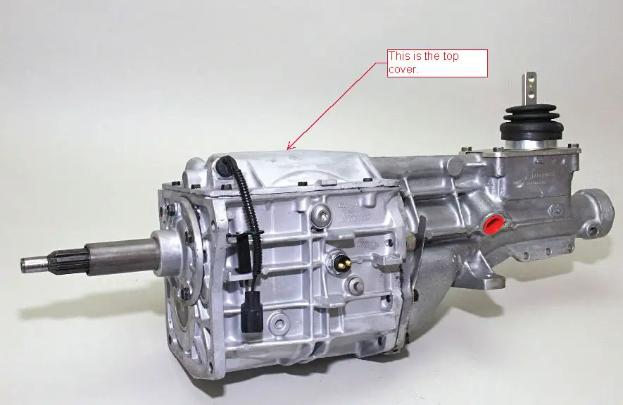

AeroCoupe said:
That will install in the top cover and go from the switch to the connector on the harness that comes through the trans tunnel.
Ok sorry but what is the ‘top cover’? Where the shifter bolts to? I was expecting to jack the car up and unbolt this sensor from up near the top side of the transmission but now I’m unsure.

That doesn’t look easy to get to lol
It's extremely easy to remove when the transmission is out of the car!

Man there is like no photos and very little information about the Neutral Sensing Switch online. I’d like to be able to at least see a photo of what I’m going to try to replace before just unscrewing a sensor. I imagine I’m gonna have to do it half blind with the transmission in the car. Is that sensor just hanging off the transmission the sensor @AeroCoupe ?

You might want to drop the trans a little bit to get to it.
It ain't that difficult,just take your time.
Reactions: gkomo and AeroCoupe

Unfortunately it’s not an easy reach. Lower the resr of the trans and take your time. You may have to remove the H or X pipe as that will gain you a lot of working space.
