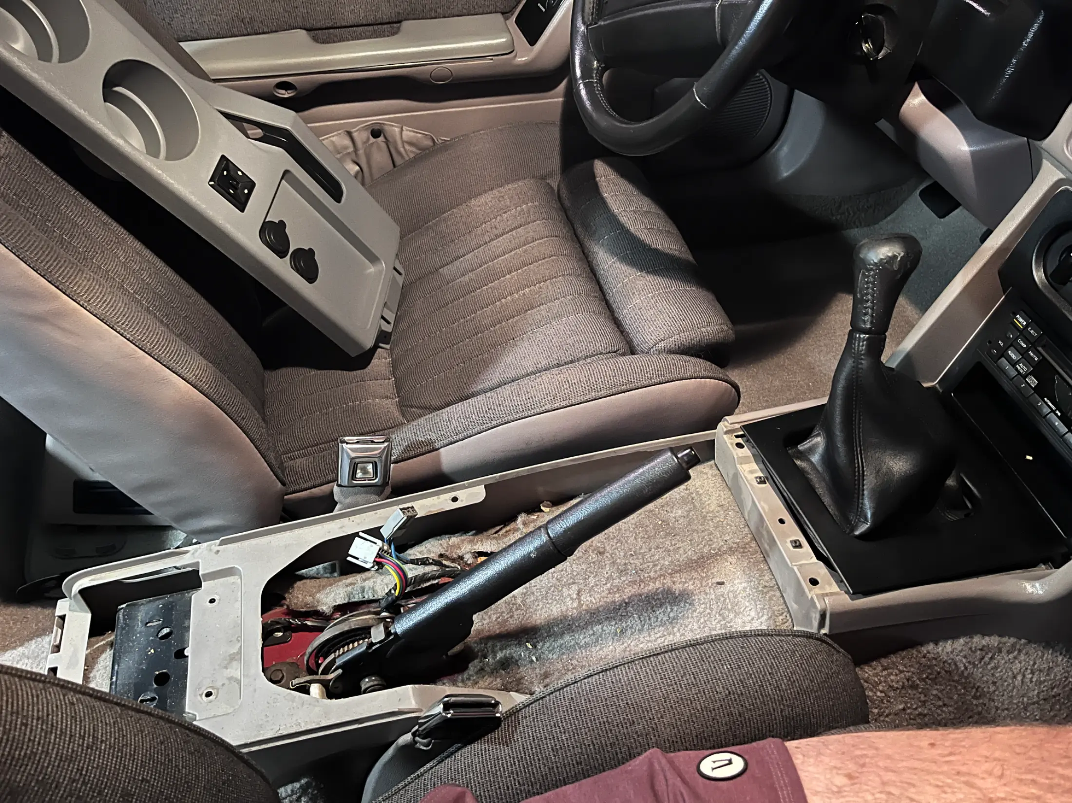

Out with the old:

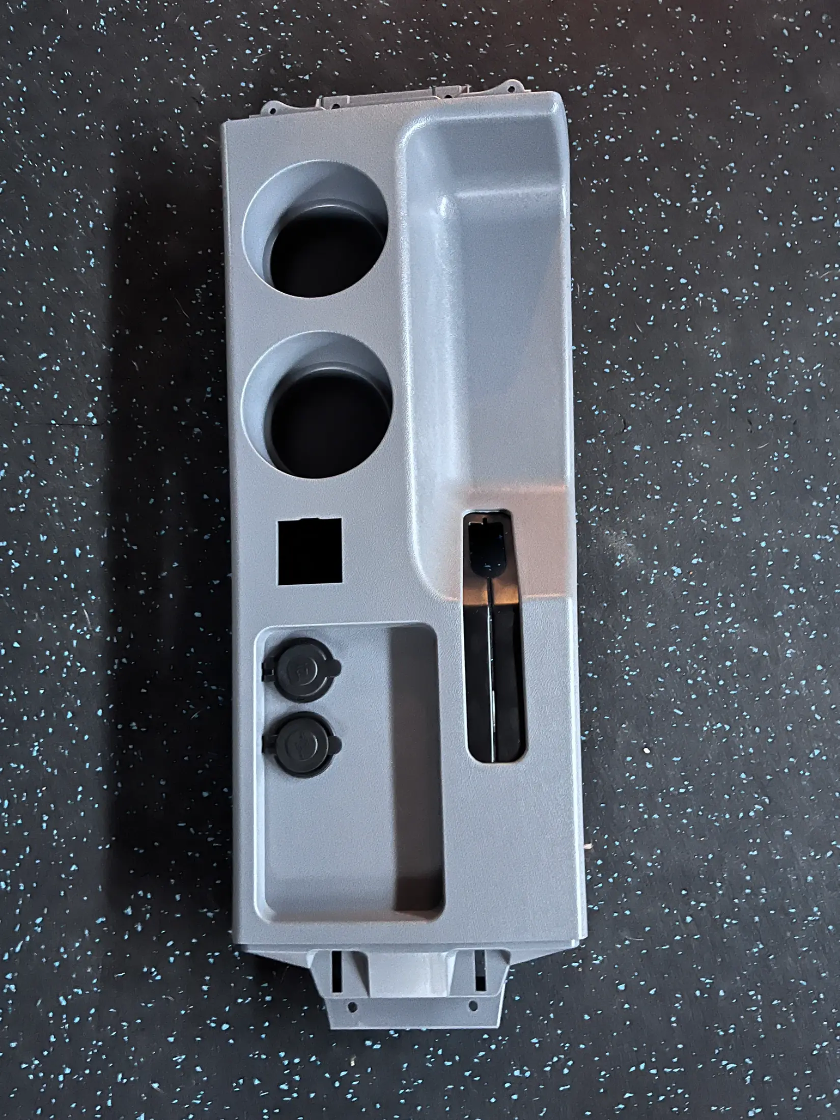

In with the new:

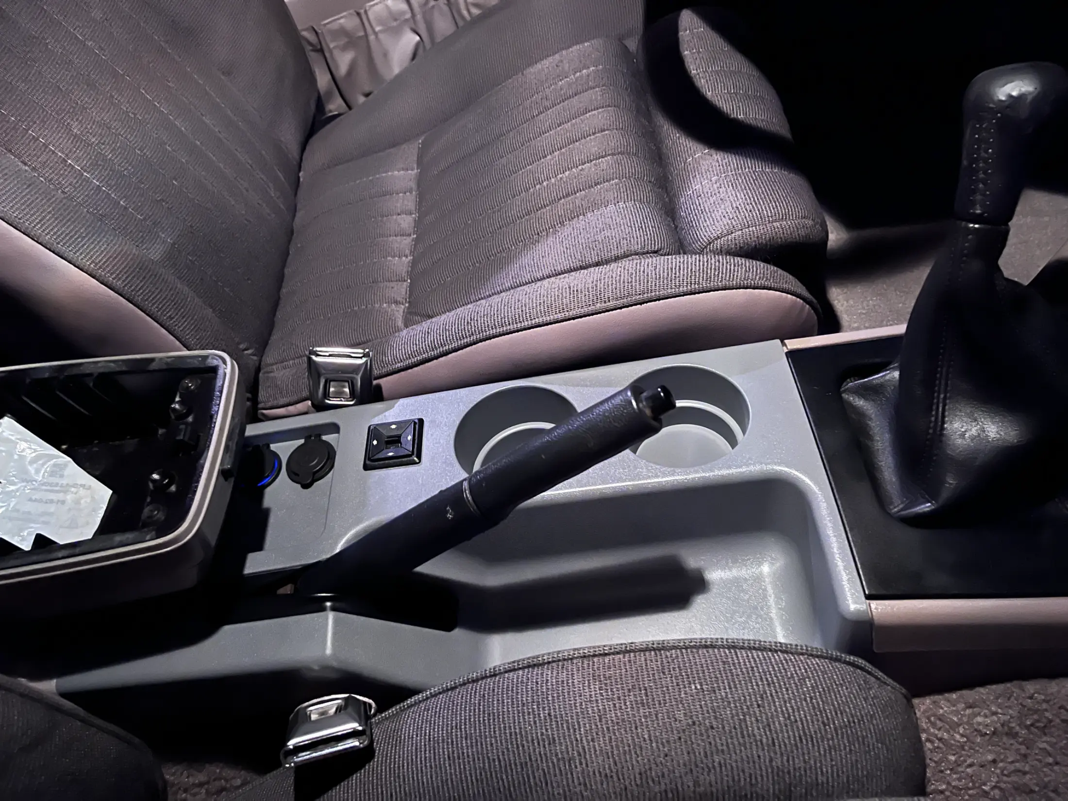

Color doesn’t match worth a damn but I think they say it should be painted. Will worry about that if/when I do the entire interior.
Super tight fit but I think my e-brake bracket is slightly off kilter so that’ll need to be adjusted at some point.

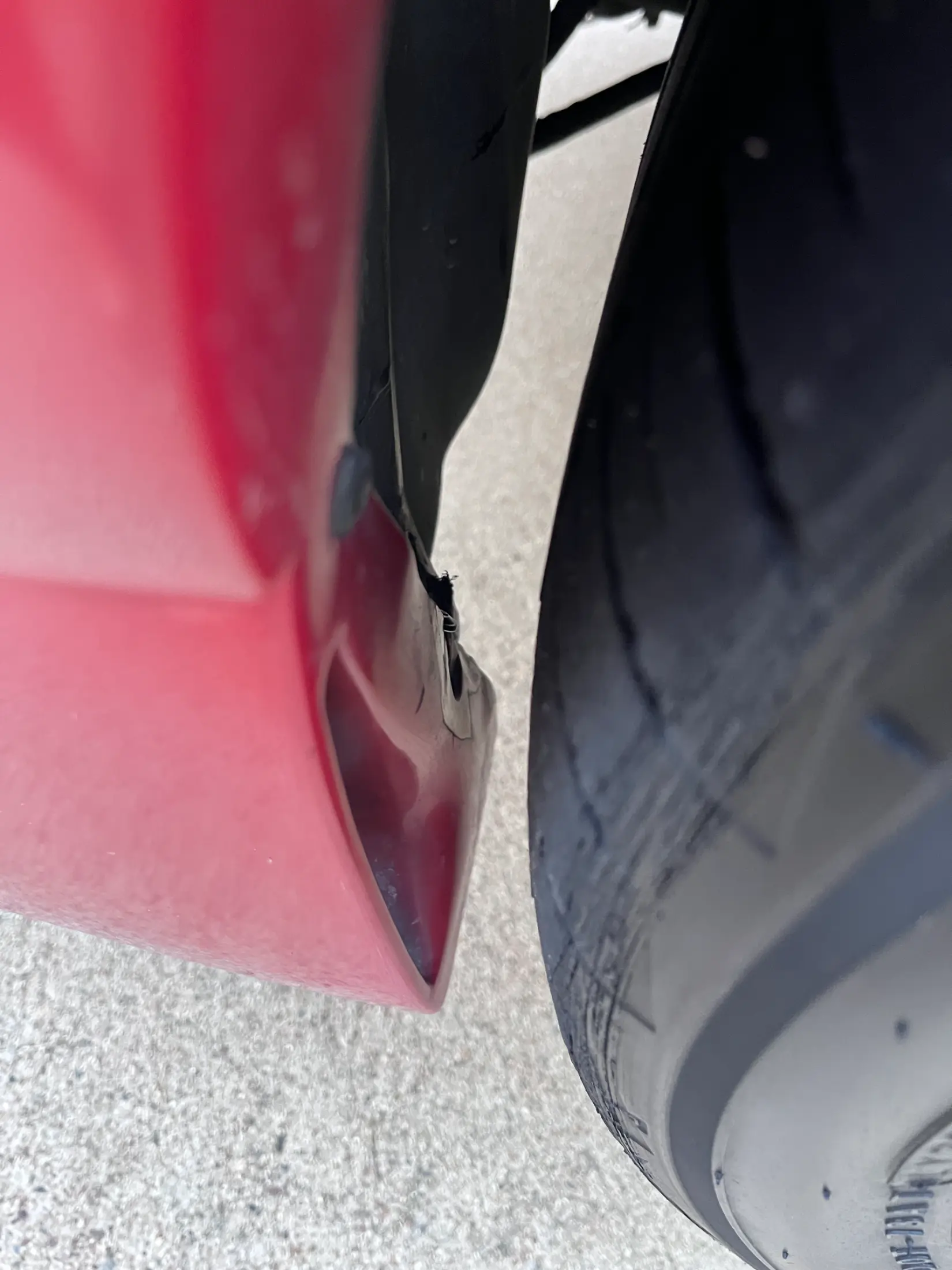

I've been having some gnarly rubbing on the front drivers forward fender/metal piece down by the lower ground effect trim, literally scribing marks on the outside of that tire. There was a bent metal shard like sticking out towards the tire. So i applied some heat and bent that sh*t back 'forward', away from the tire. At least i don't have to worry about a metal shard cutting into my tire, but it still rubs like a mofo. Eventually i'll just cut out the entire part of the ground effect and metal backing for clearance, but this is a good temporary fix.

Here’s a photo of where I bent this shard of metal sticking out on the front drivers side. There is still a screw I need to remove that pokes out a little. Eventually I’ll cut out all of it to have total clearance:

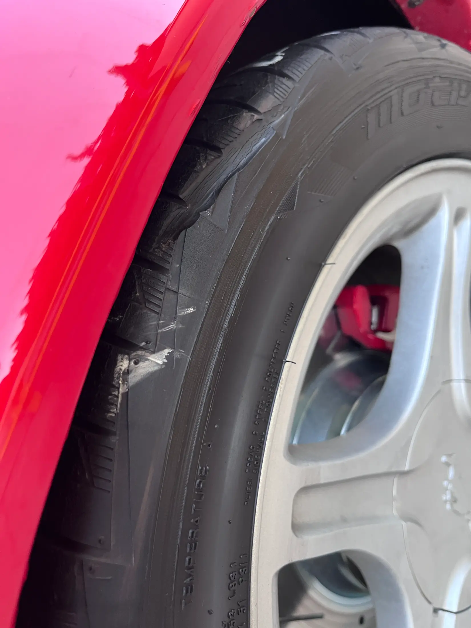

And the damage caused to the tire before bending it:

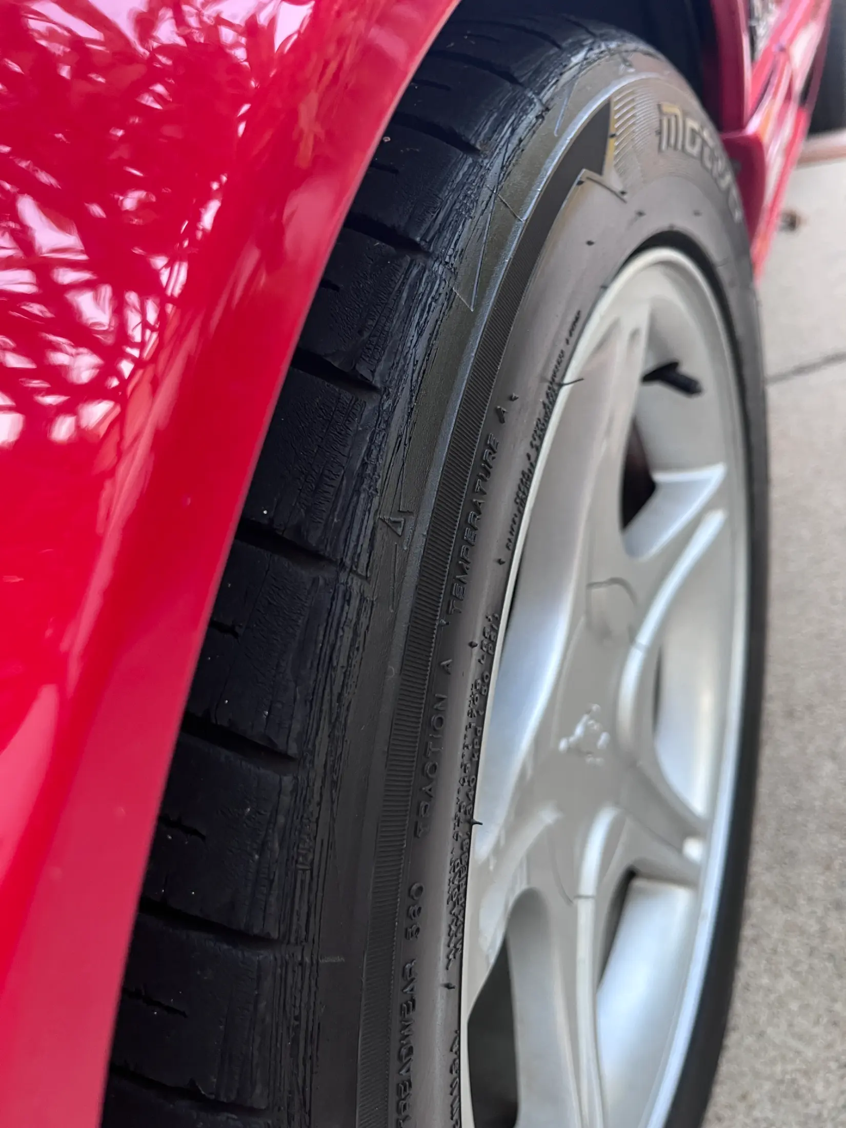

And here’s a chunk missing out of the rear tire:
Fenders are rolled but I think they need more, or a smaller tire. The SN95 rear ended widens the track and although it looks good I don’t think it’s doing me any favors as far as figment goes.

I run 245/40R17’s up front on a 17x8 wheel with a +35 offset. In the rear I run 275/40R17’s on a 17x9 wheels with a +45 offset. Zero rubbing and the car is pretty low and has a SN95 width rear end. This was with the stock front suspension and now with a MM K-member and zero offset control arms.
The picture you show makes the front wheel look like it’s not centered in the wheel well? Then again it could just be that it’s a taller tire.
