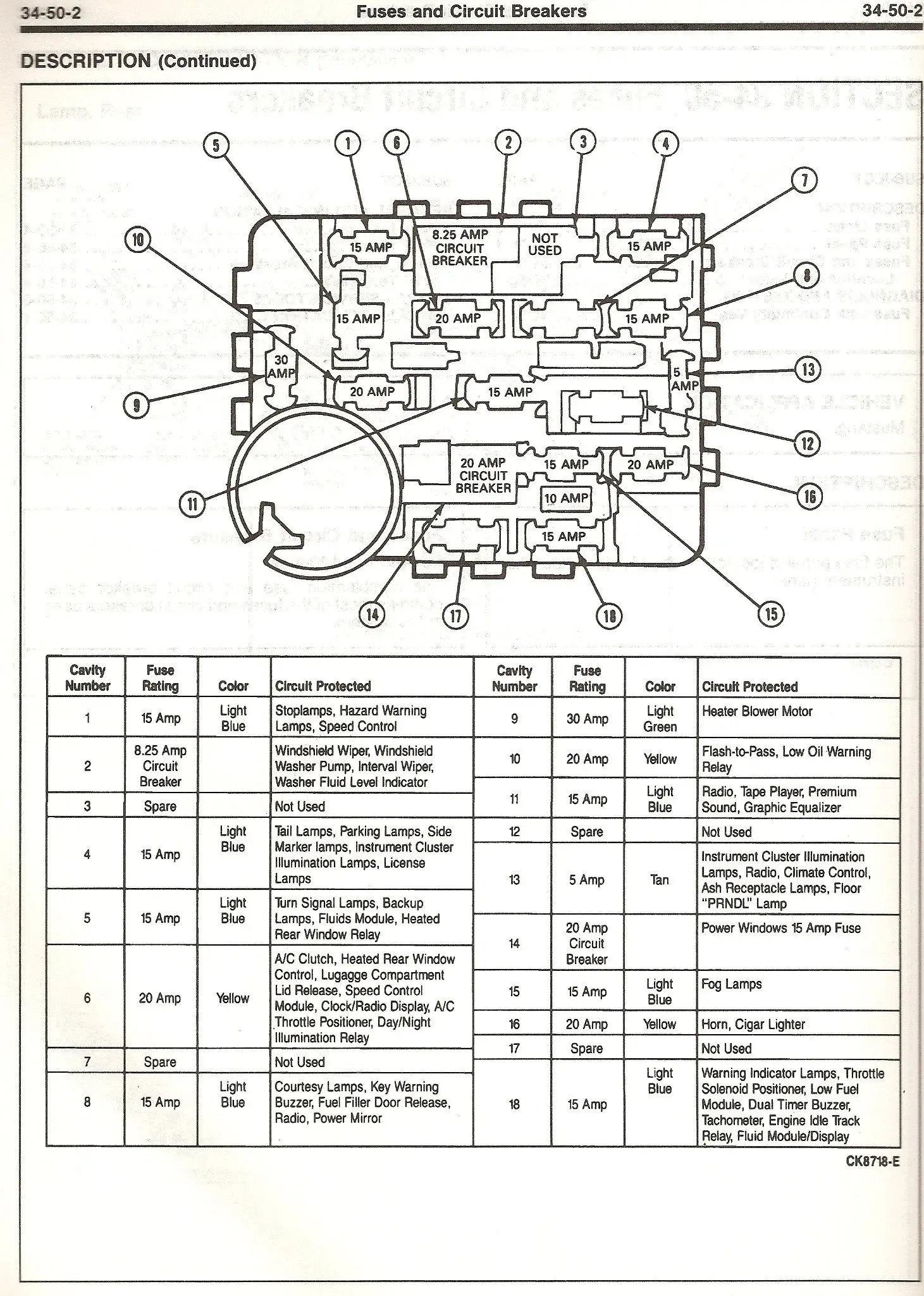

Postion 16 in the fuse box? Pull the fuse and use a test light to confirm that one side of the other in the fuse box has 12V+. Then either visually check the fuse or test continuity with a DVM.
Reactions: gkomo
