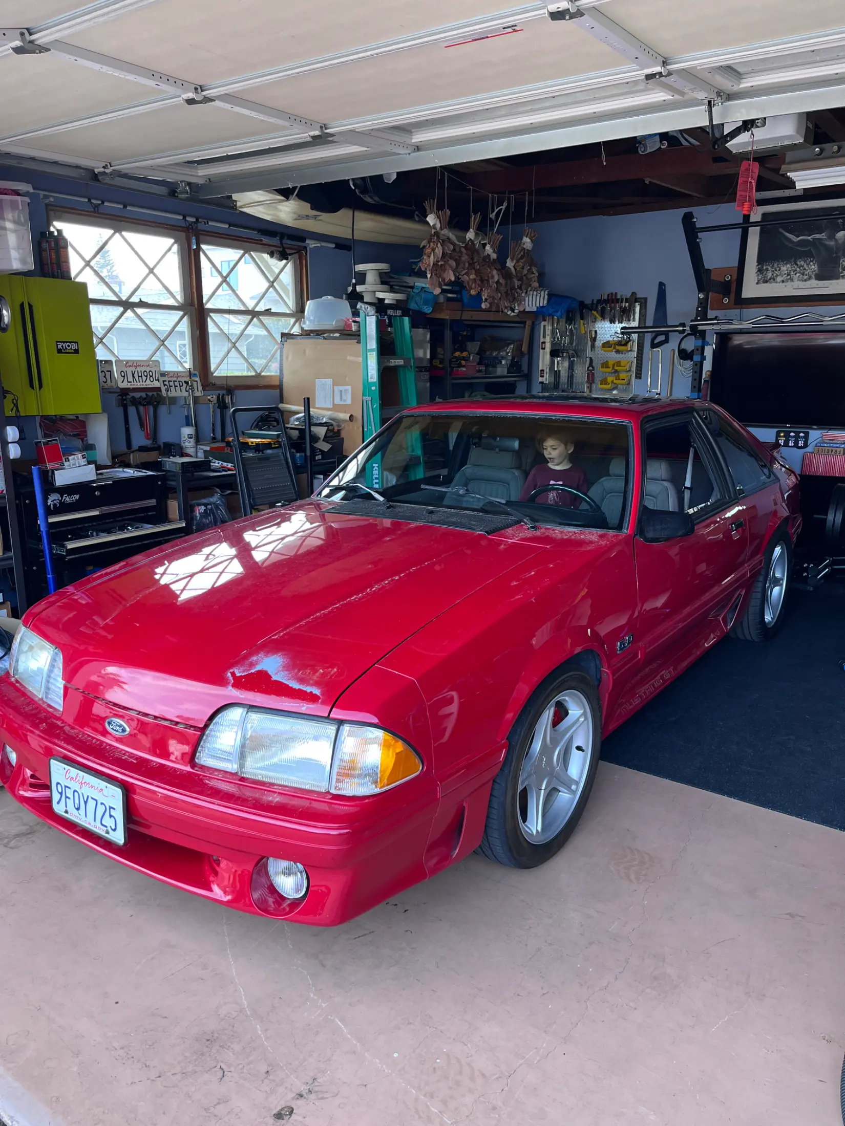

Decided to move her into the garage now. Don’t mind how dirty it is it just rained and my car cover isn’t completely waterproof.

I'm not trying to be too PC here, but you really shouldn't let young children live in your car in the garage... Not only do they start to smell bad which ruins the value of the car, but eventually a Karen is gonna call the cops on you and you could get in big trouble.
Hey she makes a 2 hour job take a month then she gets to think about that for a month in the car… eye for an eye around here!

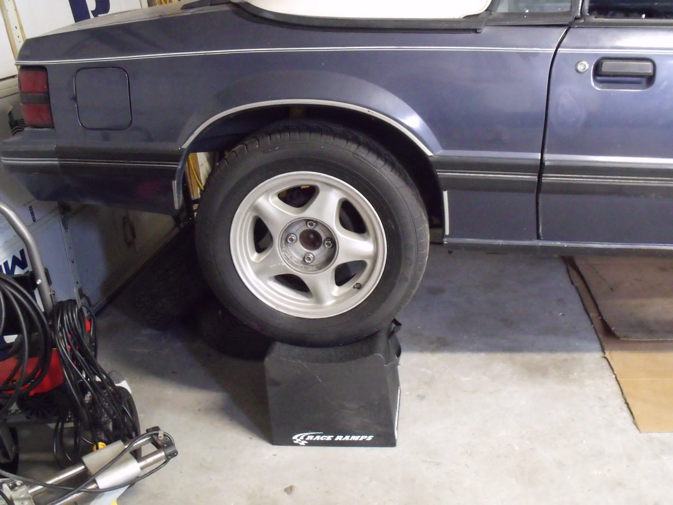

Anyone have any suggestions for Race Ramp alternatives? They are damn expensive. Eventually i'm going to start the supercharger installation, but want the car higher up in the air for an extended period of time. I'll use my ramps for the rear, just looking to support the front under the tires.
I have other things i'll need to do under the car as well, not just the S/C install:
- Motor and transmission mounts
- NGS switch installation
- MM Clutch cable head shield
- Redo the gas tank straps with loctite
- MM RLCA install
- General cleaning of the undercarriage
I do have two jackstands, but would probably want different ones with a safety pin lock (my current ones don't have that feature), so i could go the jackstand route instead i suppose. I do need to replace my drivers side ball joint so obviously supporting the car under the tire won't work for that.
Oct 28, 2001
5,959
4,073
183
Claremore, OK
Mar 11, 2025
#526
  • Mar 11, 2025
  • #526
I would go the getting some good jack stands route as they will come in handy for all kinds of things.
And if you ever want to put a turbo on it they will be required for many years after you start the project.

they work really welll

AeroCoupe said:
View: https://youtu.be/wUgx_qxmhGo?feature=shared
That’s a good cheap alternative to the $200 race ramps.
this is a good way to do this IF lumber prices are low or reasonable... When I bought my Race Ramps the price of lumber was " transitory" LOL.. and it would of cost MORE to build em out of lumber.....
