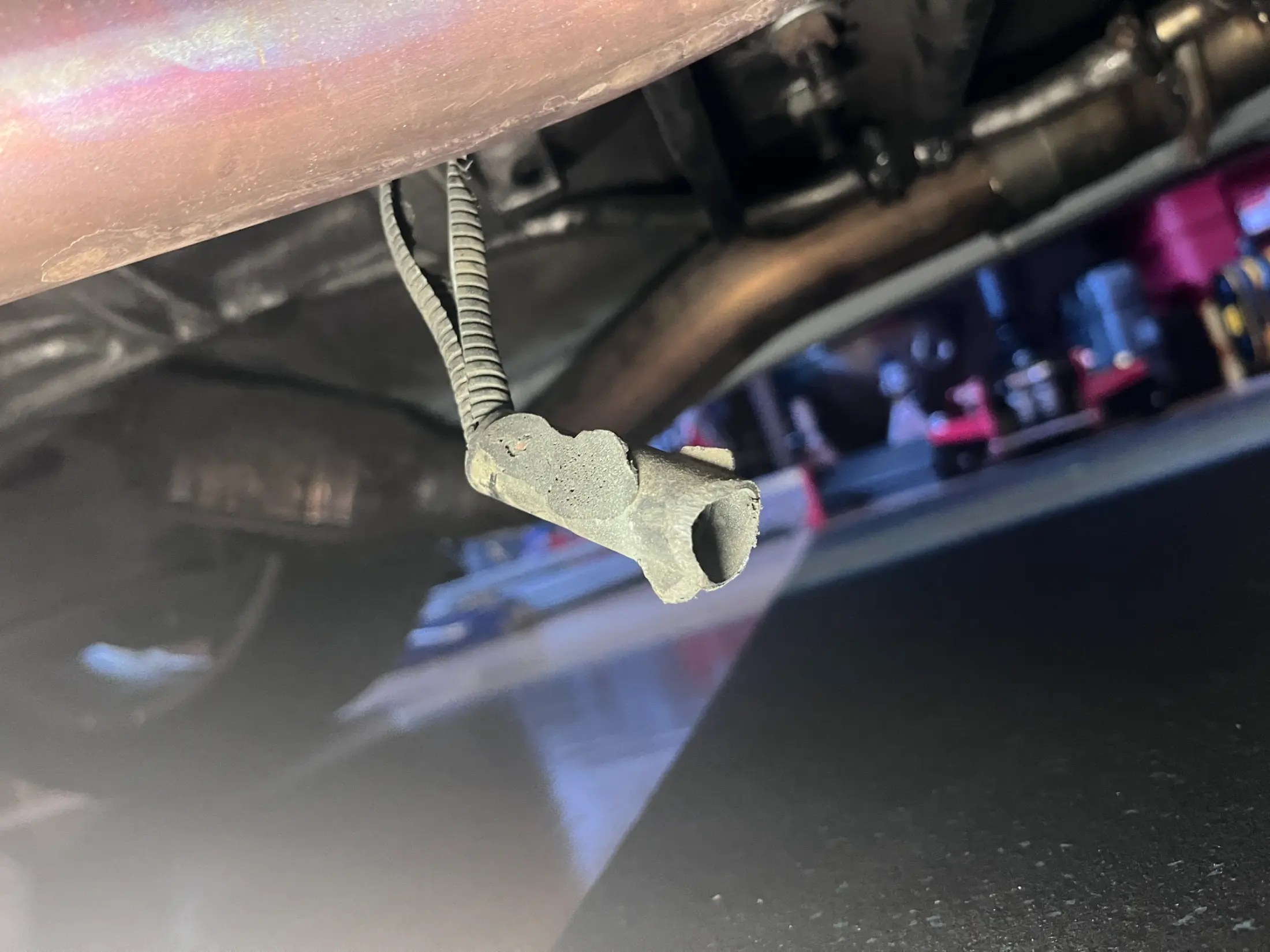

On another note, today I was under the car just cleaning stuff and I remembered the loose plug I saw from when the subframes were getting installed. Crawled as far as I could down by the transmission (only have the rear of the car jacked up right now) and traced the plug and I’m 99% certain it is the NGS connector as it originates up on the top of the transmission drivers side. That would explain my KOEO code 67. I wasn’t able to get far enough under the car to plug it in…. However it looks like the other connector it plugs into like rested on the exhaust and partially melted. Like I said I couldn’t even try to connect them without the space… hopefully they do because I don’t know how to replace the damaged connector:
Oct 28, 2001
5,959
4,073
183
Claremore, OK
Mar 15, 2025
#549
  • Mar 15, 2025
  • #549
I would just get this one and be done with it. You may be able to depin the original one and just use the new connector on the old wires which will keep you from having to cut, connect, and heat shrink the connections from the original wires to the new pigtail.
https://lmr.com/item/LRS-8693NSSM/Mustang-Neutral-Safety-Switch-Harness-For-T5-86-93
Reactions: General karthief and gkomo
gkomo
now i can hopefully expect to receive the shaft
Aug 2, 2024
2,205
1,440
133
San Diego, CA
Mar 15, 2025
#550
  • Mar 15, 2025
  • #550
Oh perfect that’s exactly what I need!

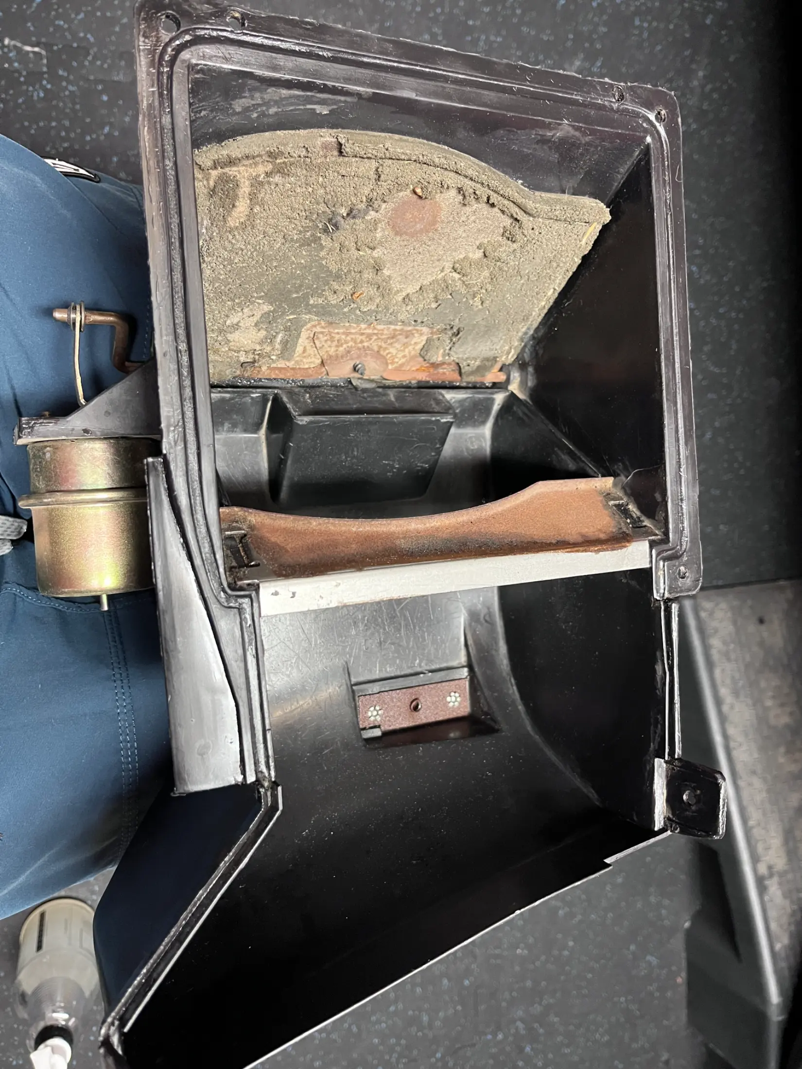

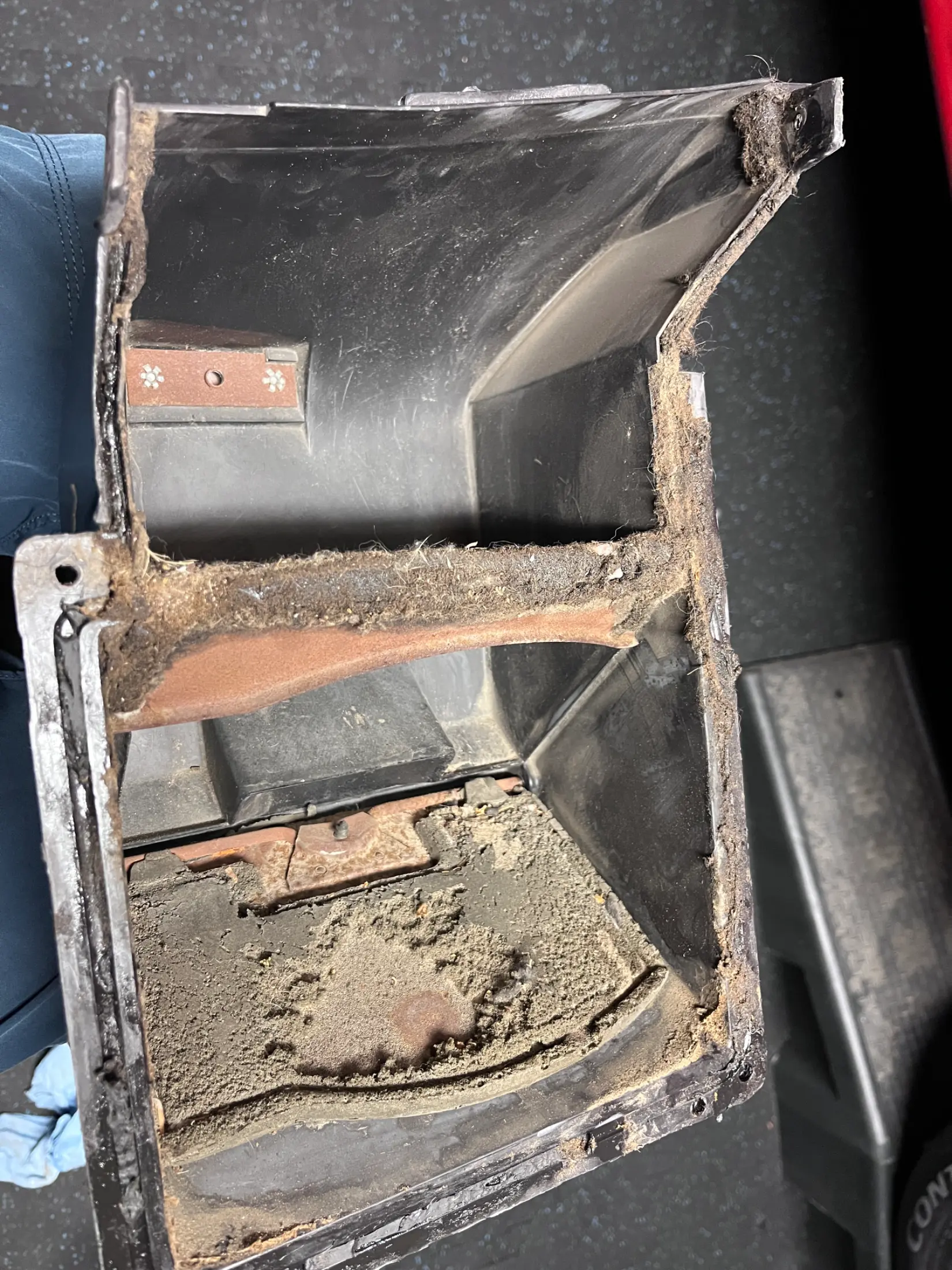

Was poking around the garage tonight, spotted my blower motor sitting on the floor looking pretty ragged, super dusty/dirty so I decided to clean it up.
I noticed the two halves of the assembly weren’t even ‘together’ all the way, and two bolts holding it together were missing. I tried pushing them together but they wouldn’t go…. Too much gunk and butyl was preventing them from sealing correctly.
Old:
Cleaned:
Was pretty much the same story for the other half. Cleaned that up as well… put the two together and used some spare bolts I had laying around to replace the missing ones.
Just need to vacuum the foam seals as they are super dusty but it’s too late to have a loud ass vacuum running.
Edit: I may just buy one of the seal kits from LMR and replace all the nasty foam.

Admin Dude
Jan 4, 1985
43,178
21,344
Box behind Walmart
Mar 18, 2025
#558
  • Mar 18, 2025
  • #558
The new seal kit will give you one less rattle, going down the road.
