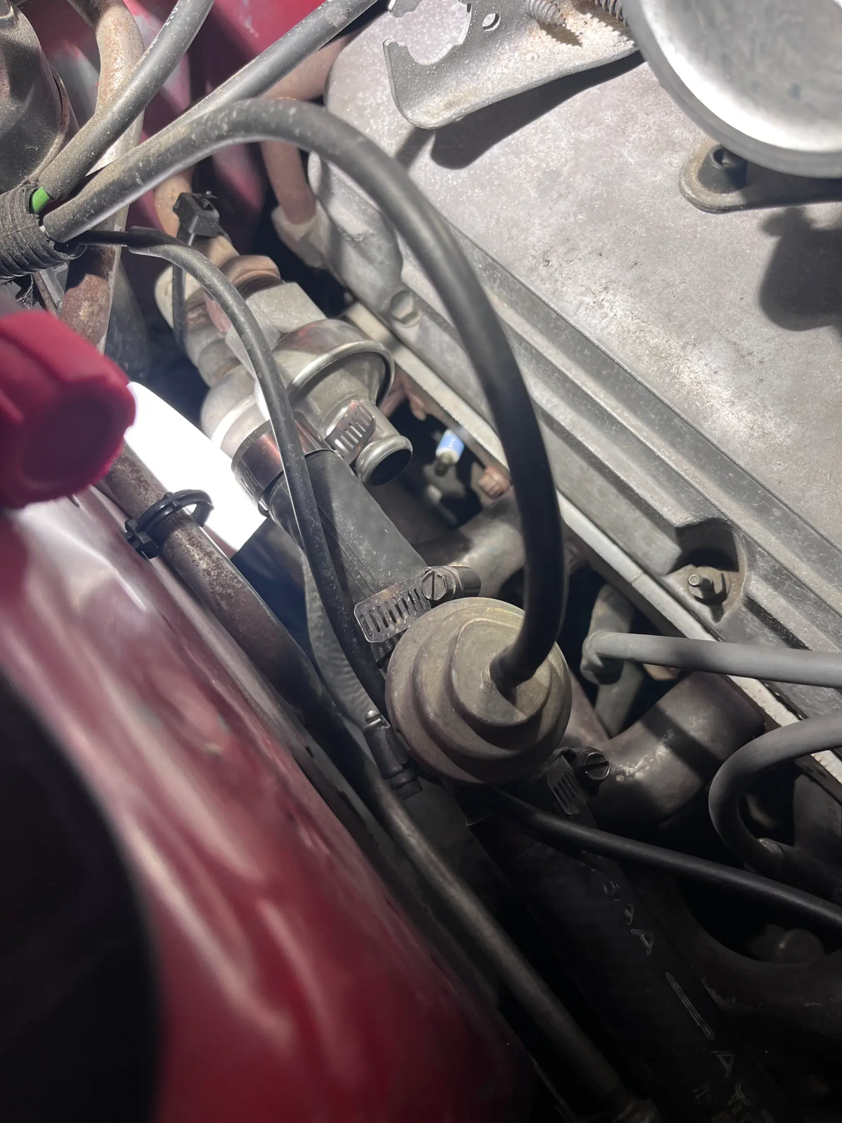

Omg I’m such an idiot, thank you @nicholase for the smog tube suggestion, all I had to do was disconnect one end of the top tube and I got the plug in in like 2 minutes, like this:

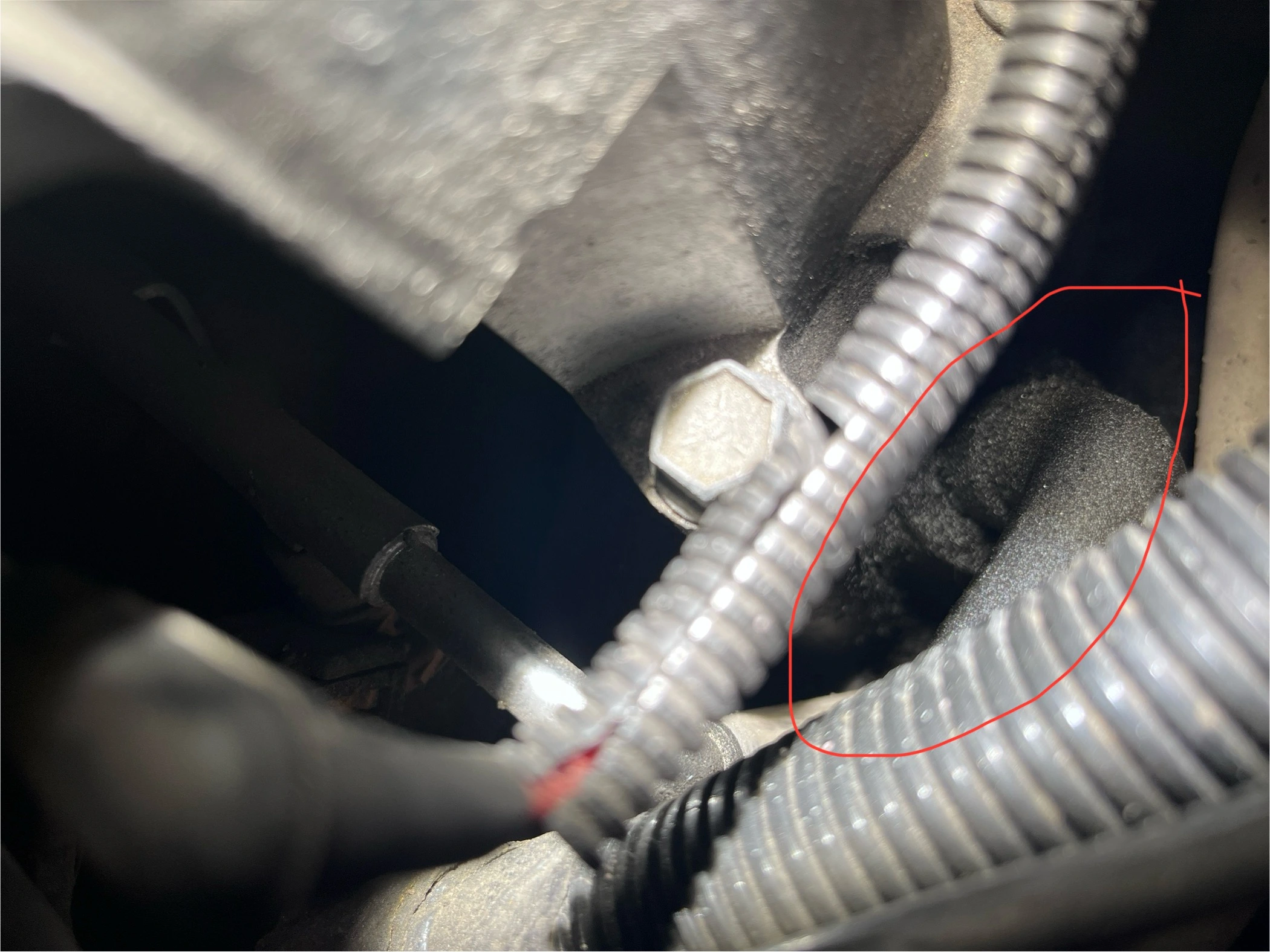

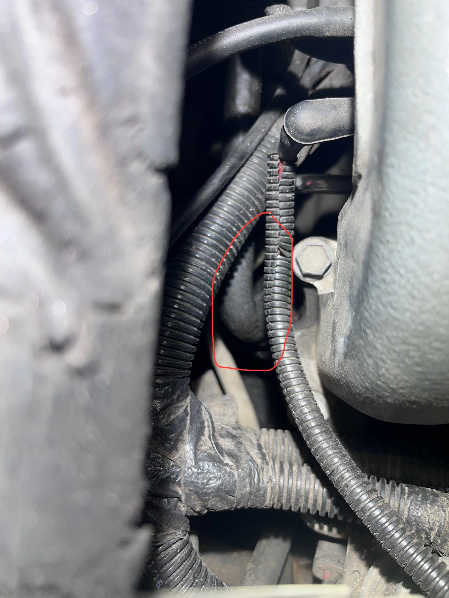

Ok newb/dumb question… but I’m trying to change out my PCV and mesh screen… I know where the PCV is but for the life of me don’t see anything that even looks remotely like the “F” fitting with a vacuum hose coming out of it. Sorry for the bad pics but I ‘think’ the hose circled in red is the PCV but the hose also looks way too big?
Which means even if I replace it I wouldn’t be able to plug that hose back into the new one. Just for more info that hose circled in red goes up underneath the back of the upper intake.

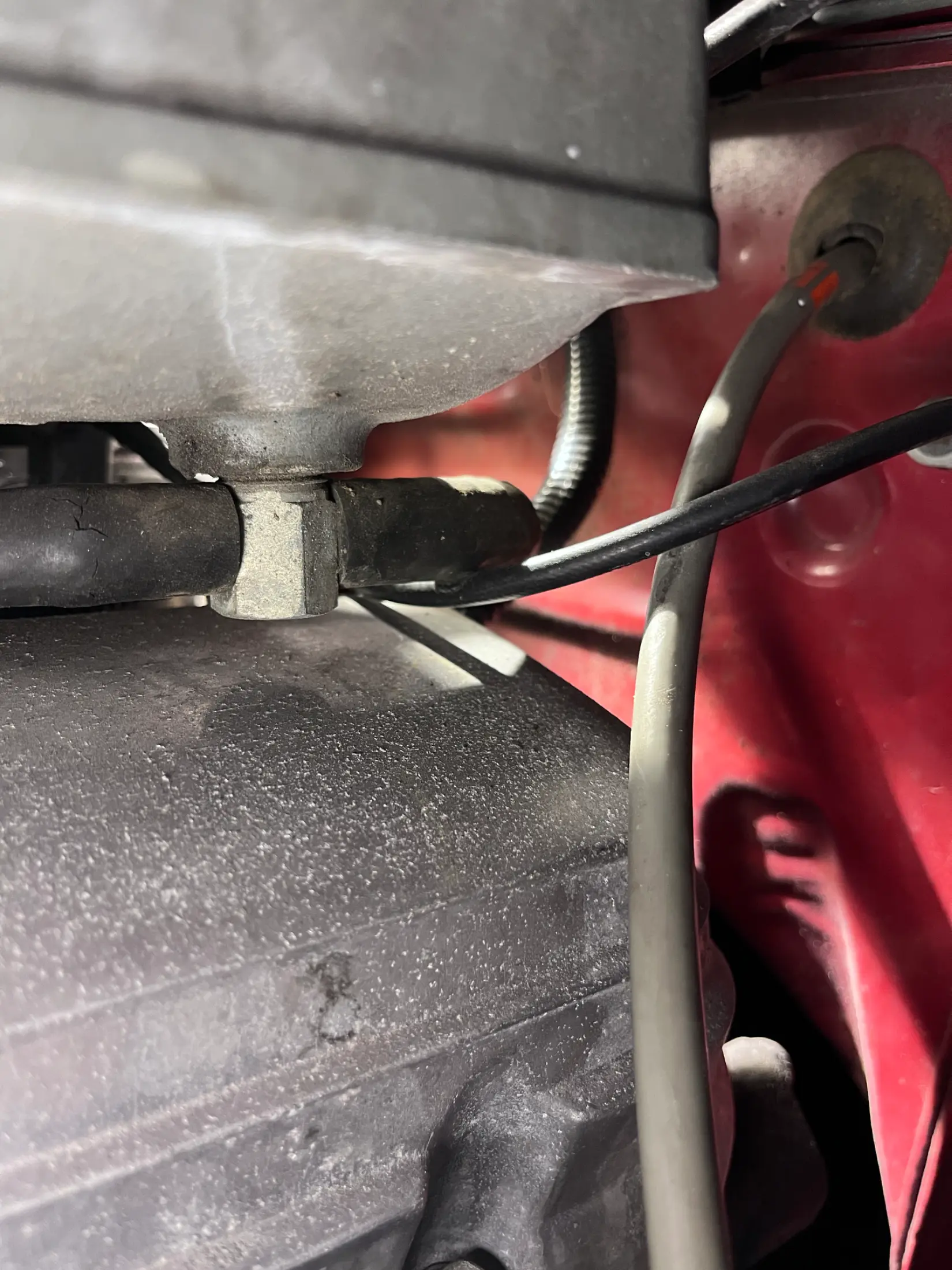

Edit: this is where that hose connects to.
I don't think you're missing anything. If you can see it and can [barely] get two fingers on it, you've probably got the right one.
I think it's a what... 3/8" inside diameter which makes it 1/2" to 3/4" OD? It's dead center of the lower plenum and [really] close to the back of the upper plenum.
You can see the PCV port all the way over to the right.
The PCV valve will likely come out of the grommet before the vacuum hose lets go but... either way.

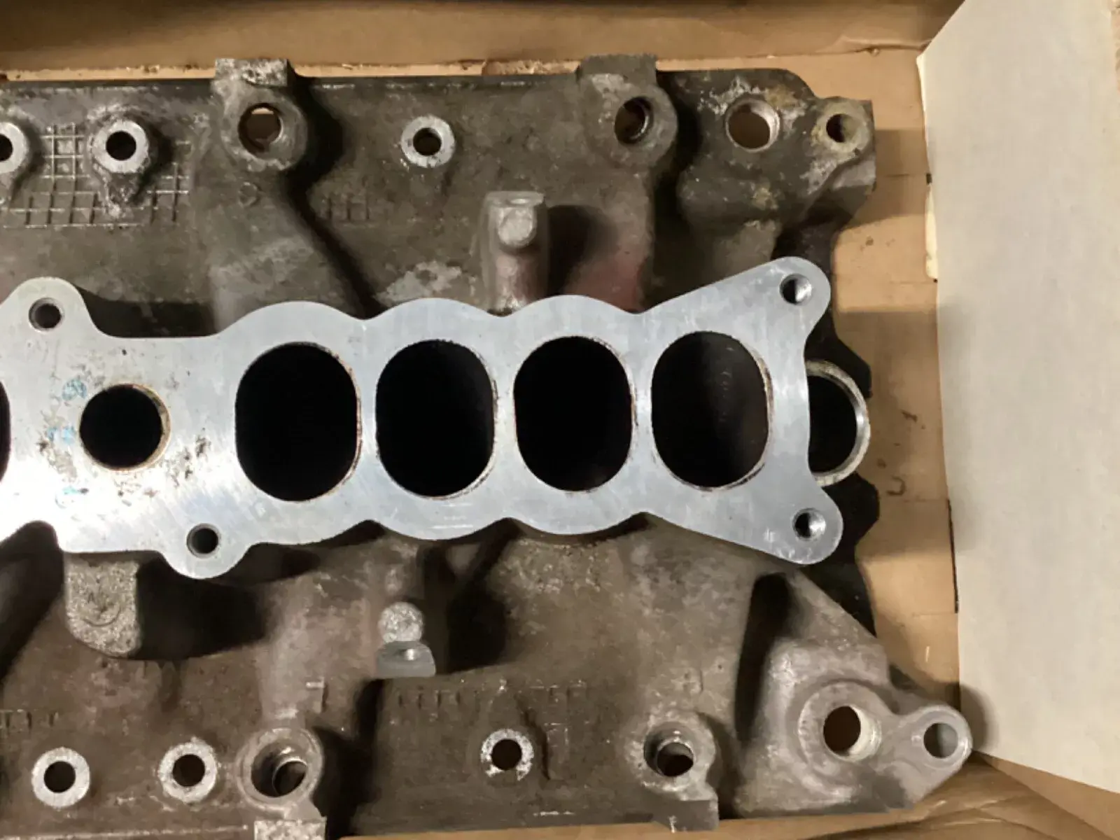

Below that is a grommet:
You may be able to feel the edge/lip of this thing with your fingers.
Below that is the PCV screen:
You may or may [not] have the "F" or vacuum tree on the top depending on model year.
