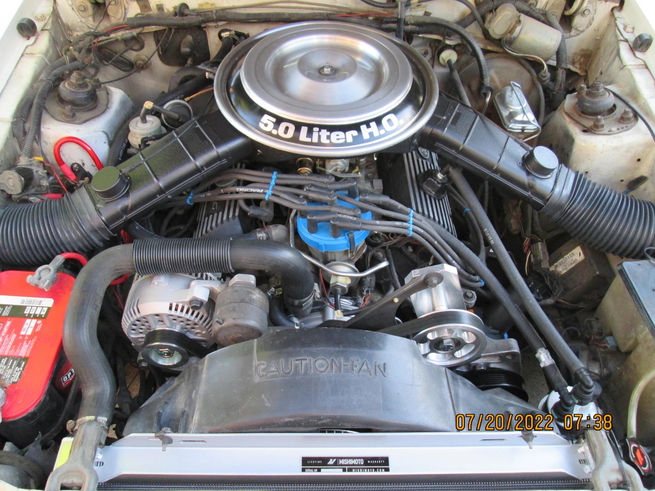

I just noticed the inlet holes are still there for the dual snorkel air cleaner.
Wait what do you mean? I removed the circular plastic cover from the one hole rearward of the normal airbox hole. If I end up going like a power pipe it takes that hole (enlarged) but for now I’ll leave it open. The cover was pretty loose which is why I removed it.
There are two large round holes in the fender wells where air cleaner tubes are attached.

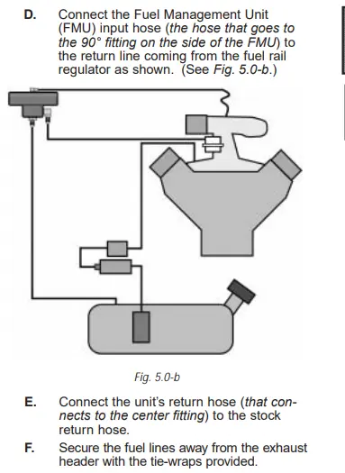

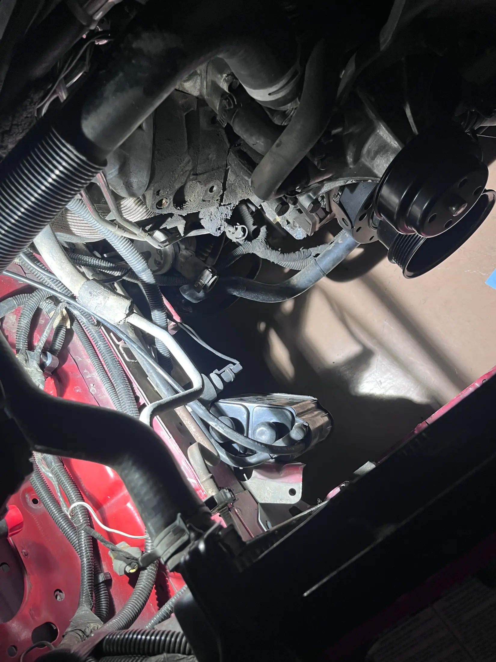

Can someone sanity check my fuel lines for the FMU??
I have the 90 degree fitting off the FMU going to the fuel rail (non shrader valve hard line), the bottom port on the FMU I have going down to the bottom of the engine to hook up to that line… if I could actually disconnect it. Any tips/tricks are welcome.
But, do I have it right? Then I just remove the return hard line completely?
Also, the line I have hooked up from the bottom center port of the FMU (the one just hanging near where the airbox would be), why doesn’t the other end of that line look like the other fuel line? I.e. have the disk and o-rings?

Unless they changed the FMU hook up, you don't have it right. The hard line stays. Unplug the connection like I mentioned above and connect the fmu in series there.
The reason the hard line stays is the fittings on the FMU are male/female. You'll see when you unplug the line. To eliminate the hard line the FMU would need to have two of the same fittings.

Ok so disconnect only the hard line connection (non shrader valve line - the return line) down by the engine block. From that newly disconnected hard line i connect to the 90 degree fitting on the FMU, and from the soft line that runs to the tank connect that to the bottom center port on the FMU?

and as i mentioned previously, Paxtons installation instructions aren't very helpful as they also show the line going up near the fuel rails:

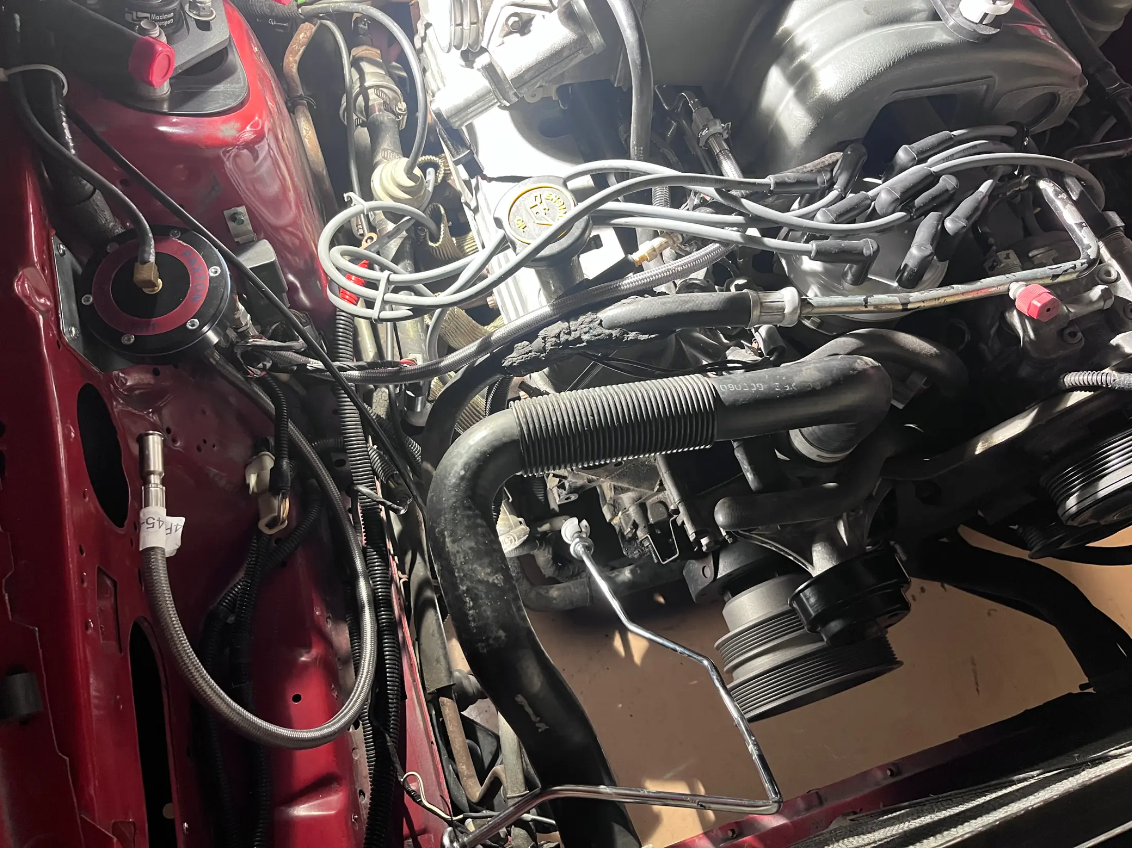

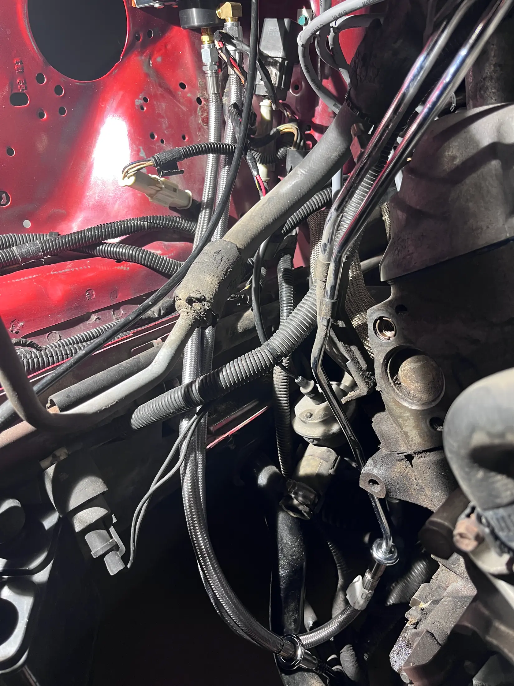

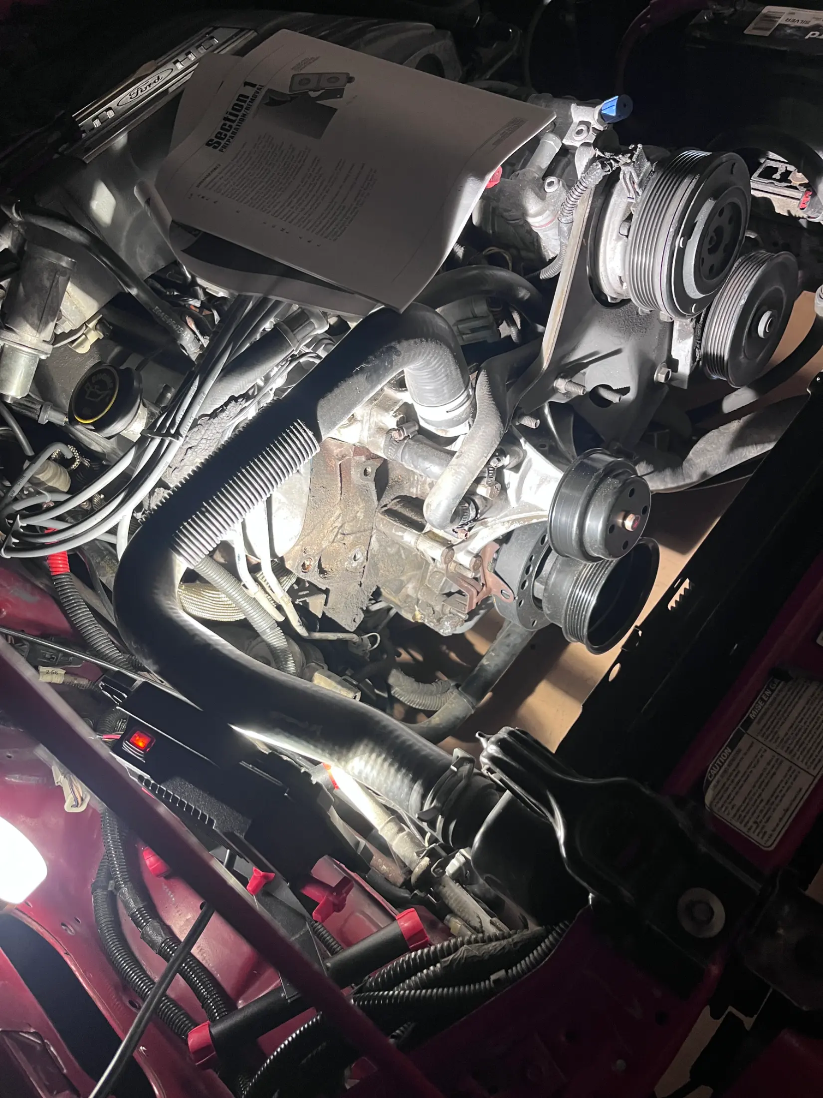

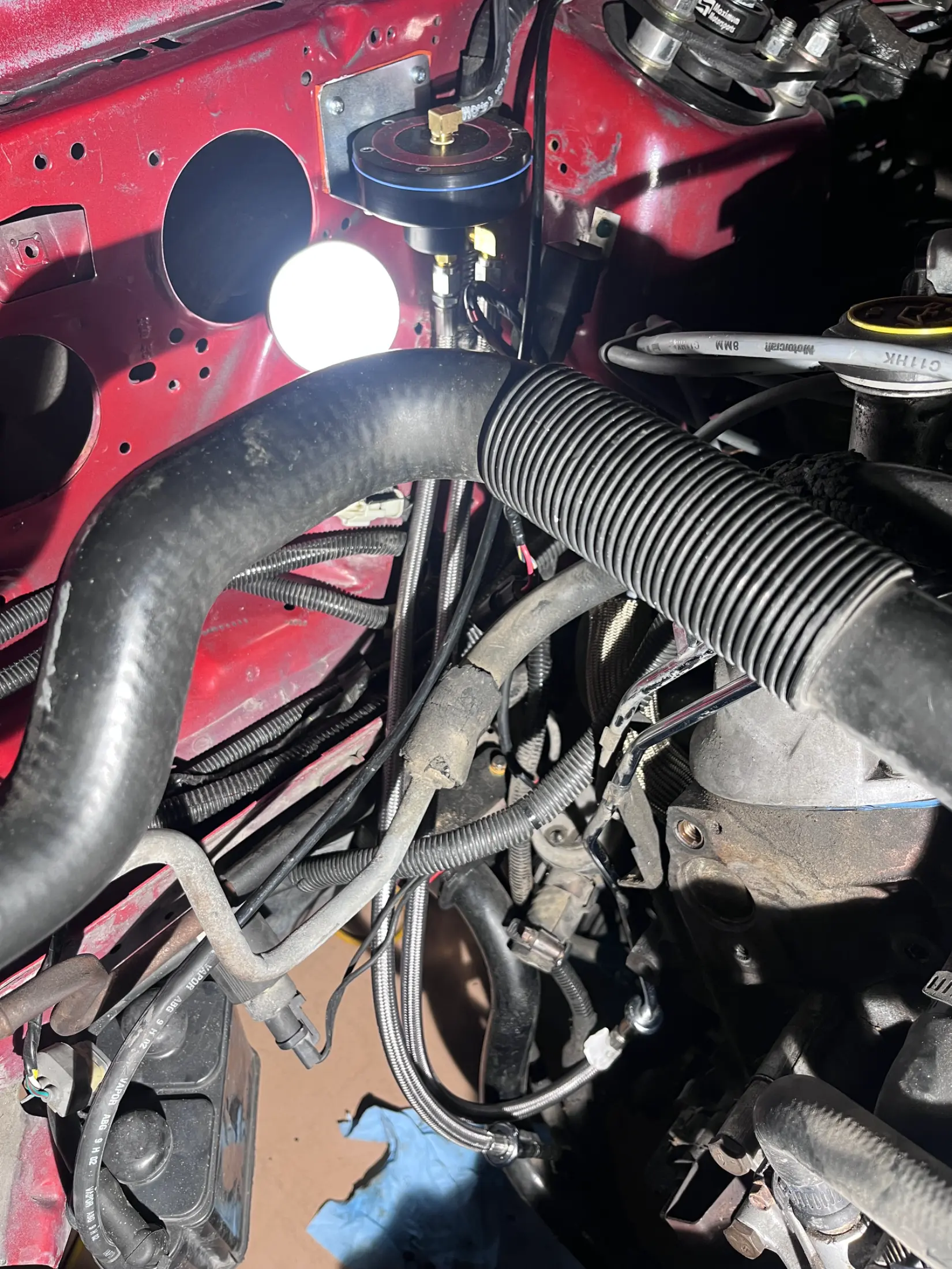

Ok one more sanity check from anyone please. Reconnected the stock fuel rail up by the intake, finally was able to disconnect the other side of that hardline from the soft return line to tank… swapped my Paxton fuel lines on the FMU and ran them as @nicholase suggested, and yes once off you’re right there is only one way to connect both of them… just need to make sure they are connected correctly on the FMU. Anyways, sorry for the bad lighting this is my nighttime working conditions, lol
I tried to adjust my lights the best I could so you could trace the lines from the FMU down to the soft/hard return lines. I’ve connected everything but just loosely until I know they are correct.

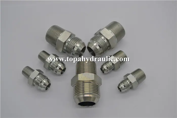

The fitting going into the FMU are compression fittings. The seal is made against the nose of the fitting:
The torque on these is [important] and they should [not] be overtightened. Torque to what the instructions say.

The FMU does have a direction of flow, I’m like 99% sure I’m good to go as I have it now. Side port to hardline off rail, bottom port to soft line to tank.

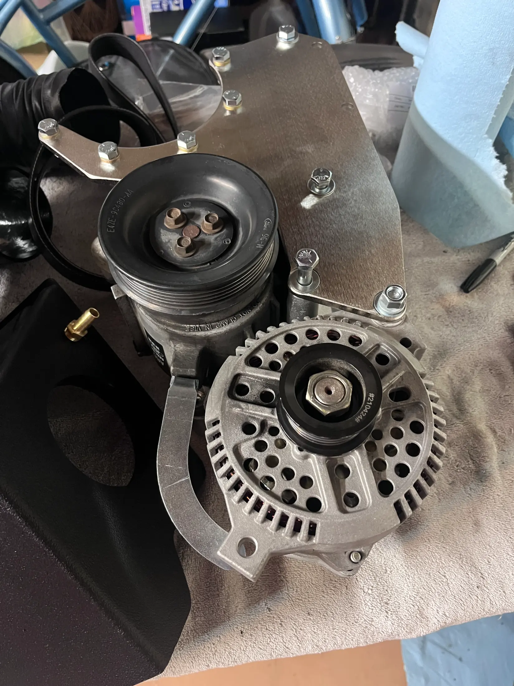

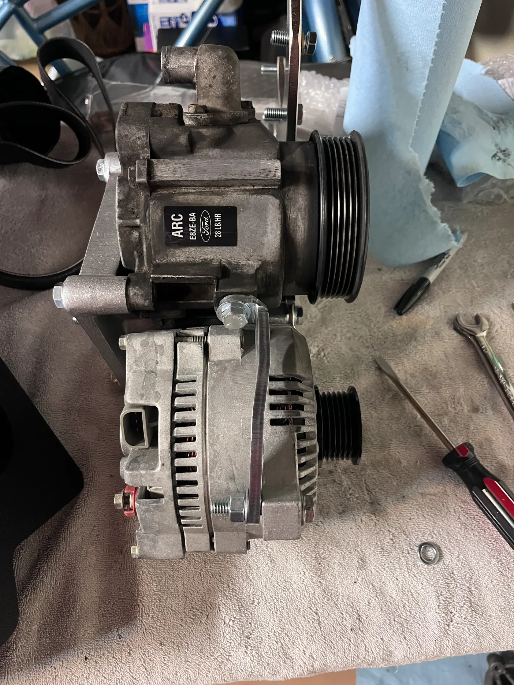

May have hit my first snag due to this kit needing to be on a completely stock engine. I am assembling the accessory mounting bracket and with the 3G alternator I can’t get the alternator ’stay’ bracket lined up correctly because the 3G is larger, and also its mounting boss isn’t threaded, and neither is the bracket, shown here:
So the bolt they call out is 1. Too short (assuming 3G mounting boss is also thinker) and 2. not threaded.
So, I thought I’d just put a bolt and nut through it, but then it cockeyes the alternator so the pulleys don’t line up, as shown here:
One other semi non-related issue, the 2” bottom bolt called out holding the smog pump on in the instructions says to go In from the front but it’s too long where the smog pump to alternator bracket boss gets in the way. So I went in from the back to make it work.
Any ideas on the alternator situation?
Also the kit comes with lock washers but the instructions don’t say where to use them. Frustrating how bad the instructions are.
