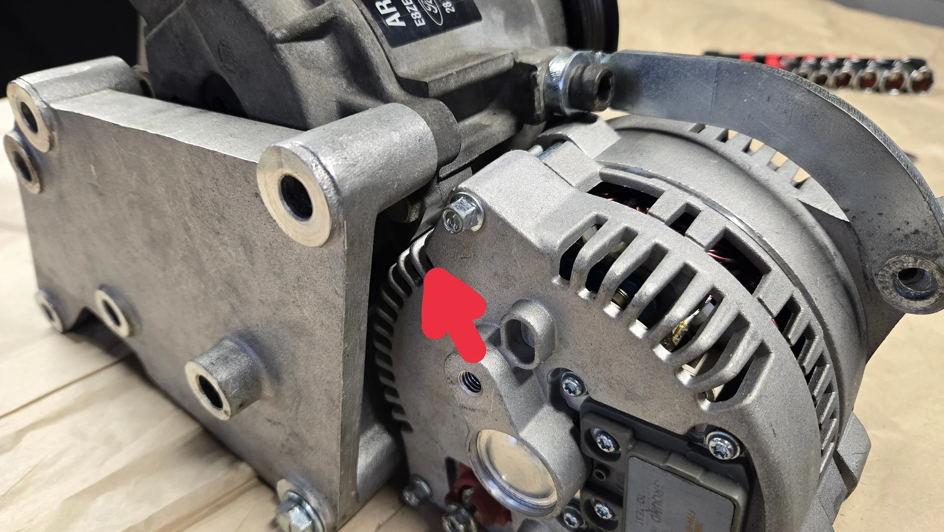

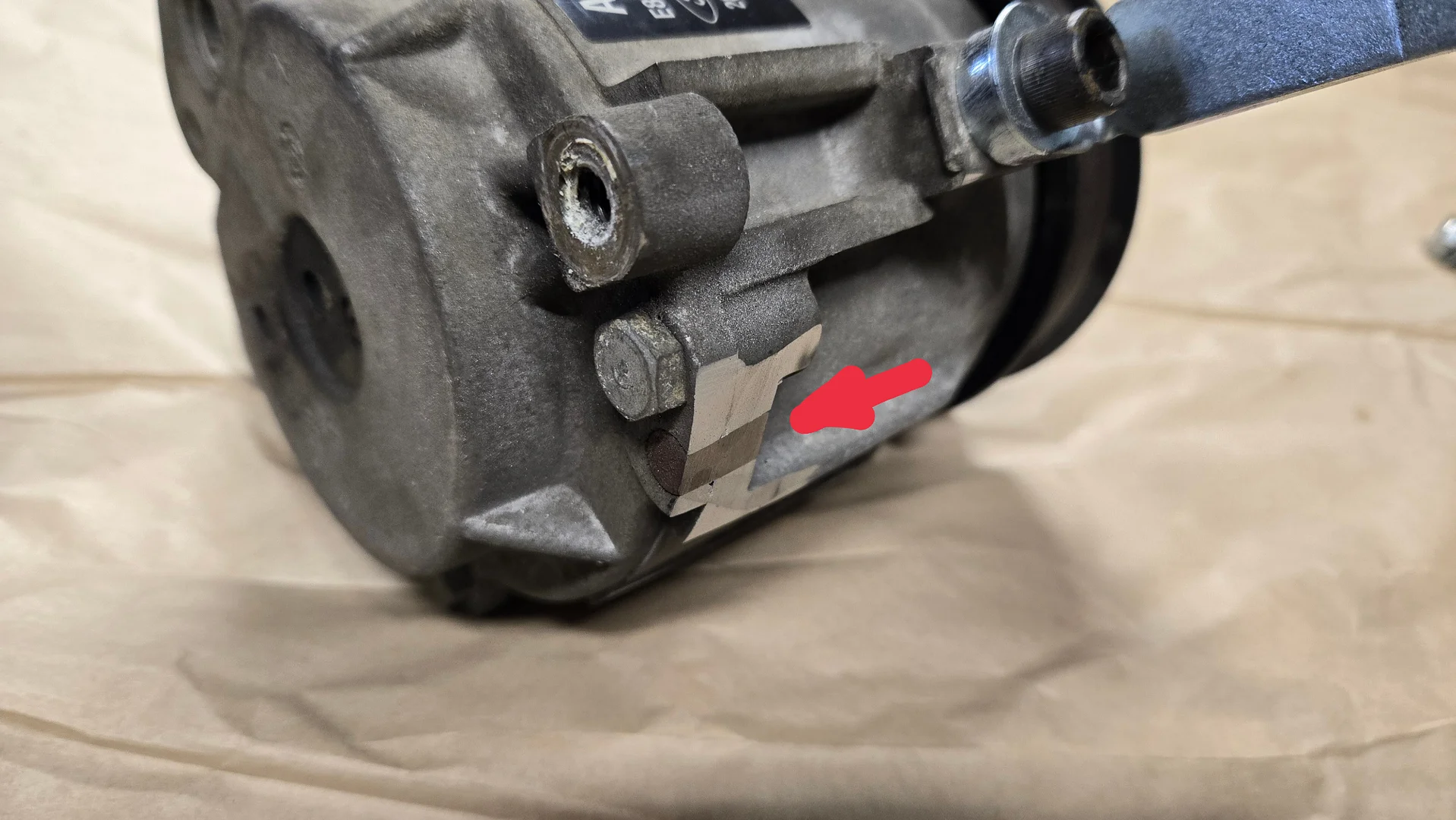

It looks like the alternator needs some grinding and the bracket needs some adjustment.

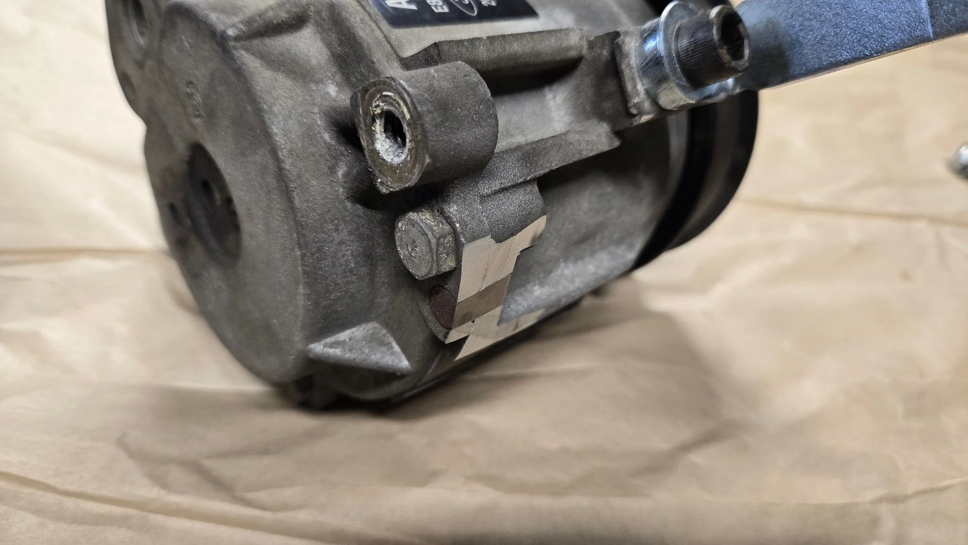

Your alternator is probably hitting the smog pump here
If that's the case, you'll want to clearance the smog pump like this
When you get that sorted you'll want to snug up the long alternator bolt. Then check the alternator stay sits flush against the alternator ear. If it doesn't you'll have to bend it until it does. If it's not sitting flush it will pull the alternator out of alignment when you tighten it.

I just went out this morning and see the exact spot you’re referring to on the smog pump, so I will dremel that down. Makes sense that it ‘cockeyed’ the alternator when I snugged the stay bracket down because that smog pump boss is offset.
I’ll definitely doublecheck the pulley alignment once together and bend that bracket if needed.

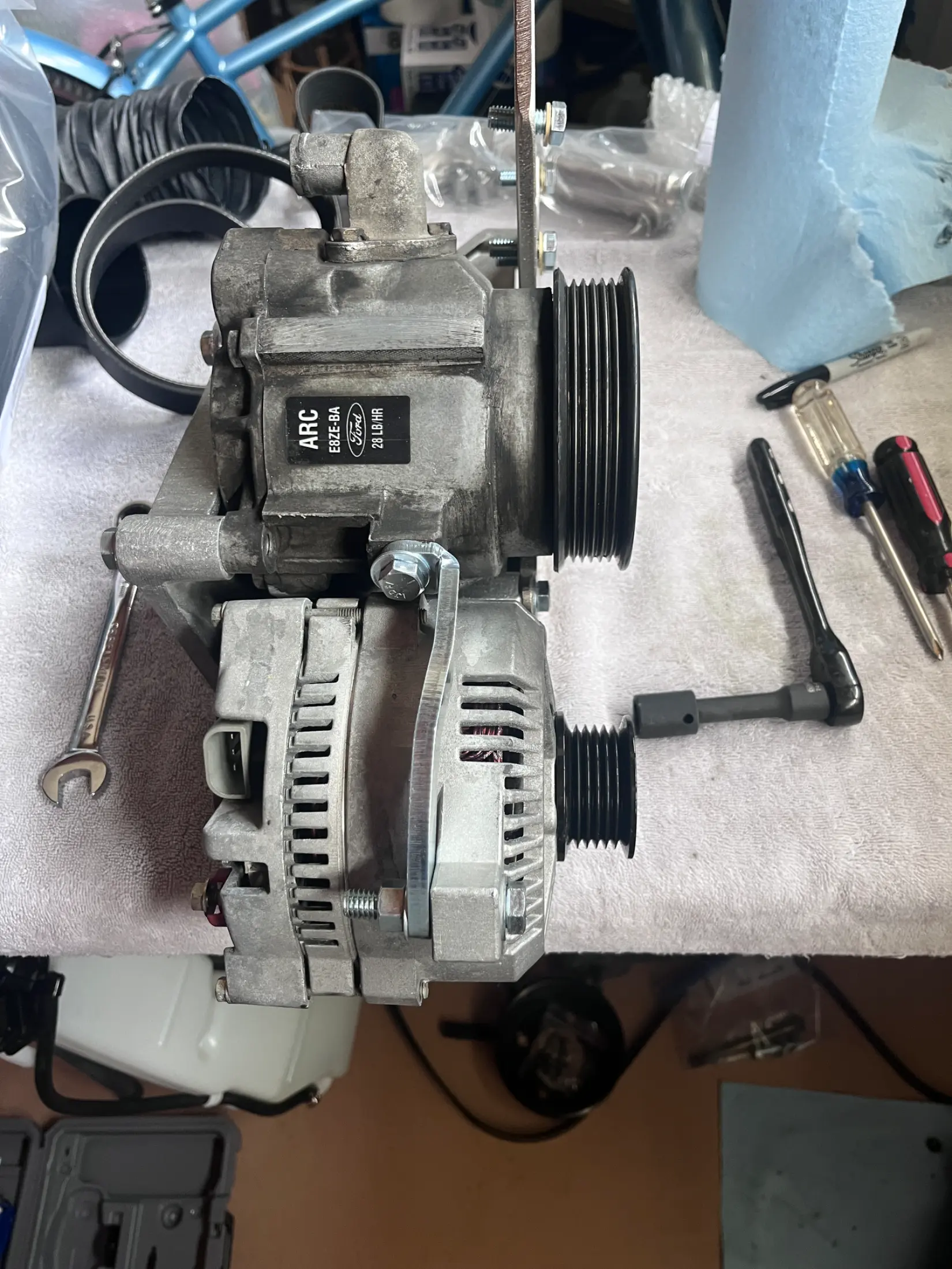

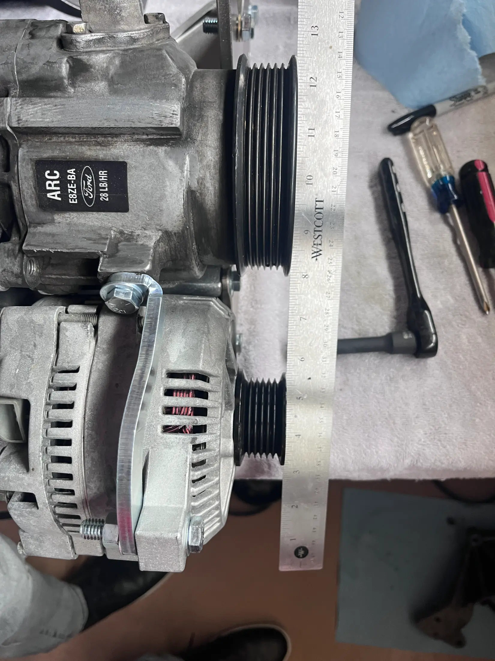

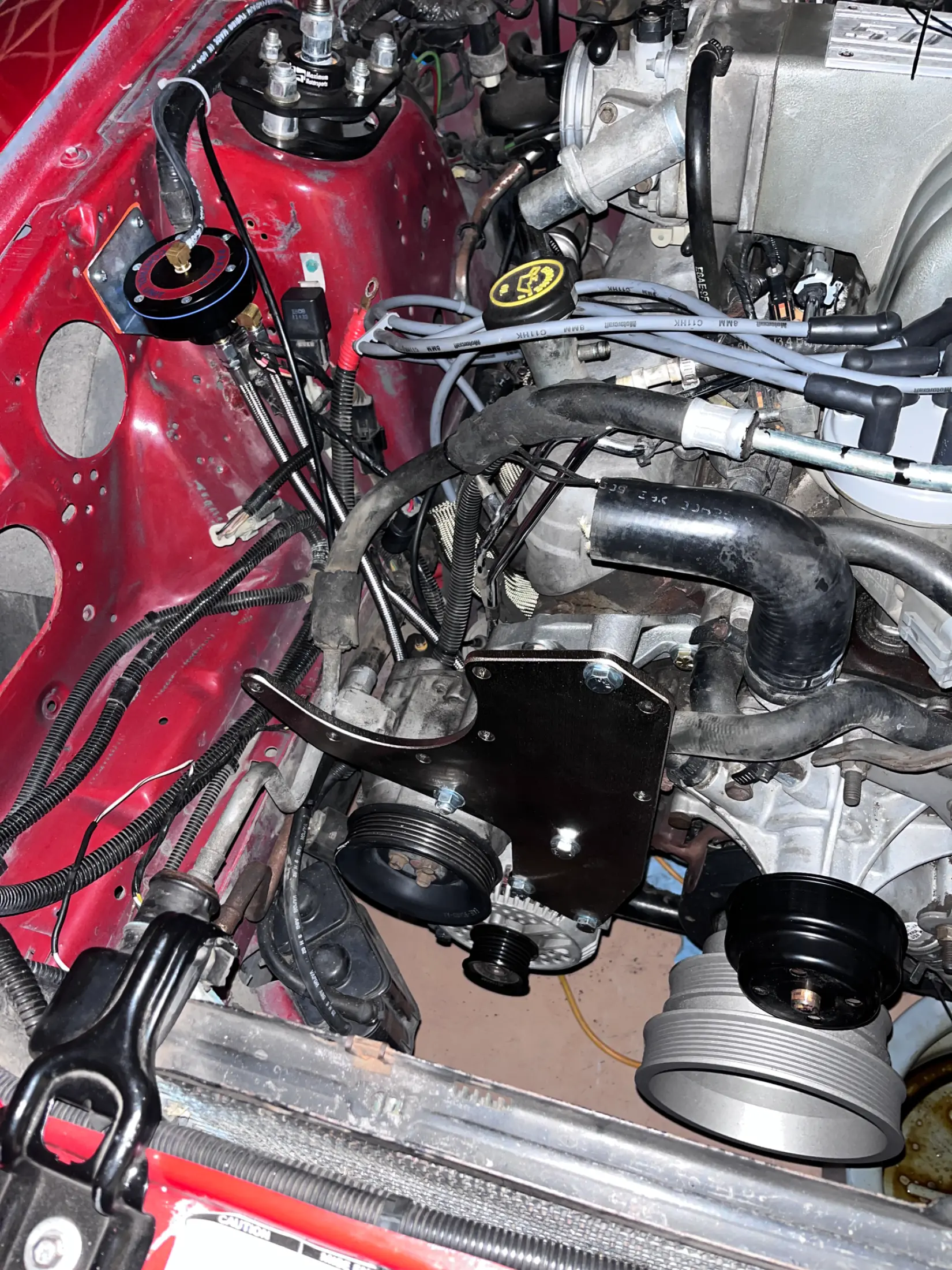

Got the smog pump boss dremel’d off, and the alternator on with the stay bracket. Pulleys ‘look’ to be lined up eyeballin it and I put a straight edge on them and there’s no gaps that I can see:

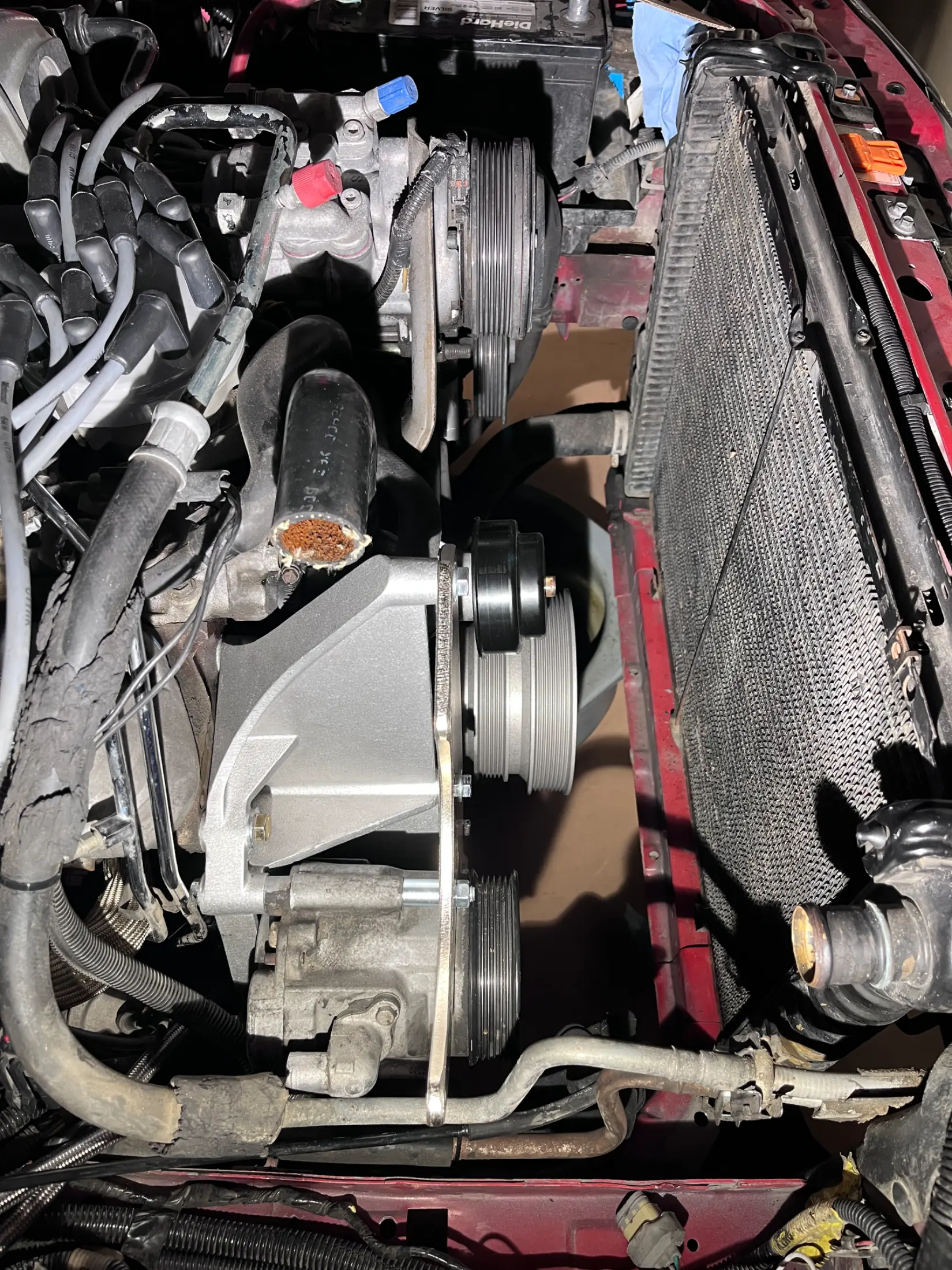

Got the main accessory bracket on the front of the engine. Jesus I hope I got everything right because I do not want to do that again by myself. It’s heavy, tight space, heavy, and tight space. The top right bolt is a pain, many adjustments shimmying the whole assembly up/down/left/right to get it to line up correctly.
Need to route wires and connect the alternator back up. Want to look at the fuel lines as they seem tight.

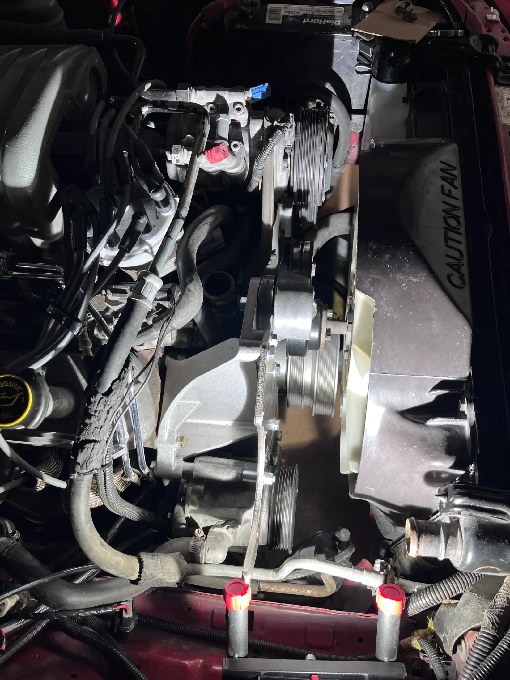

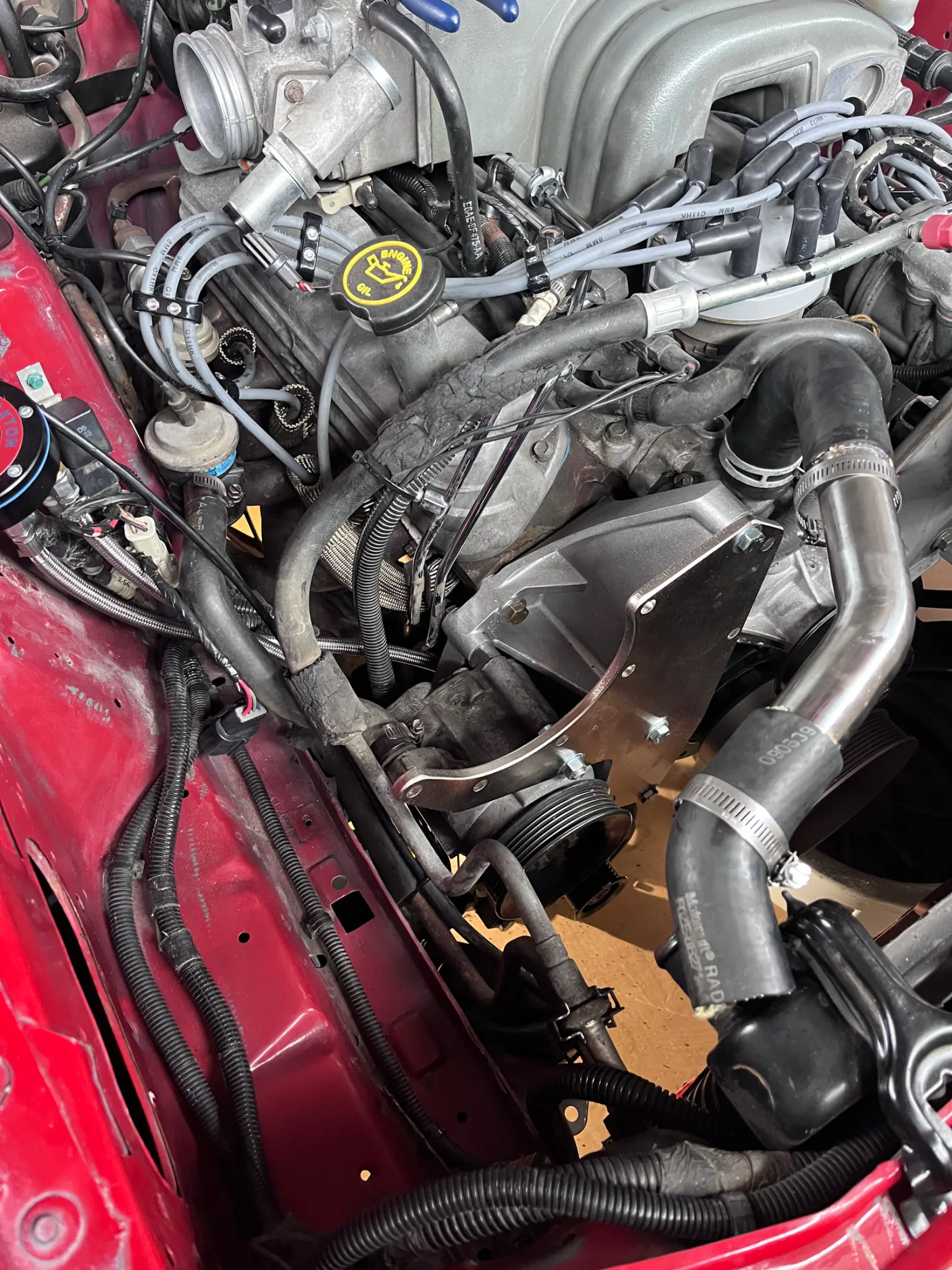

Got the belt tensioner on and put the fan and shroud back on:
Just need to tighten the fan/waterpump bolts down, they are just finger tight. One thing I had to do was move a coolant pipe up and over the thermostat housing (closer the TFI module) because it was getting sandwiched between the new tensioner bracket and the thermostat housing, which wouldn’t let me put the tensioner bracket on.
Next is running the serpentine belt, and then I get to put the supercharger head unit on! Don’t see why I couldn’t start all that before my new radiator hose comes in.

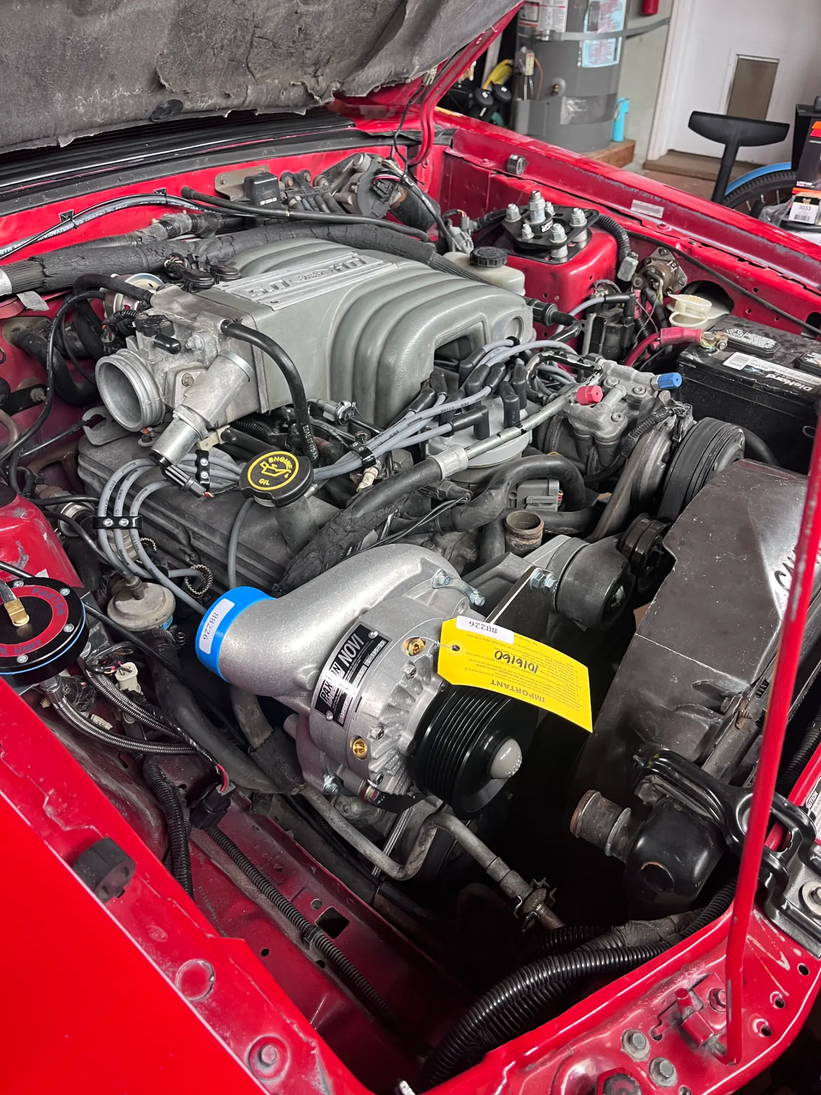

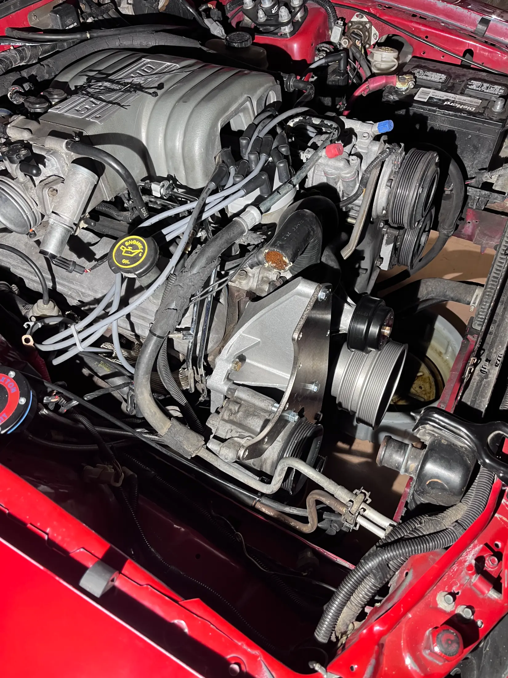

I feel like this is the biggest milestone in this endeavor and it was like the easiest part. Bolts not tight yet but she mounted. Got the oil drain line on and ran it down the side of the smog pump, will zip tie it in a good location.
I had to revert back to the stock GT length drive belt, the cobra one was just too short. Luckily I kept it and it was almost brand new from the PO… tensioner is almost right in the middle, little more on the tight side but still perfect IMO.
I also reconnected the battery and turned the key on (didn’t start the engine) to let the fuel pump prime a few times and checked for leaks at the new fuel line connections and FMU, which I did not see any. Not sure if it would tho as it’s all return line stuff. I’m not smart on the fuel system.

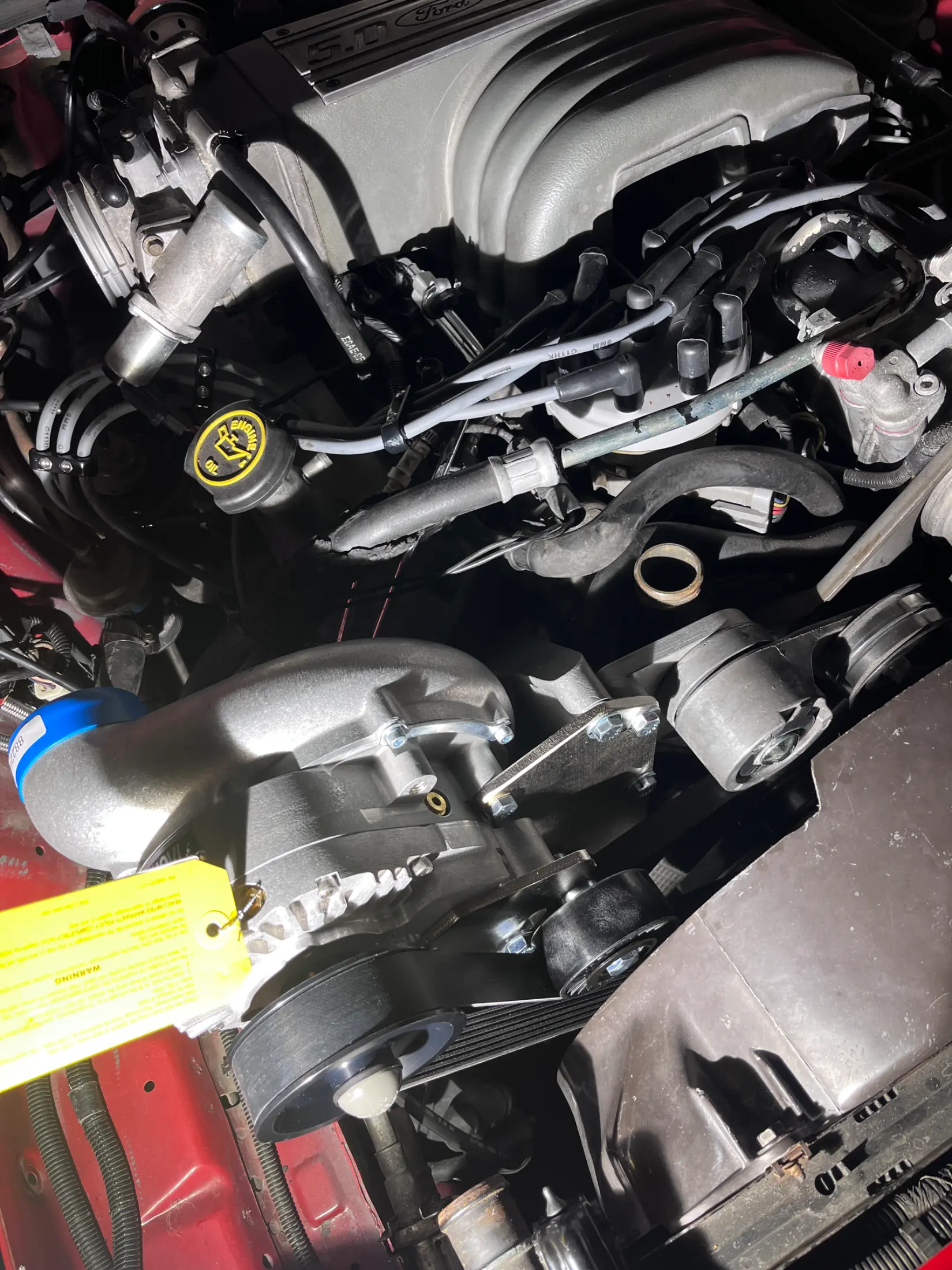

Got the supercharger belt tensioner on, for such a simple part this was actually quite the pain in the ass due to where the bolt heads are in relation to the actual belt. And whoever designed the pivot bolt location needs to be fired. It’s so close to the tensioner pulley you can hardly get the wrench head on. Was a game of 3/4” wrench 1/16th turn, random small crescent wrench 1/16th turn… and so on.
I also went through all the front bolts and double checked my tightness and marked them with a sharpie.

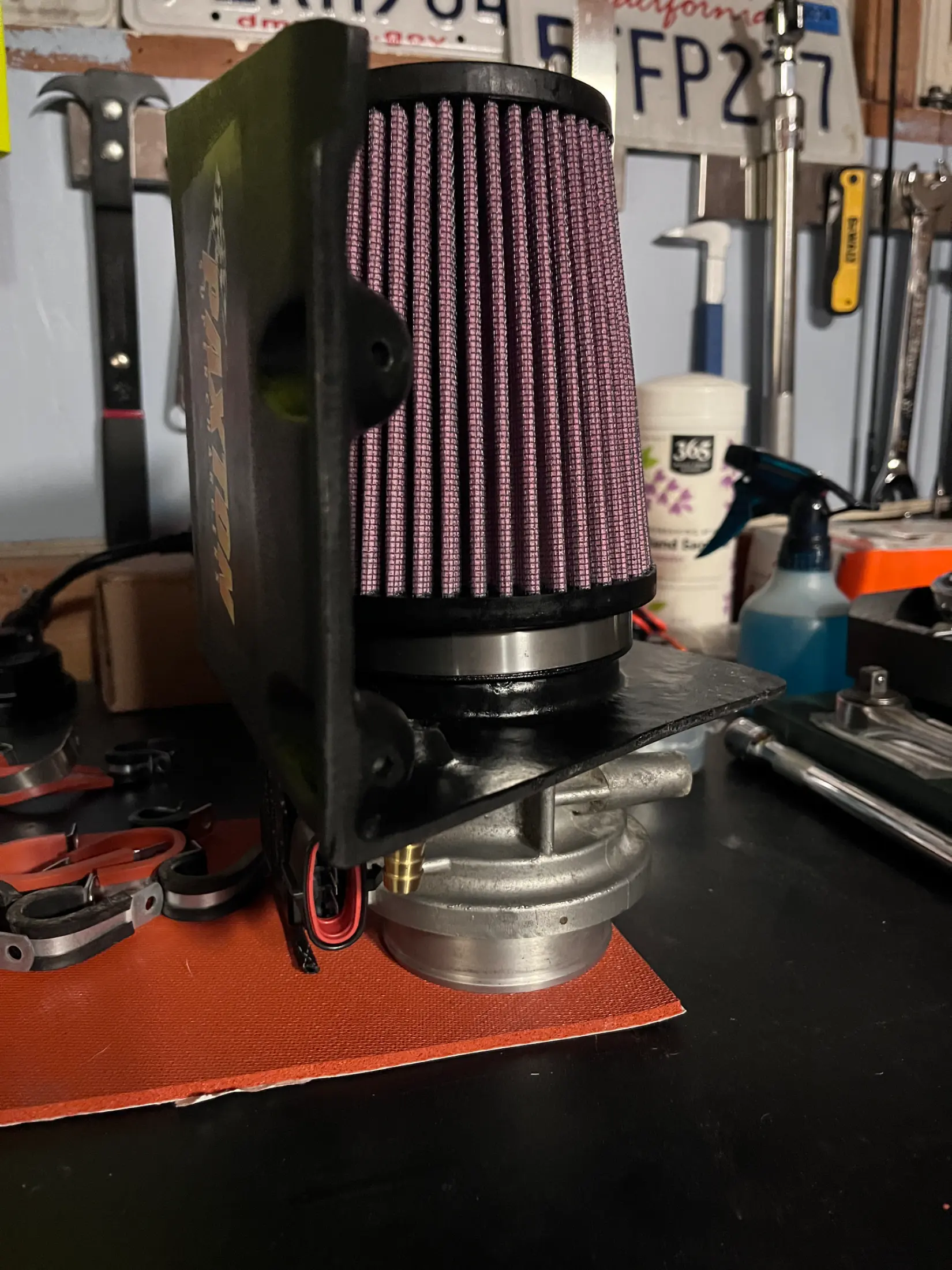

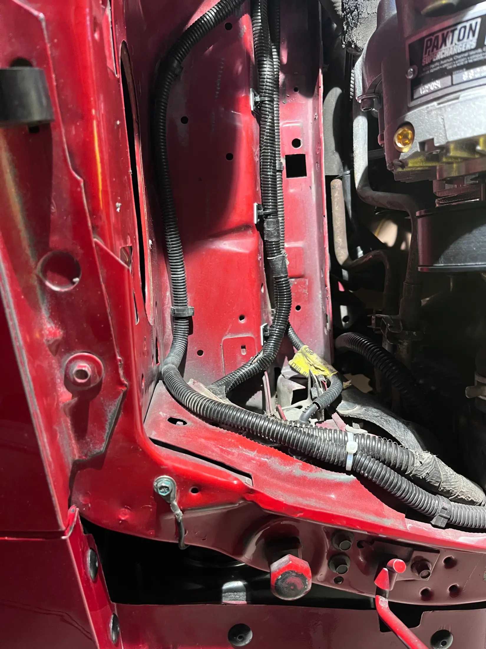

Making a little more progress on the intake tract. Got the filter assembly in. This was a major pain in the ass, the stock MAF housing is definitely too big for the opening of the plastic shield. I had to lightly sand the plastic opening, as well as heat gun it slightly to finally get the MAF housing to go on:
Then, when I tried placing this whole assembly down into its final resting location, I now know I need to retract my previous statement (somewhere above) when I said I didn’t see why the ground cable need to be relocated per the directions. Not only does the ground cable need to be relocated, but both those wire bundles do as well. You can’t have ANYTHING there, it will snag the filter. So I’m in the process of getting those wire bundles moved. I’m going to move them down into the bottom fender channel and run the more up near the radiator side:
So here I’ve already rerouted the ground cable and one of the two wire bundles. Need to reroute the other wire bundle shown on the left side of the photo. Again, the instructions are garbage.
