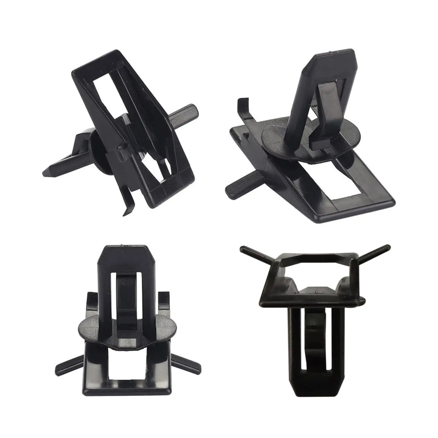

Maybe these GM clips would fit with some modification?

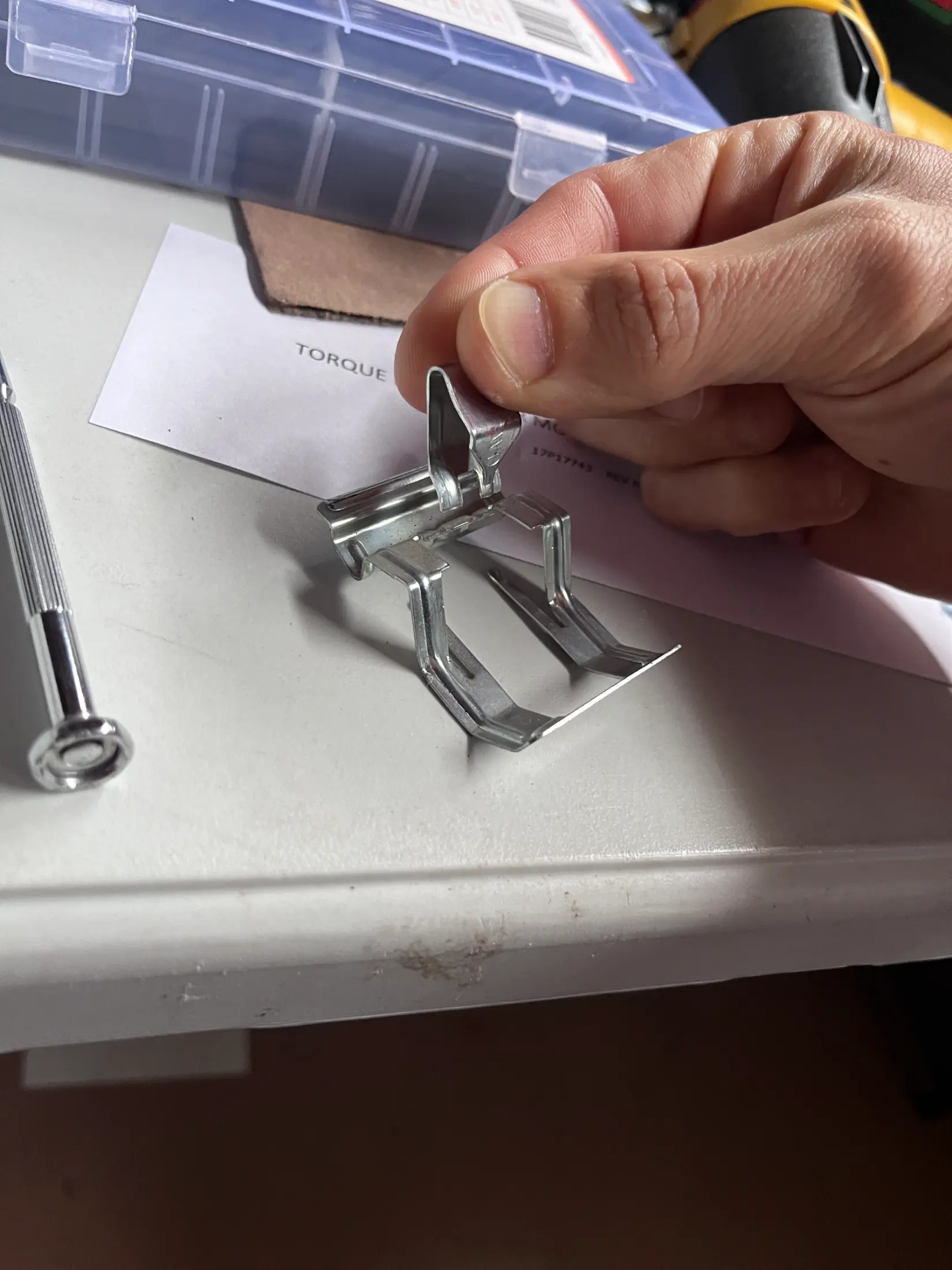

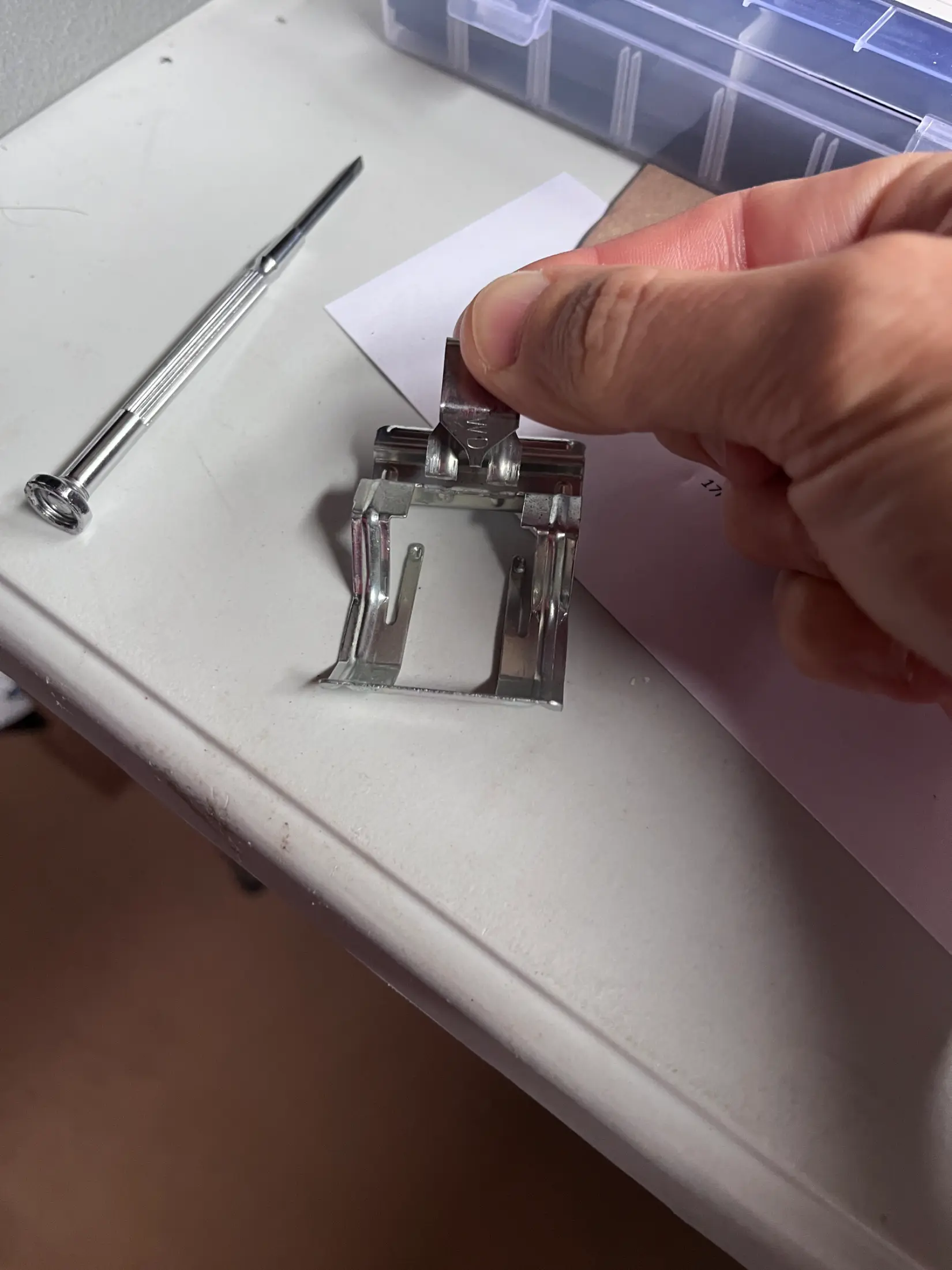

The number for that part in the Shop Manual is:
03552 - Windshield Upper Garnish Moulding Retainer - 3 Req'd
I do not see them anywhere. I wonder if they have been replaced by something else? :shrug:
These are the closest I could find for you…. They look on-point…

Geezus those are some expensive clips. I’ll put a little effort into researching alternates then, if no luck, bite the bullet and buy that $25 eBay one if needed. Sucks but looks like my bad for breaking it.

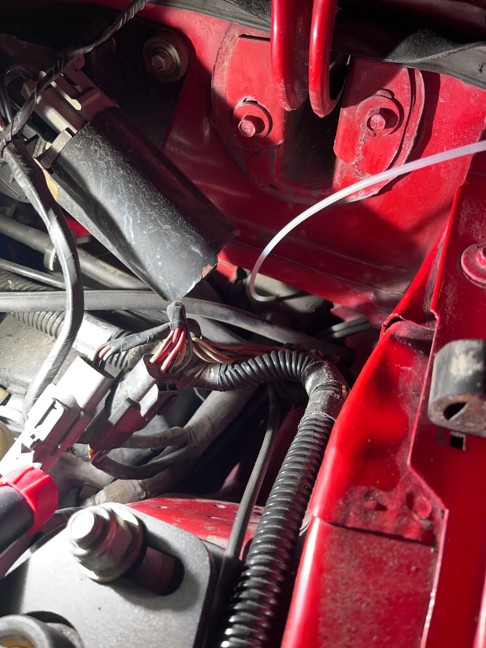

Next up was running the vacuum line from the boost gauge through the firewall. Went through I think the main engine harness grommet. This was a royal pain in the ass and took me many many tries to not have the line separate from my fishing tool (coat hangar). Was hoping to hook it all up but it took so long getting it through I ran out of time. Here’s where I left it:

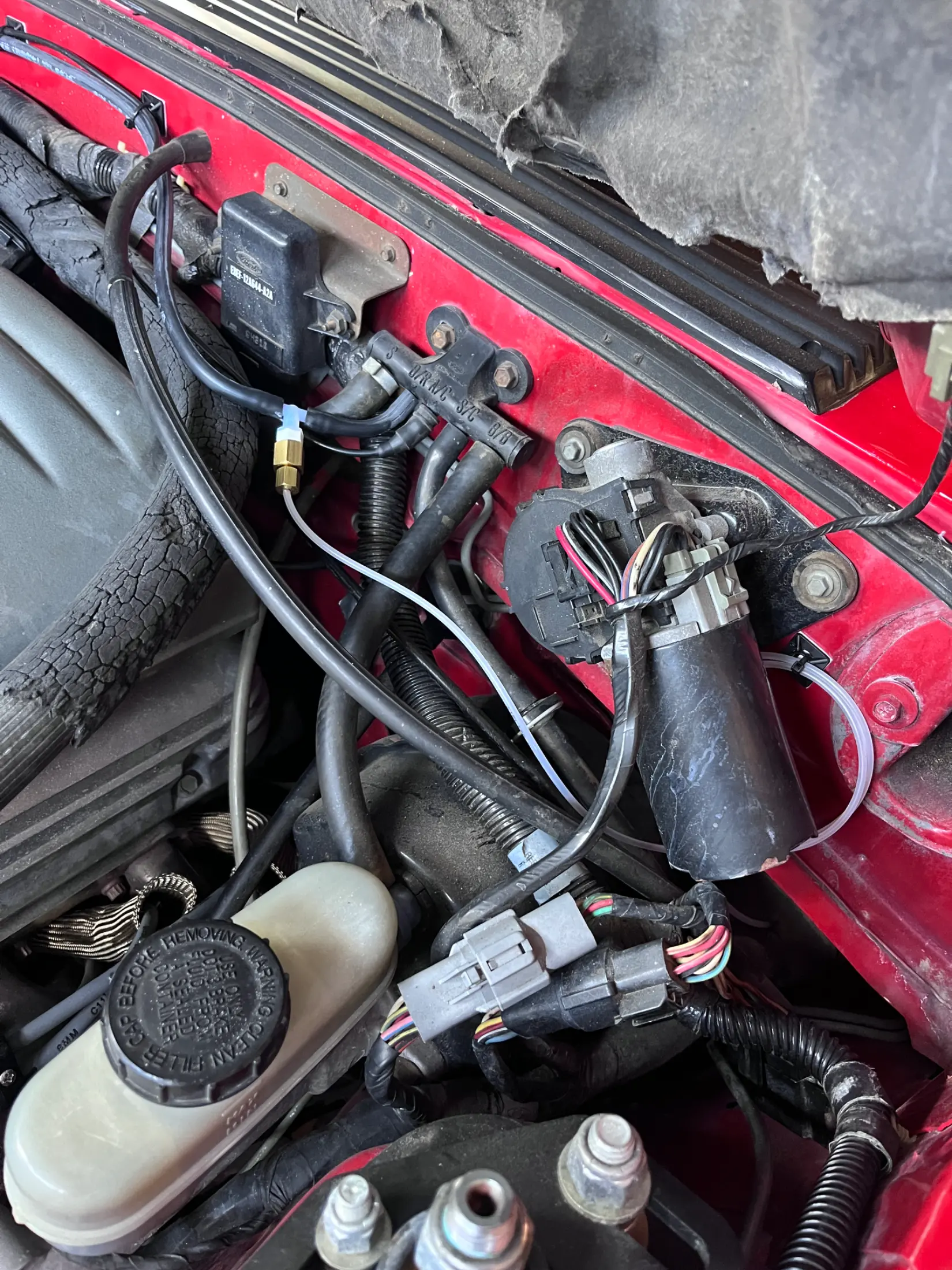

It’s the white line there. Connecting it to the B/R vacuum line should be a 20 minute job. I left a little slack under the dash for oopsies, which with me, I’m sure will be needed.
For the wide band, I almost want to go through the floor instead of the firewall. I may drill and put a grommet for that cause I have to get an entire connector through.
Got the vacuum line hooked up. Should complete the boost gauge install. Besides finishing the wide band install ( weld bung, install O2 sensor and run line from kick panel to O2 sensor ) I believe everything is done. Just need to start her up and burp the coolant… again. It’s surprising how I can’t get like 30 minutes alone to let the car idle with occasional revving it up a few times.
As you can see I left a loop of excess in the engine bay as well just in case. I still cut off quite a bit of the hose length to get it to this point.
