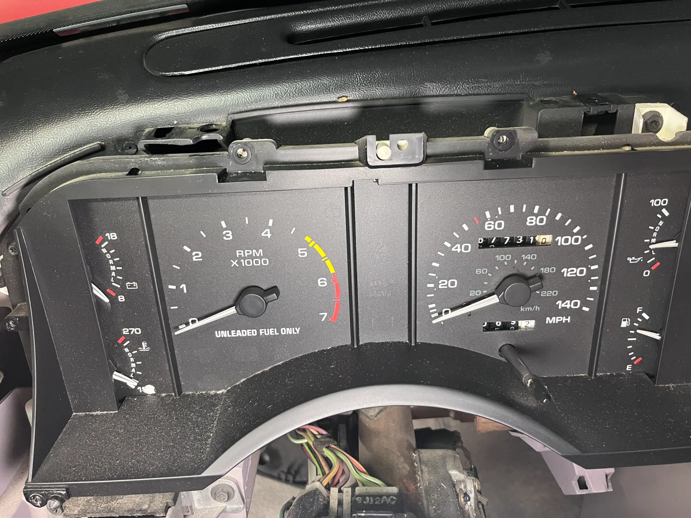

So with all that done, I moved onto putting my speaker grill on that I couldn’t get to with the dual gauge pod in the way. As I assumed, it’s super easy with the cluster surround out of the way… not that it’s super easy to take that off, however. Of course, since I had that off I might as well clean the inside of the cluster and polish the lense front and back, so off that comes!
Here you can see how dirty it was inside:

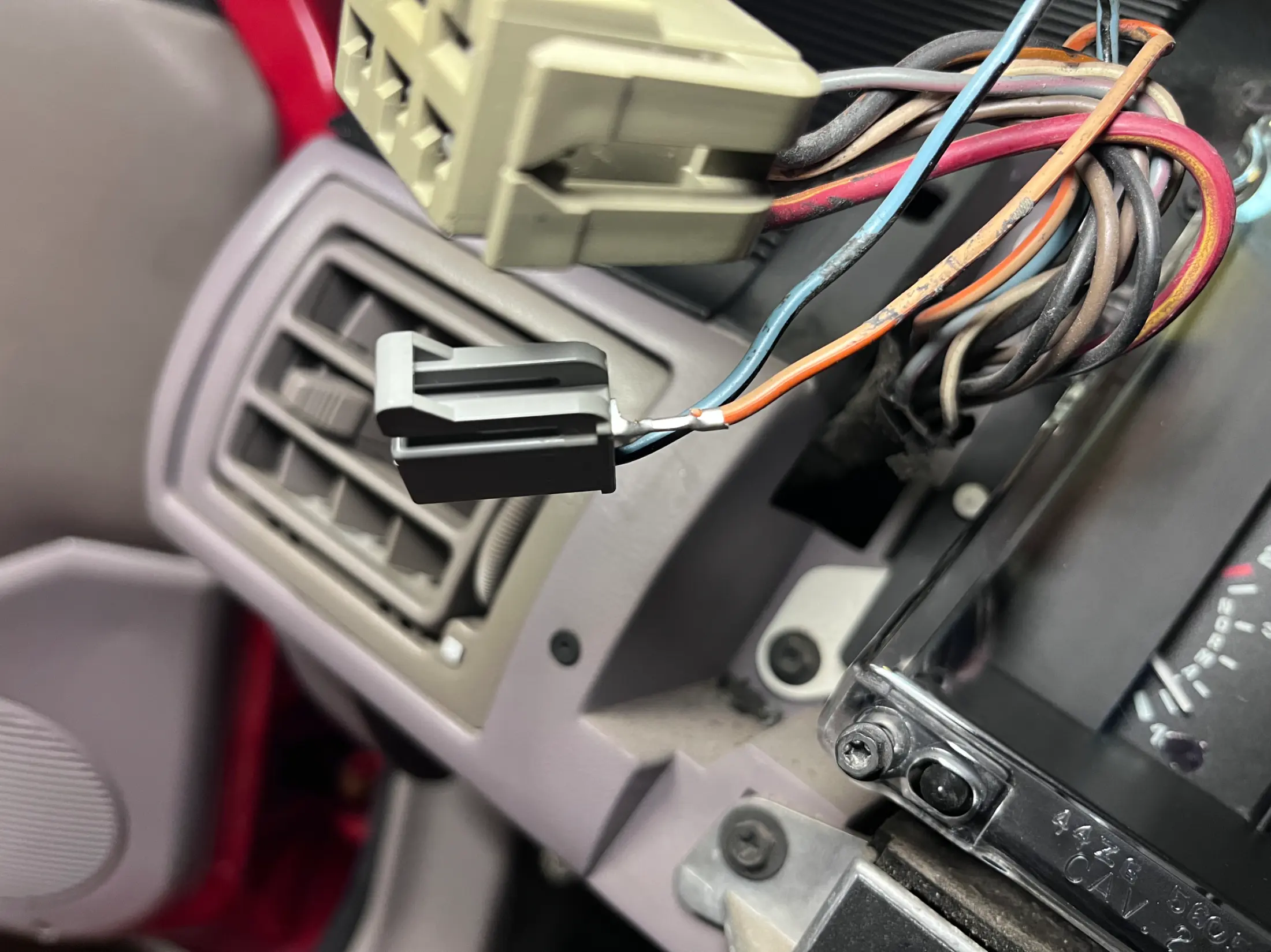

Oh and I figured out why my fog lights don’t turn on… broken connector which doesn’t hold the orange/red-ish wire in place:
So I’ll see if I can order a new connector (thankfully doesn’t stop me from reassembly).

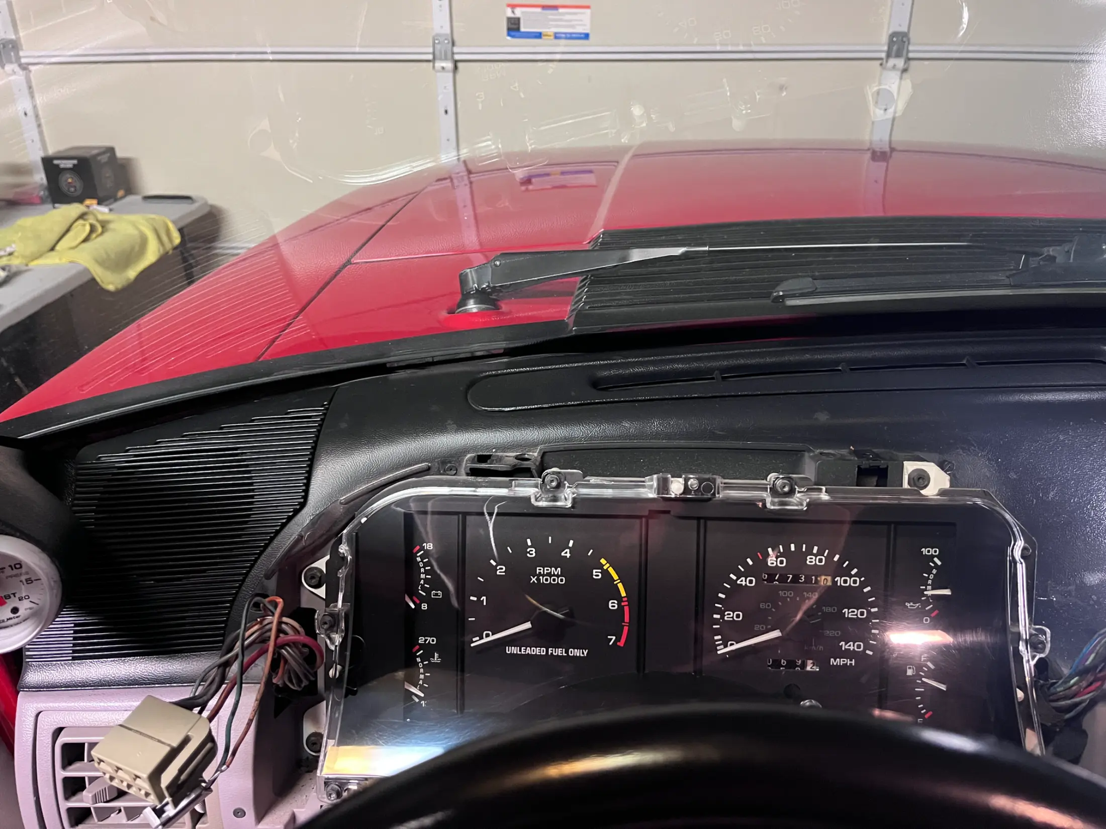

And here’s the cluster cleaned up with the speaker grill back on:
That’s it for tonight. I want to vacuum all up in and around this area but too loud for that right now. The rest is pretty easy to put back together.

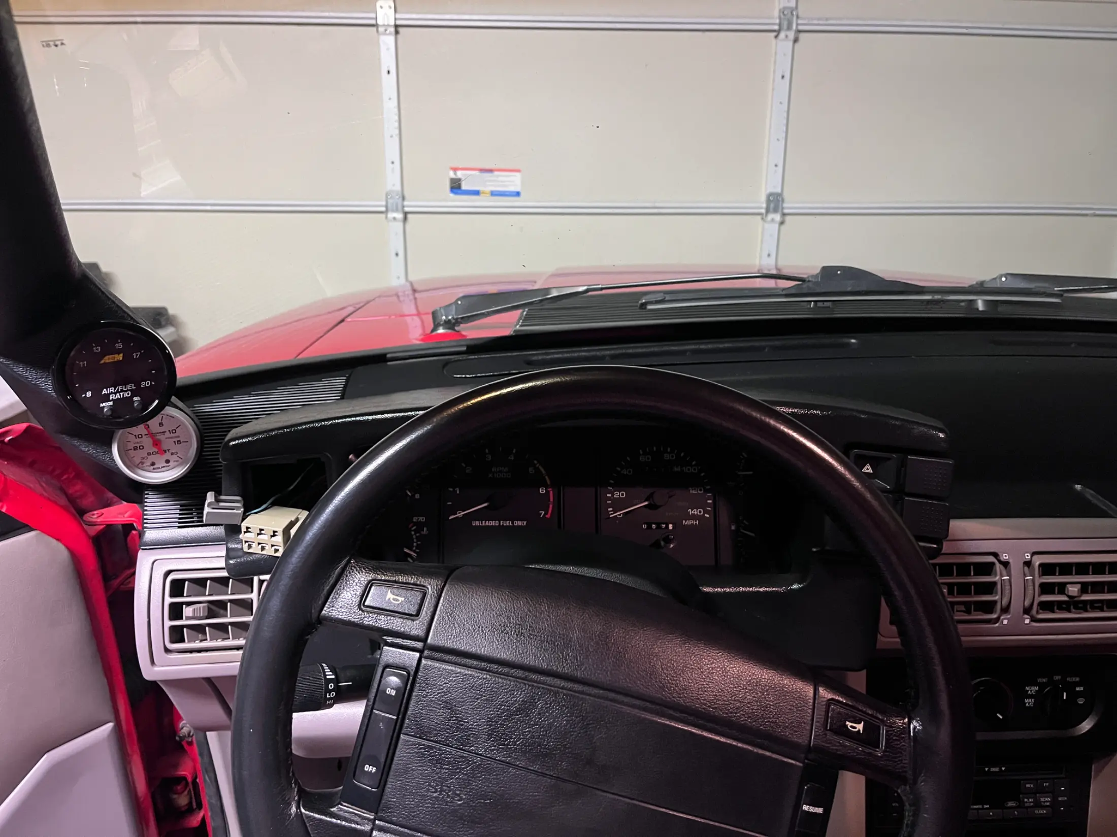

Got everything back together. Somehow seemed to have lost one of the screws for the column cover. So weird I literally organized them all in piles on the floor mat. No idea how it’s missing.

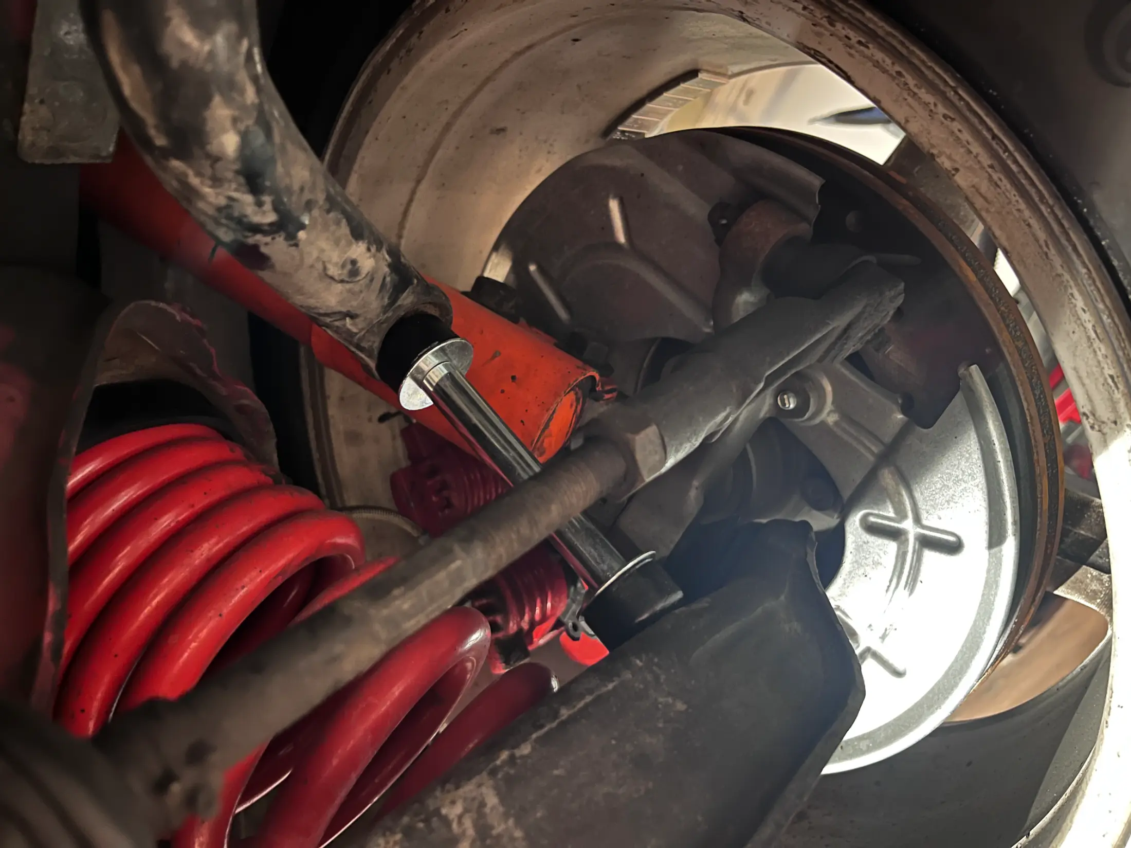

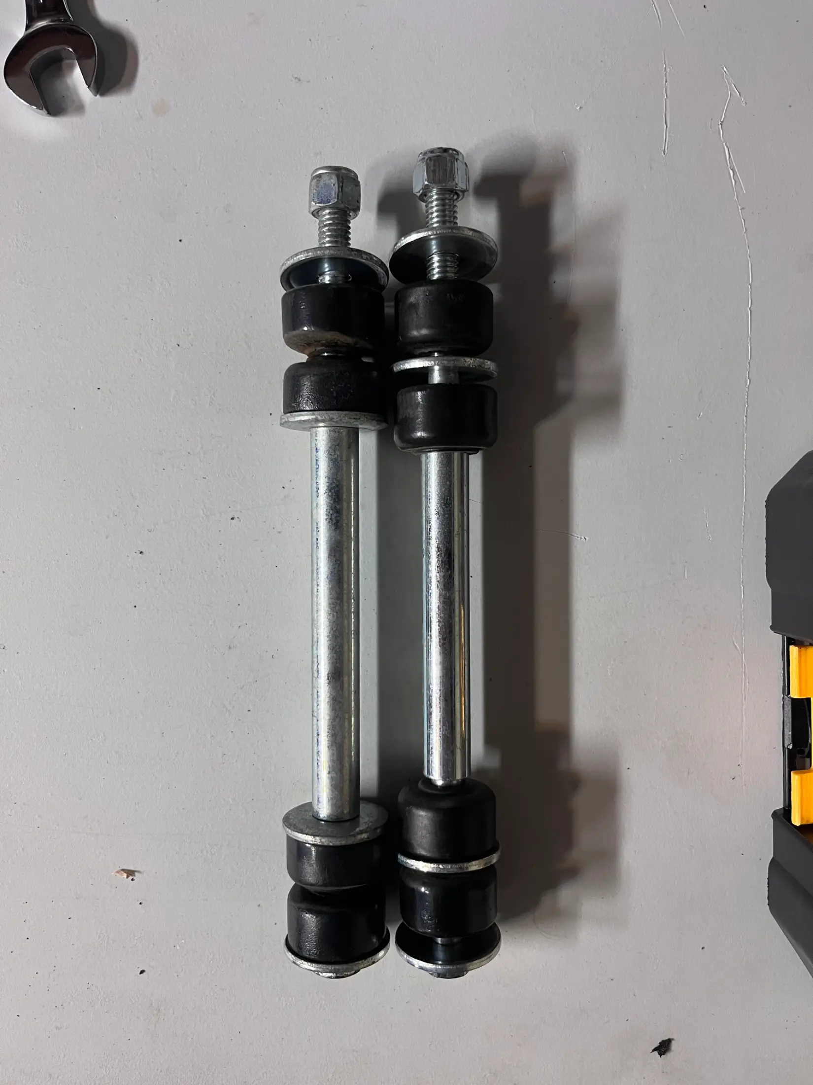

Still waiting on my end links to come in. In the meantime I removed my other side end link. They aren’t even the same length bolts so who knows what the PO was doing:
Close but not quite.
I've mentioned that everytime i dig into this car to do one thing, i find four more things wrong with it. For the $30 i don't mind having a better set on hand.
