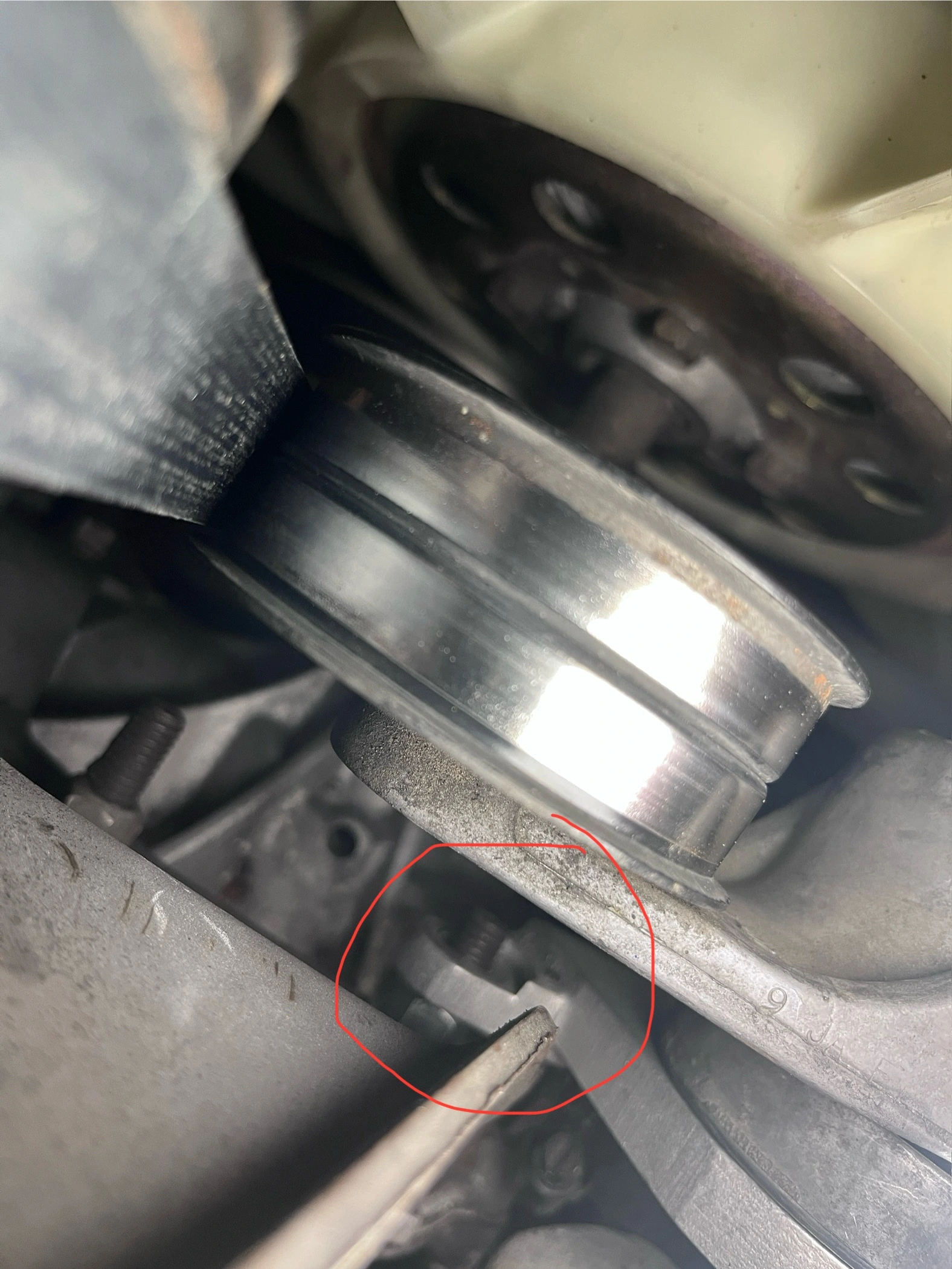

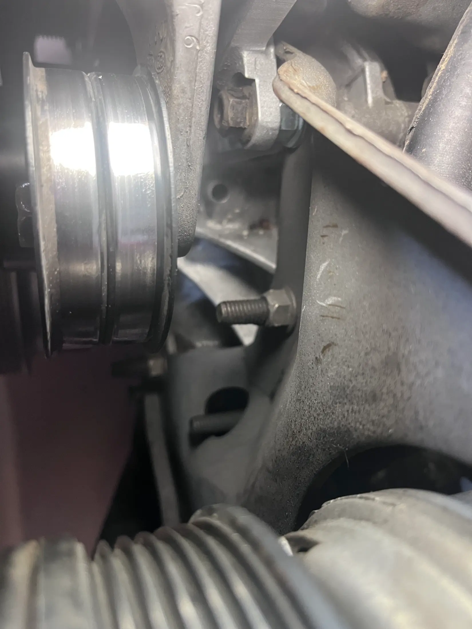

This is the water pump stud I'm referring to. In the picture the two bolts holding the tensioner to the s/c bracket are tight. The distance between the tensioner bracket and nut is what needs to be accurately shimmed.
When I was having these problems i started it up with the belt on and the tensioner attached as shown in my picture. My squeal was gone. Thats how i knew where the problem was. Then I carefully shimmed the gap and it's been fine since.
Use your own judgement on starting it like that. It seems sturdy enough for a test start to me.

Yeah. So what I suggest is to remove that nut and washer behind the tensioner. Then reinstall the tensioner. Just let that stud sit free in the tensioner hole temporarily. Don't put the front nut back on. Just tighten the two bolts that hold the tensioner assembly to the S/C bracket. See if it still squeals.

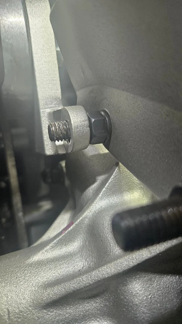

It's hard to see in my picture. There is a small gap between the tensioner bracket and the nut. It's floating there and square. It won't squeal like that. The gap is about half as thick as a standard thin washer. It i put a nut on and tighter it down it will close that little gap, pull the tensioner in that small amount out of parallel and squeal like a stuck pig for about 1-1.5 seconds on startup. Particularly cold starts. It really doesn't take much.

Alright, got the nut off @nicholase suggested. The bracket did ‘bend’ back forward a tad, to create a small gap between the bracket and rearward nut behind it. I can’t start the car now but will try tomorrow to see if it goes away.
@nicholase i know you suggested removing the washer and nut behind the bracket (so the bolt is bare), just curious as to why that’s necessary? If the Paxton tensioner bracket moves away from that nut then isn’t it fine leaving it?

The idea of removing the nut entirely is to make sure it's not influencing the tensioner bracket at all for your test start. If you loosened the outer nut and the tensioner mount pulled away it isn't. However if you loosened the outer nut and it didn't pull away you wouldn't be sure if the inner nut was holding the bracket out of parallel. That's why I suggested just to remove it.
The fact that the tensioner mount pulled away when you loosened the outer nut tells you that tightening the outer nut pulls the tensioner out of parallel. So that will need to be shimmed regardless of the results before you move on to the next step. Step by step, adjust things as you go and you'll get it.
However you do want to make sure the stud isn't binding in the bracket hole and holding it from returning fully back to it's natural position. As long as you loosened it all up and determined the tensioner was free on the waterpump stud then retightened the two bolts holding it to the SC bracket you should be good.
