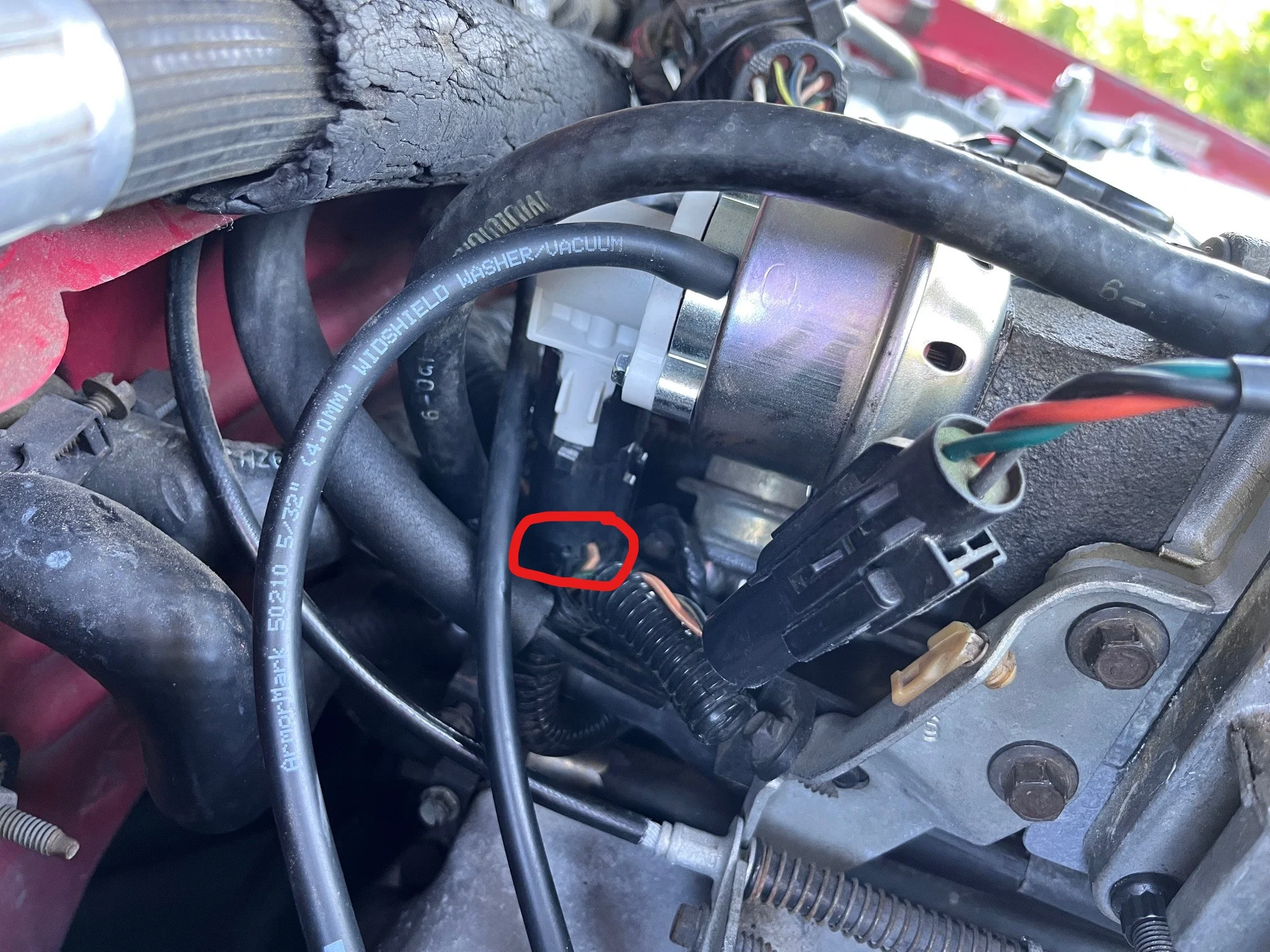

Drove the Mustang to work today. She ran great, even in stop/go traffic getting onto the freeway. Car seems like it wants to wander a bit driving at freeway speeds. Not a new symptom, probably has to do with my inner/outer tie rods as well as the 'bad' balljoint. (still not sure if its actually bad). I haven't gotten a proper alignment due to said tie rods, but with my future steering component swap planned, i won't worry about it too much for now. She tracks straight, just wanders a bit.
Ran just a KOEO scan once i got to work just for the hell of it. My damn code 34 is back. Been reading up on that code more and more. Sounds like i need to probe the wires going to the EGR sensor to make sure they are in the specified range and go from there. EGR sensor and valve are both new.
The wires coming down off the sensor are the ones i need to probe, correct?

Have you seen this post? Might help with some trouble shooting.

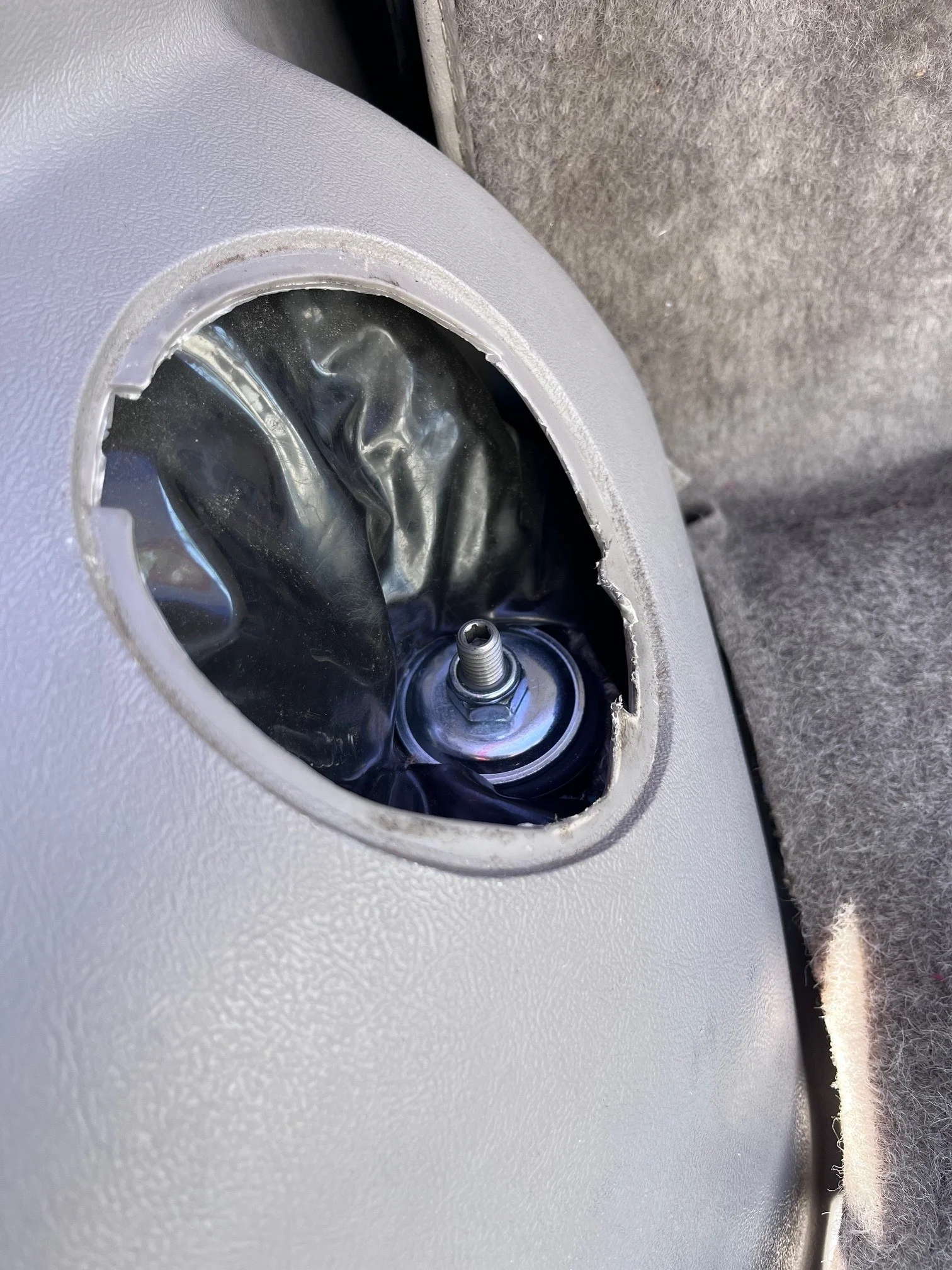

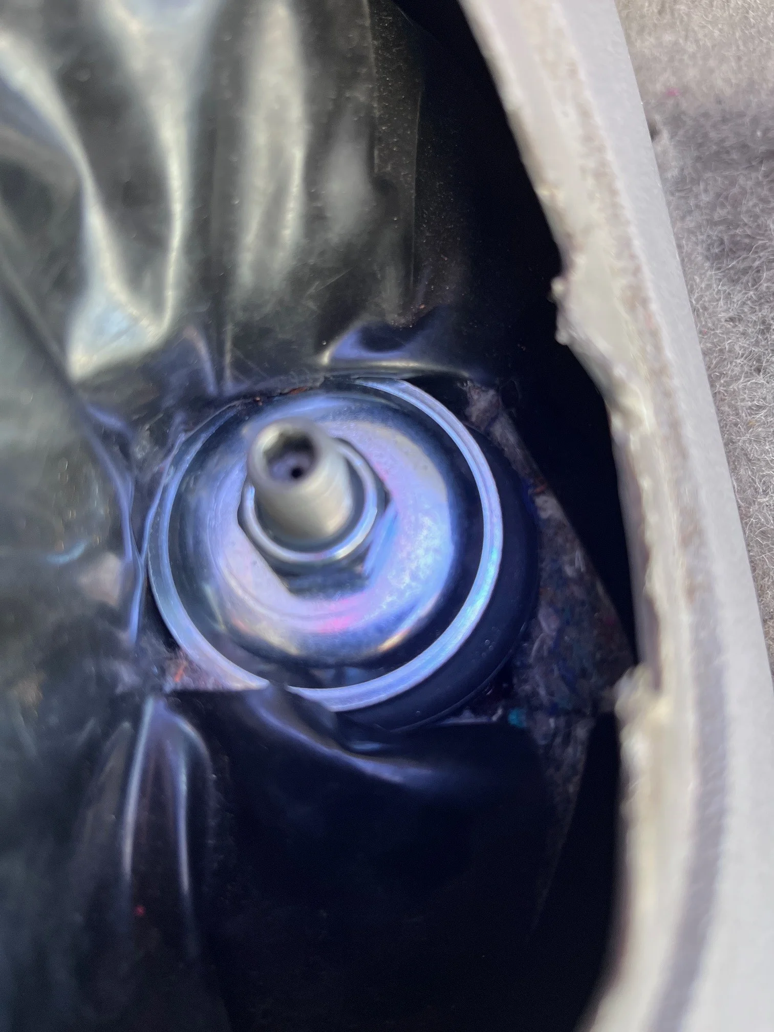

Curious if my rear Bilstein top bushings look too 'squished' or not? I tried torquing them to spec (which is pretty low), but my torque wrench got them even more tight/squished and never actually clicked before i thought it didn't look right. These photos are with the nuts backed off a little so the bushing isn't completely pancaked. I only have one torque wrench that goes from like 20ftlb to 250ftlb. I just didn't want these to be too tight where it causes binding or anything.

I counted the threads so each side is identical. The first picture shows the squished bushing, second shows threads.
Choose a torque wrench where your target torque value falls between 30% and 80% of the wrench’s total capacity.
Below 20–30% Most torque wrenches become inaccurate at the low end of their range.
Above 80–90% You risk overstressing the wrench, which affects longevity and calibration.
30–80% sweet spot = best accuracy and tool life.
I would retorque with another torque wrench. Believe it not, the Harbor Freight torque wrenches are rated as some of the best for maintaining calibration and they're cheap.
Yaa been meaning to get a 'smaller' wrench for a while. I used to have one that only went up to 150ftlbs but it was old (someone from work gave it to me) and i didn't trust it after a while. Then i had a wheel bearing/hub job on another car that required a torque spec of 185ftlb so i bought the one i currently have. Need to get a smaller one again.
But before i do that, just visually, do those bushings look too tightened down? or kind of pointless to say based on visual, and just go get a proper torque wrench?
