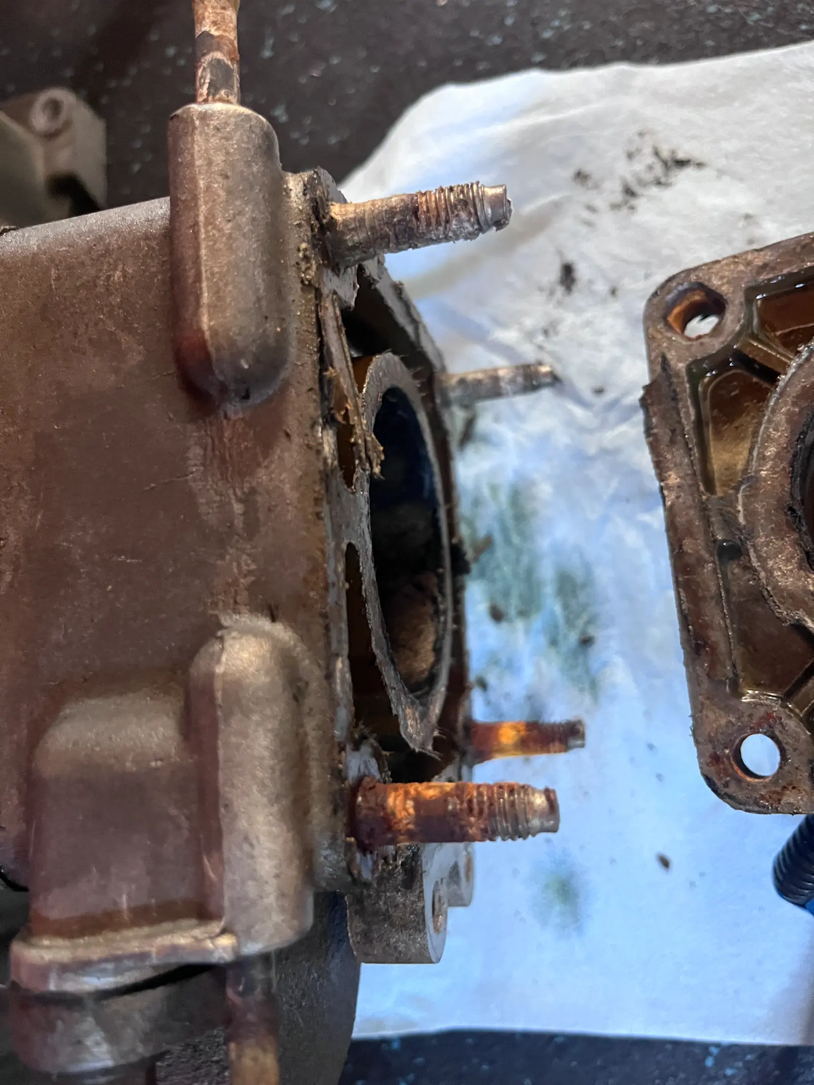

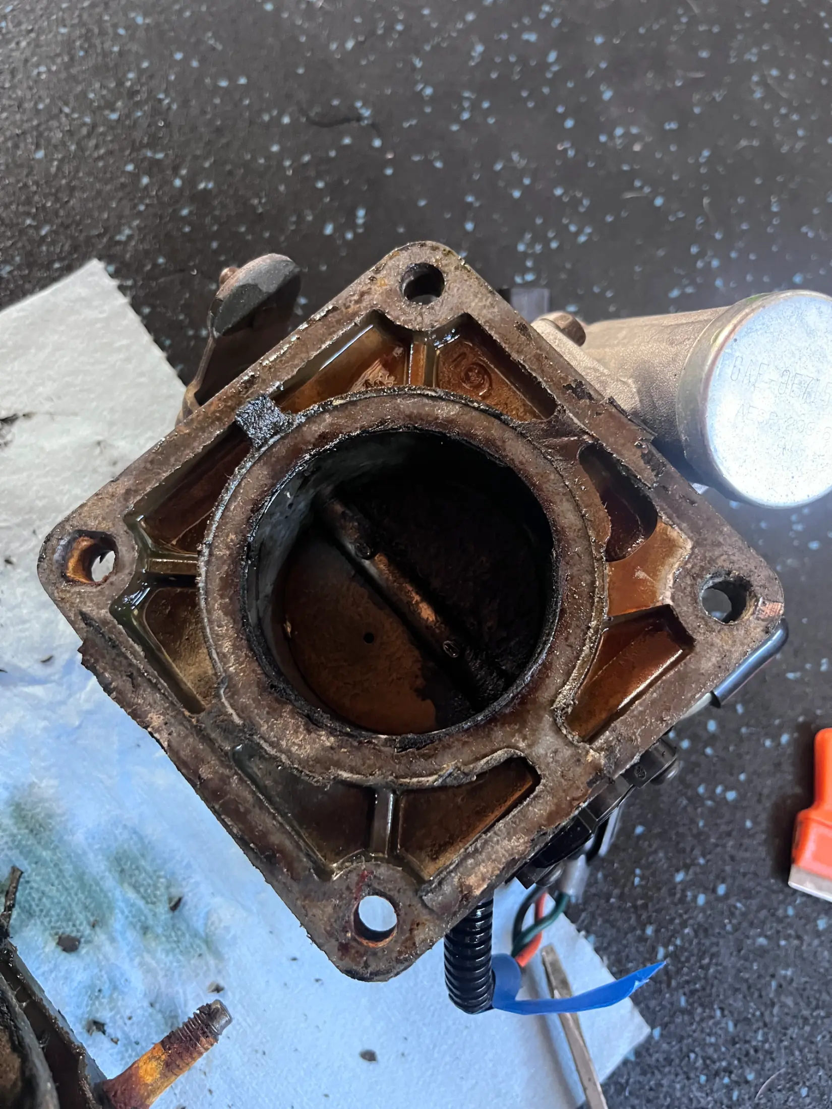

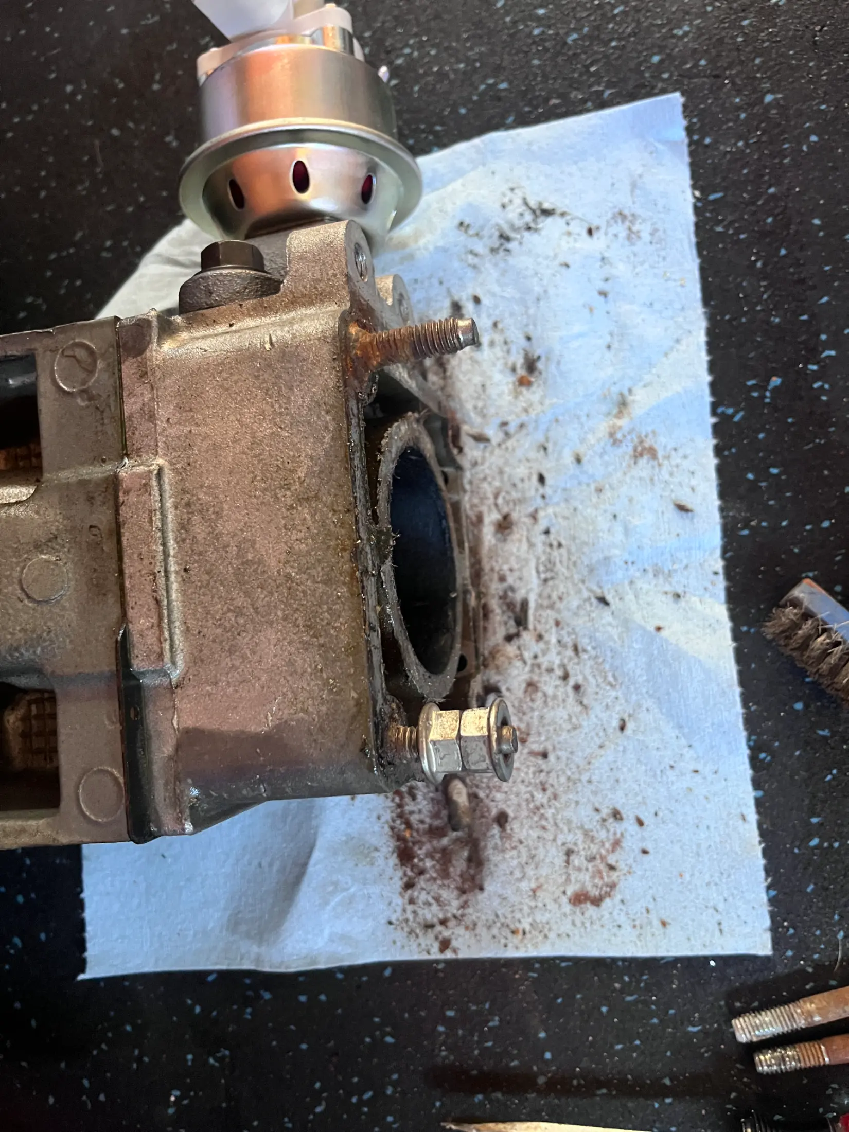

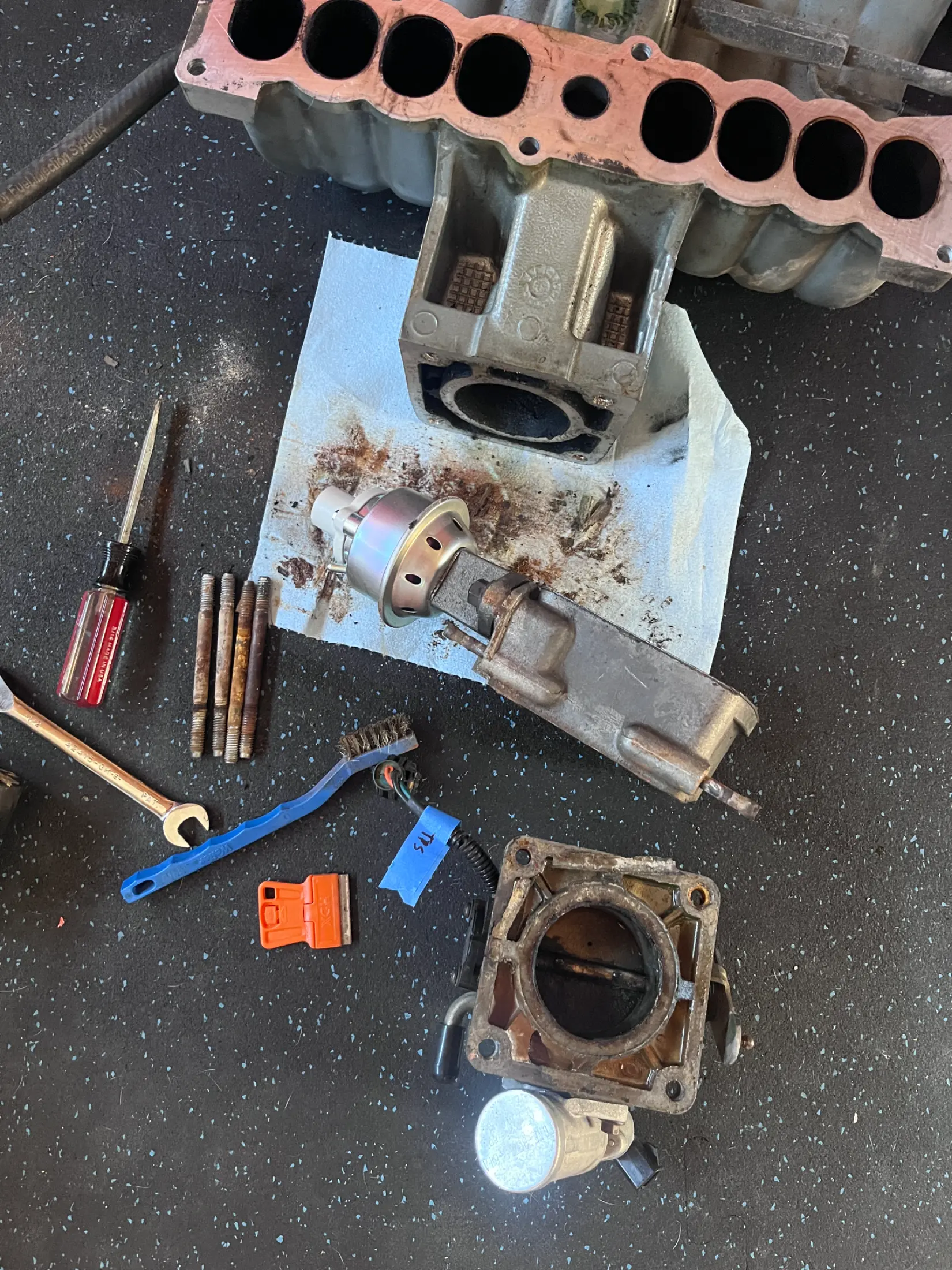

Ok making good progress. Got the throttle body and EGR spacer separated from the intake. Thank you @AeroCoupe for the post, because that’s exactly the method that ended up working to get the EGR spacer off the intake. Spinning the last stud out actually pulled the EGR spacer away, then I had to punch out the stuck in stud. The studs were soooo corroded!
Got all the mating surfaces free of old gaskets, now just need to clean up all the built up coolant and/or carbon build up out from inside of everything. Rear of the TB blade is pretty nasty!
Anything I can put on the new studs to keep them from corroding or no?
You can always use Loctite Blue. It has a corrosion preventative in it.
Reactions: gkomo
Anti-seize works wonders and retorquing the nuts on the studs after a couple of head cycles will keep the water off the studs.

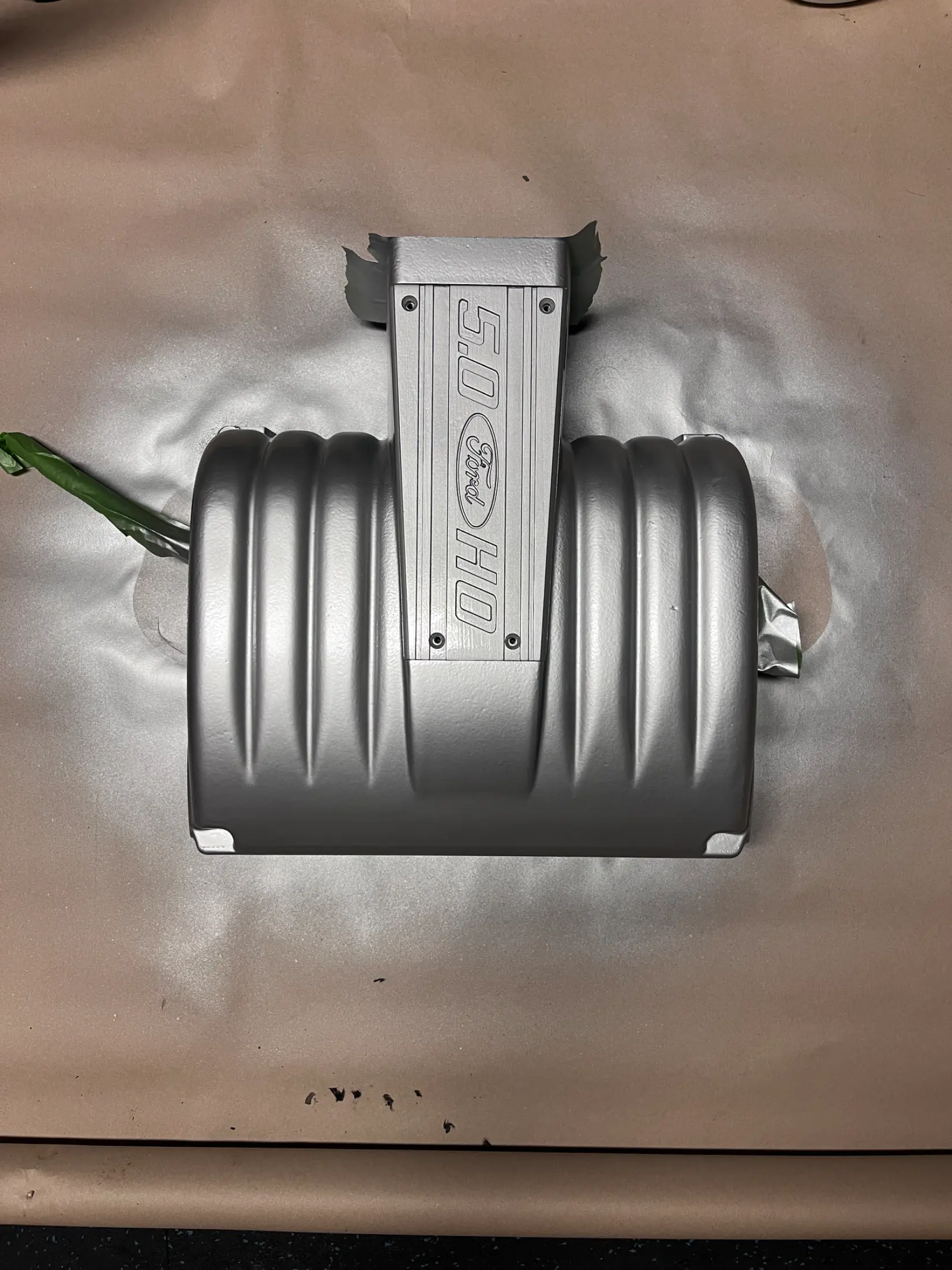

So tonight I was able to clean out a ton of gunk in the throttle body, EGR spacer and the opening of the intake. Not going for full on bead blasting quality, just getting what I can.
Then I prepped the intake for paint (degreased, sanded, scotch pad for hard to reach crevices, cleaned, and wiped everything down with alcohol). I’m sure better prep would be ideal but we’ll see how this goes. Sprayed the first coat of same color as the valve covers. Will do 2 more coats then 2 coats of clear.
My plan is to have the plaque the same color as the intake then I’ll fill in the letting with some sort of high temp black paint (or something) I can squirt.
If it sucks, I’ll deal with it later.

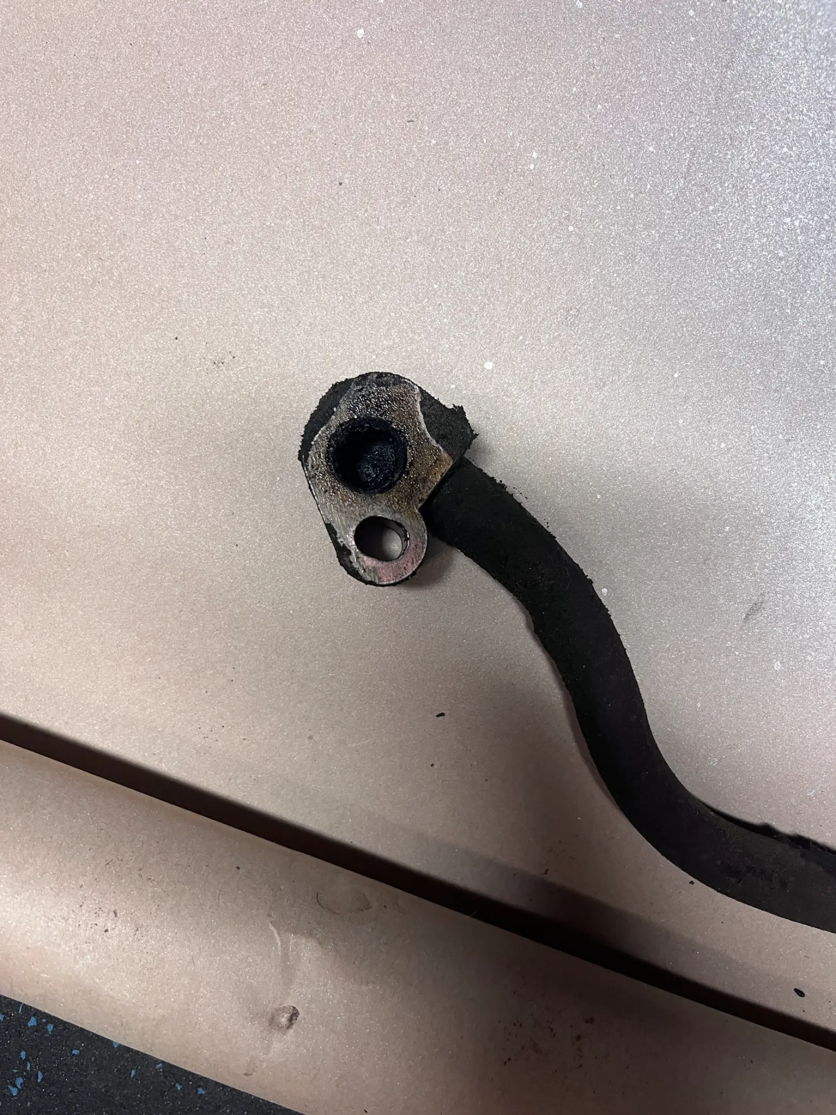

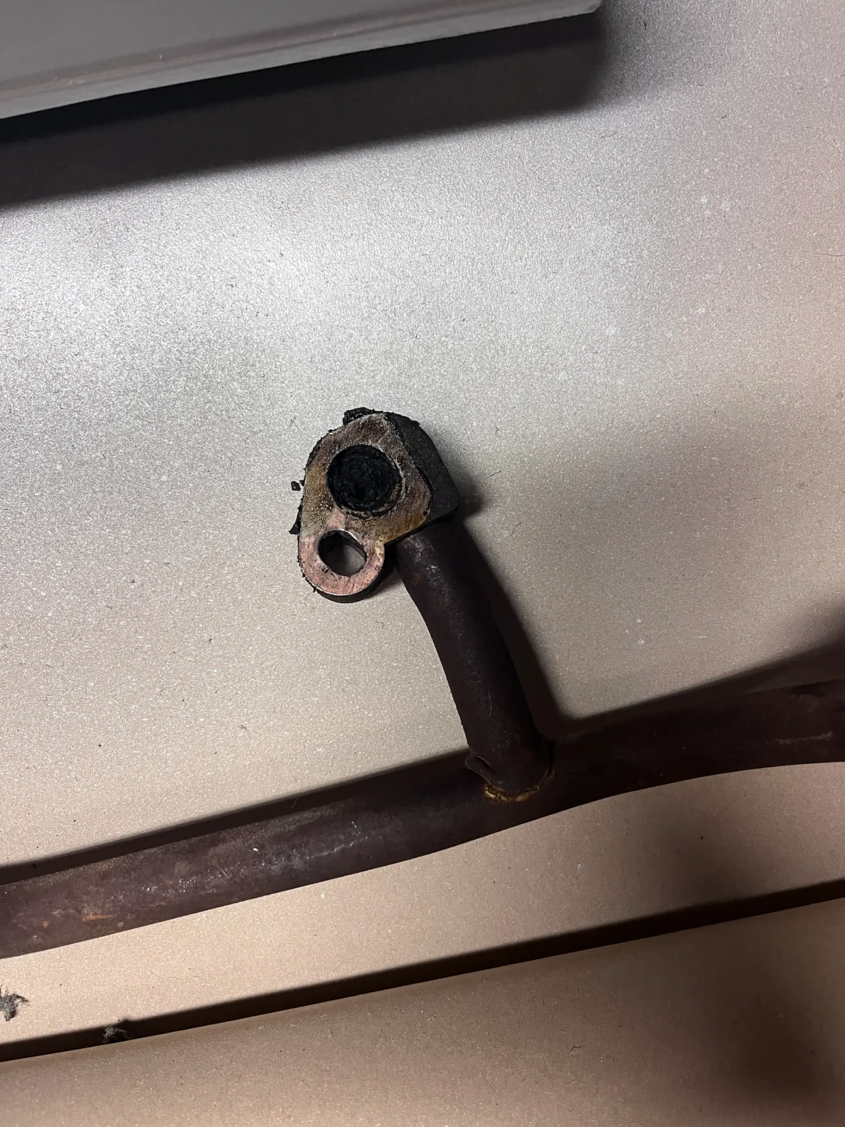

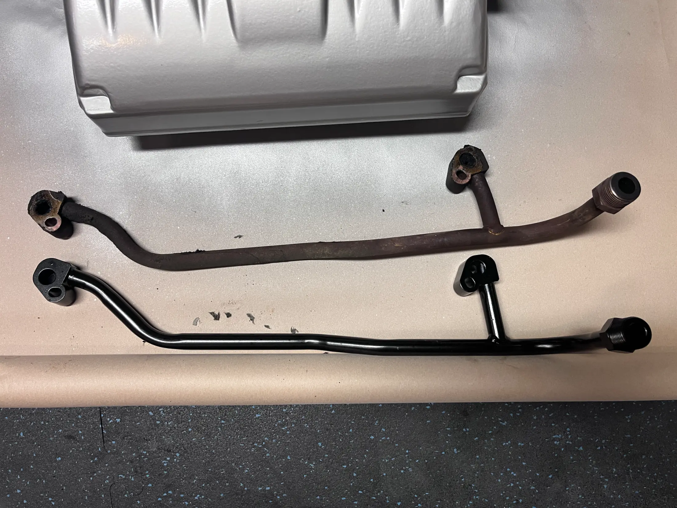

I think I found out why I’m throwing code 44 (I think it was 44… need to look back in my thread):
*Thank you to whomever suggested the air pump crossover tube*
Passenger side (completely clogged):
Drivers side not as bad:
Old vs new:

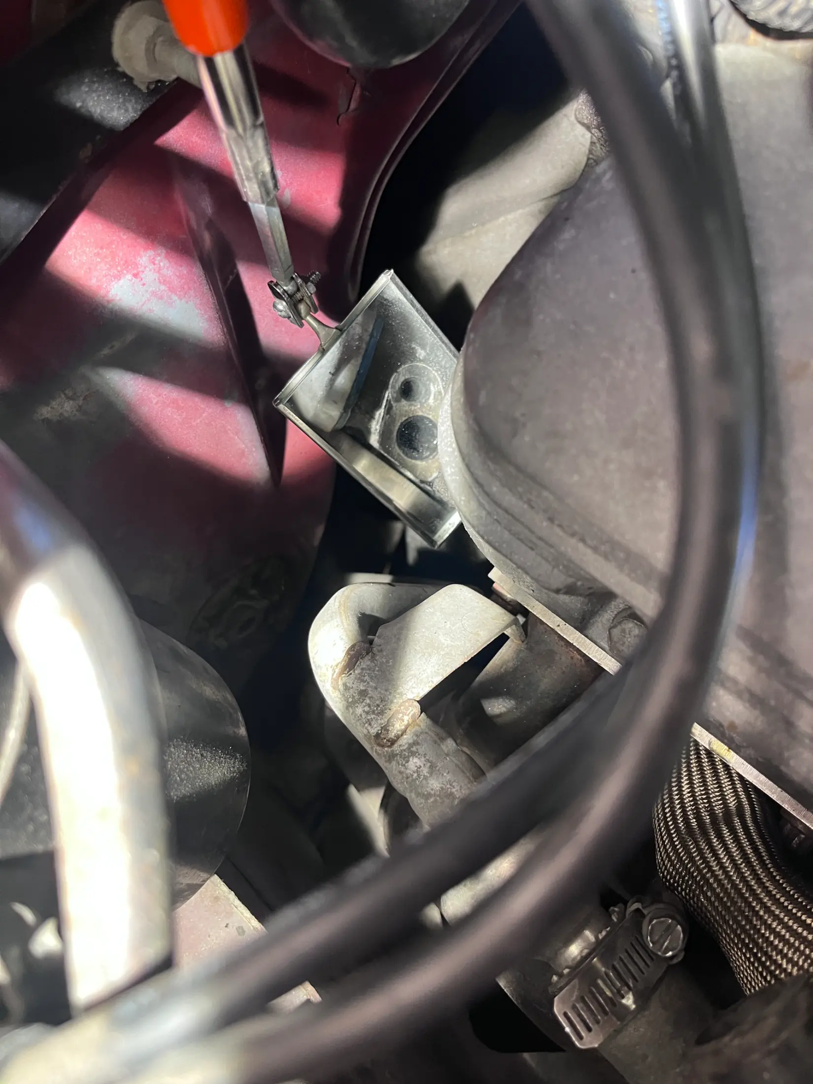

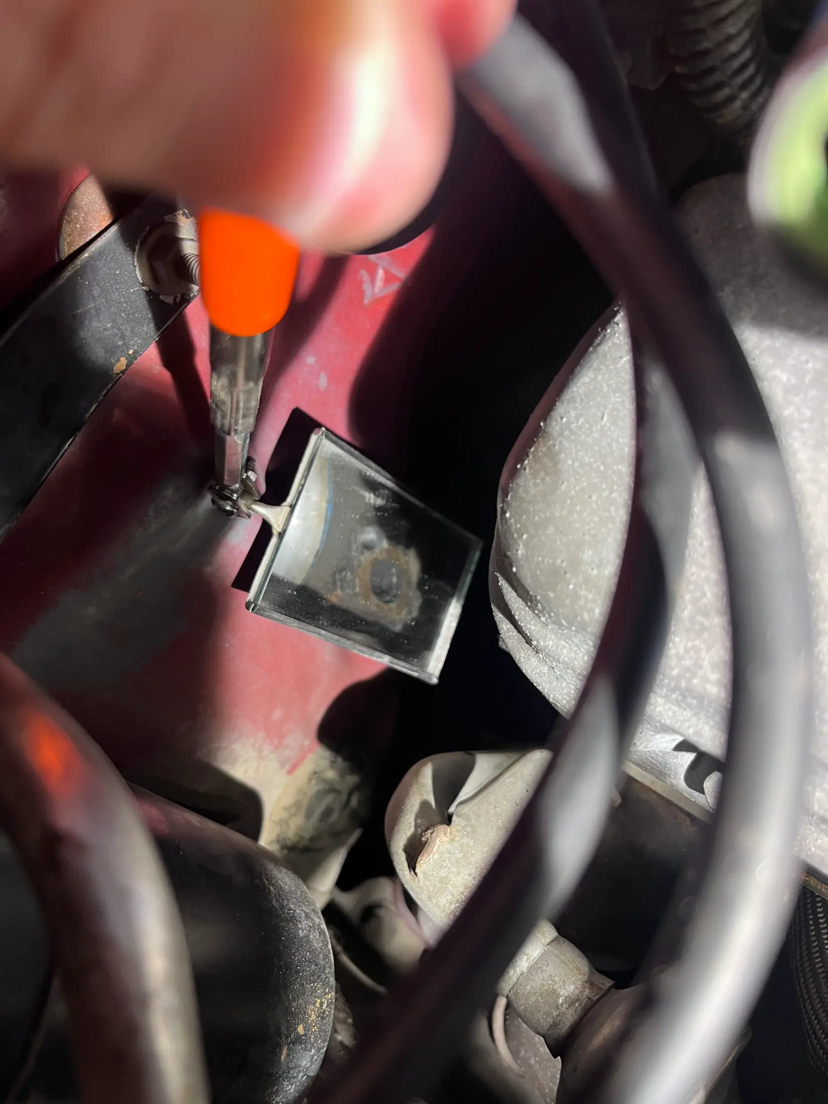

Of course it couldn’t just be the tube. The hole in the head was completely clogged too, had to hold a mirror while digging out carbon buildup:
Before:
After:
Again, drivers side didn’t look as bad but I cleaned out the head holes as best I could. I basically used a really small flat head screw driver and poked and scraped the gunk out as best I could. Even with the mirror I can’t exactly see deep into the holes, but the screw driver freely went in as far as I could get it. Hopefully that buys me enough time not throwing a code before I swap heads anyways.
Wrapped up by getting the new tube in place but not yet bolted down.

You're not gonna reuse that thrashed EGR spacer are you?
Gotta be a ton of those that are in better shape, I've got a couple :jester:
Since i took the photo i cleaned it up pretty good, and wire brushed the tubes where the hoses connect to. But to answer your question, yes i was going to reuse it, lol
All will get replaced when i go with a larger TB down the road.

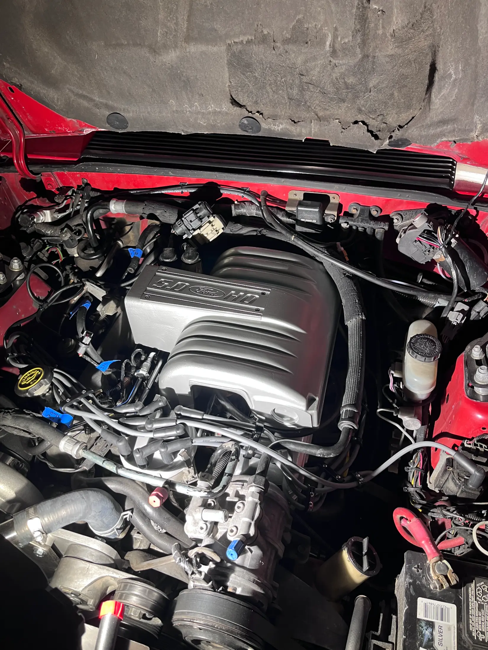

Got the intake back on and all the vacuum lines (except an easy one going out the front) and still need to connect the PCV hose. Bolts torqued to 21ft/lb. I think the intake turned out great, paint-wise.
My EGR spacer is drying so once that’s good I will get that put back on. Still need to do the passenger side valve cover gasket but it looks pretty easy to do without the intake tube and TB hooked up.
