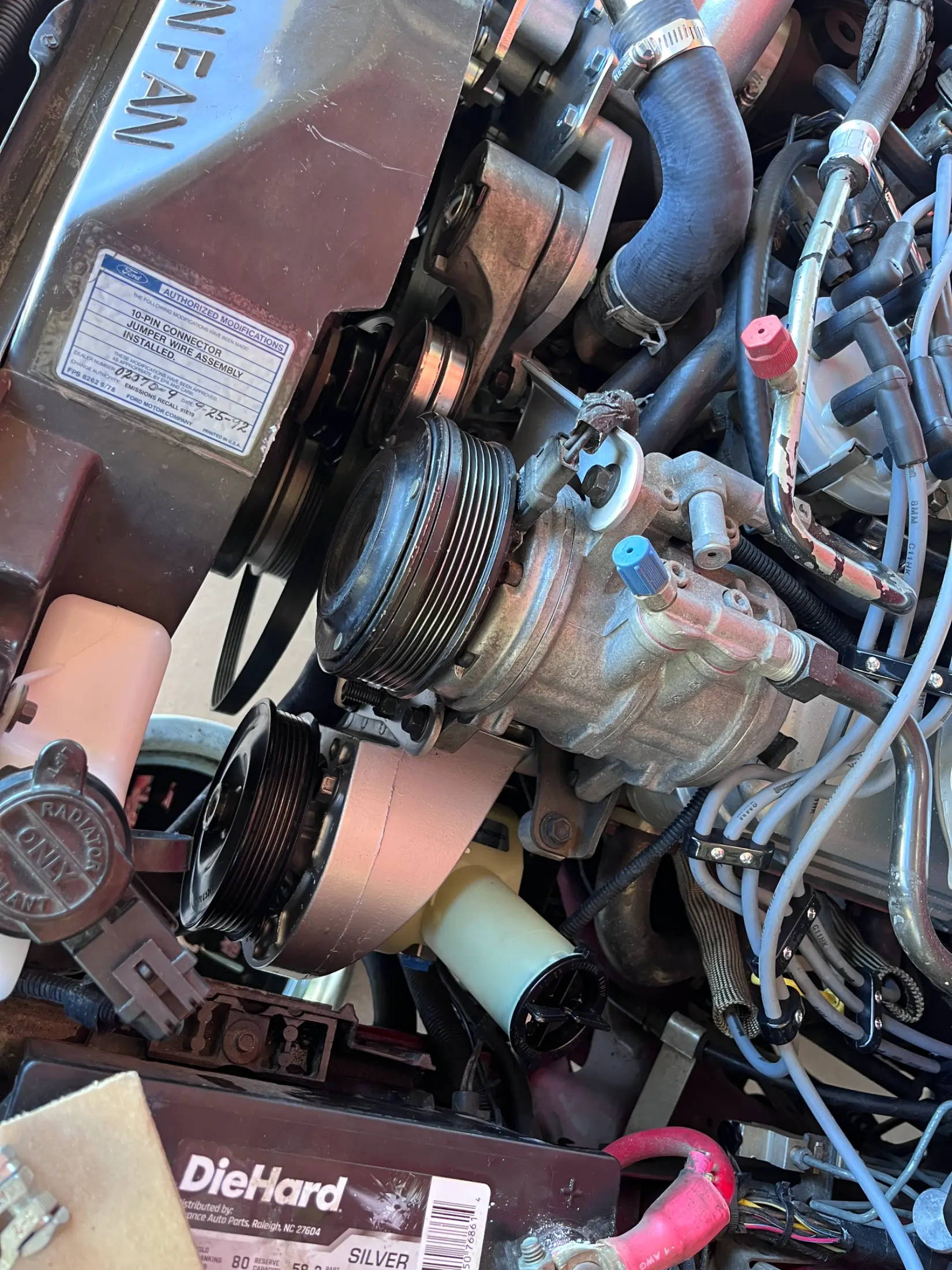

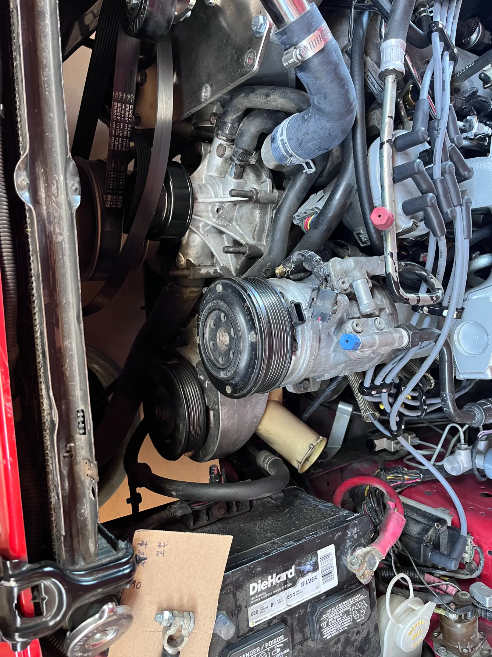

Alright got the PS cooling tube back in… at the expense of some bent AC radiator fins.
Got the fan and shroud out, and the AC and PS pump bracket off. Some of those bolts were pretty tough to get off, had to use a jack handle as a breaker bar. Was so dirty so I cleaned it off and now I’m painting it the same color as the intake.

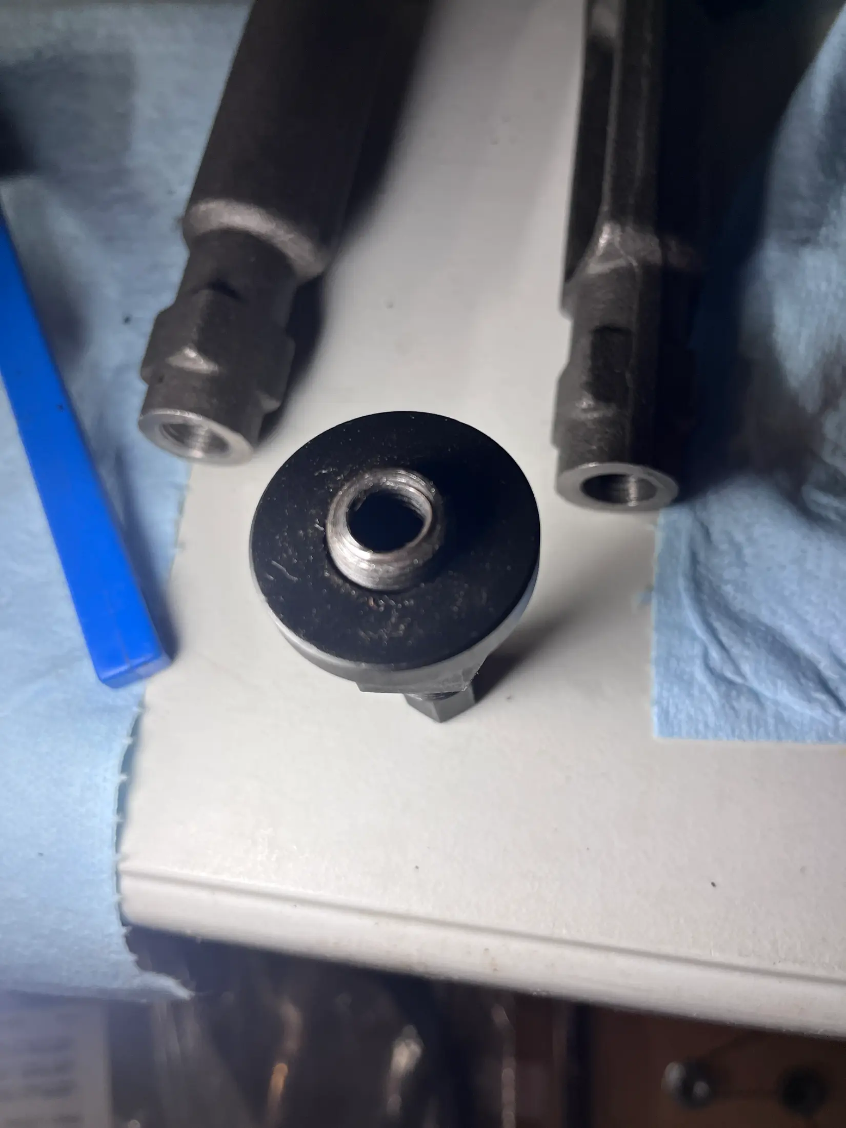

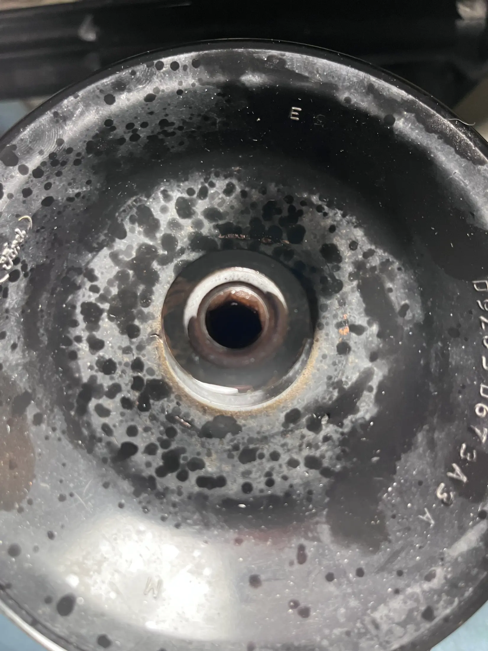

Alright got the pump removed and on the bench. Time to take the pulley off. I’m just following LMRs how-to video and have the pulley puller kit they do…. I feel like I’m doing something wrong. The tip of the puller bolt is starting to gall when tightening it down. So my question is, there is an inverted hex hole inside the pulley:
And I supposed to take that out or something? LMRs video didn’t show them removing anything prior to using the puller tool.
Here’s what my puller bolt is starting to look like:
Assuming it’s not supposed to be that hard to do this?
In the meantime I’ve sprayed it all down with liquid wrench and will get back at it tomorrow.
Edit: nevermind, got it off. I was doing it correctly just must’ve not been putting enough muscle on it. Was making a super loud ‘crack’ noise with every turn, thought I was gonna wake the kiddo up even being all the way out in the garage.

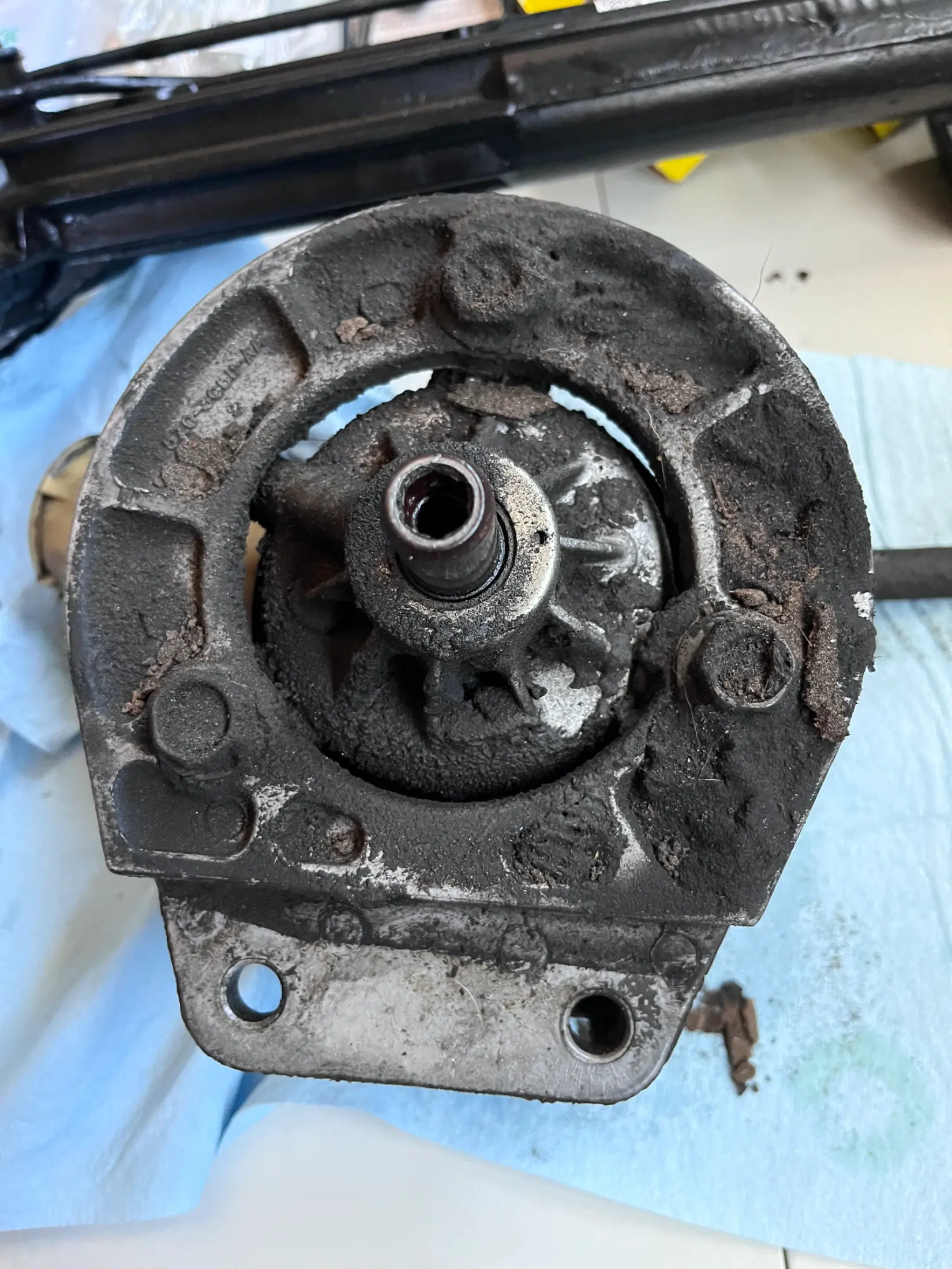

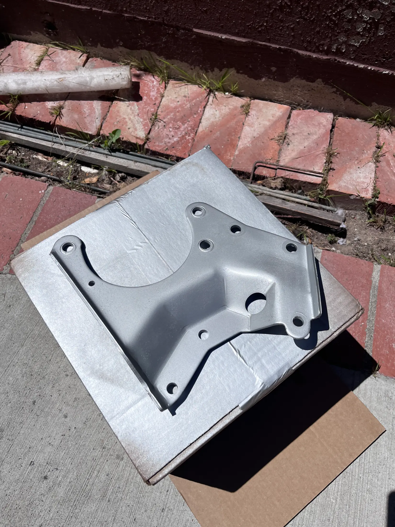

Got the pulley pressed on, and pump reinstalled. Started putting the front of the engine back together, just need to bolt the fan onto the water pump. Now everything should be under the car! Pulley alignment seems good and there’s no for/aft play in this pump like there was on the original. Pulley is straight now too, previous one looked like it was being pulled “in” by the drive belt.
Here’s the PS bracket from the old one, so gross:
All cleaned up and painted now.

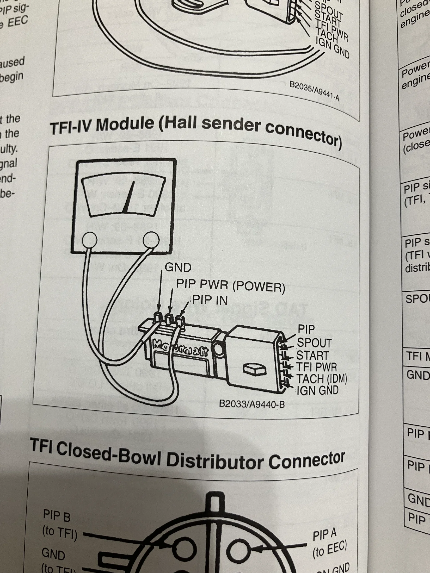

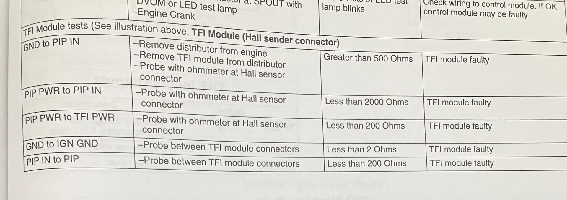

Side note, I bought a TFI tester someone linked somewhere around here and tested my spare Motorcraft TFI module… dead. Made sure my 9v battery was good, plugged and unplugged the tester numerous times, could never get the test light to light up.

As mentioned before, i'm not great with a DVM but i will try these tests, so thank you.
So the DVM set for Ohms will provide its own power to run the tests through the TFI module on the bench?
Yes, tfi just needs hooked up to meter while testing. Here’s a good video showing how to do what I posted screenshots of. Use the Ohms chart from my screenshot though, not that video.
