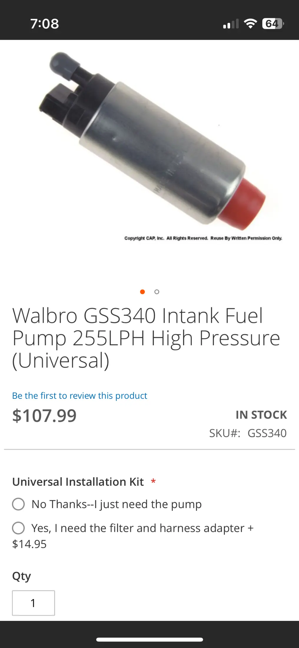

GSS340 is what my LMR order says the MFG P/N is. I don’t know which one that specifically is though.
You may not like this but...
With the FMU, and assuming you're not using a helper pump with a 255L, I would take a good hard look at this:
And maybe consider keeping your current 255L as a spare once you go to a larger injector.
You talking for my current setup or like down the road when I do engine work?
If it’s for the latter I don’t mind replacing it later on. Now that I’ve done it, it wasn’t too bad.
So I currently have a non-high pressure pump? I imagine for my current setup since the kit is ‘supposed’ to work with the stock 88lph pump what I have should be fine for now?
Or do I have the high pressure one? This is a screen shot from walbro’s website:
P/N is what I have and it says “high pressure”. Just curious.

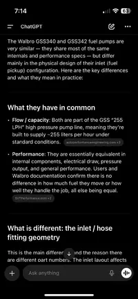

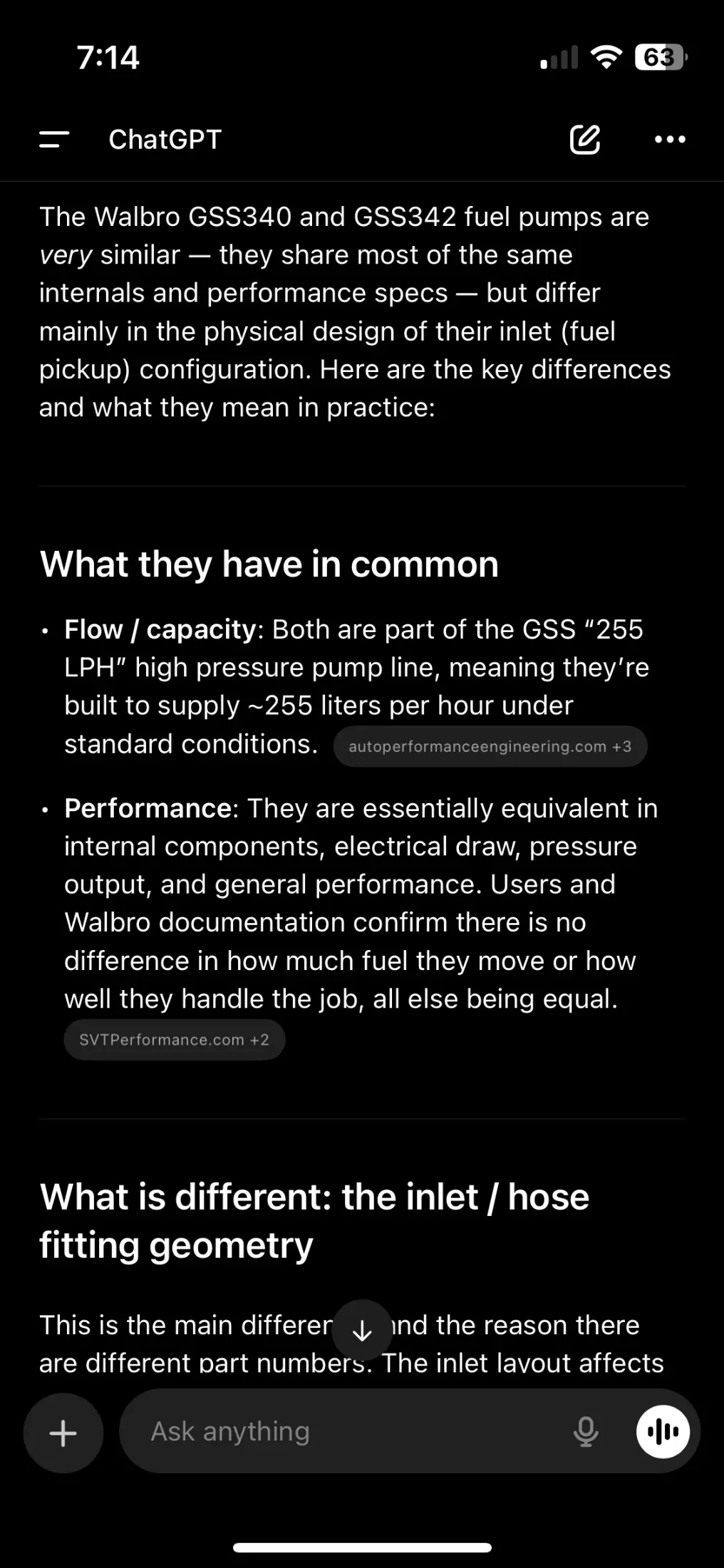

And ChatGPT says:
LMR lists it as the high pressure version. Or are you talking I need something else?
