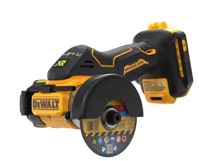

Picture of the tool and disc please.
This one:
and i bought a pack of "metal cutting disks" for it.
3 in. x 1/8 in. Aluminum Oxide Cut-Off Tool Metal Cutting Blade (3-Pack)​
I think it was the disk. I must’ve messed it up (got it too hot or put too much pressure on it). Switched the disk for a new one and it seemed to cut better just lightly going down the lines:
Still got a ways to go but ran out of time to be obnoxiously loud.

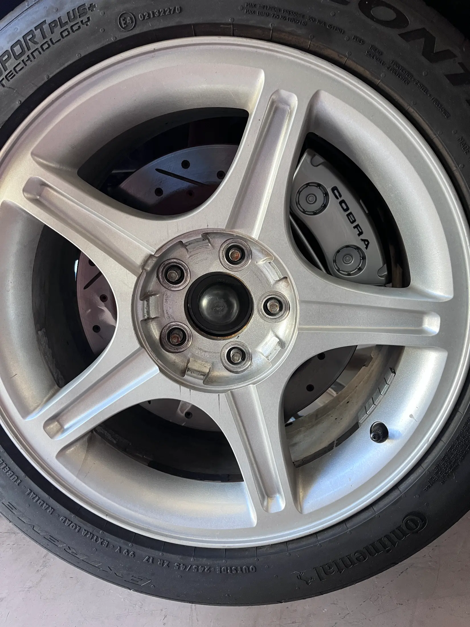

So, I put my wheel on to see how the brake calipers would look:
I think it’s gonna look great!

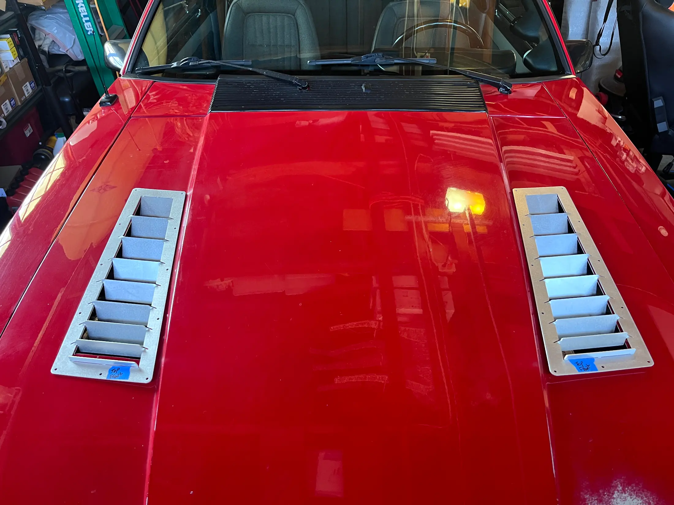

Another opinion request.
For the Race Louvers, should i paint them black, or the same silver i just did my calipers? I like the idea of black as it could tie into the window trim, cowl piece and mirrors. But, the silver could tie into the wheels/calipers.

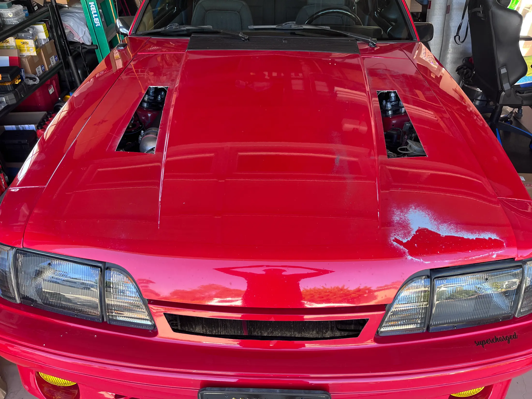

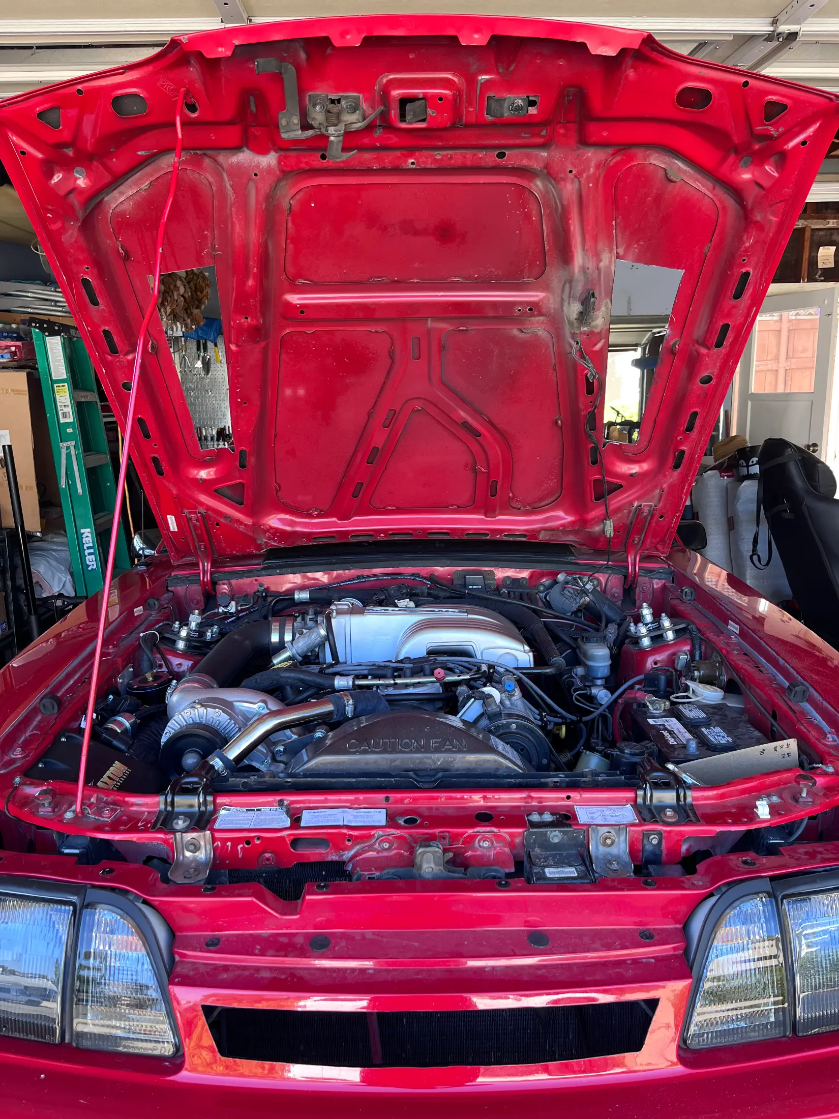

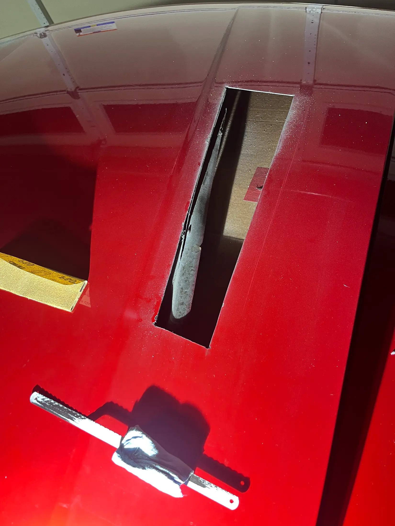

Well to keep things moving as best I can I’ve resorted to hand sawing. Although 100x less efficient than using the cutting tool… it’s something I can do at night due to it being 100x less loud (still a little loud though). Got like 7” cut away tonight.
Yes I wrapped a hack saw blade in a shop towel and wore a glove over that. It works, just slow going.

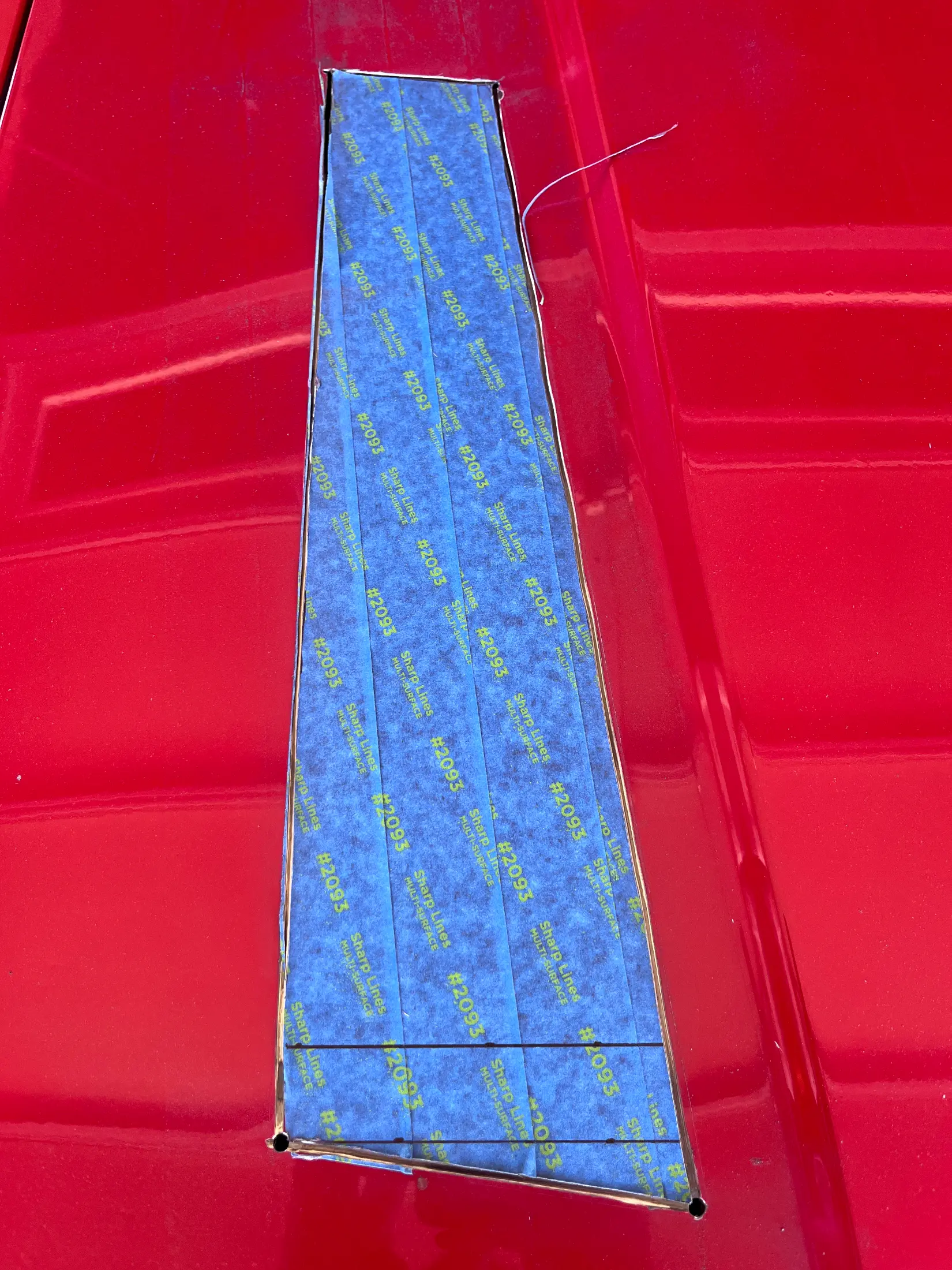

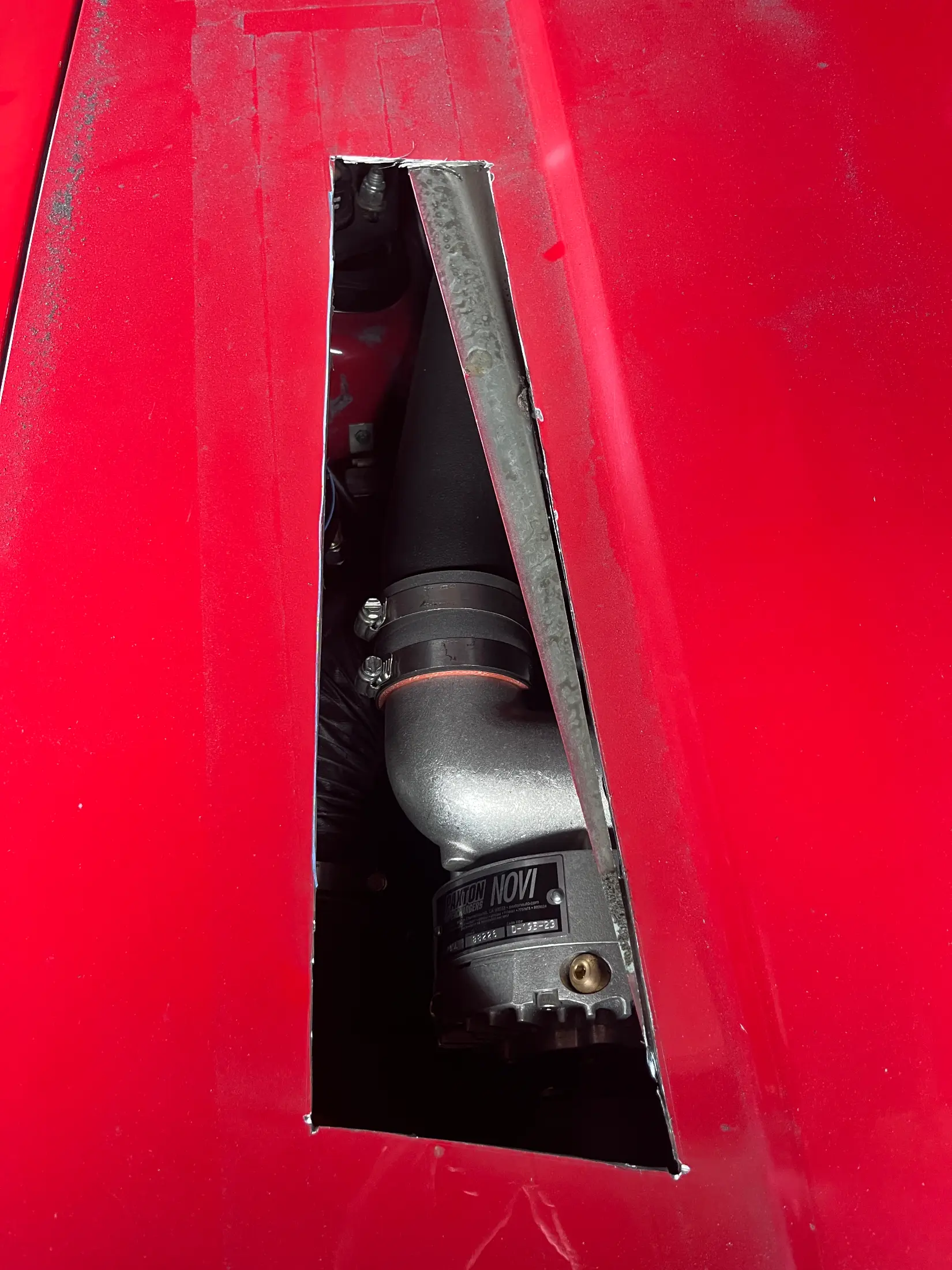

Ah what 30 minutes of uninterrupted alone time can do!
Finished cutting the vent holes including the support structure. Just need to clean up the edges, test fit and sand to fit where needed.
Thanks for the heads up on the booster I’m gonna pick one up whenever they go on sale.
Edit: some slight massaging will be necessary but pretty good fit for first go:
