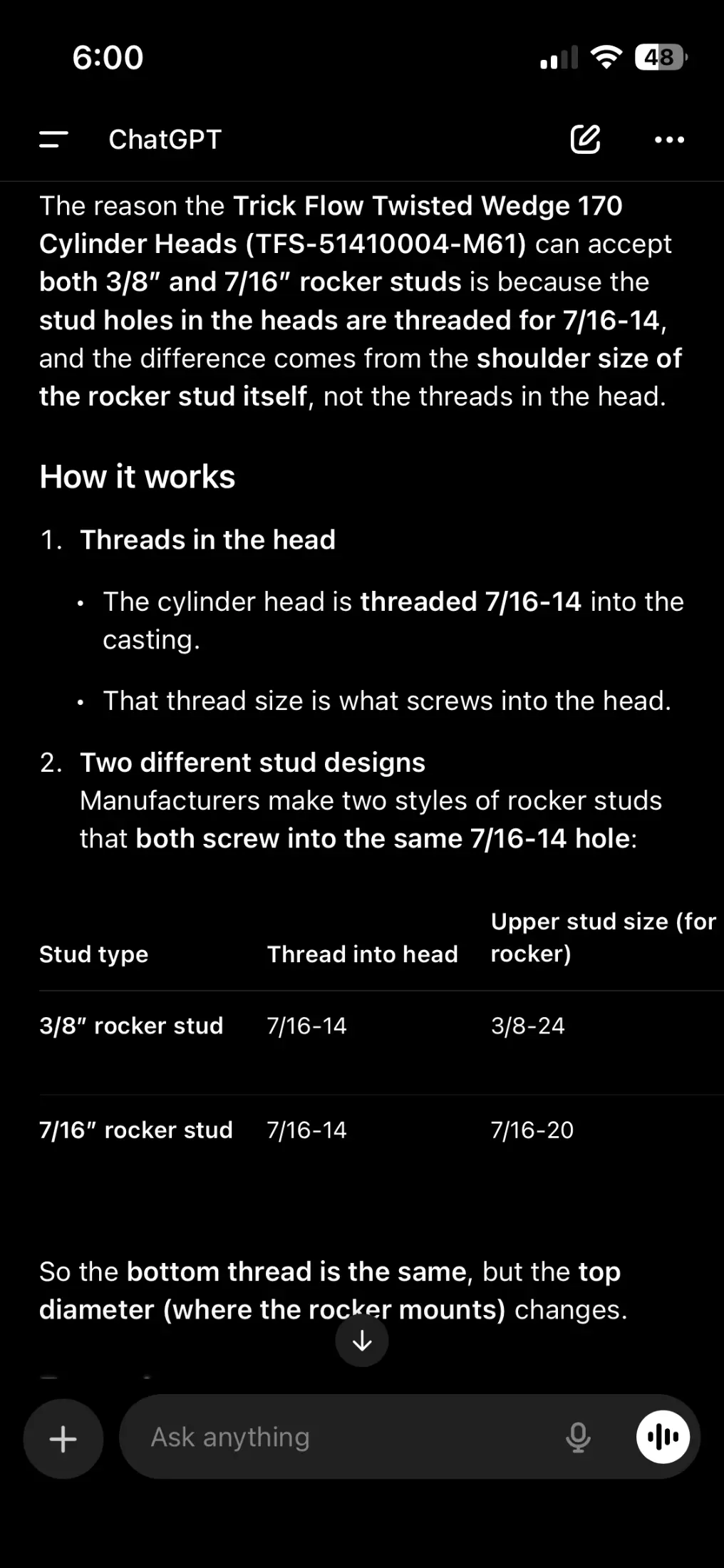

Oh man I’m dumb, I should just go with the 7/16” studs:
So the heads are already threaded for 7/16 and step down to 3/8 on the upper side of the bolt. Might as well just go 7/16 the whole stud.
Shoulda just researched this before.

Noobz347 said:
Good to know.
I wonder though, whey would somebody have reason to use the 3/8 studs in a head threaded for 7/16?
I think the real question is why does Trick Flow provide 3/8 studs with the heads if they are threaded for 7/16?
Now I gotta spend money on new 7/16 studs.
