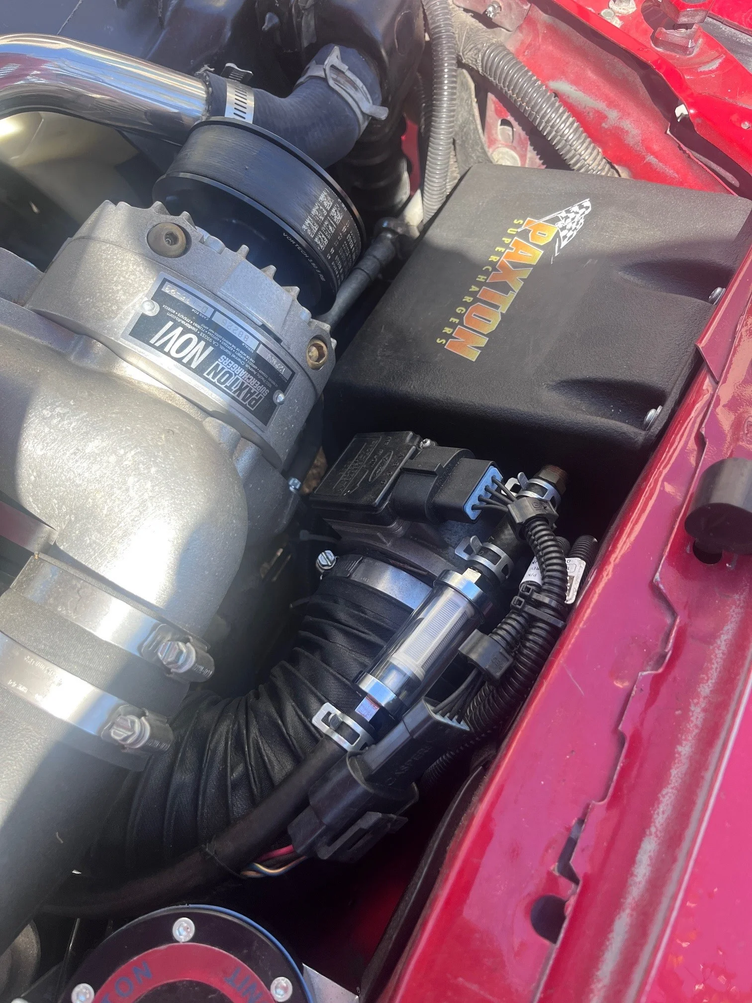

I swapped out my metal casing fuel filter for my supercharger blow-by vent line with a clear casing one just so i can see whats going on.
I looked inside the existing metal filter and did not see any signs of oil vapors nor did it smell at all. So i'll keep it in the car in case the clear one doesn't work out.
This is the line i need to move to the inlet elbow (I already bought the "L" fitting for that job), but for now it stays here.
I also have a J&L Oil Separator ready to install on the PCV side, just need to find a good mounting point for the can.
