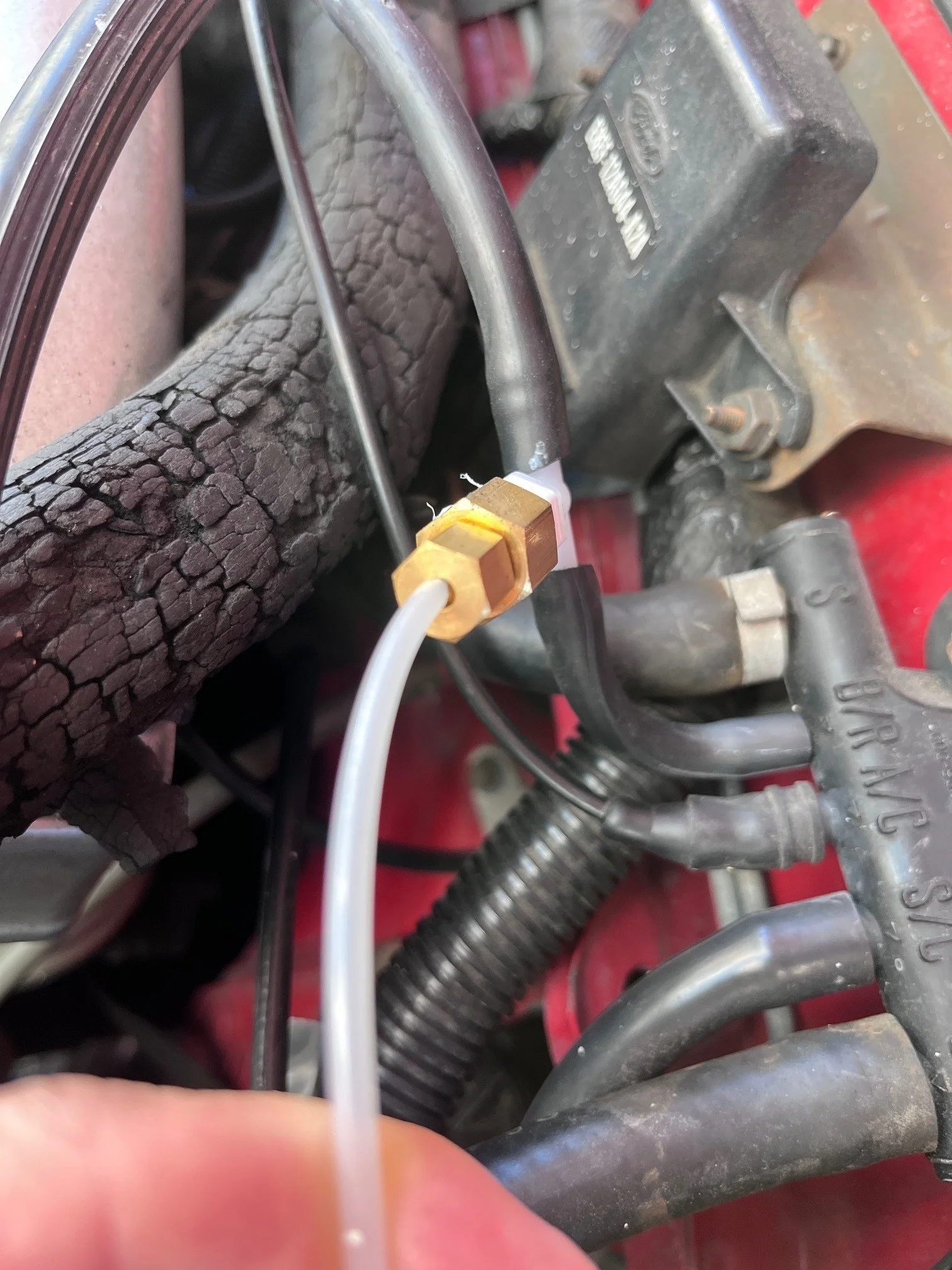

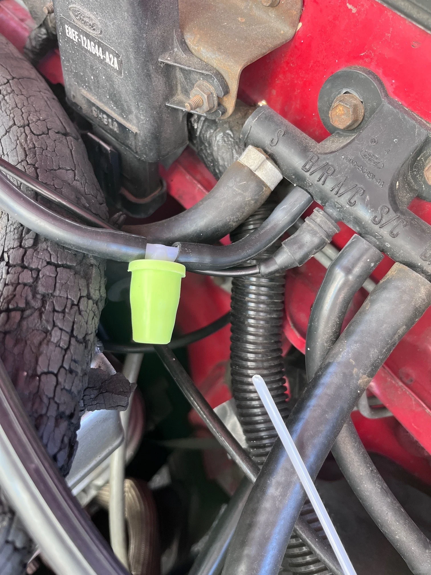

Well now i know not to work on cars while at work. So i went out again just to look at some stuff, jiggle the boost gauge line around and see if anything was off. The whole brass connection to the plastic "T" was hand tight, i could remove it without tools (but i installed it with a wrench...?) so it must have worked itself loose. Anyways, me being a dummy started unscrewing it so i could get to the ferrule holding the boost line in and the boost gauge line (white plastic line) snapped off. Ruh roh!
Damage has been done, so i take the brass fitting inside to inspect it. I take it apart and the ferrule is all deformed and looks like the boost line is somewhat bent inside the ferrule. I actually couldn't get the sheared off boost line out of the ferrule it was all jacked up so much.
So, being at work I am going to temporarily cap off the open boost line fitting from the "T" with one of the caps that come with the vacuum pump kit, not confident this is air tight! Its snug but I will drive the car gingerly home not to get into any boost.

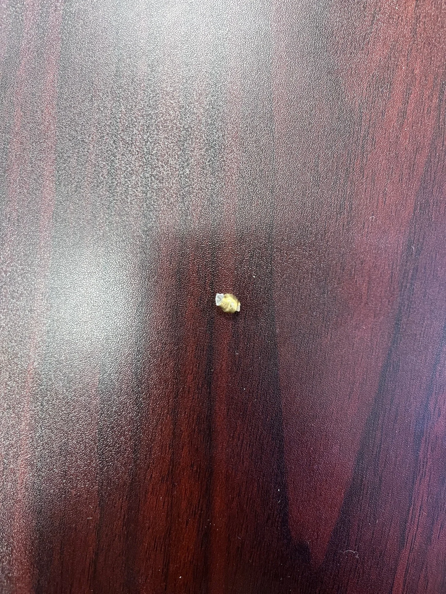

And heres how the ferrule looks:
So, now where to get a replacement ferrule! Thankfully i left an abundance of extra boost gauge line in the engine bay for when i can reconnect it. I should also actually replace the plastic "T" with a brass one as that one seems jankified.
