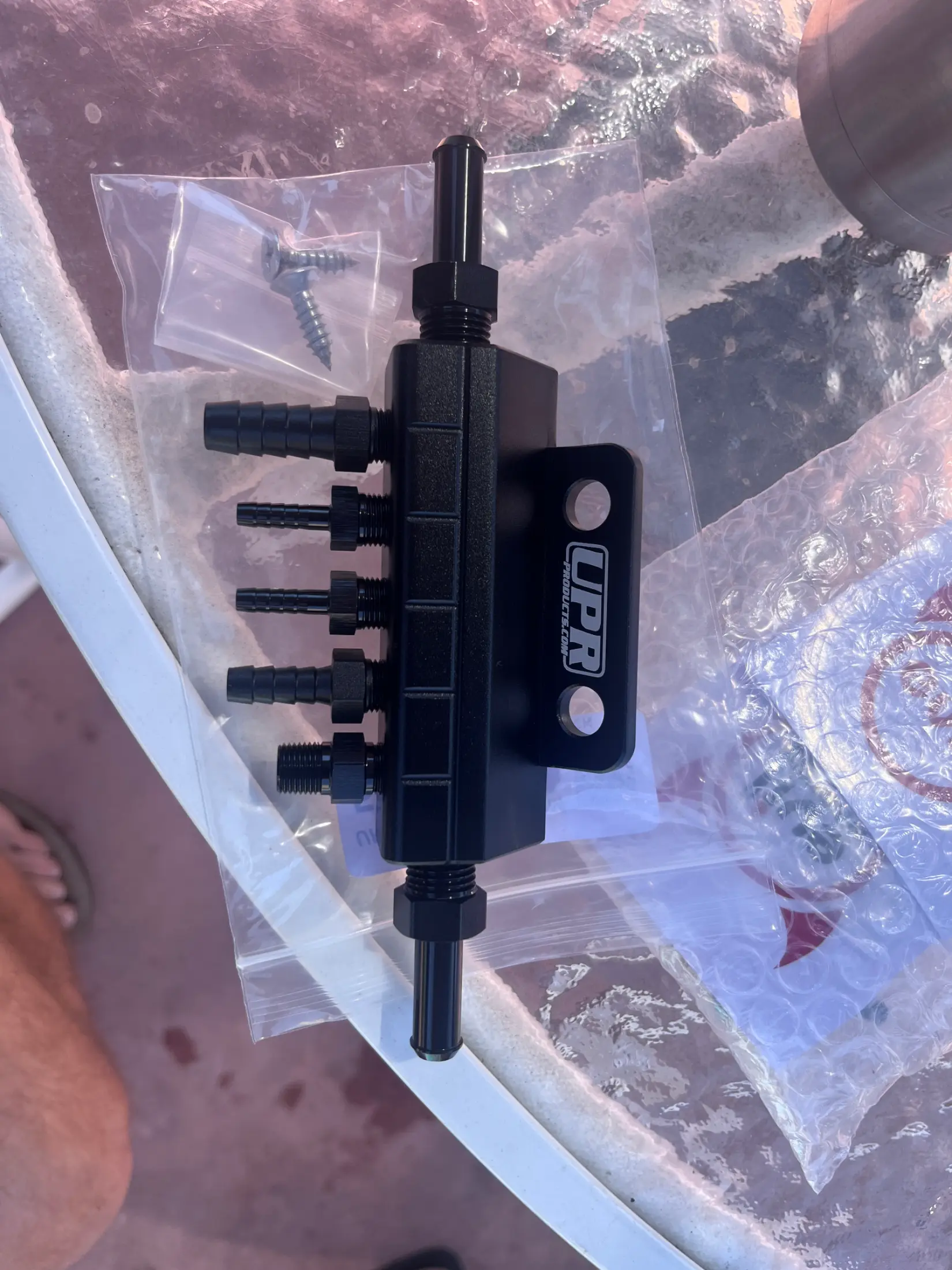

Got my vacuum block in and added the additional ports. I’m hoping the one male NPT fitting will fit the boost gauge female fitting.
So from left to right I’m thinking:
- source
- brake booster
- FMU
- bypass valve (eventually)
- A/C
- boost gauge
- cruise control?
I have a bunch of other fittings to make sure everything fits, I might have my sizes off a little bit currently.
Goal was to not have a bunch of tees branching off lines.

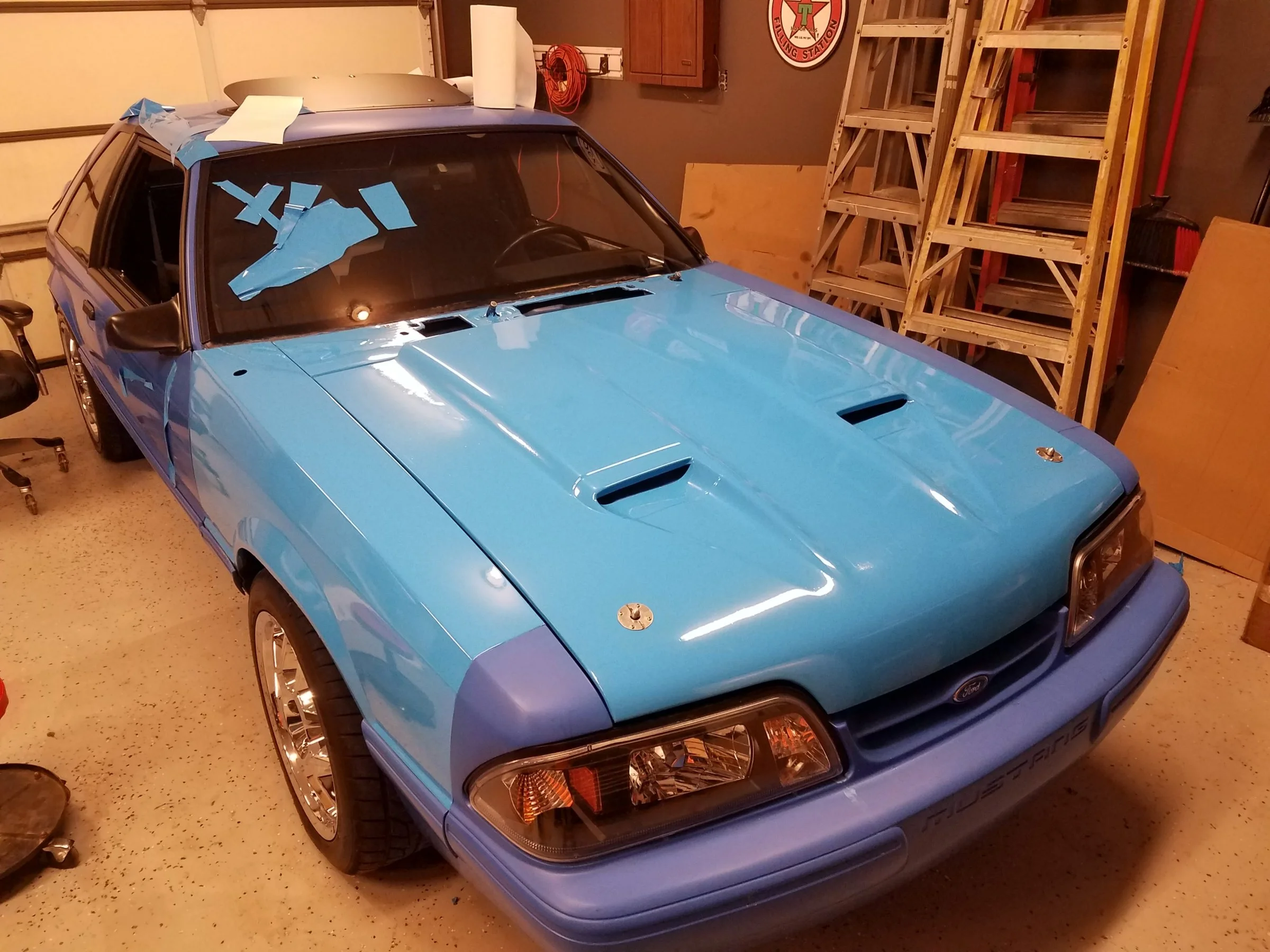

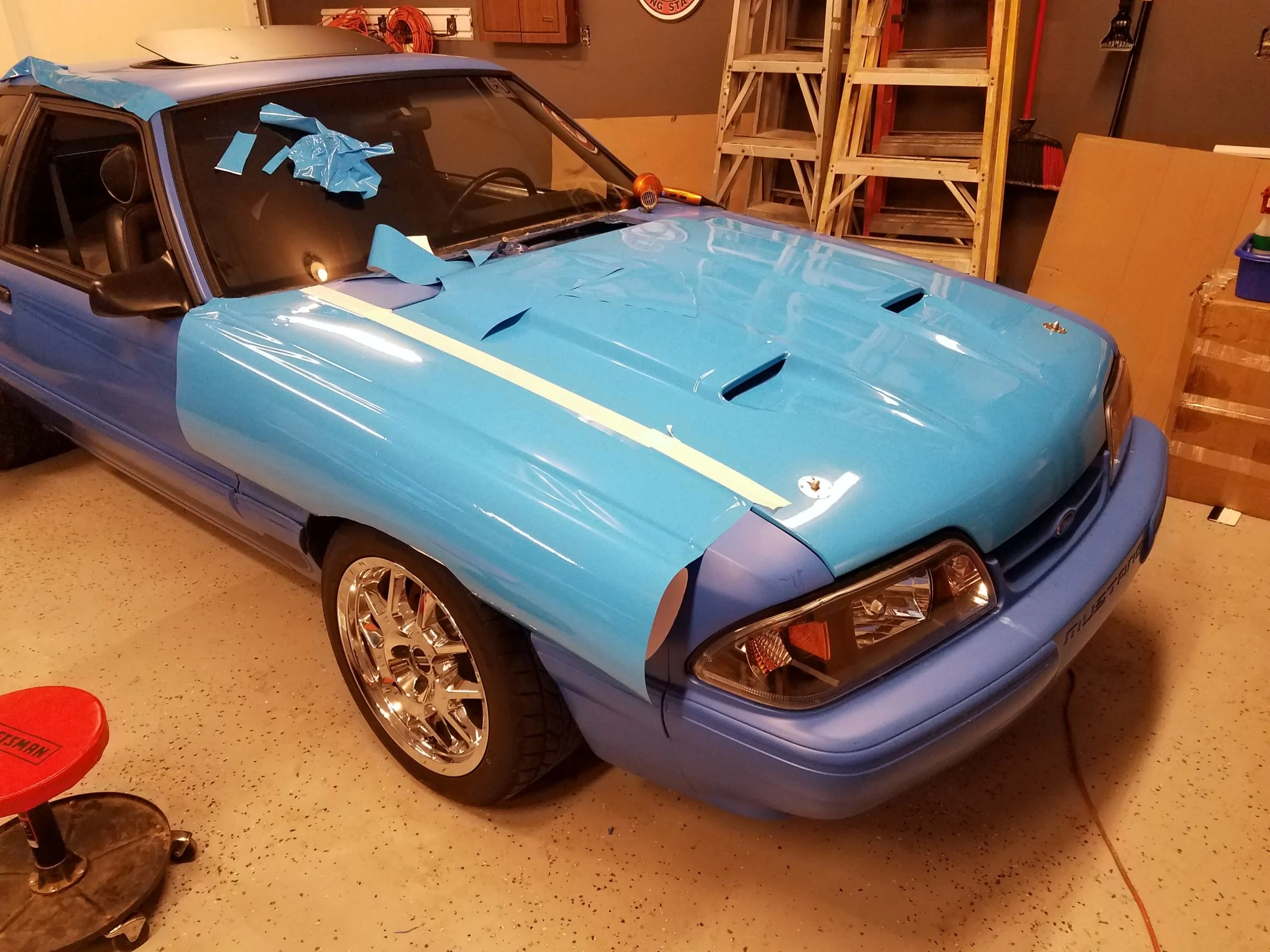

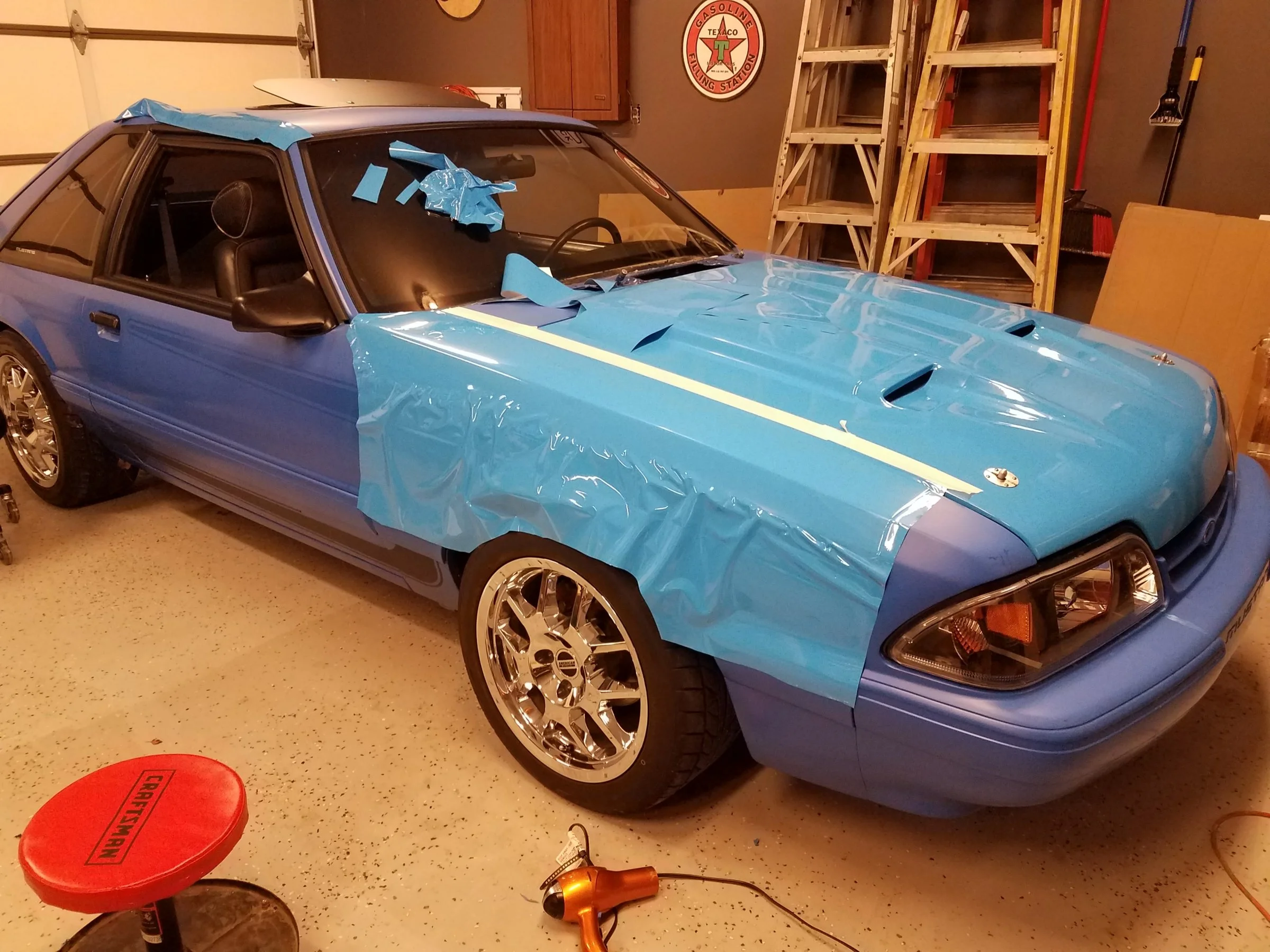

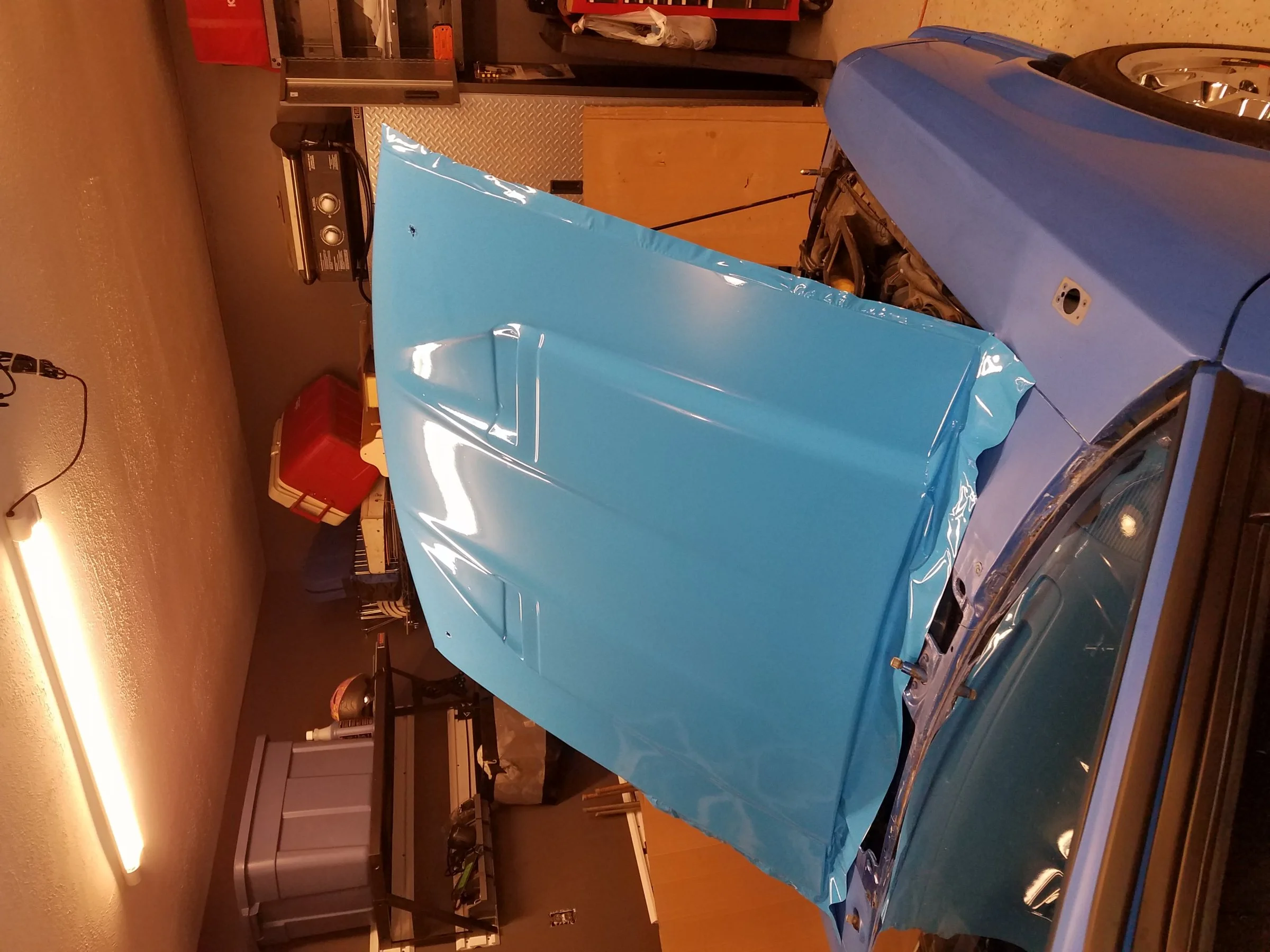

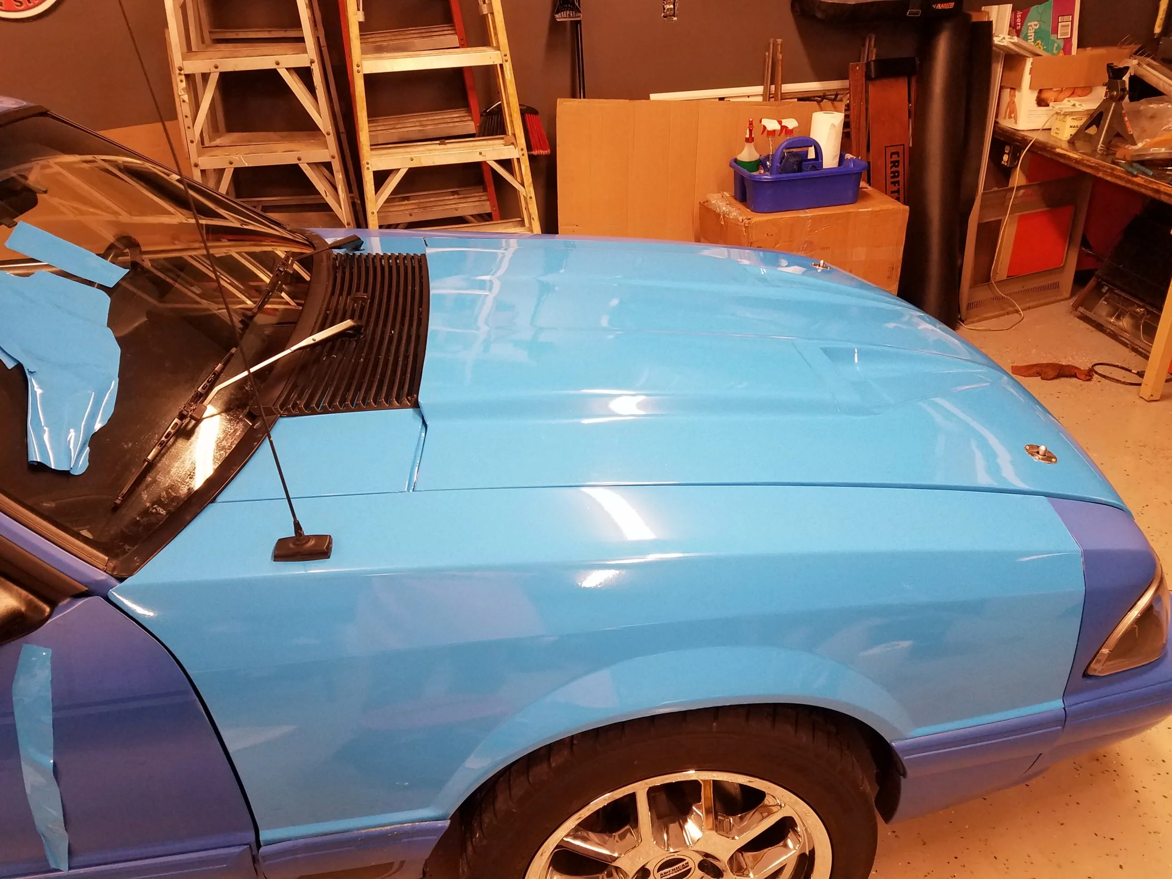

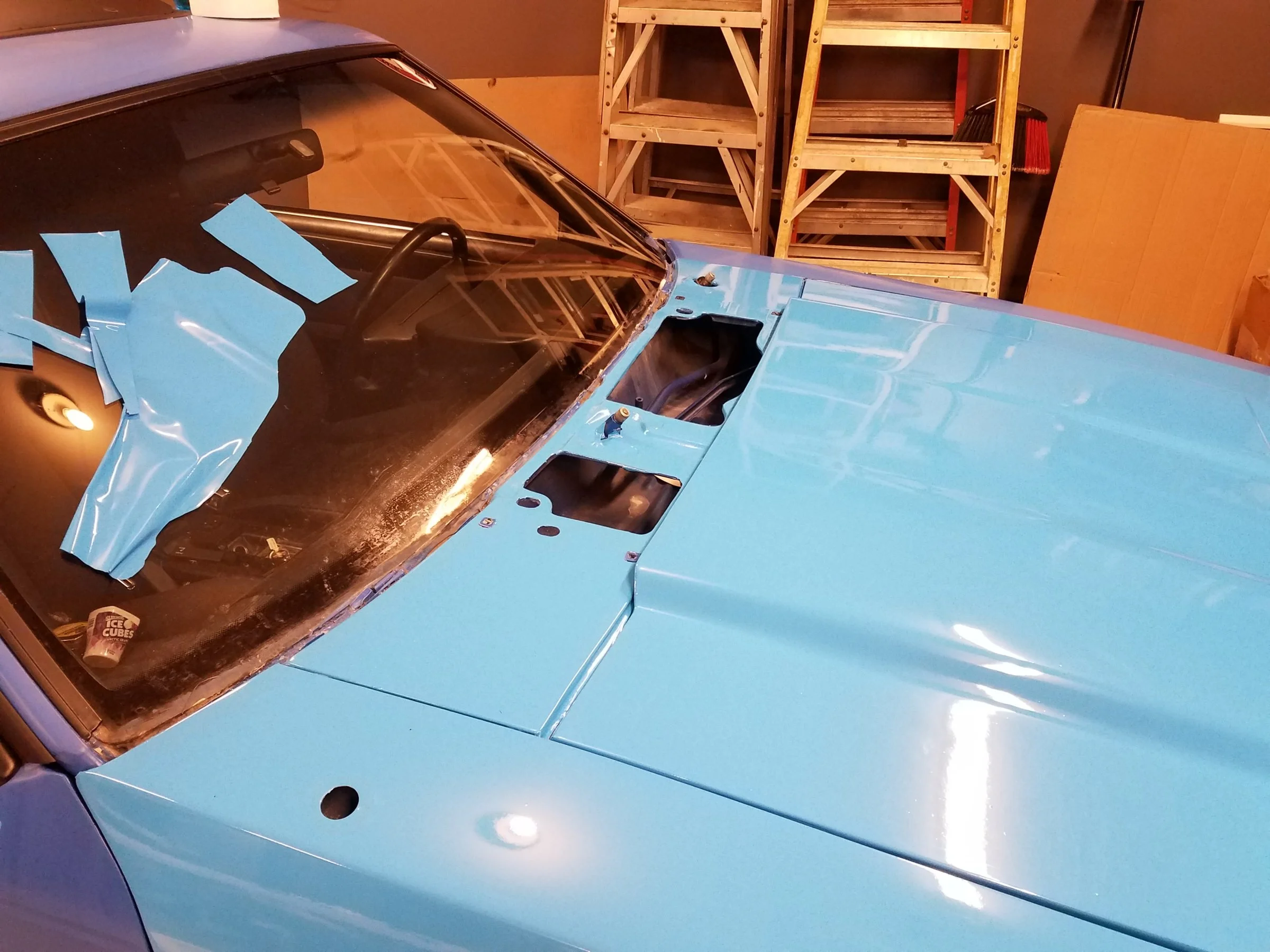

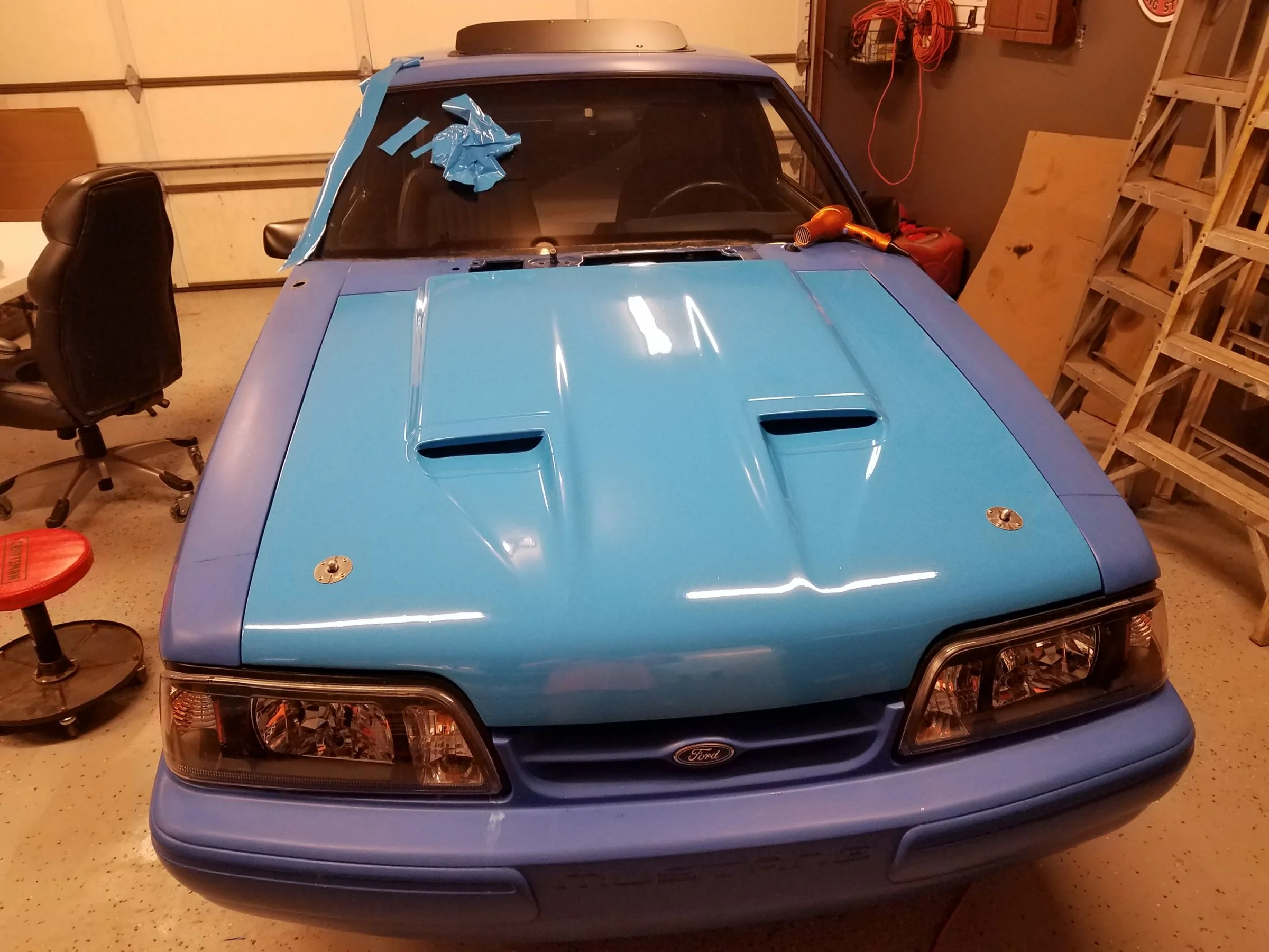

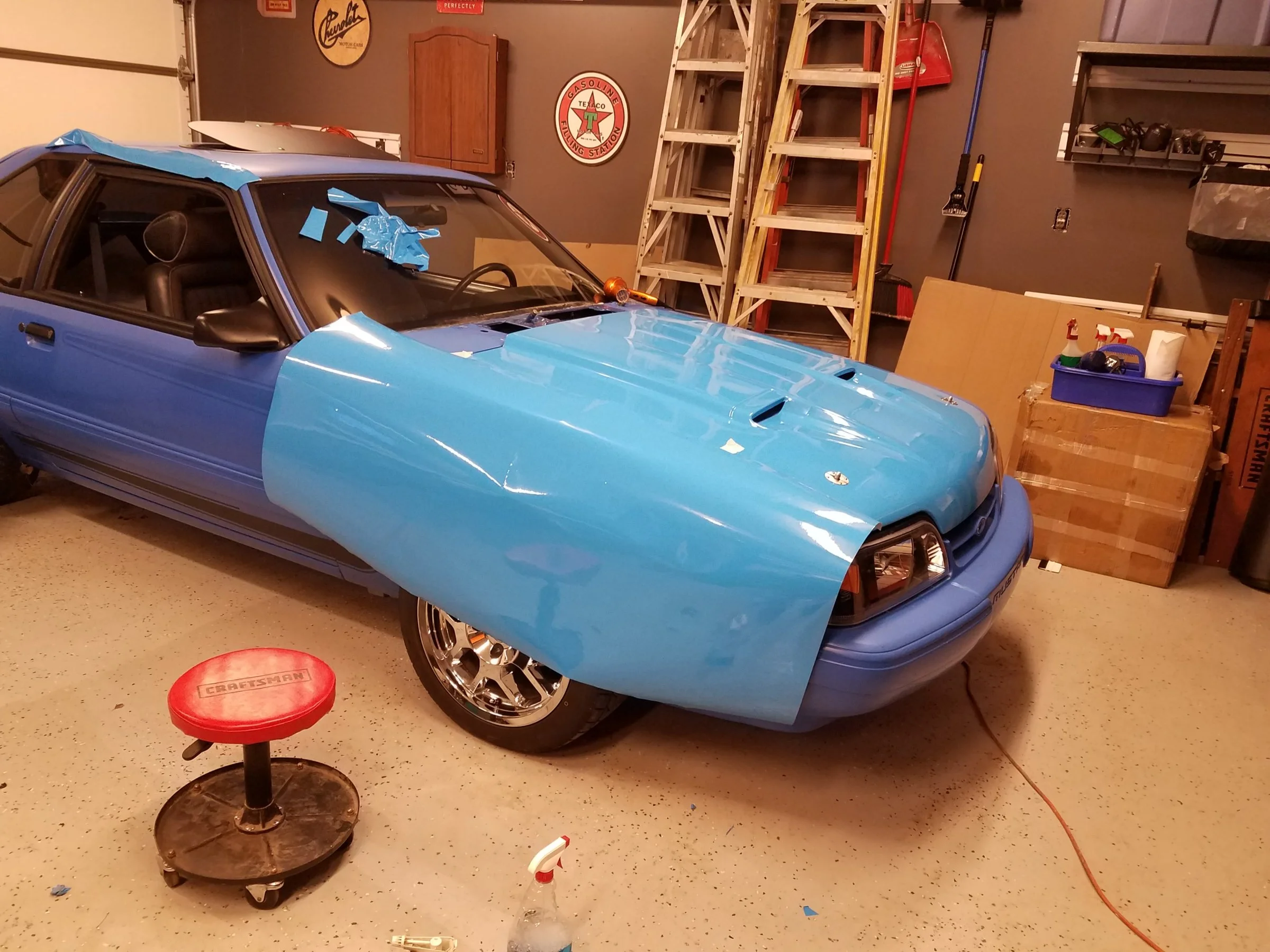

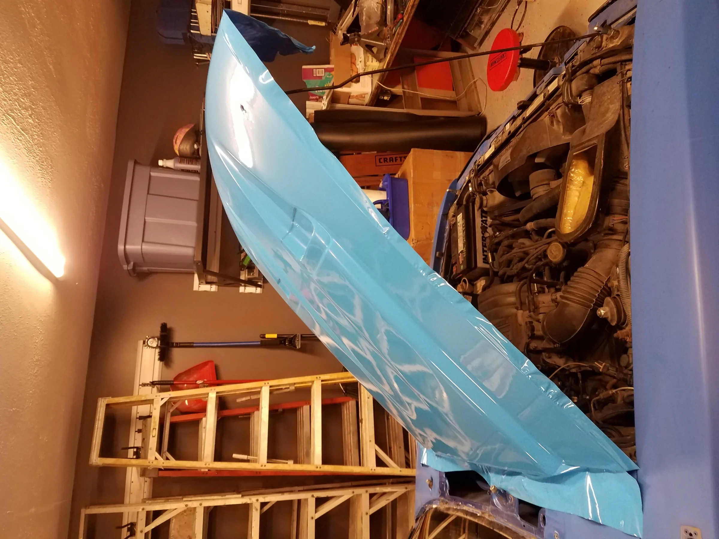

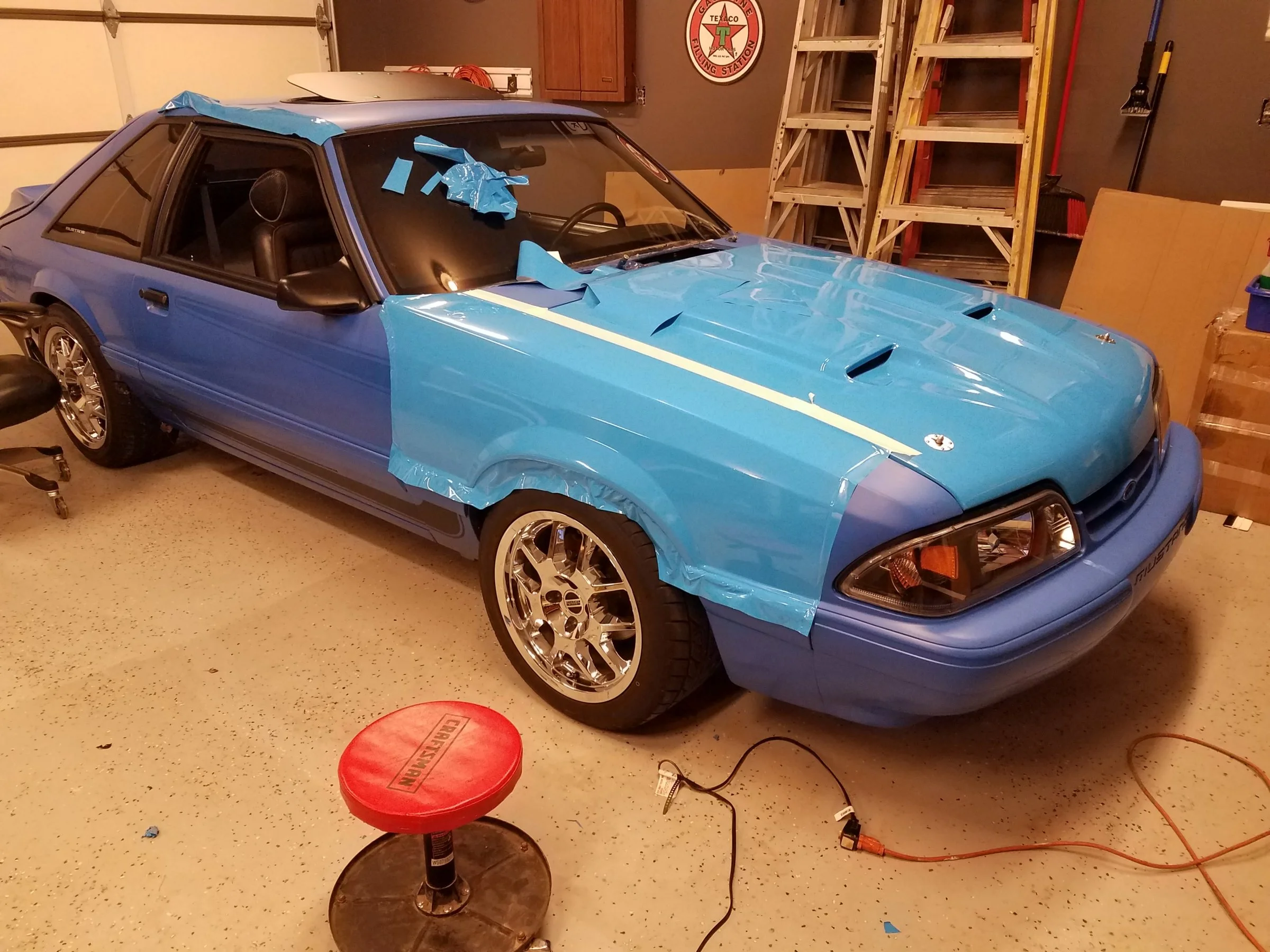

If you haven’t seen this thread yet, give it a look. Facinating wrap work by @JoeDaddy. Excellent “how-to” that you may find very helpful.
Thread 'Wrap That Thing!'
May 21, 2017
Got out to the barn at 10 tonight, wanted to accomplish something. It's 2am now, and I give up for tonight. Will add more words tomorrow. Enjoy some pictures for now. (2am Joe doesn't care some of the pictures are sideways)
  • JoeDaddy
  • Replies: 101
  • Forum: 1979 - 1995 (Fox, SN95.0, & 2.3L) -General/Talk-
Reactions: DadLife0724, 85GT4V and gkomo

91AOD5.0LX said:
If you haven’t seen this thread yet, give it a look. Facinating wrap work! Excellent “how-to” that you may find very helpful.
May 21, 2017

Awesome thanks! I will check it out

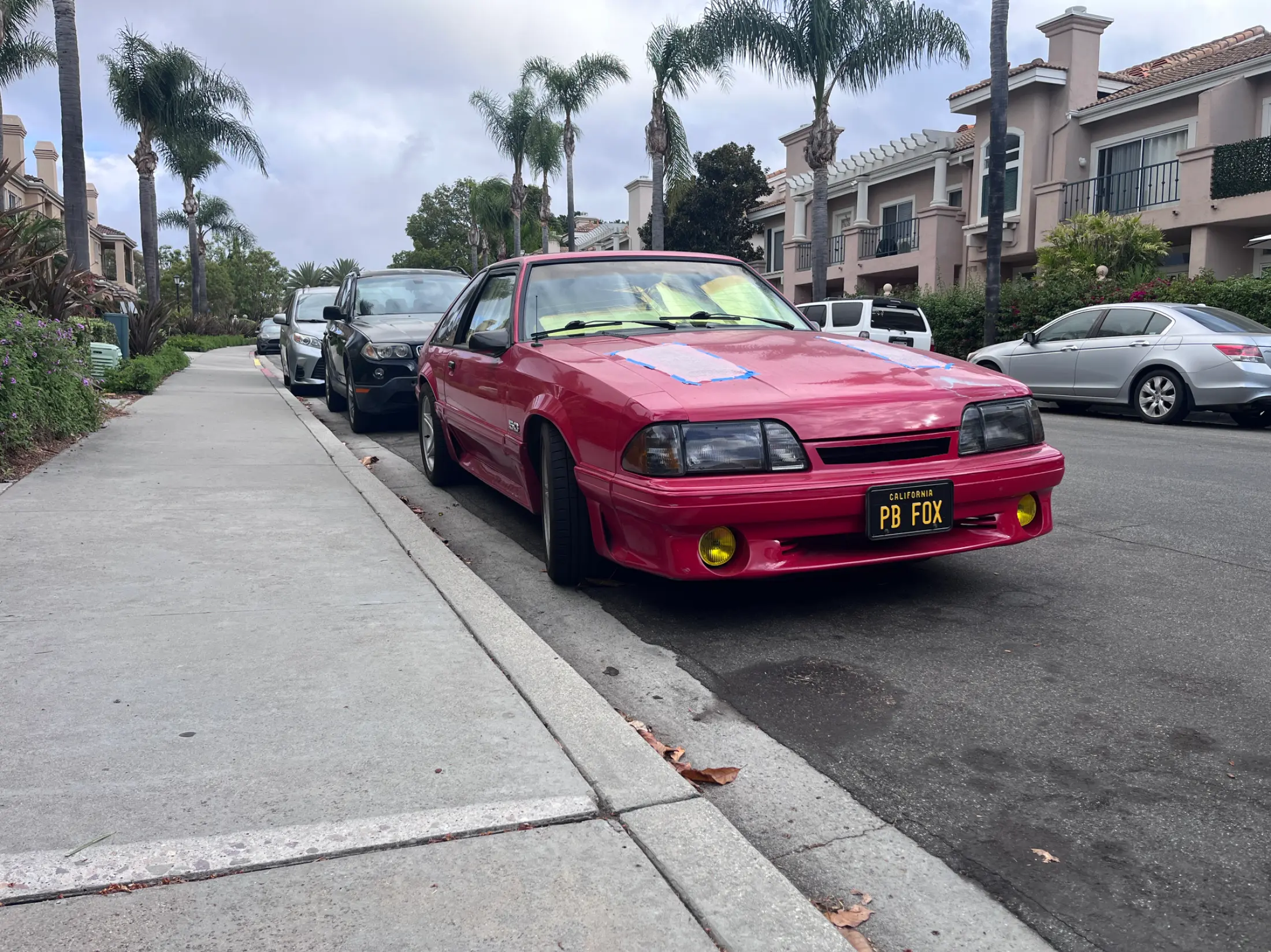

I In fact did not have time to install the vacuum distribution block and only have time to quickly take a passing photo while walking a napping baby:
Just wasting away getting dirty, baking in the sun (although we did have a small sprinkle overnight hence the vents being covered), not getting driven at all this week.

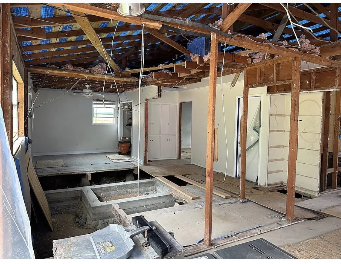

AeroCoupe said:
How is the remodel coming along?

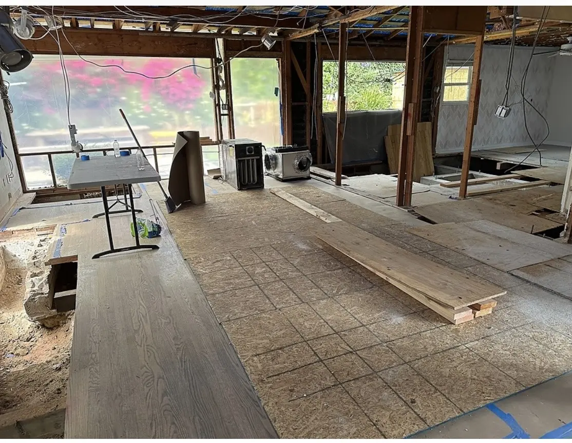

Roof shingles and plywood are off. They’ve torn more walls down and removed the wall/closet where we are expanding the entry way:
Lots of work to go though ::crying::
The blue up there are tarps covering the exposed house.
Stairs will be going where that dark wall is in the first photo.

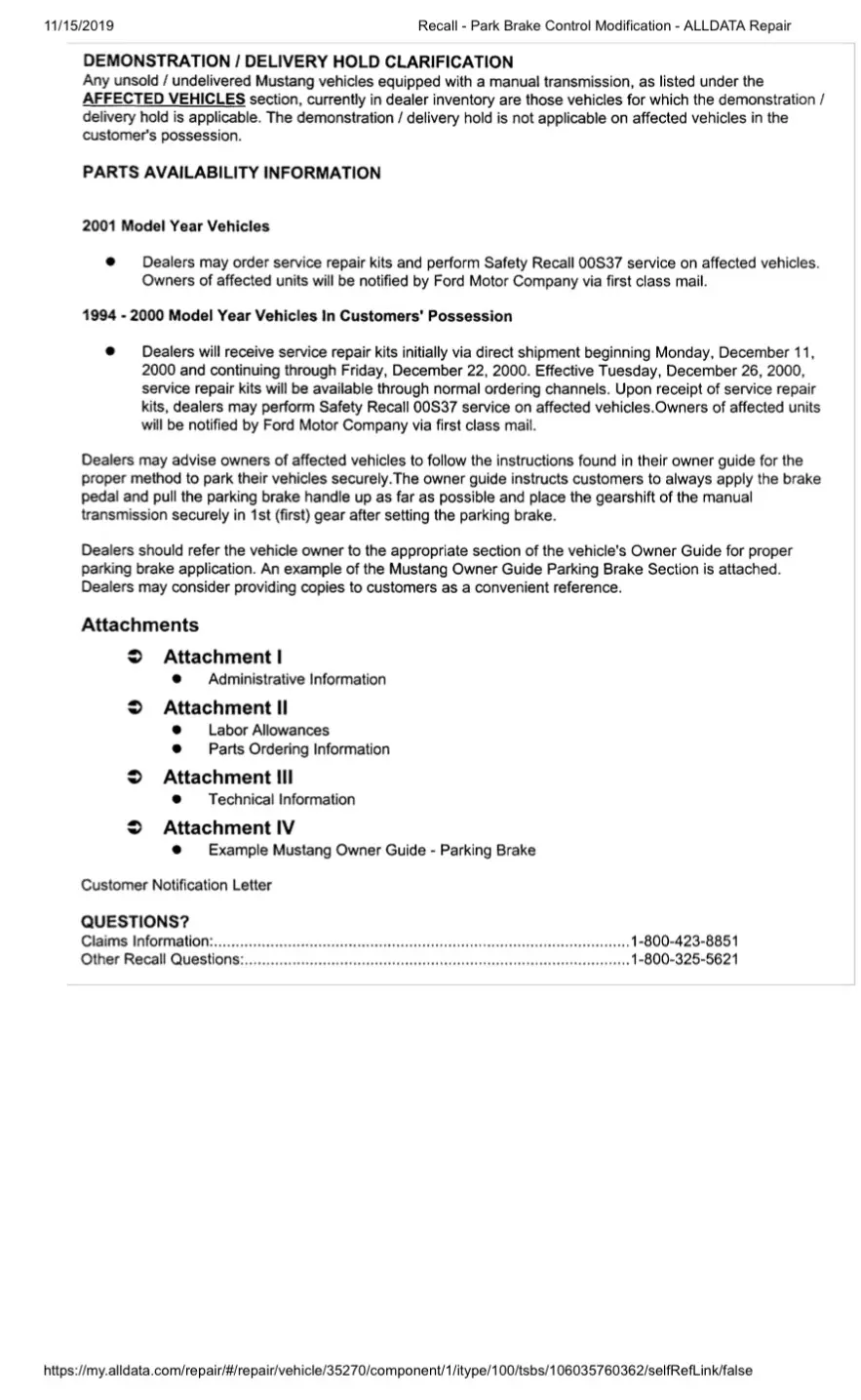

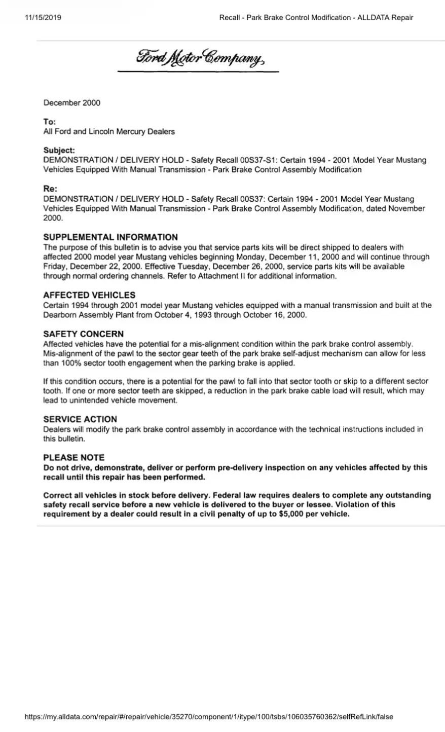

So I have rear 5lug disks and never did the modification to my ebrake handle (so it basically doesn’t work). Standard method is to weld something and cut the spring. Apparently LMR now sells this:
https://lmr.com/item/LRS-2753BA/ford-mustang-e-brake-handle-adjuster-lockout-87-93
Which is supposed to take the place of the welding part. Anyone use it? I think I’ll pick it up and give it a try.

Several folks have and it works. I believe it stemmed from a TSB on the 94 and up cars.
Yes I have that on my 93 ,got it off a 95@the pic a part, same 95 I got the proportioning valve.
Oh damn I must be late to the party this is news to me. Is it not a new part? I would’ve done this a long time ago since I can’t weld, and would have a working ebrake.

Recall was in late 2000 and applying it to the 87-93 ebrake handle has been done since the late 2000’s from what I remember.

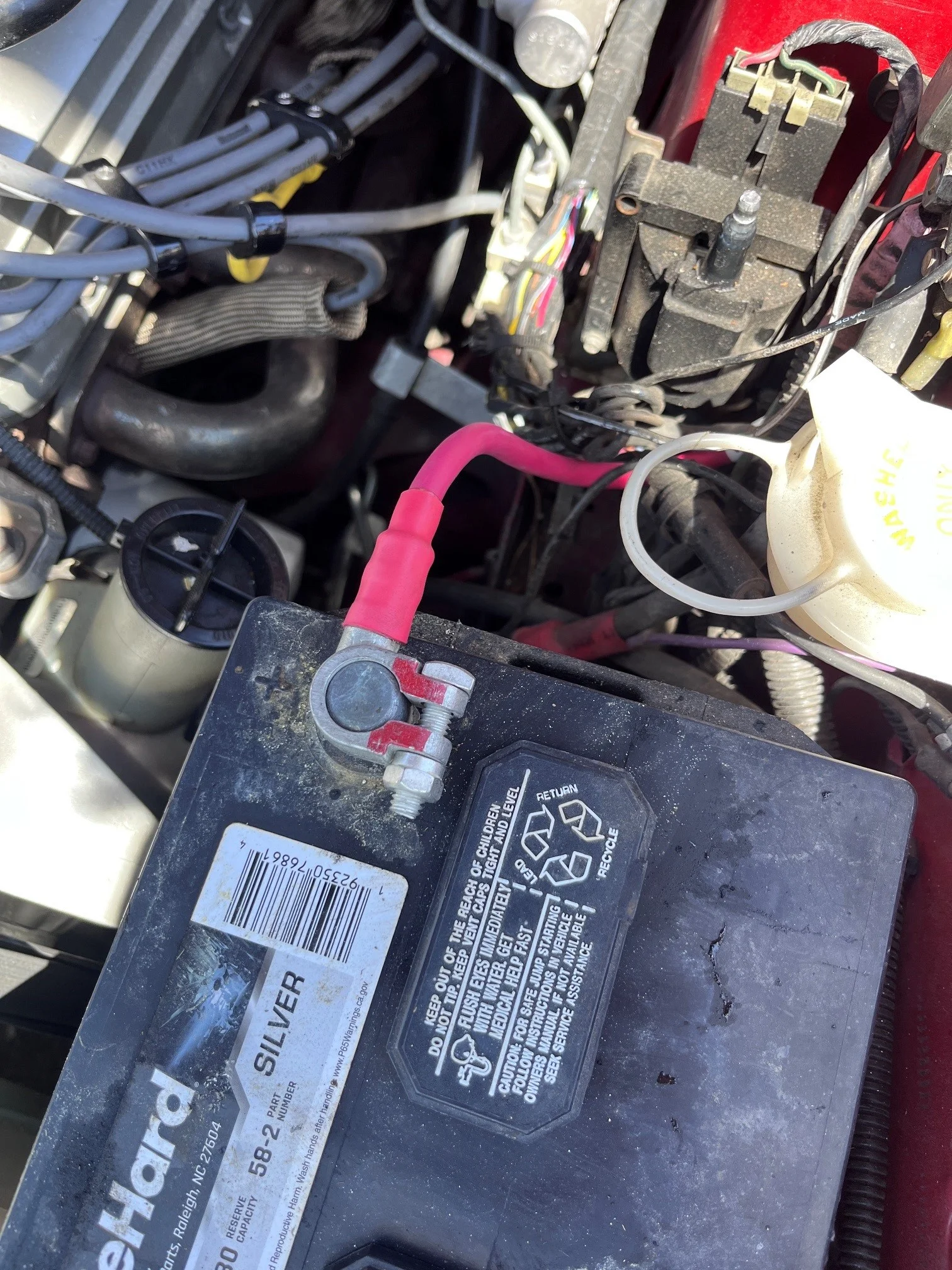

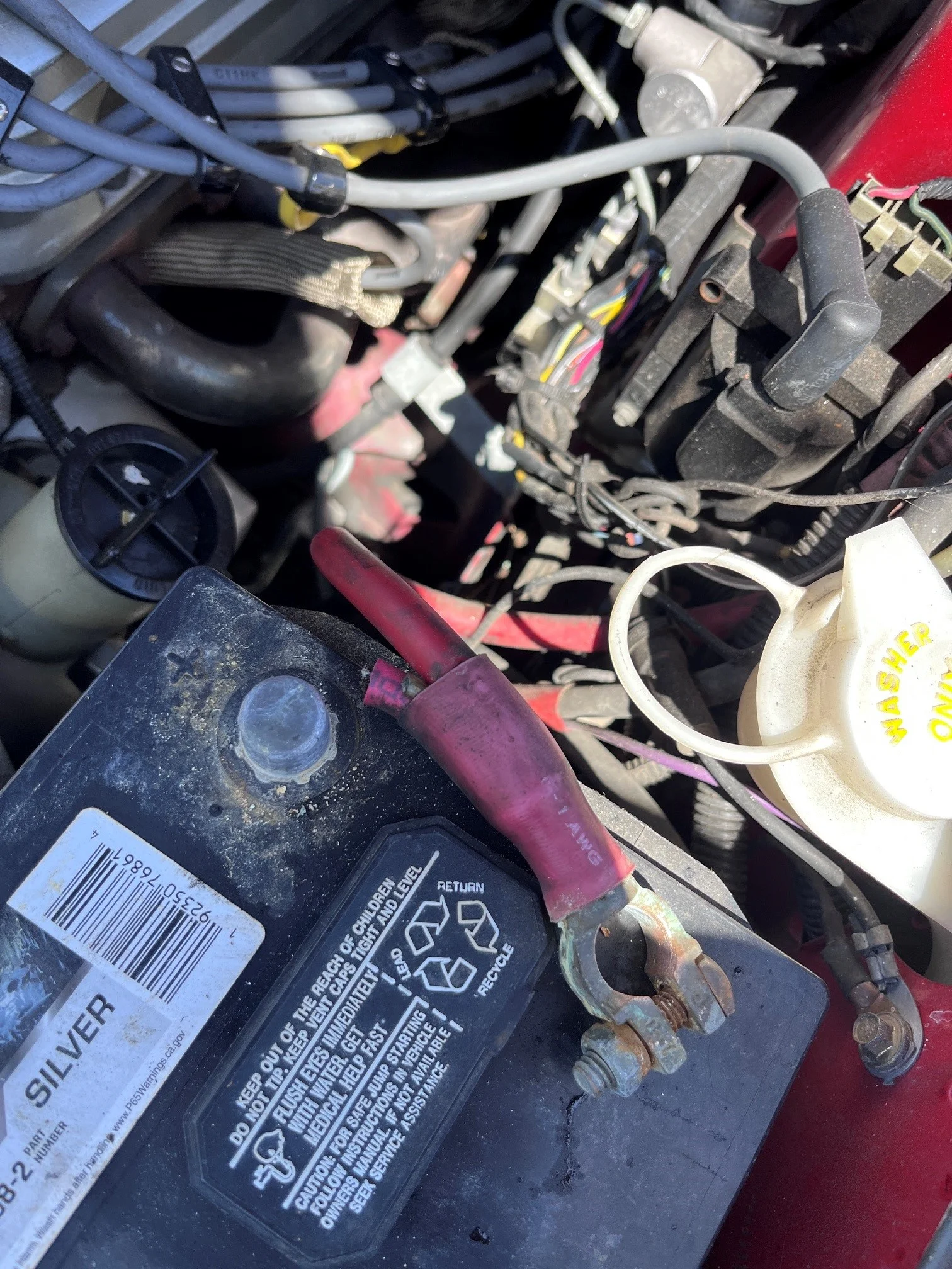

Replaced my positive battery cable today. Man, i need to clean up some of the wiring in that area. What a mess. My solenoid has a lot going on with it! I did wire brush all the ring terminals before putting them back on, as well as the solenoid post.
Old cable with random cut off wires:
New cable:
New cable IS smaller gauge than what was on there. Hopefully that's not an issue.

Why did you go smaller ?
I just bought a replacement positive battery cable since mine was looking jerryrigged and the terminal kept corroding. It looks somewhat clean in that photo because i recently cleaned it, but the corrosion comes back fairly quickly. I have no clue how far down the actual cable the corrosion goes so i figured i'd just replace the entire cable. The PO must have put that old cable on it, I didn't.
But I do have a 3G 130amp alternator. If that requires a larger battery cable then i'll just have to replace it again.
