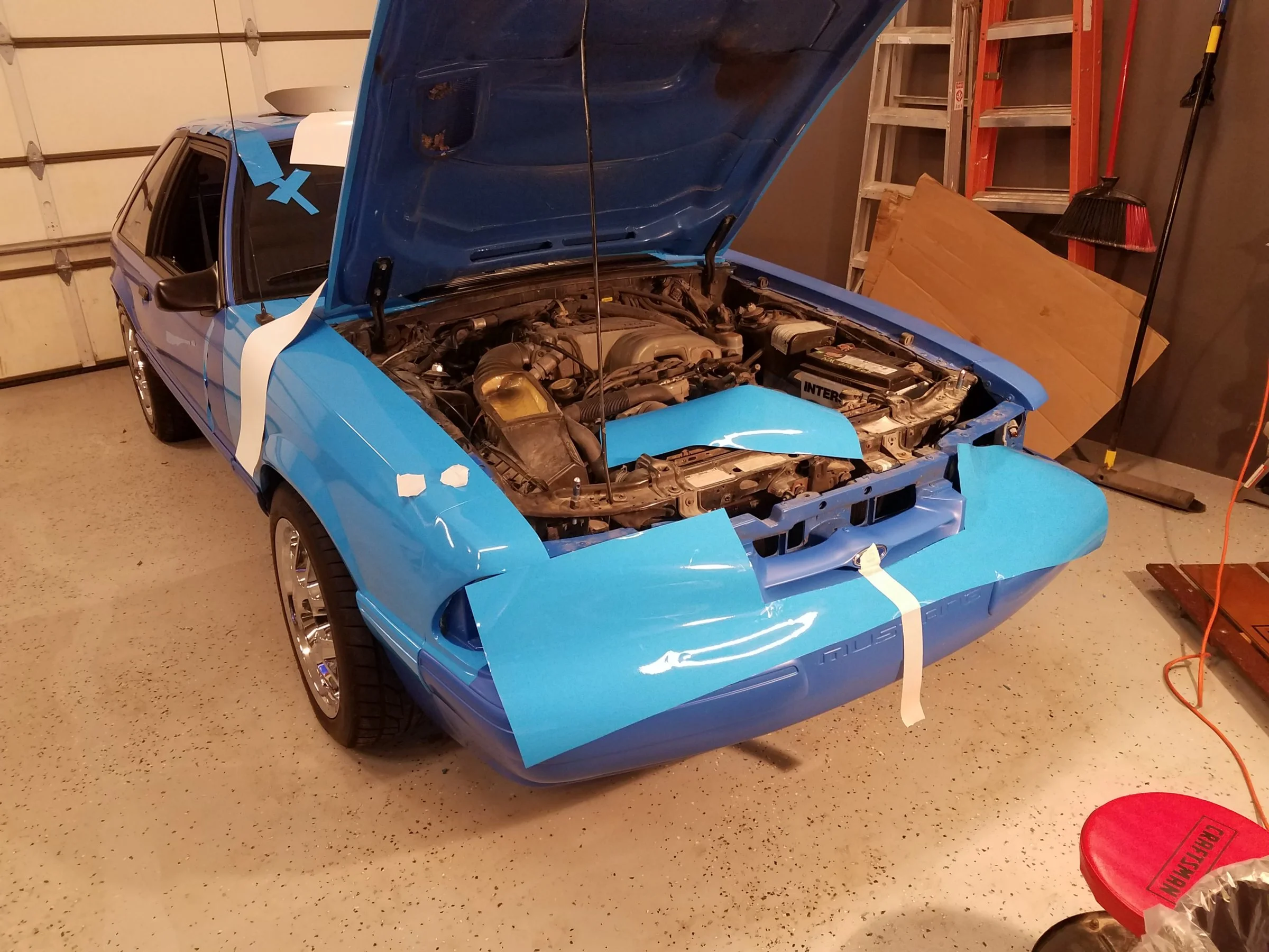

:rlaugh: I put a time lapse app on an old phone, and I'm still experimenting with the intervals it snaps a picture. The time lapse of the hood was set at 10 seconds, and made it way too fast. The hood took me a little over an hour and a half to do. The fender was probably around 45 minutes.

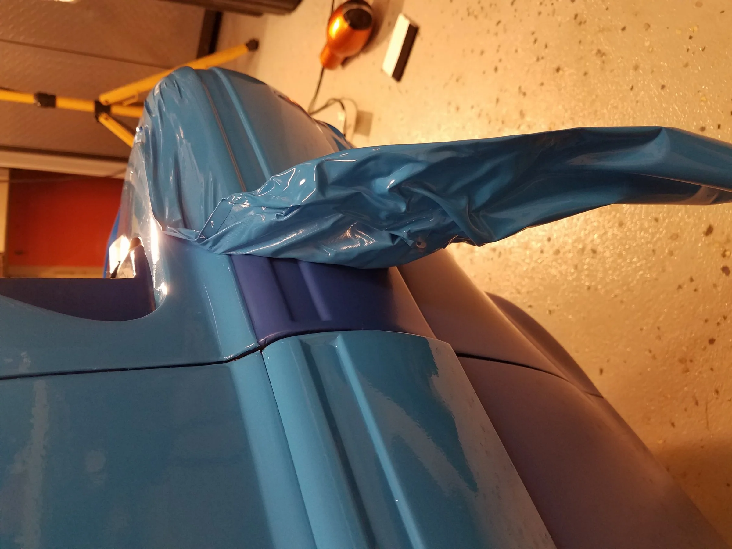

The kind of vinyl I'm using is conformable, and made for doing wraps. Getting it on with no wrinkles is just a matter of heat, stretching it, and patience. Ill take a regular movie on a smaller (less time consuming) peice.

The vinyl im using is very forgiving. You can fold it over on itself and peel it back apart. It doesnt really "stick" until you apply preassure. That being said there is still a learning curve as to how much heat to use, and where to pull. Id put it at a 3.5. You could probably train a monkey to do it, but it would need to be a smart monkey :shrug:
So far the hood scoops were the most challenging part, not getting any wrinkles.

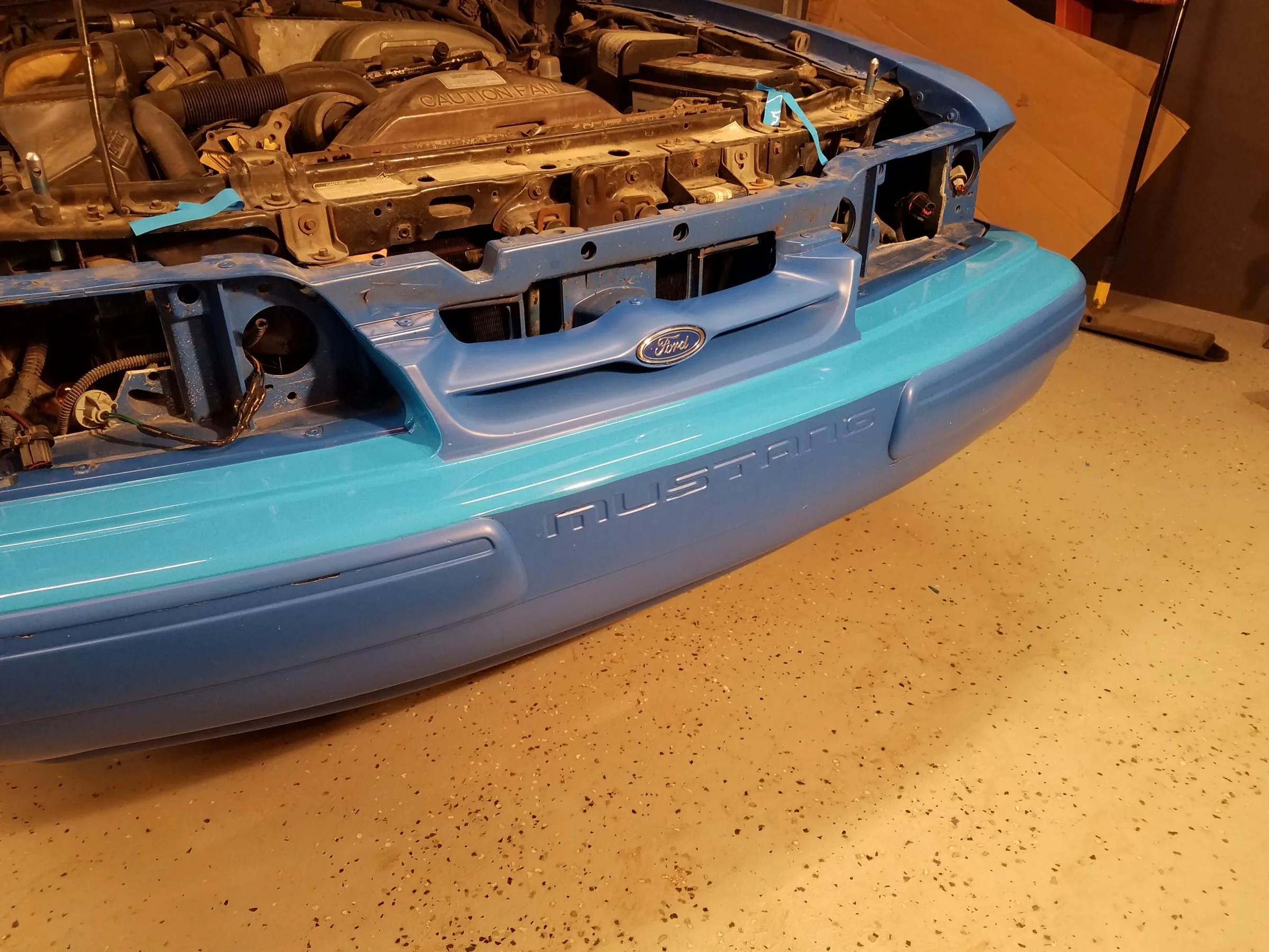

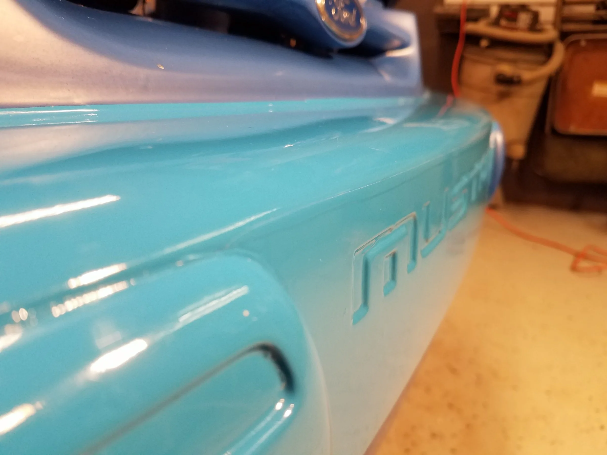

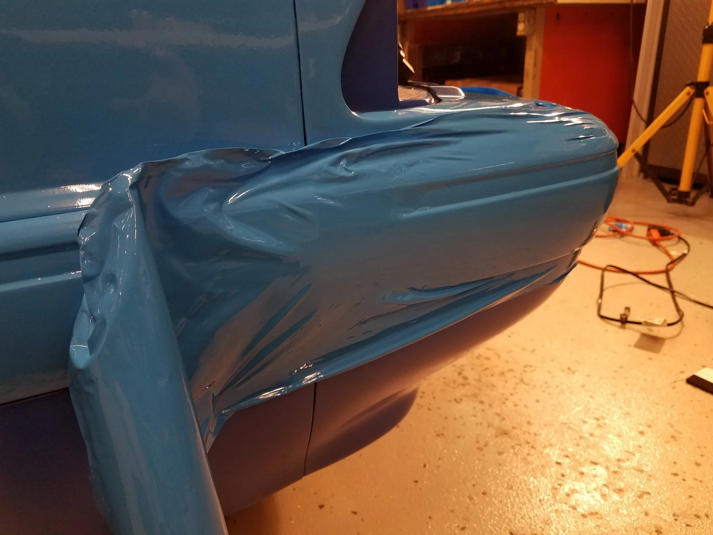

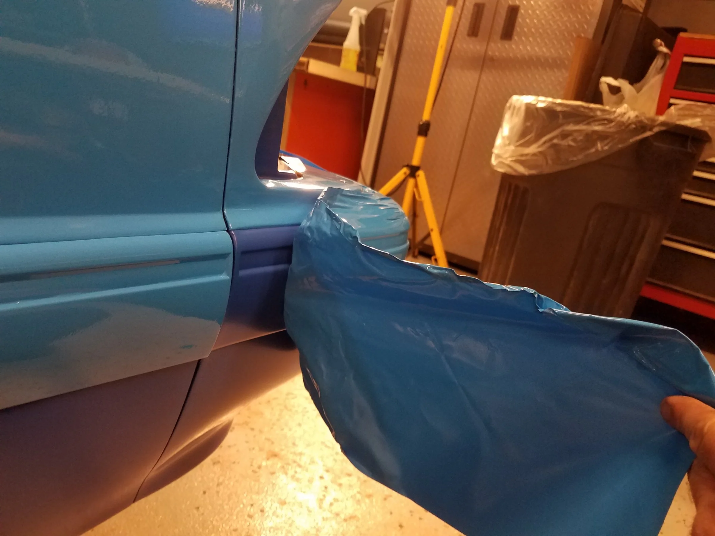

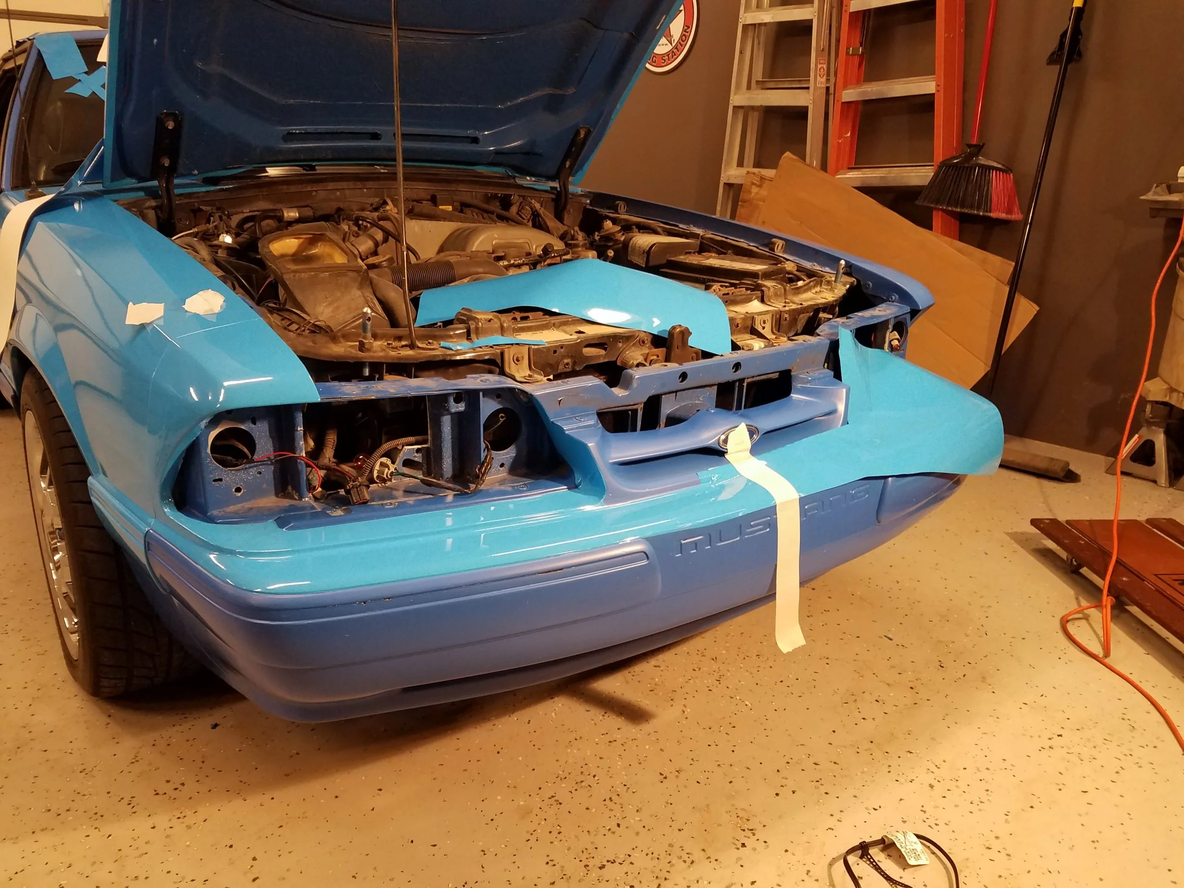

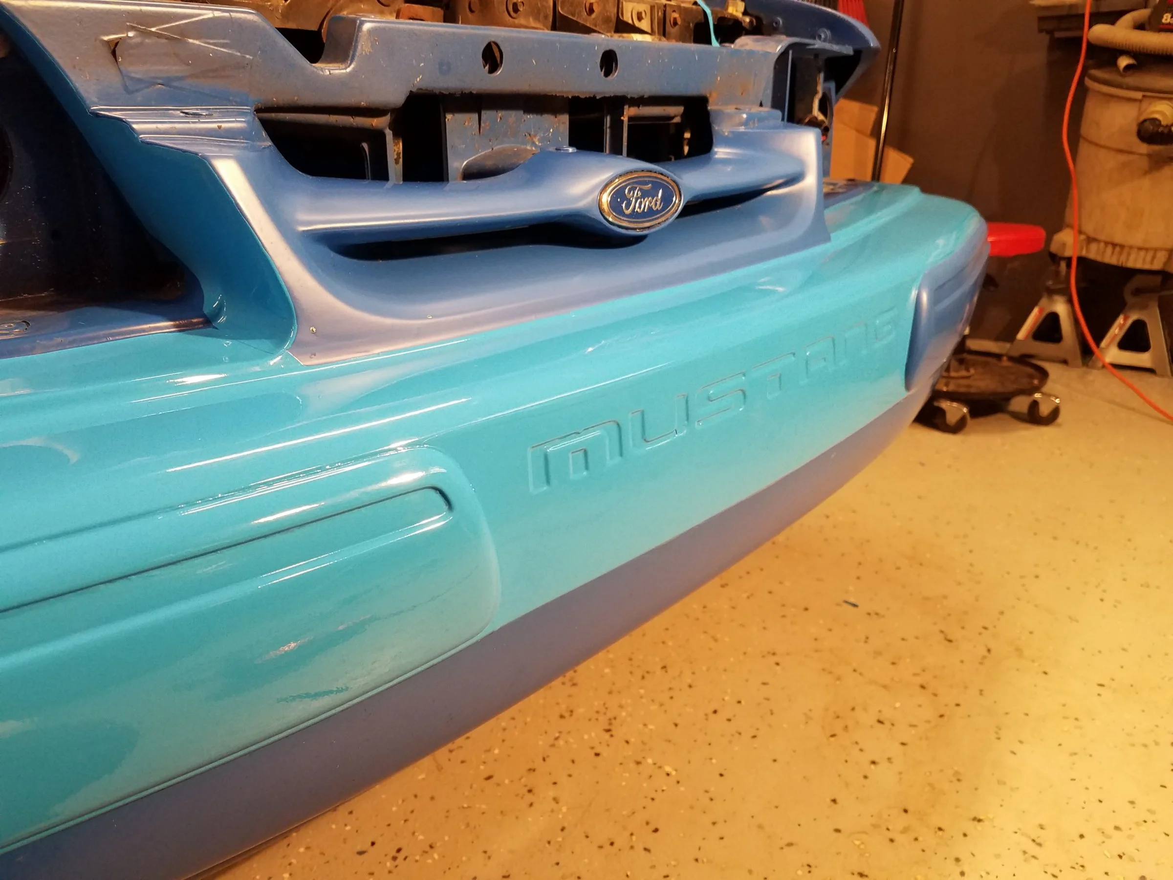

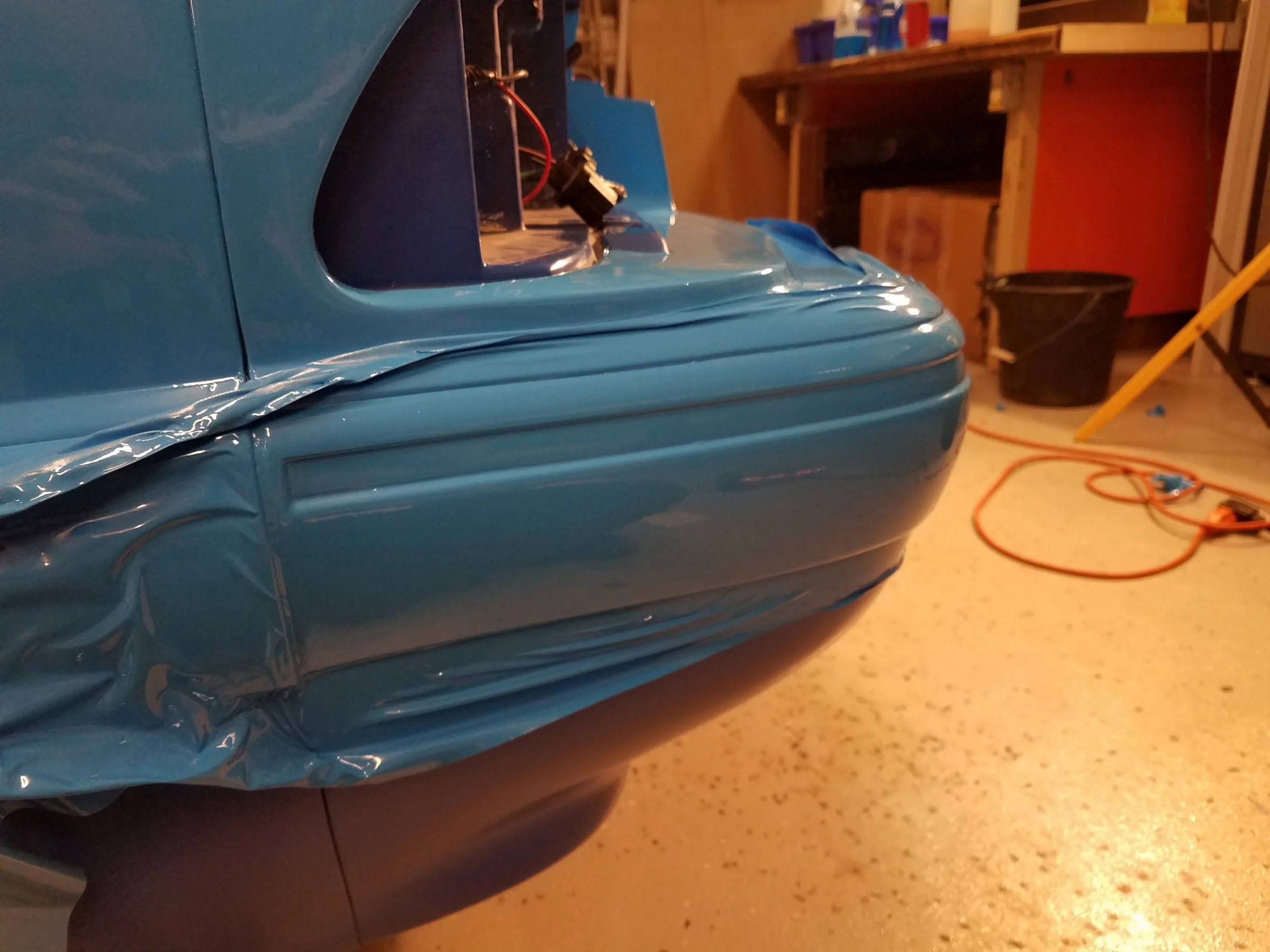

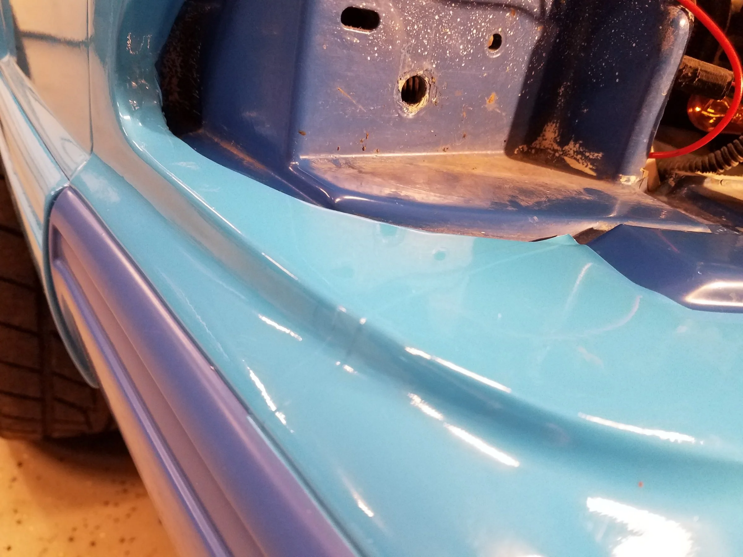

Back at it again tonight.... Someone asked me above how I was going to do the bumper. Simple answer, I'm gonna cheat. Lots of seperate pieces, with the seams hidden in body lines as much as possible.
Oh no! I crumpled it all up!
Magic vinyl.. just pullit back apart.
Yea.. there are seams...
Not really noticable from more than 4 feet away....
