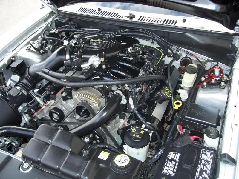

Would anyone happen to have pictures of the top of the lakewood 70/30 struts on their car 99-04. that way i could see how much or many treads are above the top nut? that way i can see if im missing a spacer or whats going on. thanks
Here is a pic of the spacer,circled in red on the driverside with red arrow.I have two per side because my M&M c&c plates come with them aswell to get the struts at proper height for being lowered,but anyways,that is what should have come with your struts.One for each side. ;)
