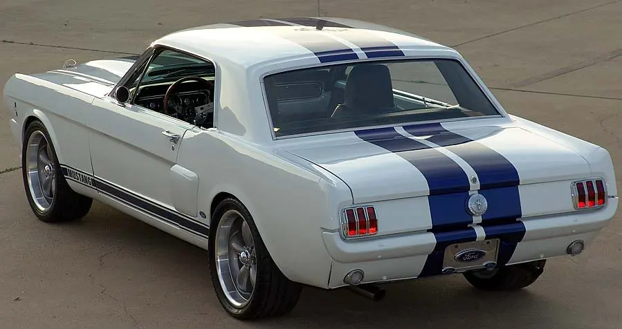

I have found that a 10 inch wide tire, maximum not tread but just overall width, and no taller than 26.5 inches on a stock ride height car 65 or 66 without modifying anything with a 8 inch wheel with a backspacing of 4.5 or even 4.75 will work. Unfortunatley most wheels dont come standard with that backspacing. It seems 4.5 is a more popular size than 4.75 which puts the wheel inside the wheelhouse, and you still have enough clearance between the tire and leaf spring. If you start lowering the car measurements start to get critical. I hope this puts this whole thing to rest. Can't we all just get along! :shrug: :rlaugh:

295/50/15 with the american racing 15x8 black rims, dont know the offset but its a standard offset, no other options were available, the car has a new set of 5 leaf standard eye springs and it all fits, if i hit a hard dip it will lightly scap with one person in the car, i dont plan on trying any passengers, its sure to hit.
Also, it runs flush with the stock fenders, well, just SLIGHTLY sticks out but its not ghetto. Unfortunatly i dont have pics yet, maybee later this week.
Are you sure you mean 295/50/15s? If so..Pic please.
I got a pic of a car TODAY with that tire size with some huge fender flares at the NMRA race.
If I am correct most 295x50 15 are at least 12" wide there is just no way these will fit without mods or you can refer to the pics in this thread and see for yourself how 275s fit on the coupe in those pics, and 295s are wider still. I think there is a misconception of what you can bolt on and what actually does fit properly

Thats what i have on my stang right now, 295/50/15's with 15x8 rims in the back, with a new set of leaf springs you dont even need any shackles to lift it either, so basically it bolts on, i banged the inner fenders a bit because it would hit SOMETIMES with 1 passenger, now it doesnt rub with a passenger, granted you can only drive with one other person, it depends how bad you want to look of some fatty tires in the back. I can live with only being able to drive with one other person, if you need to you can get some shackles and lift it more than stock to be able to drive with other people in it. I'll try to get some pics if not soon enough i'll post another thread to show you guys.
but we just saw a car with 275's and they stick out the side of the car some good inches, please show us a picture of what your tires look like from an angle and the back?

This past weekend a buddy of mine got new wheels for his '04 mustang....with 315's tires for the rear, so I said "lets see if they would fit on the '65", the inside of the tires were touching the leaf spring and the outsides were sticking out a good 1 to 1.5 inches. I could not imagine a 295 fitting properly.
Man, this is an old post, back in 2004, lol
This was the only pic I had on my computer, but those are 295/50/15s on a 15x8 inch wheel with stock springs (no shackles)
